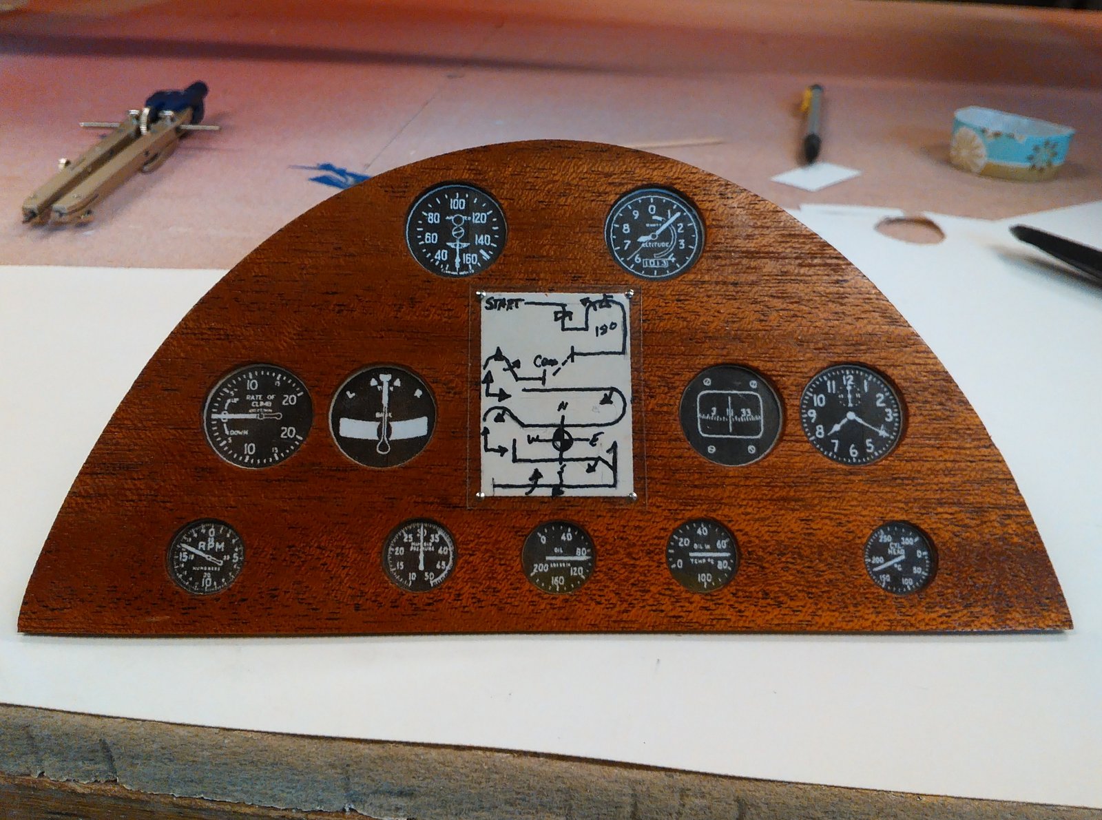

I bought a J'tec 1/4 scale instrument kit a while back so first thing is the panel. I used a piece of 1/16" mahogany and opened the instrument holes with 1/2" and 3/4" forstner bits. I then made a laminate from 1mm birch and opened the same holes up with the next size bits. When glued together it gave me a place to glue the instrument faces and instruments to.
Then I made up the aresti chart, and glued it to the panel. I used a piece of plastic to make a cover for the chart and attached it with some stick pins pushed through the panel and cut off.

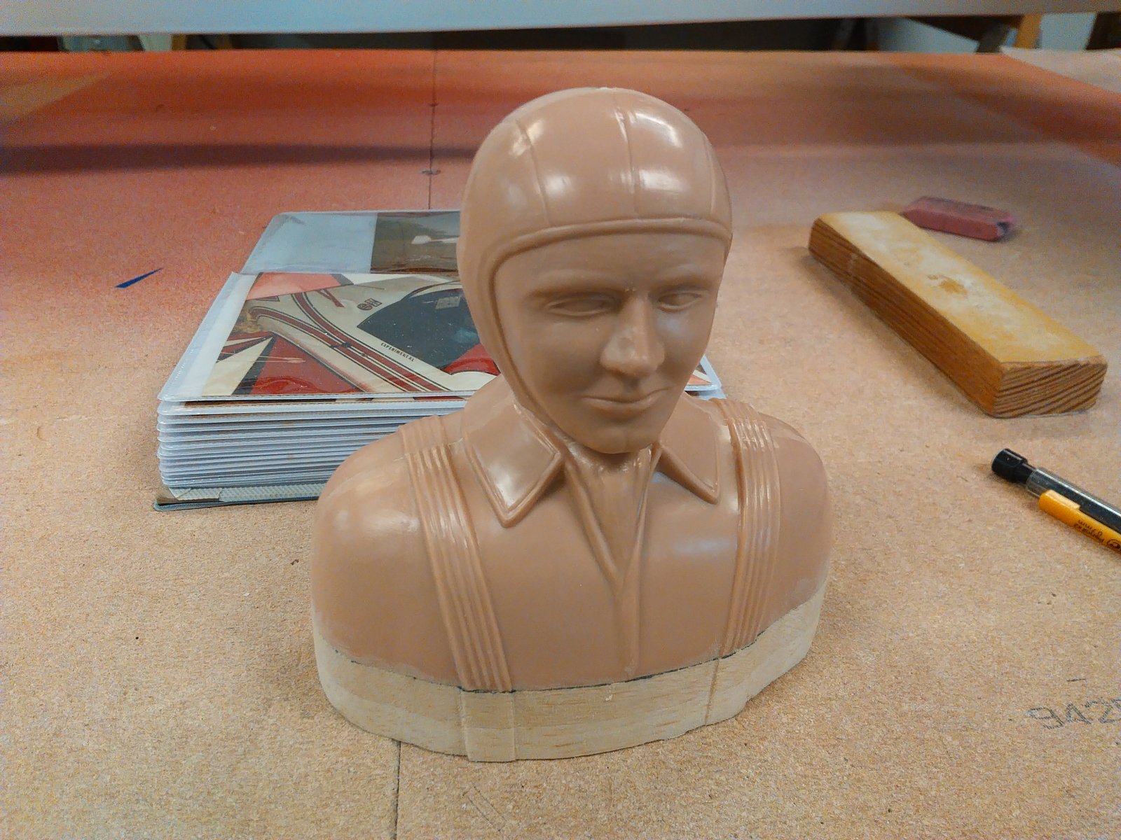

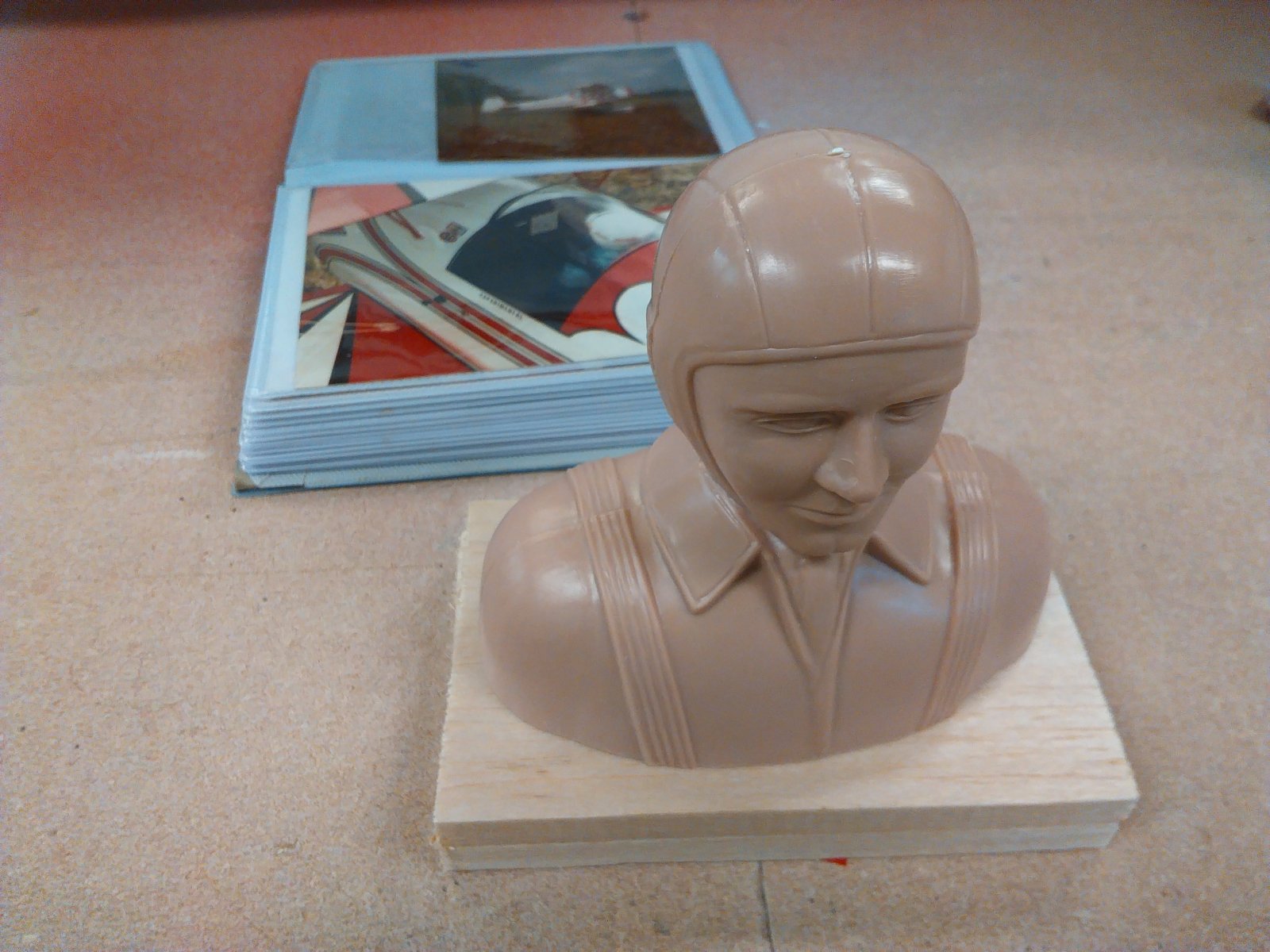

It's a little to short, because the cockpit opening on the Krier is cut down so low. So I made a 3/4" balsa shim.
I cut the shim to shape and glued it to the bottom of the pilot and set about filing it to match the shape and contour of the pilot. When I was done I put 3 coats of Nitrate on the balsa to fill the grain. I'll break out my display model paints tomorrow to finish up the pilot, including the goggles.

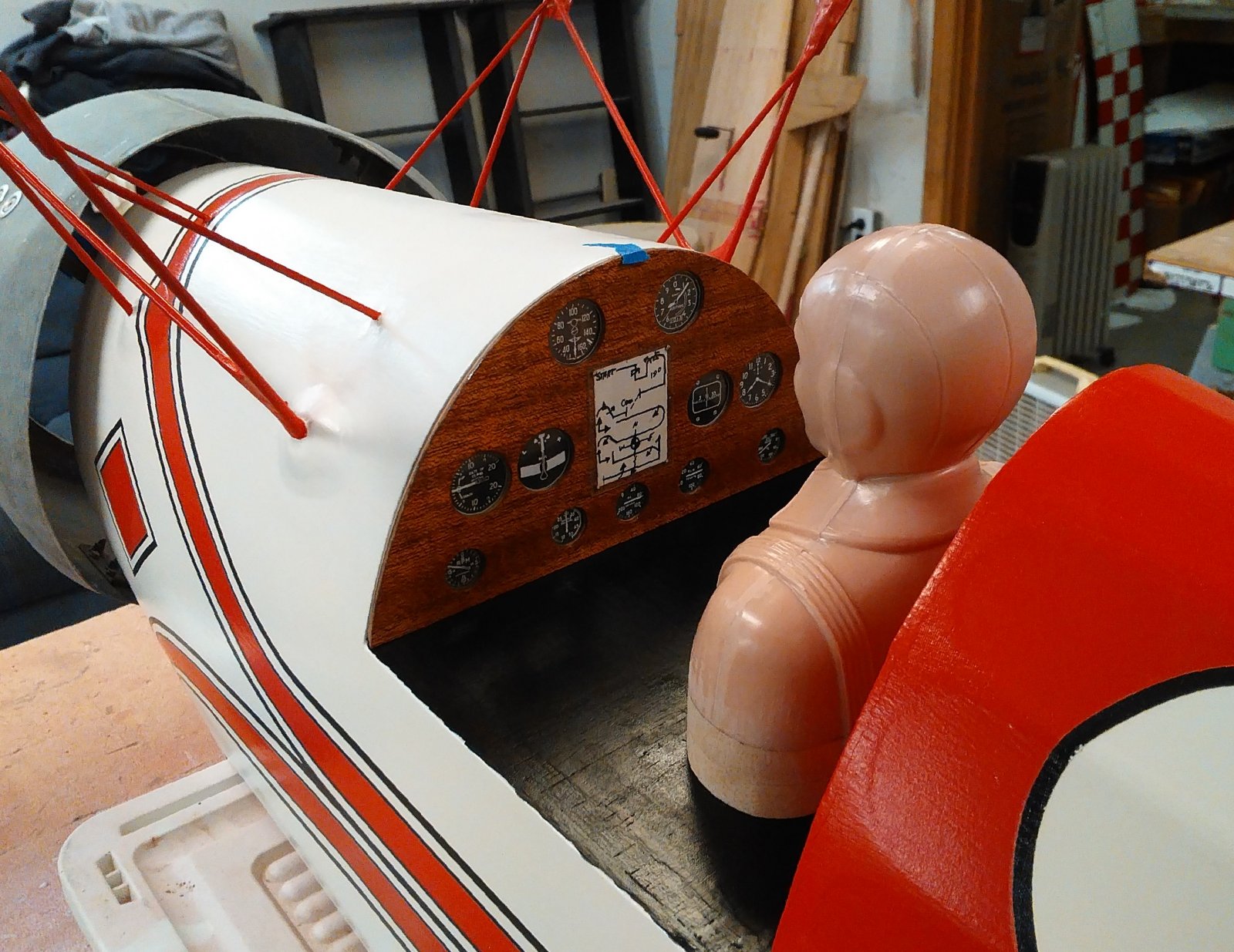

So here is a taste of the finished cockpit. The floor was painted with Dakota Black butyrate. I still need to finish the pilot, make the seat back and headrest. Then after the clear is put on the fuse, get the canopy made.
