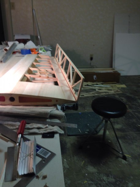

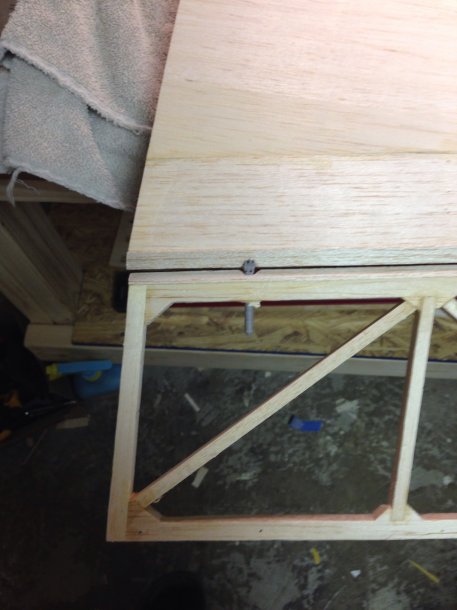

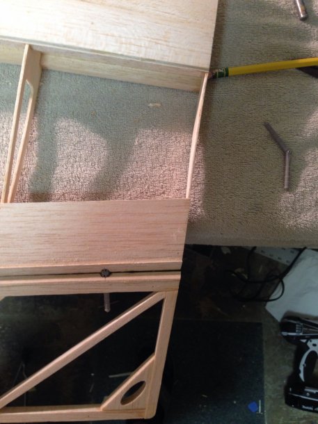

Is this gap ok also do I need more meat behind hinges.

I add another 3/8" sq. scrap to double the thickness in the hinge area. Just cheap insurance. Gap looks reasonable. Doesn't have to be perfect just close and even.
kwj48
On the bigger stuff I usually put 2 on each end a few inches apart then go from there. I think I have 8 or 9 on my 50cc.
daman691003
I totally messed up one ail doing hinges. I'm using the robart tool it's just not working out. I might need to cut of trailing edge and ail leading edge
Alky6
FWIW, on the EF 78" Extra, I believe there are only 5 or 6 robart style hinges on each aileron. Haven't had a problem.
