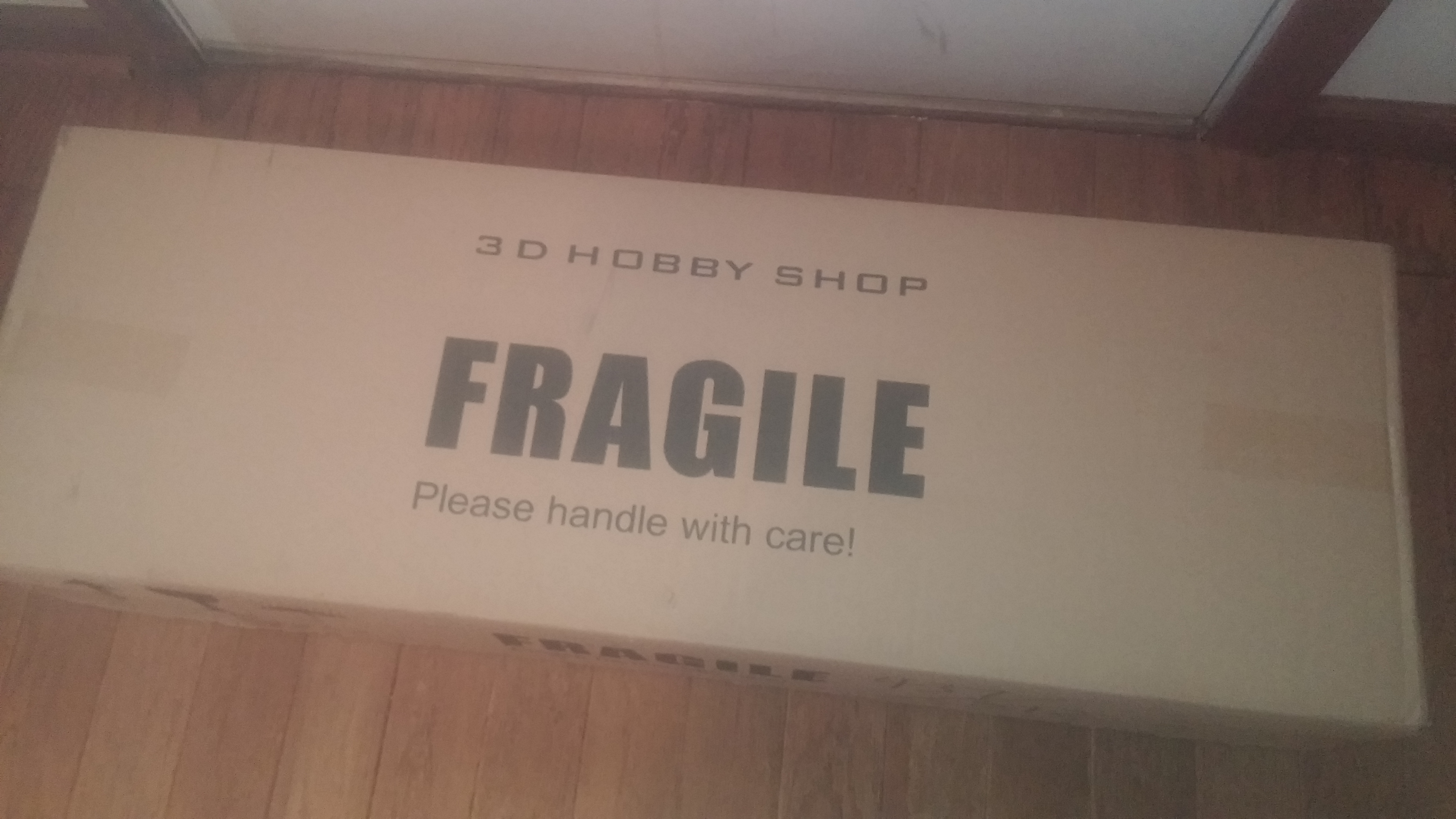

I got a major award. I think its Italian!
