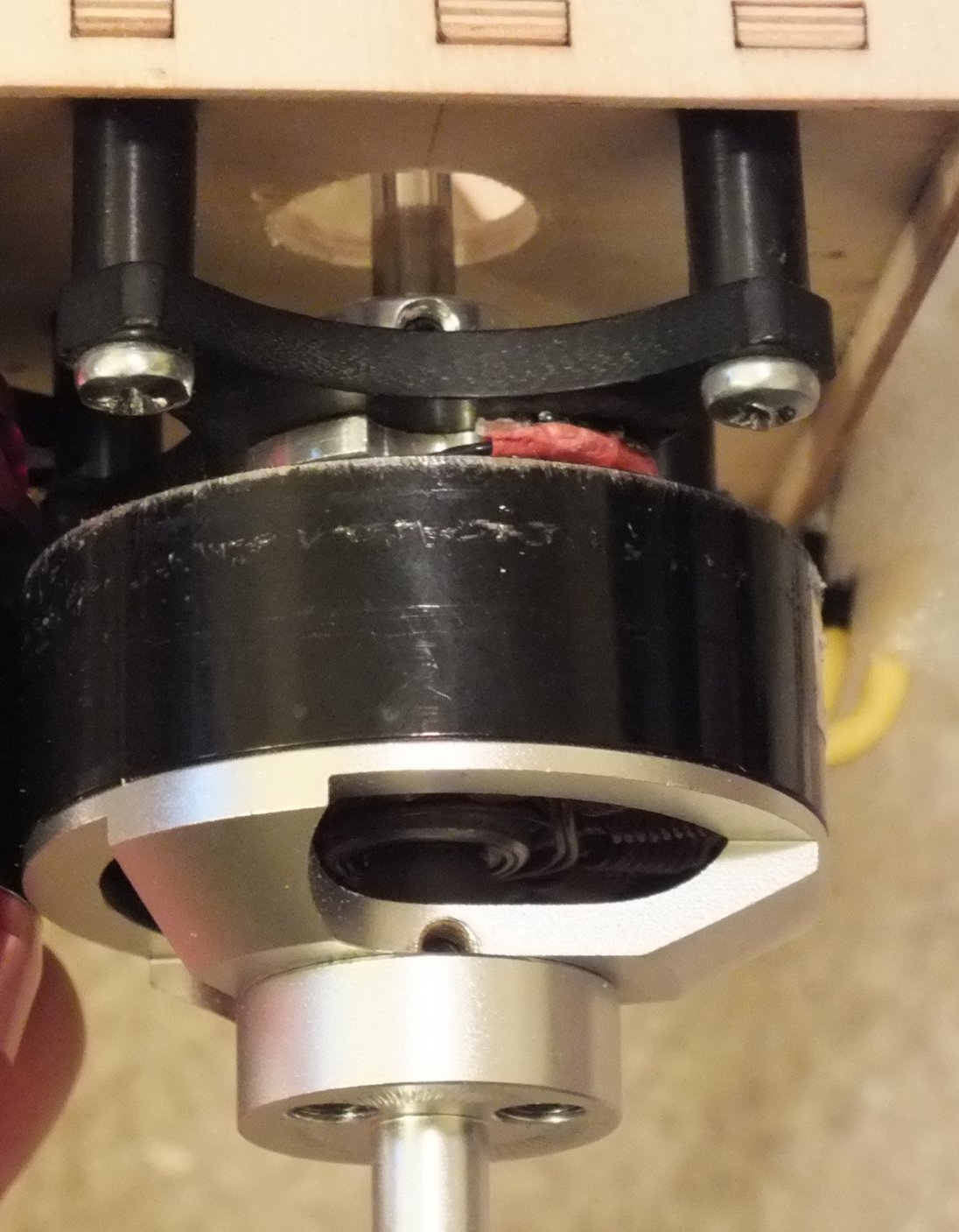

Any pics of the install with the motrofly? Head to lowest now
Due to the Motrolfly's short bell, you'll want to space it away from the motorbox as pictured

I think I bought the wrong ones.. I got 1/2 X 1/4 and 1/2 X 1/2.
Do you remember the size? Yours looks bigger (that's what she said)
I believe you'll want to go with 5/8 in length. 1/2 might work though, you just may have a little more cowl overlap on the fuse.

1/2" long standoffs work fine on the 4315. That's the size I'm using.

Thanks guys one more question, at least. After putting the spacers on the motrofly I need to replace the cap screws that were in with the plane. Can someone confirm that they are metric m4? Lowes doesn't have any cap screws, can I use these?
They are either M3 or M4 (can't remember). Picked up longer screws at Ace Hardware. I also found that I had to put the longer screws through the X mount, then attach the X mount to the motor. There is not enough clearance to slide the bolts through the mount while it is attached to the motor (using the fiberglass mount).
