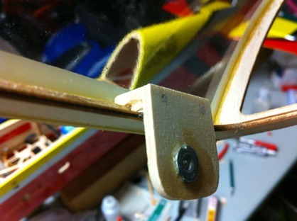

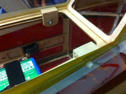

As far as canopy attachment using a 4/40 or 6/32 look a slick 89 inch canopy attachment or any plane that uses bolts at the rear on each side you will have to make some wood pieces and make some lite ply pieces of wood and glue them in . It would really be easier just to look a plane as I said before instead of trying to explain the process. Its not that hard if you find some close up photos of the install with a plane that uses that method . Hope this helps I forgot mention on the inside tabs that you would make use 4/40 blind nuts or 6/32 blind nuts to have a secure way of screwing the bolts into the tabs of wood to hold the canopy on.
