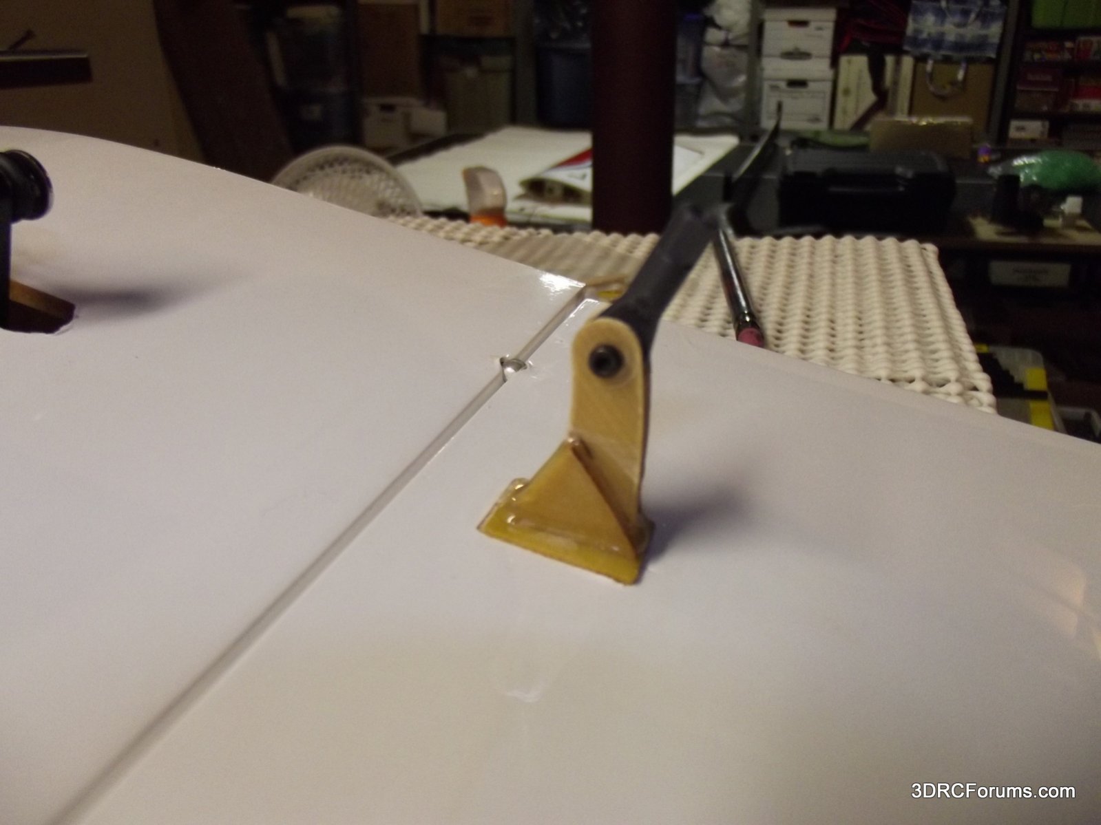

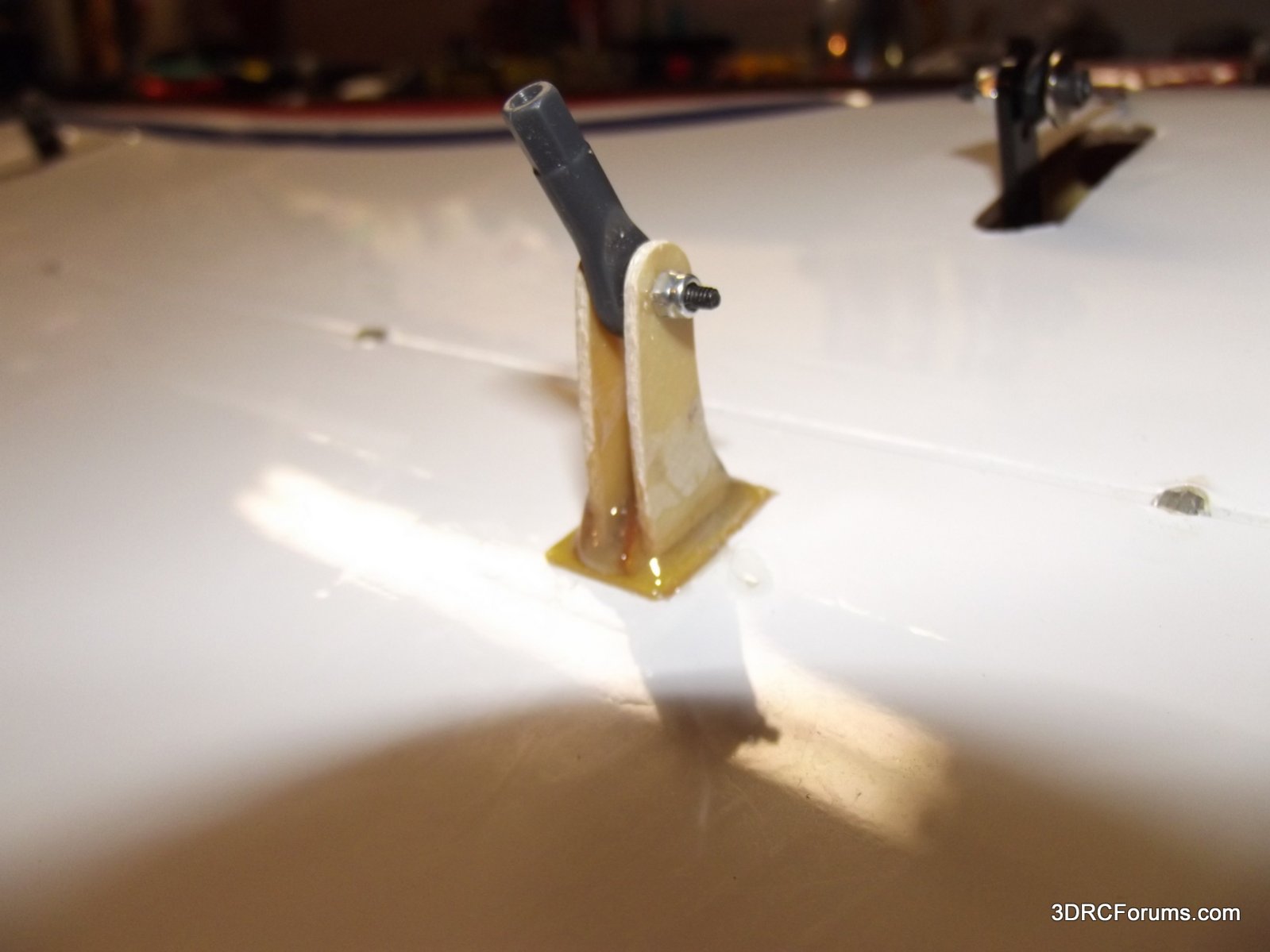

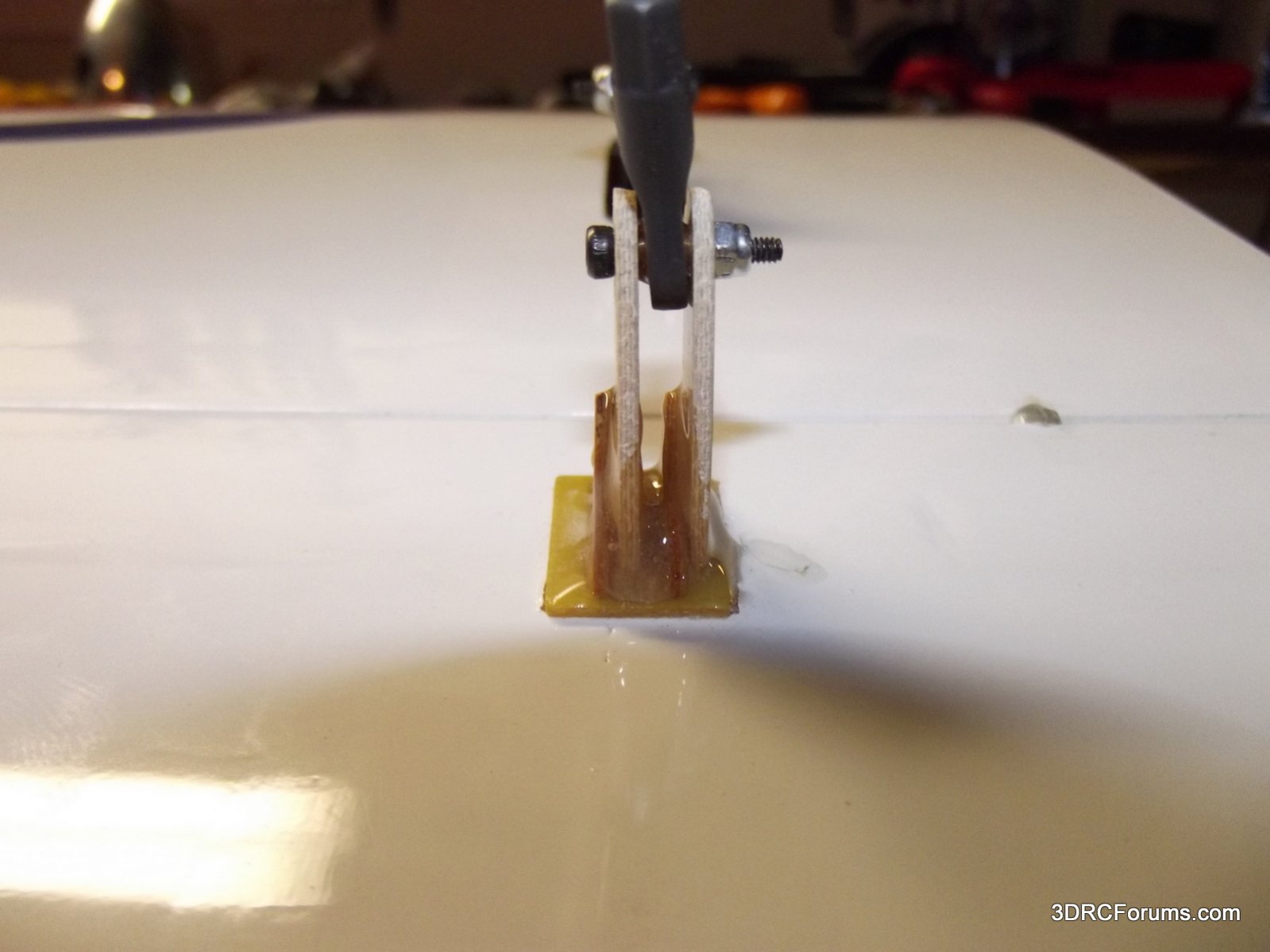

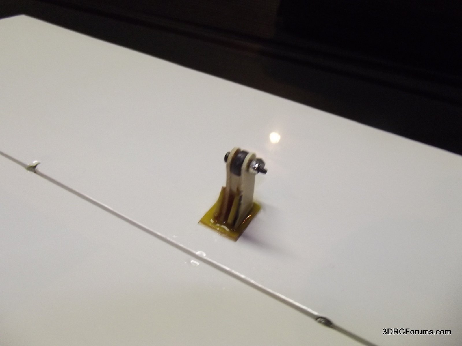

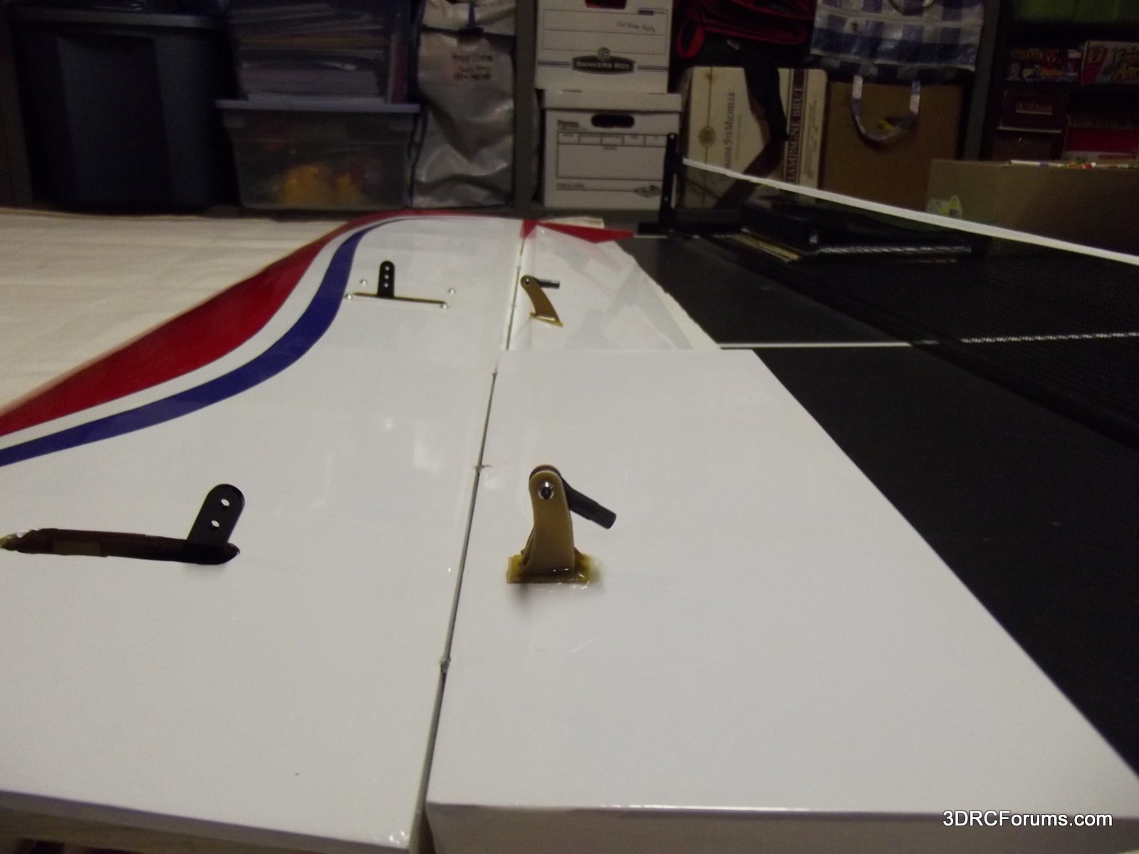

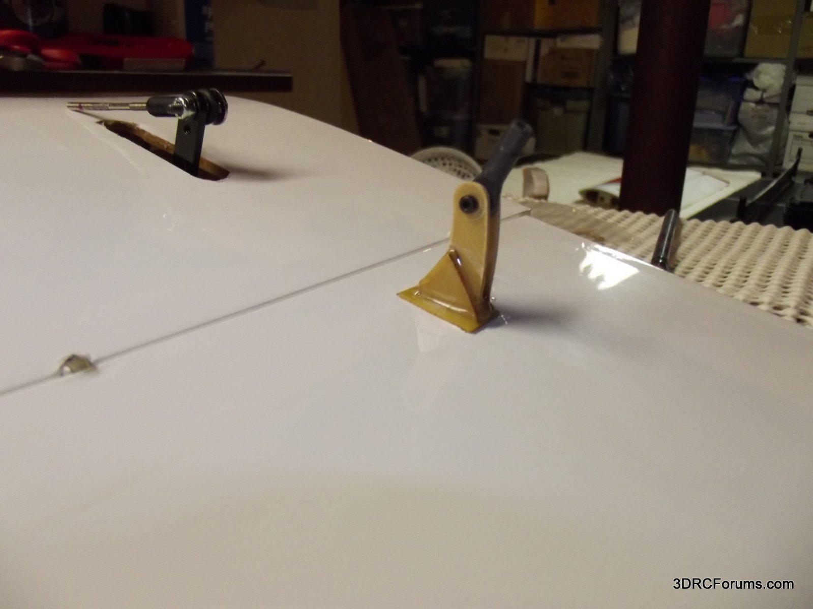

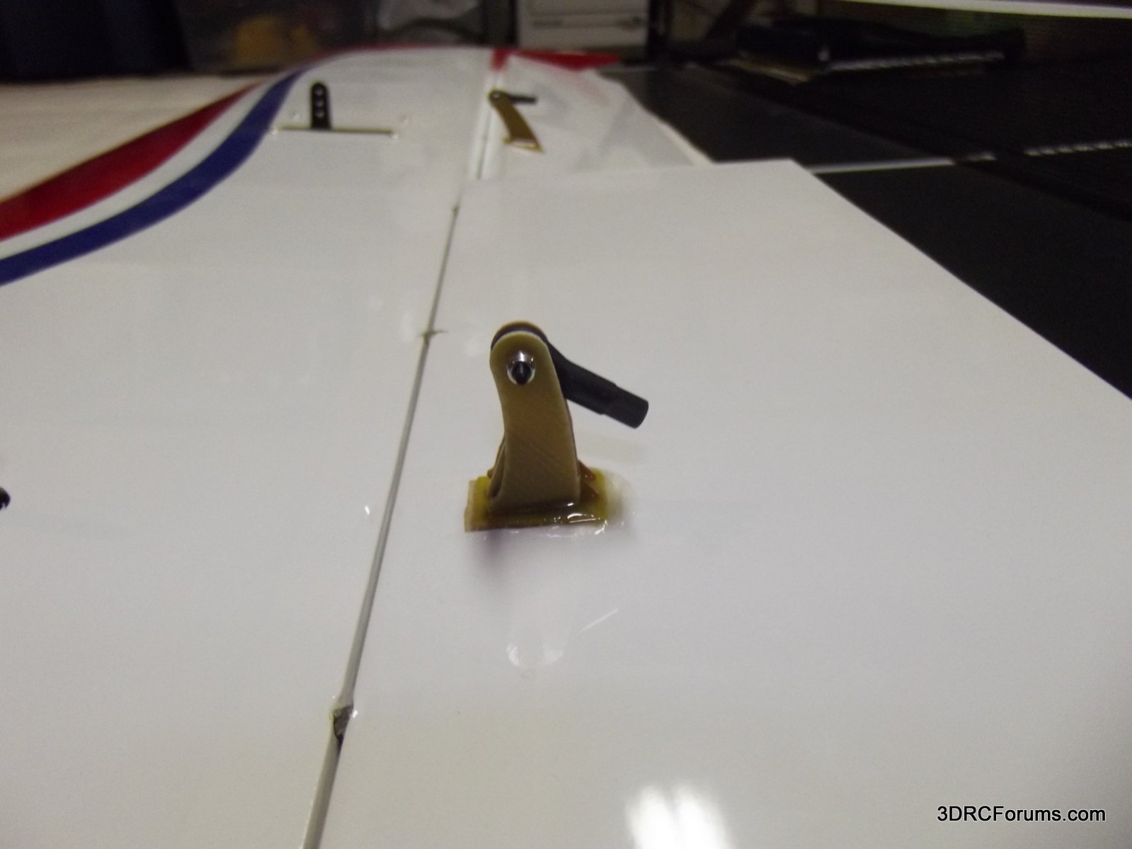

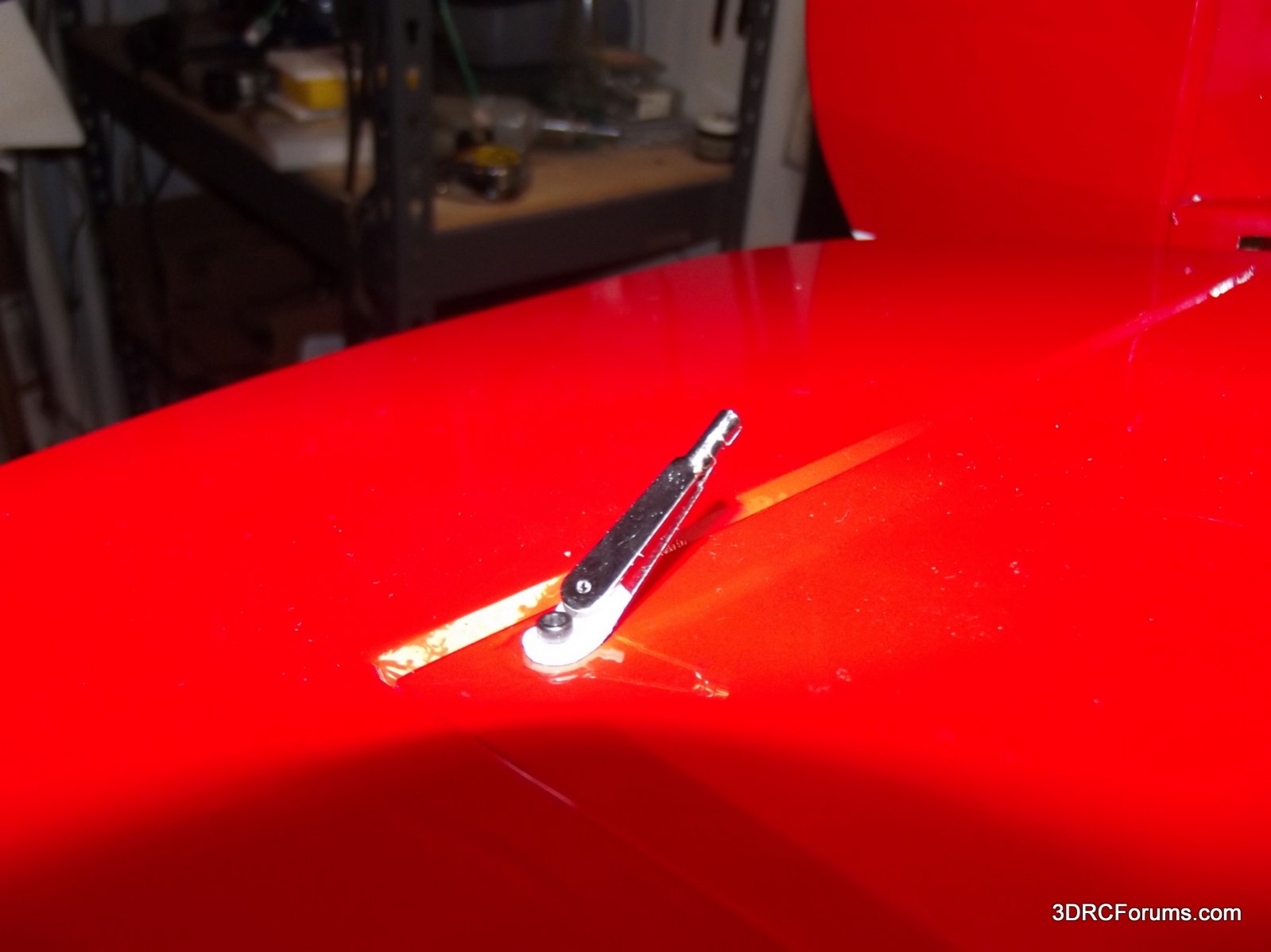

okay so yesterday after I posted my pics, Gary reminded me that I was going to install the flap control horns in the opposite direction from what the manual states because of geometry and servo issues that have been reported from the field using the stock setup of the flap control horns. So I needed to figure out a way to "reverse" them! After a bit of thinking and some experimenting, I came up with the following solution:
I used some extra control horns, and cut the base of them off so they would sit almost straight upright. Then I cleaned up the existing horns by scraping away the epoxy I could reach, cut them down flush with the new ones, then epoxied the new control horns in place:
Once the epoxy dries, I will probably place a small screw or two in the base of the control horn for added strength, although I think the epoxy should be quite strong on its own.
This setup issue should be addressed and revised in the next version of the product.

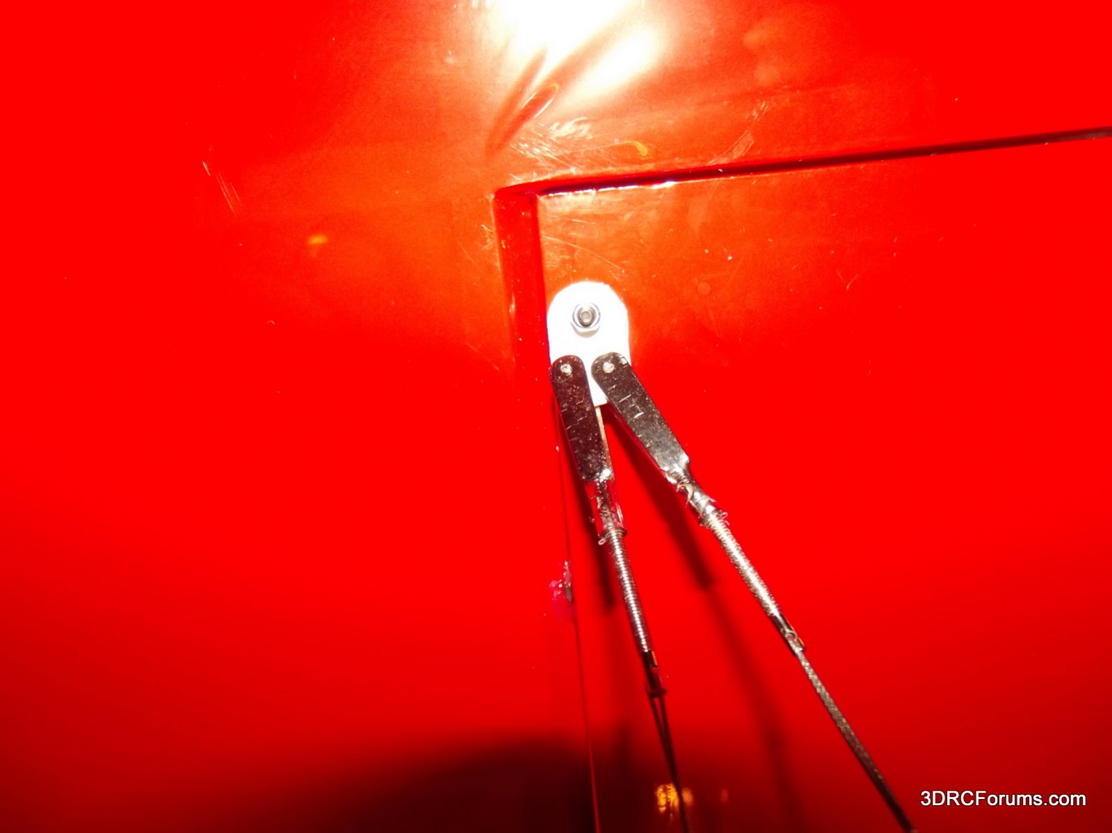

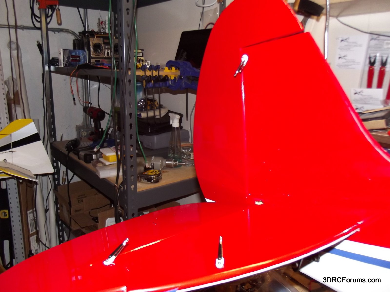

SnowDog

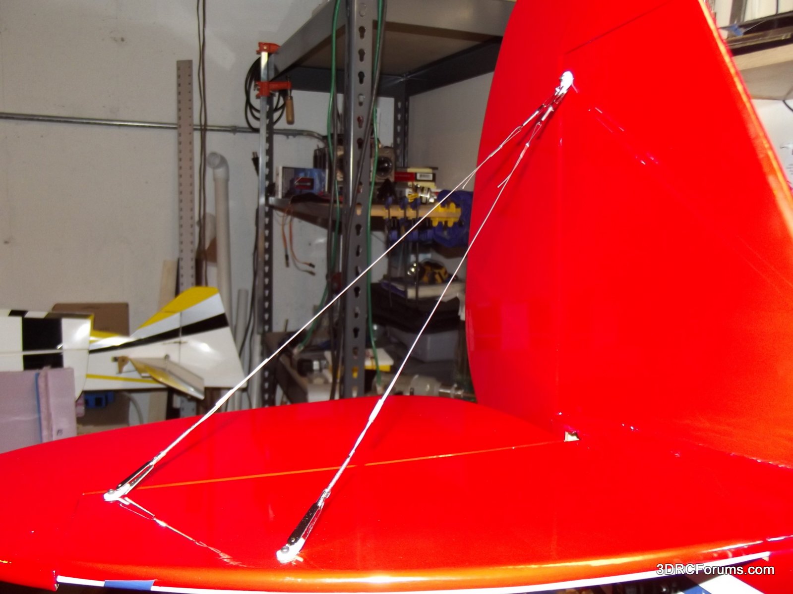

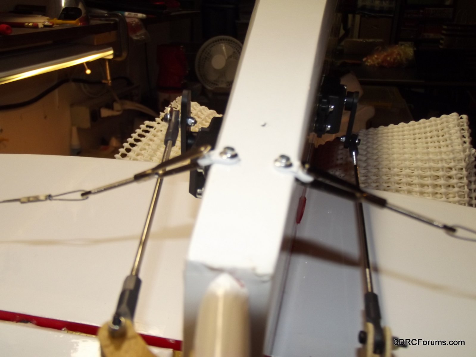

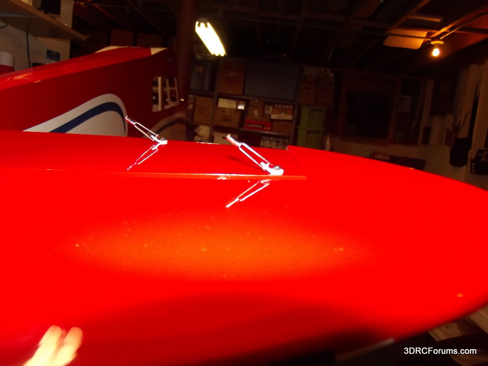

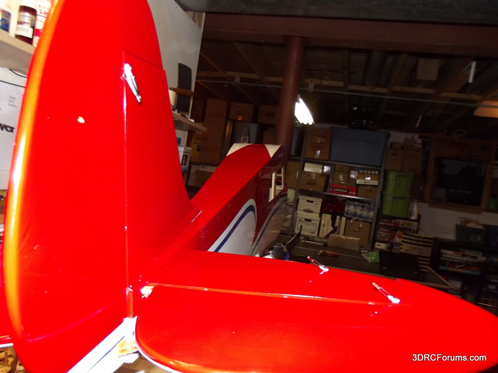

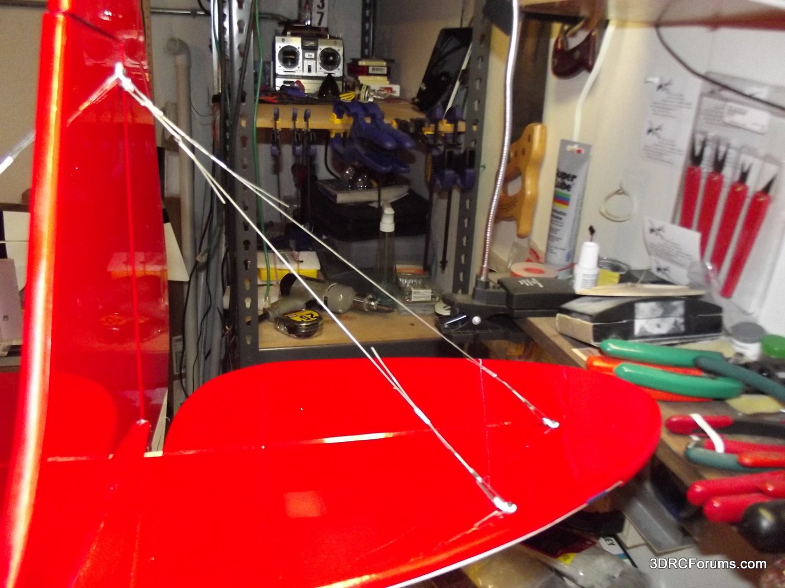

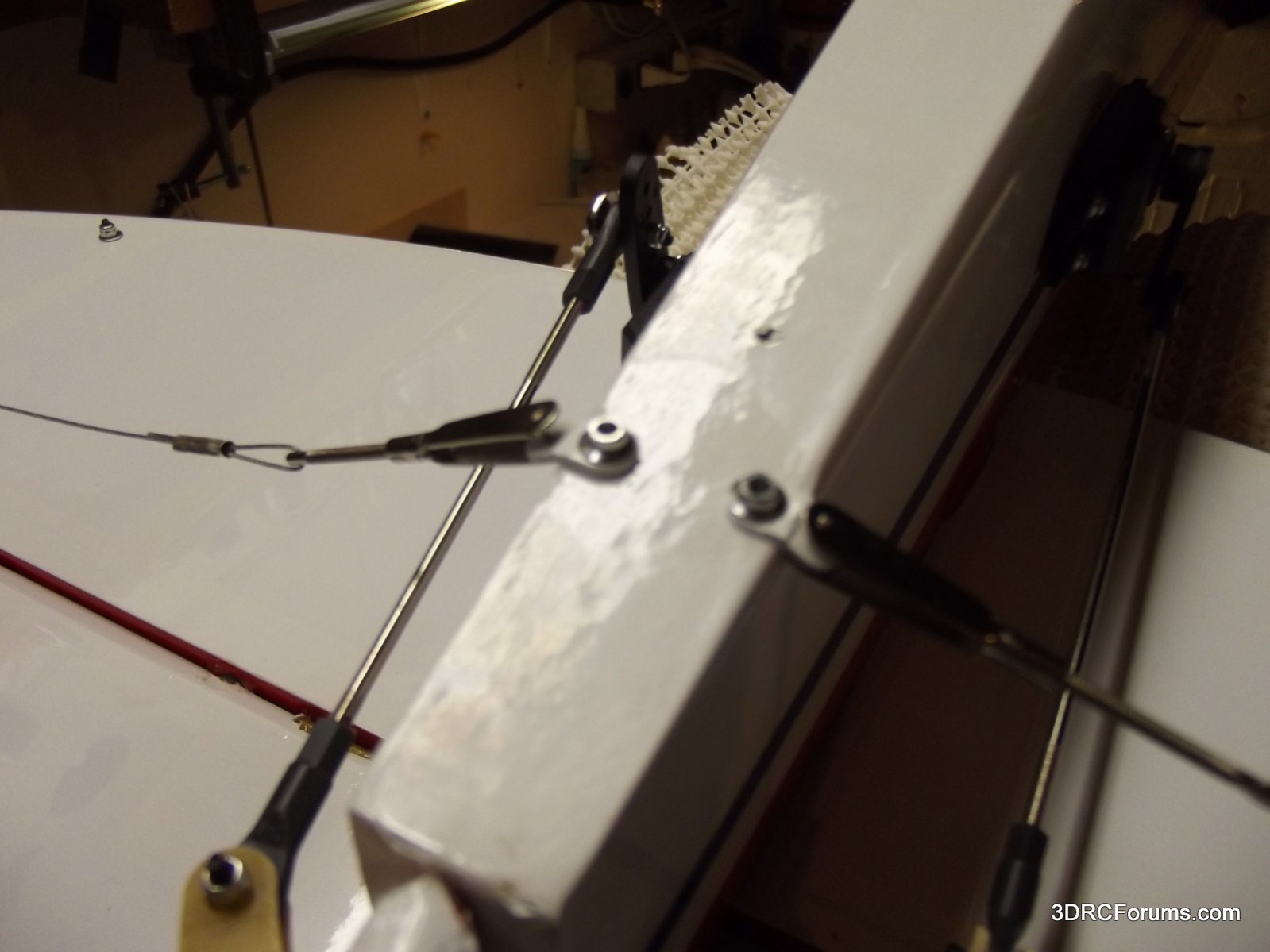

Finally made some more progress. Installing the tail wires was a tedious process, I must admit!

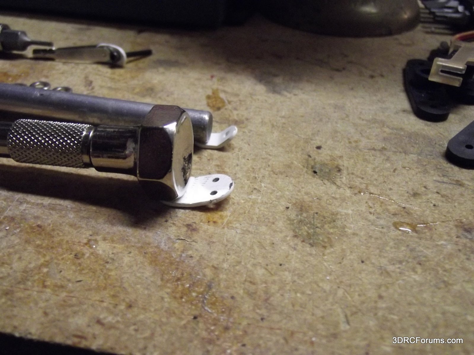

first I installed the plates and the clevises:
some of the plates (especially the top plate) needed
more bend in order to line up with the clevises on the horizontal stab tips...
out of the box, the top plates had approx a 22deg bend when then needed to be 45deg.
had to tweak the plates on the bottom of the wing to reduce the angle on those from 45deg to 22deg.
now the clevises and plates are installed, I can install the screw rods and begin putting on the wires:
DSCF1062.jpg View attachment 17733
The end result:
Next step: the motor!

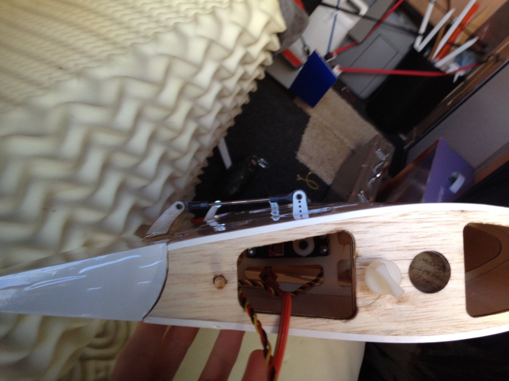

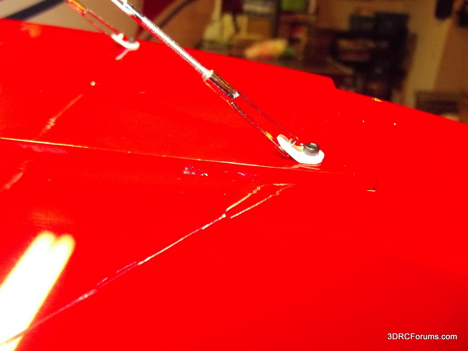

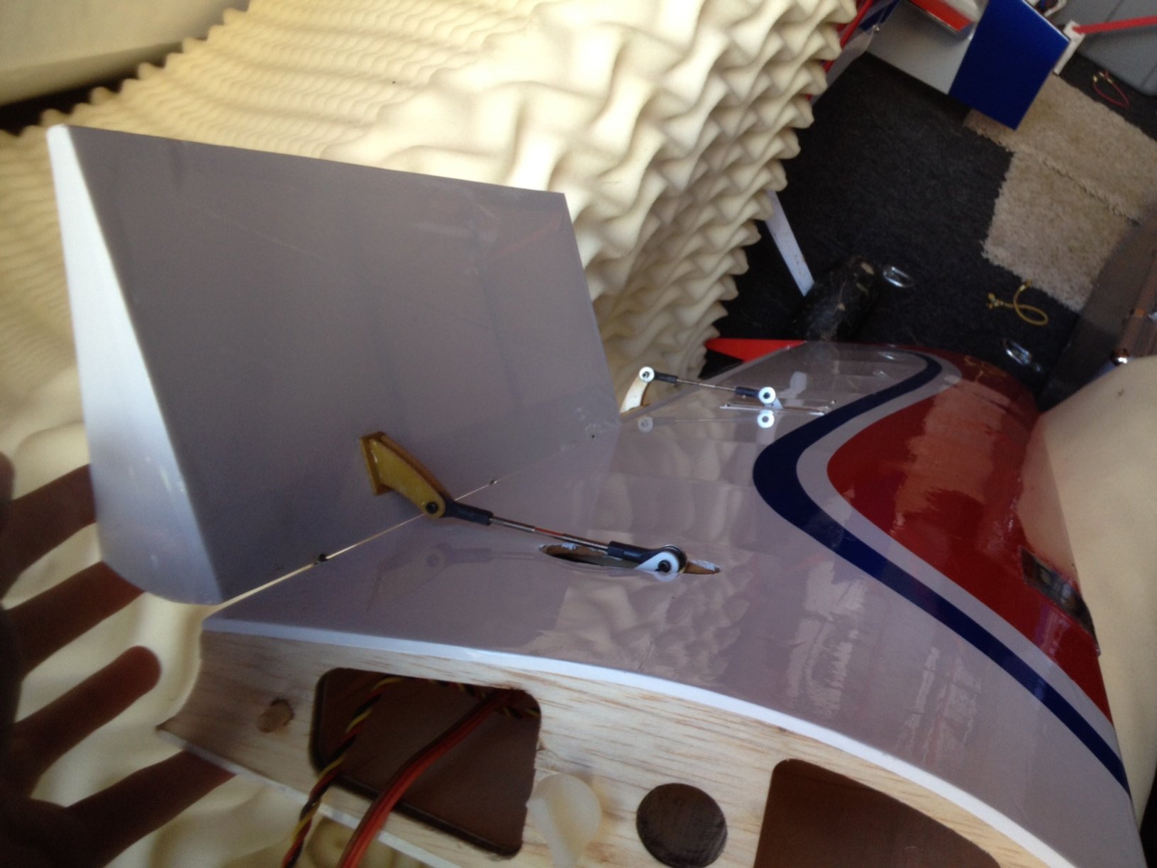

RC Girl

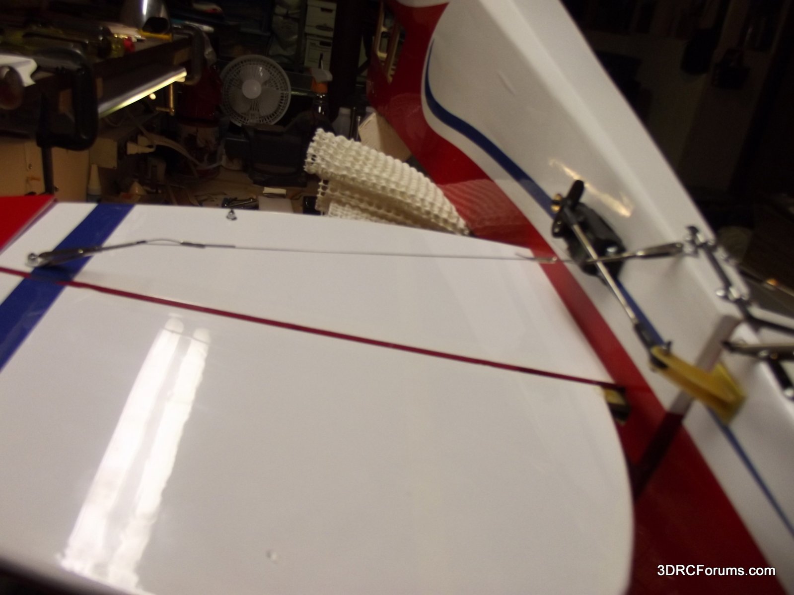

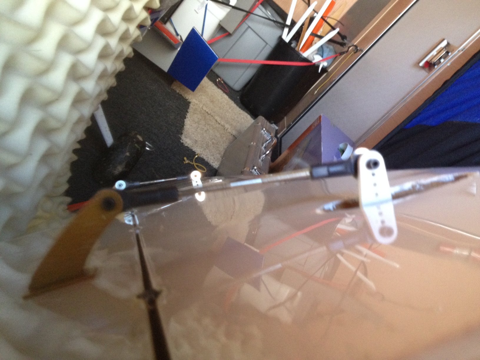

Here's a few pics of my flap set-up. I'm using Hitec Hs-7955TGs and haven't had any problems except the servo arm screw coming out a few times... don't know what that's all about...
But, I haven't flown with the flaps too much yet, so we'll see how it all holds up

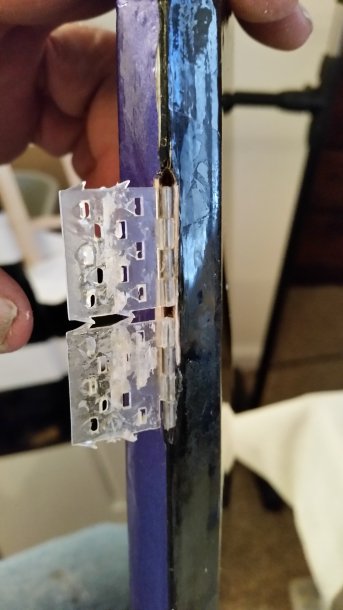

Sarlacc
I have a few things that may help/hinder you a little.
I have flown my foot pretty hard, and a few things I noticed was the elevator joiner failed. Actualy split away with part of the elevator attached to it. I reglued it with some heated 30 minute epoxy so it would penetrate the cracks and splinters real good. before that happened I had 3 of the 6 elevator hinges fail. I hadn't done any tail dragging, or tail touches. My door blew off, as a result of a single latch up front. I was going to replace the CA hinges with some pinned hinges, but haven't bothered yet. Someone said something about cutting some holes in the fuse or leaving a few windows out to counter the vaccum effect, but door or no door makes no difference to me. It is one less thing to bugger with when i am putting my wings on.
I run my flaps at near full diflection most of the time, and I haven't had any issues with the hinges or control horn like others have had. Time will tell on that I guess.
