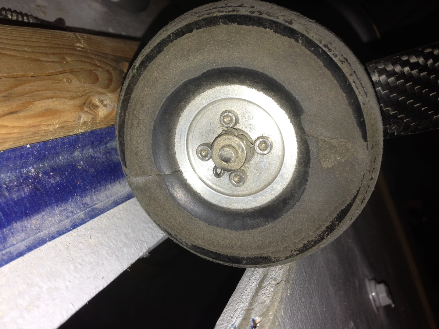

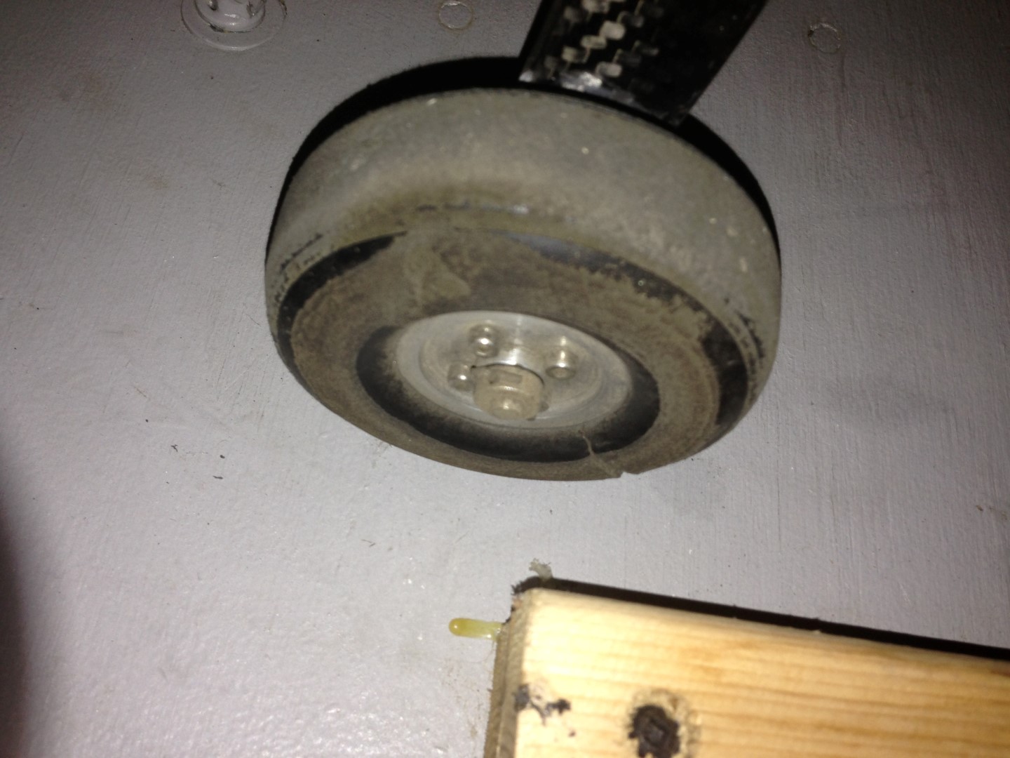

Had a wheel fall off on mine again. Talk about crappy luck. Was able to make another wheel off landing on the grass field without incident.
Going to follow Jim Smith's advice, and cotter pin the damn things, this is ridiculous!

ouch! Whew,glad you got her down ok again. Throw up a pic of your cotter pin upgrade if you dont mind when you get er done.:banana:
Somewhere I thought I had a picture but can't find it. I'll try and remember and shoot one. But it's simple. Drill a hole in the collar while it's in a vice. The collar is fairly soft. Locate a couple small cotter pins to get the hole size down, maybe 1/32 or so, not to big. Then lock the collar on the shaft in the proper position. Drill through the holes you drilled earlier. Install cotter. Enjoy knowing you will not loose a wheel anymore. I did mine on the 87 and 103 in the initial build.
Yeah, that is exactly how Jim Smith described it to me... I've just been a little lazy about getting it done.
Would still like to see the pics you took though.

Easy as this!! I need some new rubber!! Actually that wheel pant has rubbed off and on since I pinched it on the maiden! :) Also the gassers time is about 99% on concrete. wheel-pin (1).JPGwheel-pin (2).JPG
