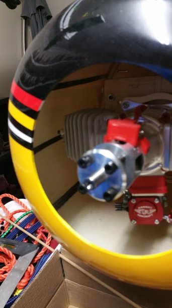

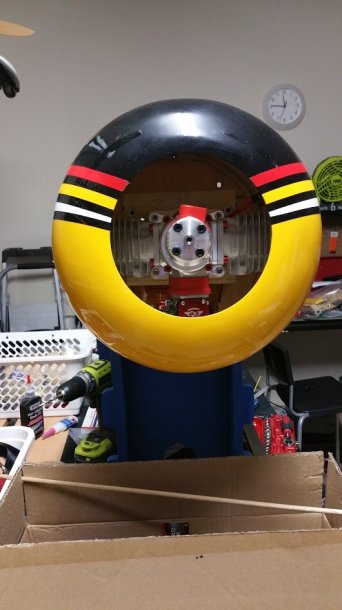

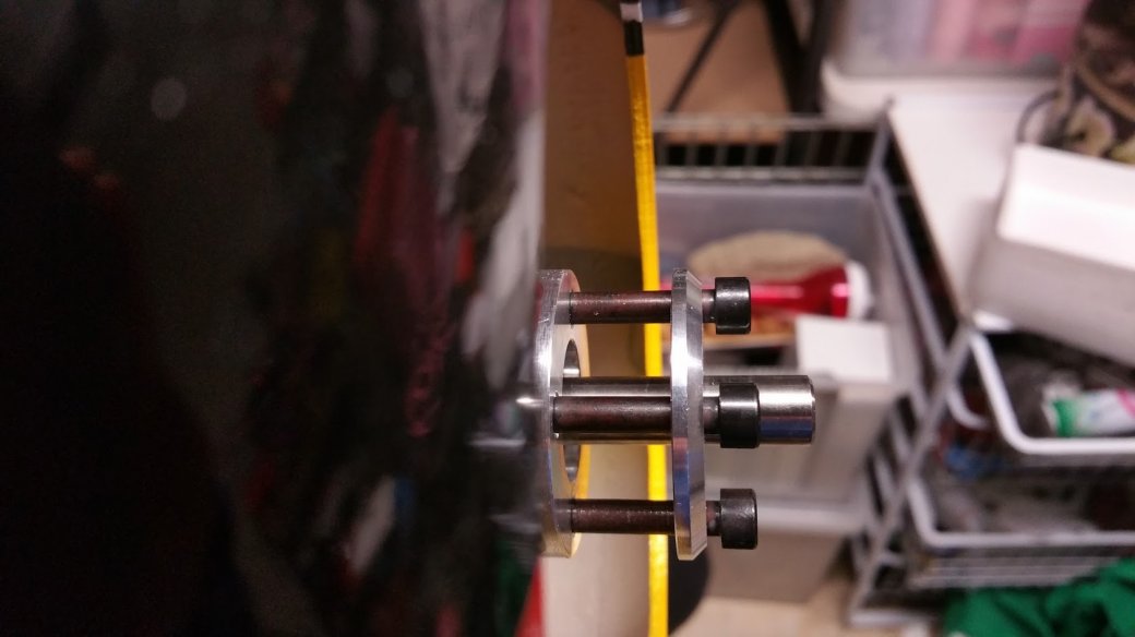

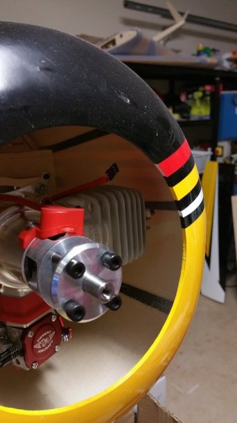

Sorry for the slow build guys, its been hectic in my house, working 7am till 6pm and its a mentally draining job so I can't find the energy to do any building when I'm home
I did get some work done though, I had to beef up the firewall a touch to pass AU's heavy model criteria so I used 3mm aircraft grade ply and hysol'd a plate onto the front of the firewall with some carbon square tube top and bottom to brace, will get a photo soon, and I did get around to dry fitting the DA70 on the beast this weekend though, doing my usual mistake of drilling in the wrong place... where did i leave that dowel LOL
but once i drilled properly it looks good, I just need to adjust the mount thickness to match the cowl, I'm considering not having a spinner on this bad boy but will decide after its all mounted up, I need about 1/2" more space on the mount to get it to line up
