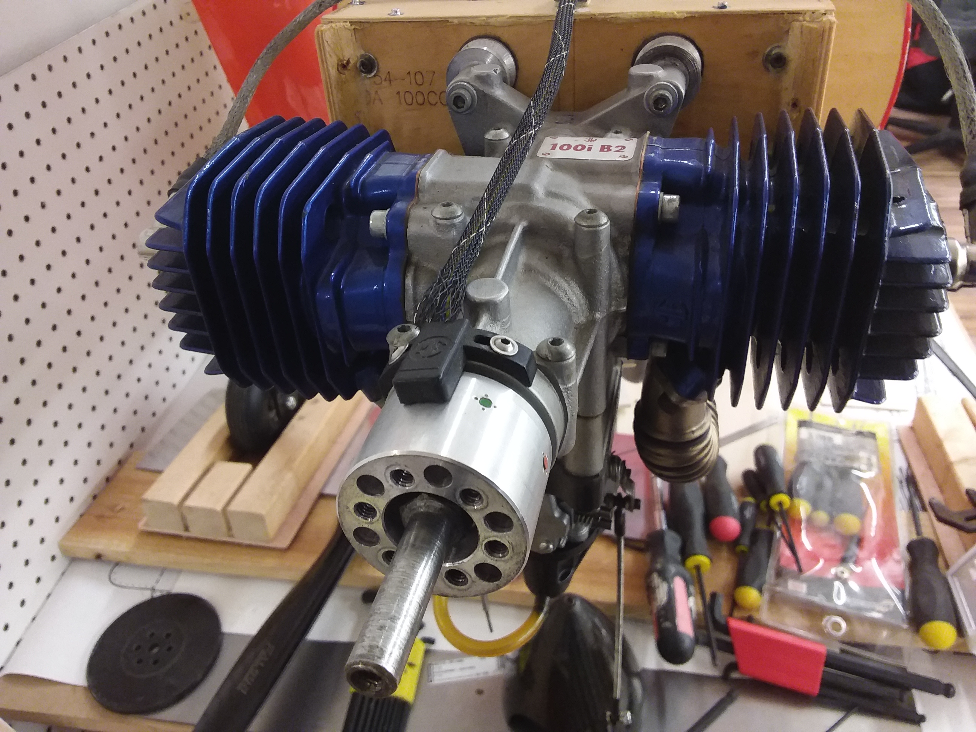

    Think I found the problem, a crappy plastic arm from years ago. Aluminum one in the mail. I'll add a photo of my long time pal, my 106.
  5. dhal22
    dhal22 GSN Sponsor Tier 1
    Yes it says 100 but it's a 106.

    Ok I know what the red is and the classic but what gives with the blue heads seen them before but what does it mean.
  7. dhal22
    TOC engine? I don't remember. Extra porting, balancing maybe. I've had the engine at least 10 years, probably 12. Choke, flip, flip, pop, unchoke flip, flip, running. Year after year after year.
