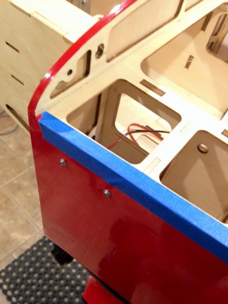

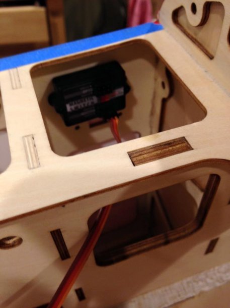

With the Jeti magnetic switch...I used the hole that is there for a normal switch....and placed the LED in the hole so it sits flush. (but did not remove the covering)
You can easily see the power LED through the covering. I did the same for my Tech Aero LED.

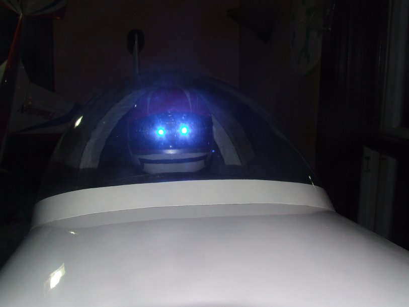

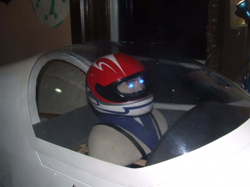

-Rick-
I did the Booma kill and redundancy switch. One switch for everything. And I put the LED's where I could see them standing in frout of the prop, I like to know if the ignition is on or off by just looking up while starting....
