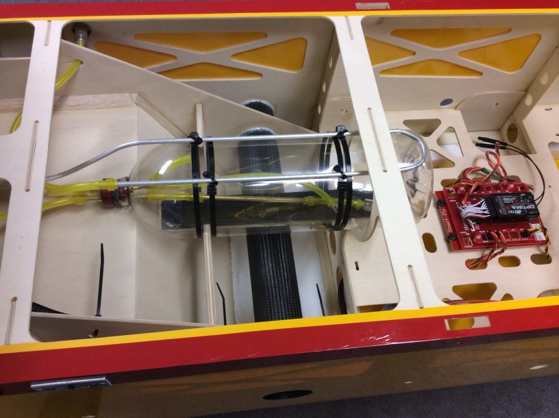

Flyrcjoe
ExtraNuts
Looking sharp Joe. I like how you used tygon made clamps over the tygon on the fuel tubing, I've never seen that done that way before. Very cool.
Flyrcjoe
The reseaon I do it is because if you use a zip tie it makes a pinch so that you can get an air leak. So the Tygon over Tygon prevents that air leak.
