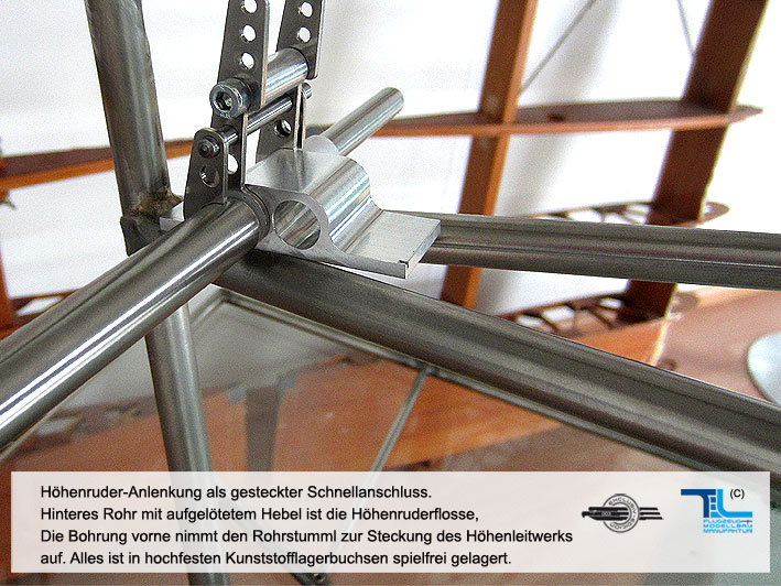

OK - here we have the solution for the elevator mechanism. Because youcan not build a servo in the
elevator you have to get a quick-link for elevator and elevator stabilator without a lot of rigging work....
The tube youcan see is normally the front tube of the elevator.

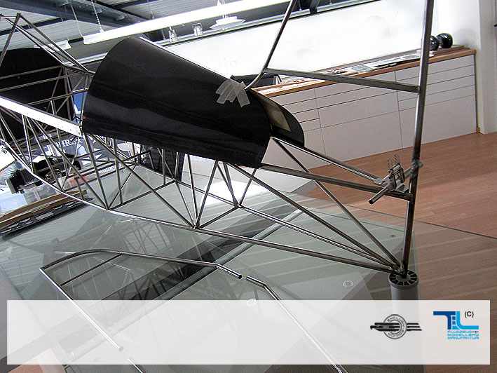

So what type and size of tubing are you using on the framework?
I'll assume it is all TIG welded construction, but some areas looked almost like they were brazed.
Keep up the great work!
TLFMM
All tubing are stainless steel very thin wall ( 0.3mm !) and everything is brazed with a spezial silver-braze material
and the perfect temp. in the flame.... All parts are done in "welding" jigs.
