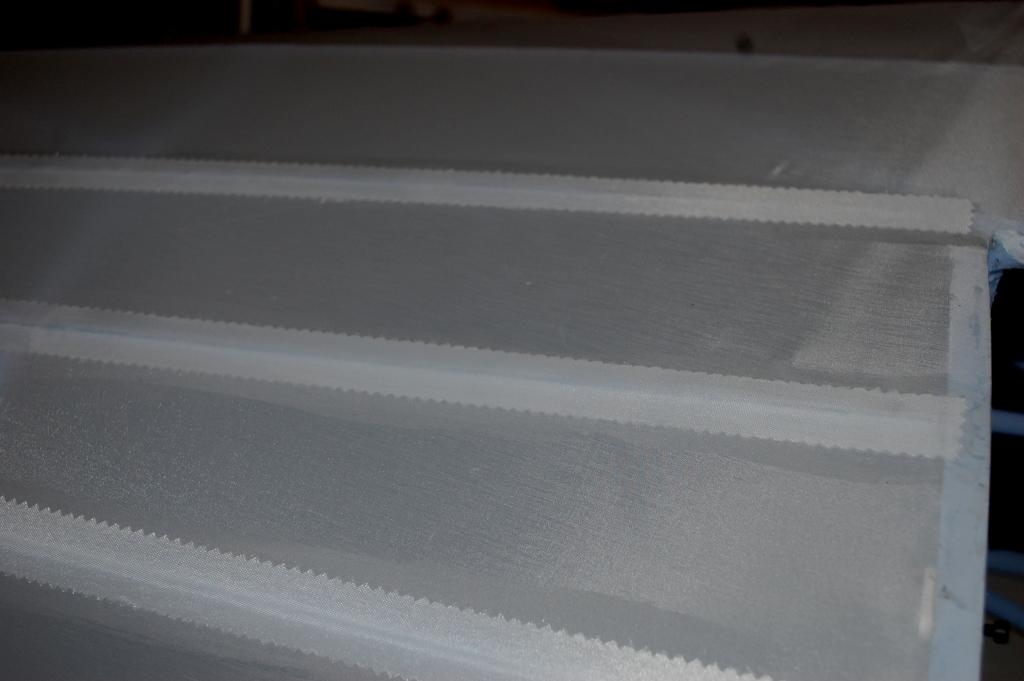

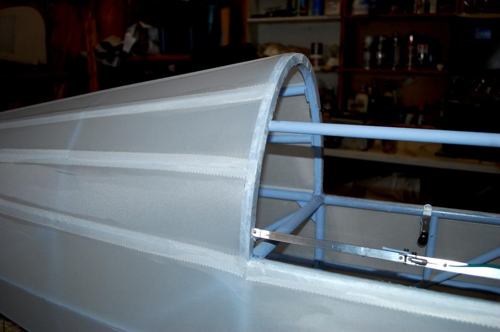

I'm glad you brought it up . I'm just about finished covering the fuselage then I will put the tape on, , ya it looks so much better
OK final word on the pink tape, Ray Ordorica , the owner of the one and only Dalotel has been really helpful with the pictures of these details , he is presently restoring the original Dalotel, so Thanks very much again Ray , your a life saver

Put the tapes on after the first coat of Poly-Brush is on the piece (fuselage, wing, etc.) and apply them using Poly-Brush, not Poly-Tac.
Its a start
