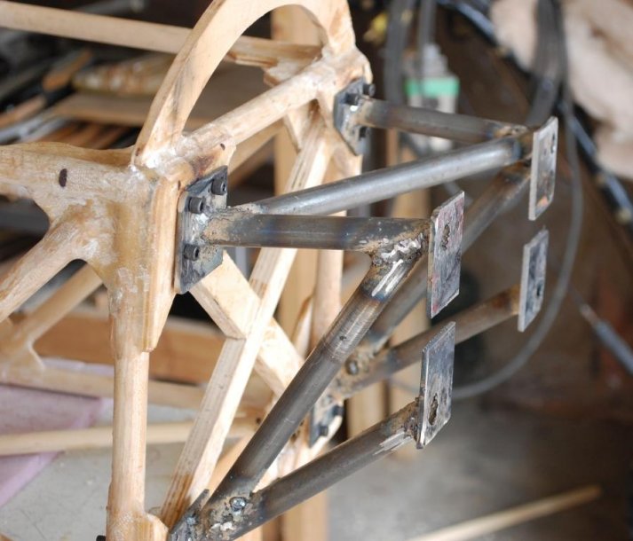

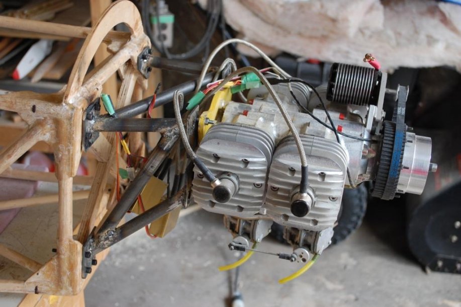

engine mount welding done, not the nicest looking but strong, trial fitting and then to clean it up and paint

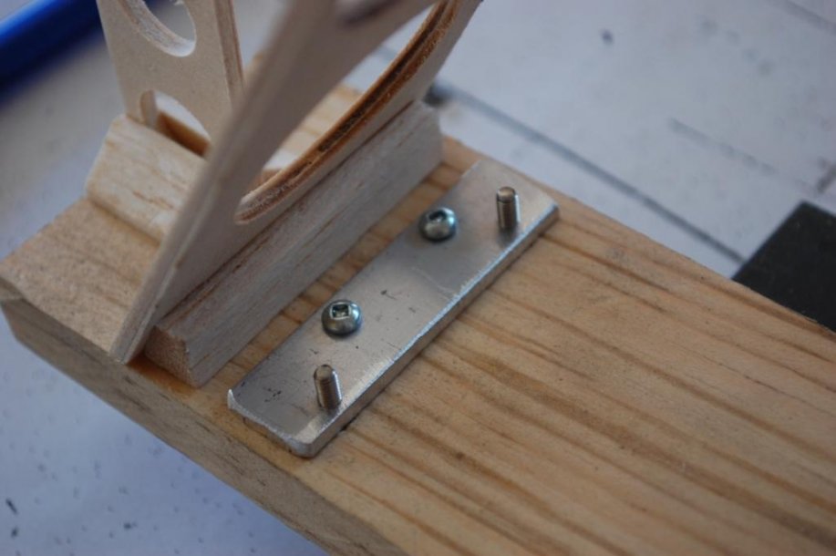

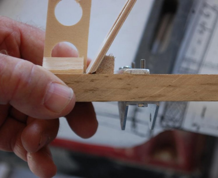

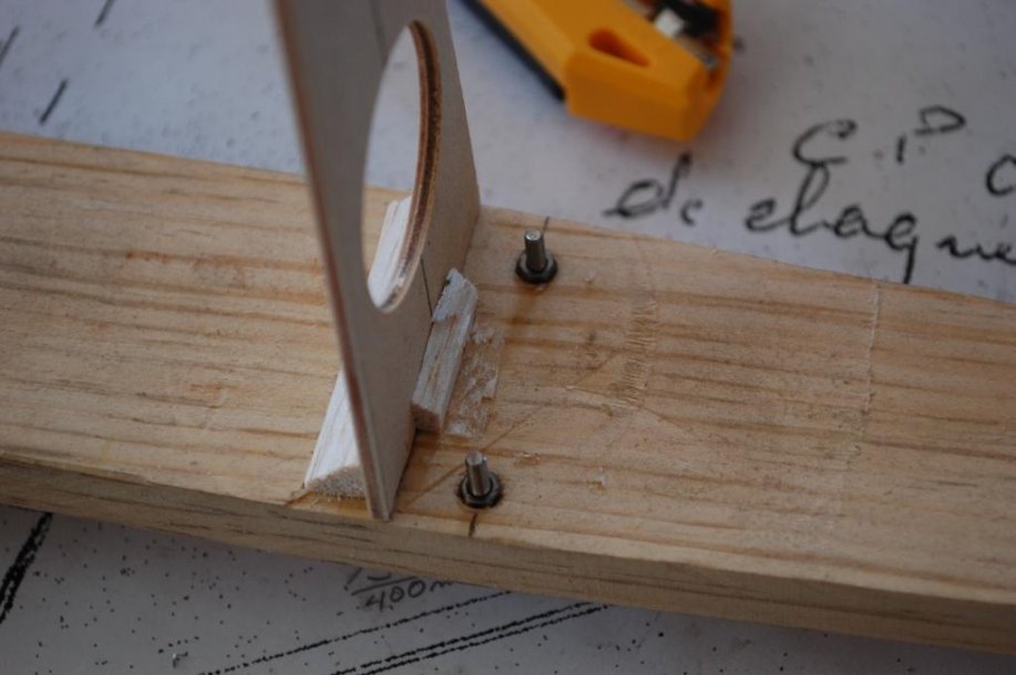

replacing the hinges hold down nuts with aluminum plates which is secured with wood screws on the inside
