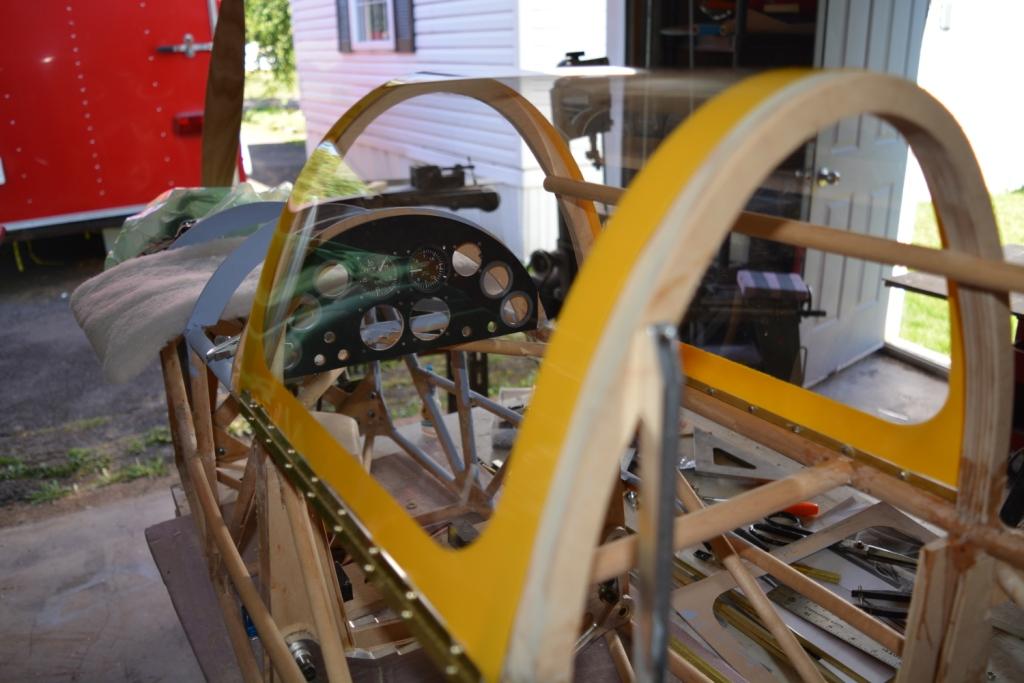

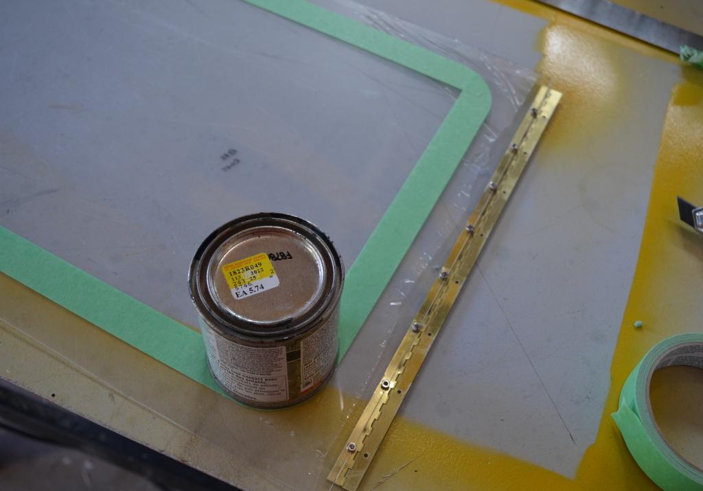

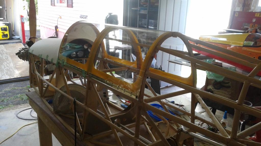

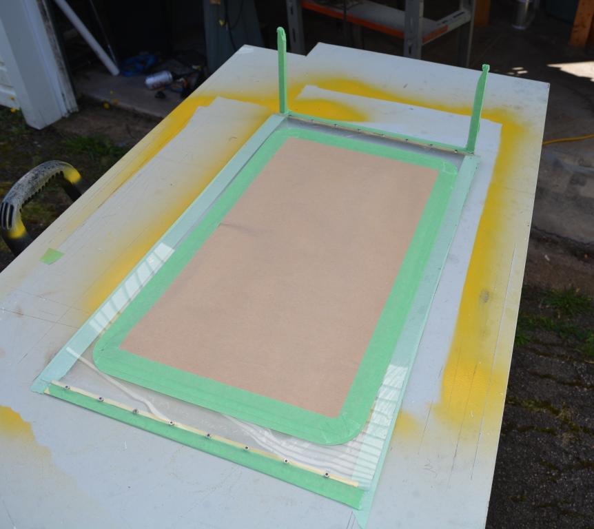

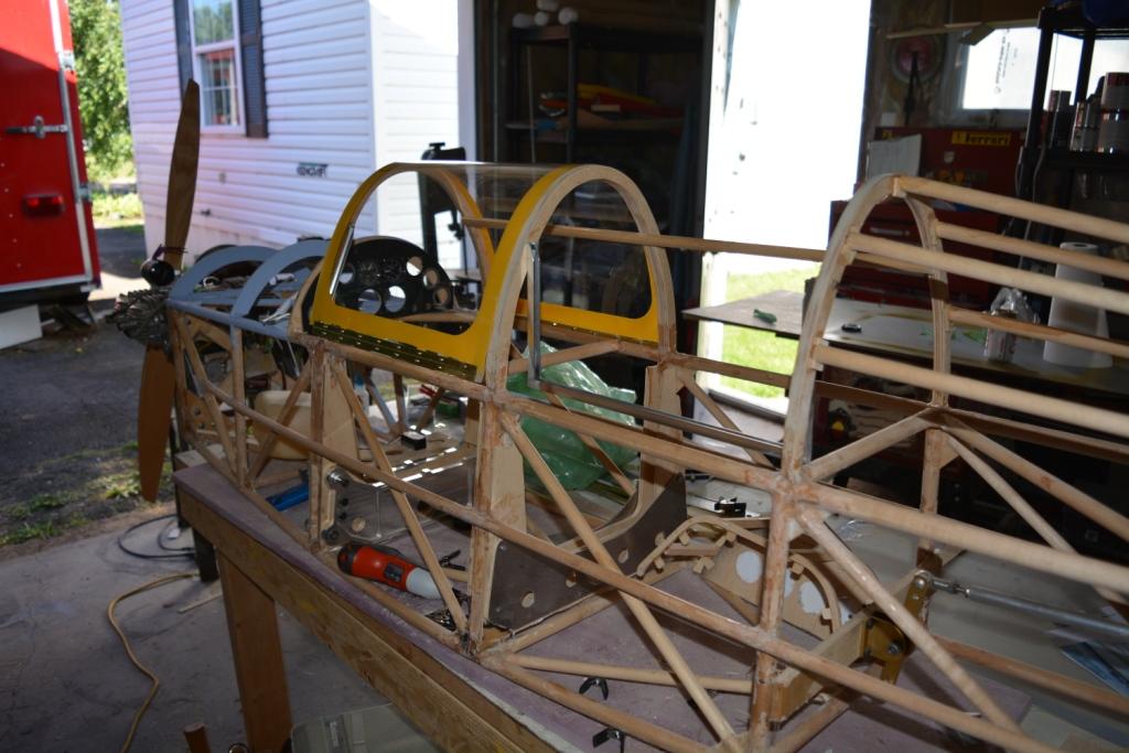

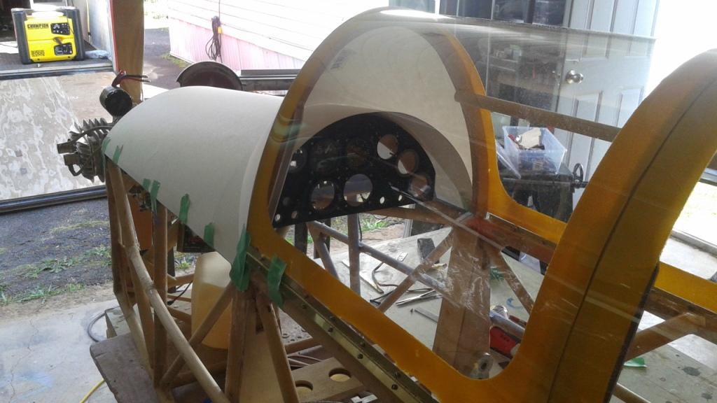

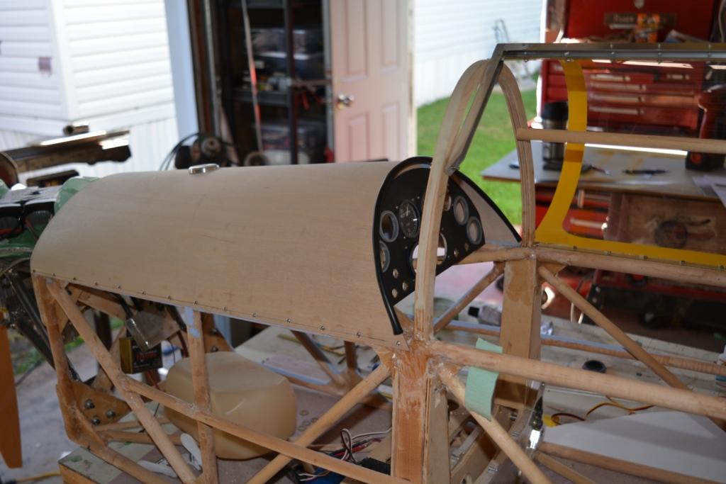

front canopy trim painted , but a few touch ups will be needed, but I'm happy as it works the way it was designed to work

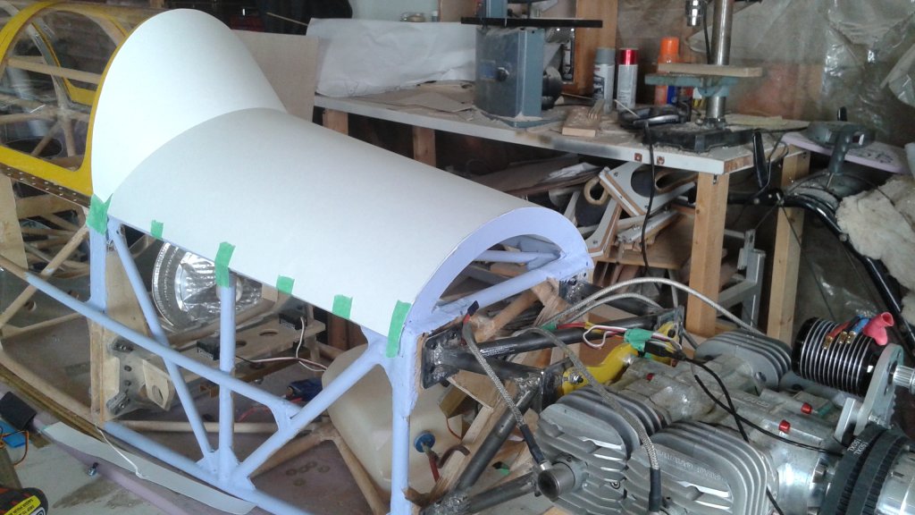

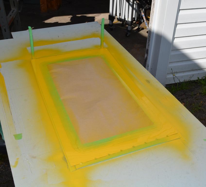

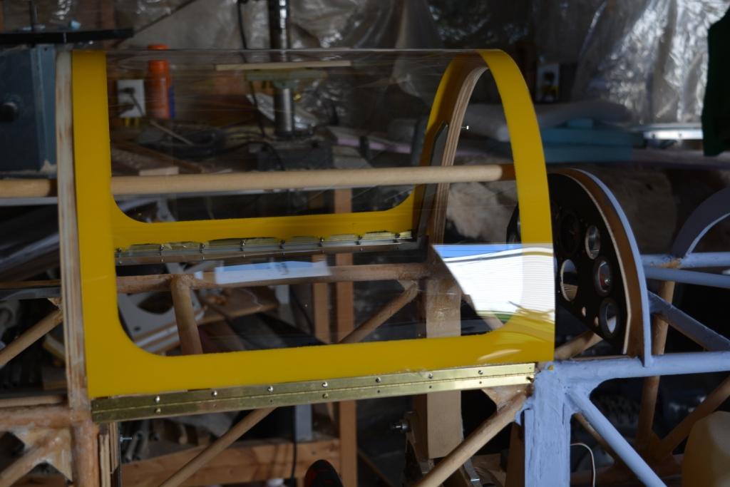

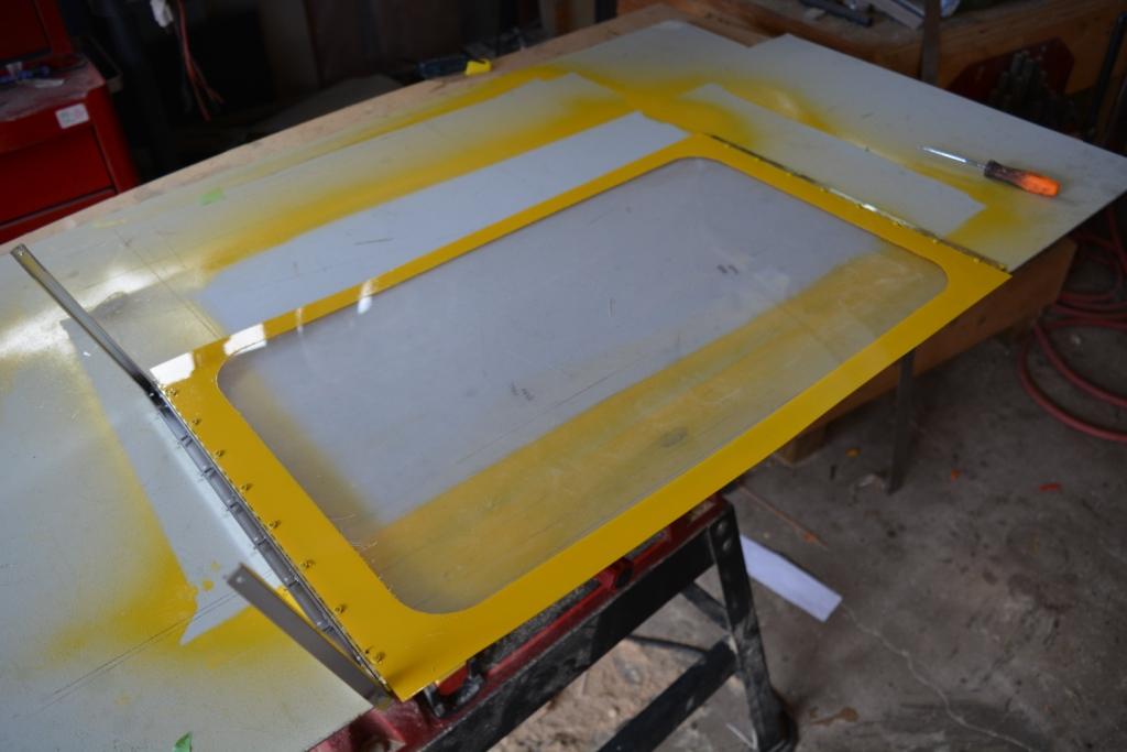

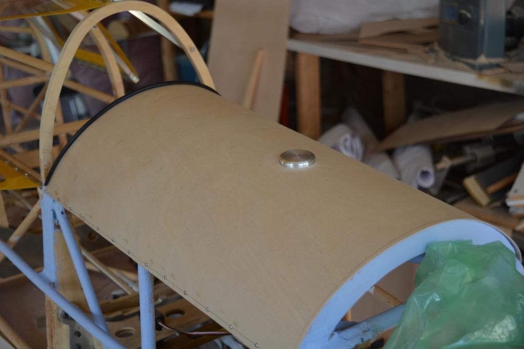

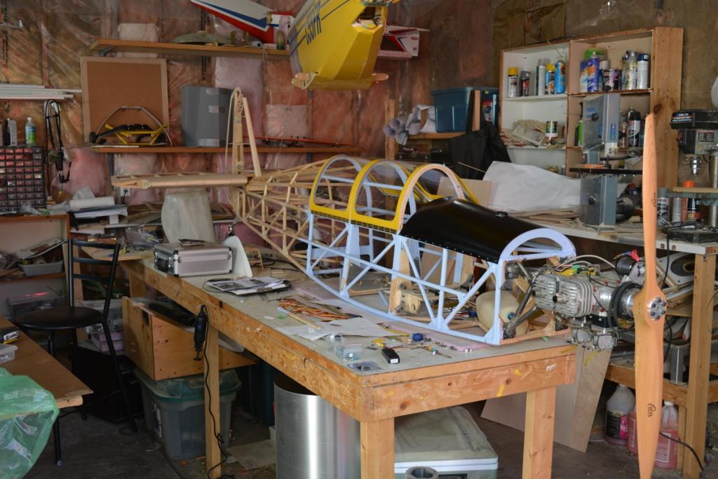

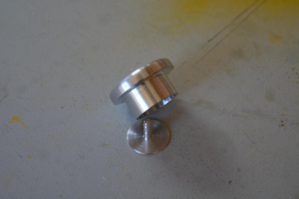

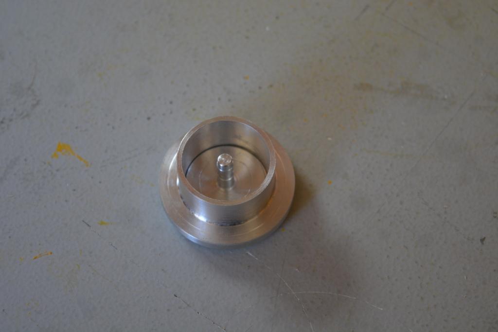

so now the 1/32" plywood front deck is in , will not glue it, but rather simply use screws as seen in the photo, other photo, is the gas cap with fuel line retainer . not finished yet

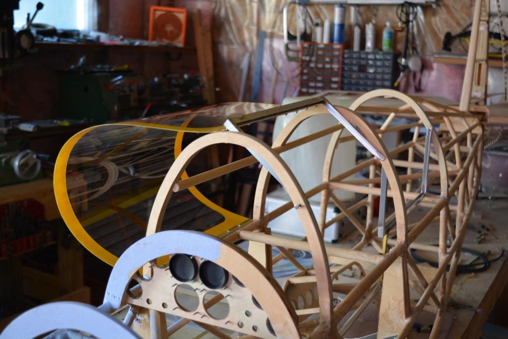

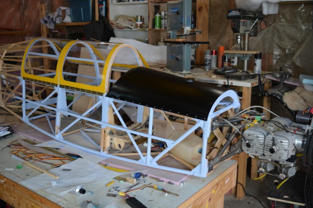

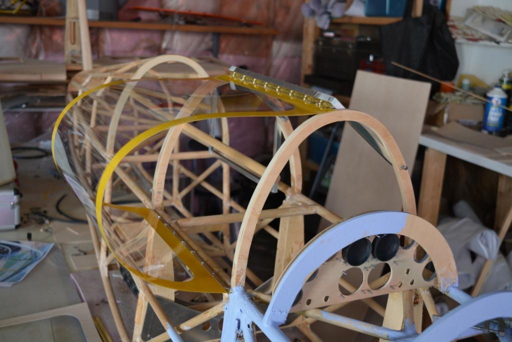

as you can see here the rear part of the fuselage will not be paint primer like the rest, since it will not be seen by the judges, and this primer bluish is what I can see on the color photo of the full size . Also the top deck is painted semi gloss black with the fuel cap installed, not sure if I should have painted matt black
