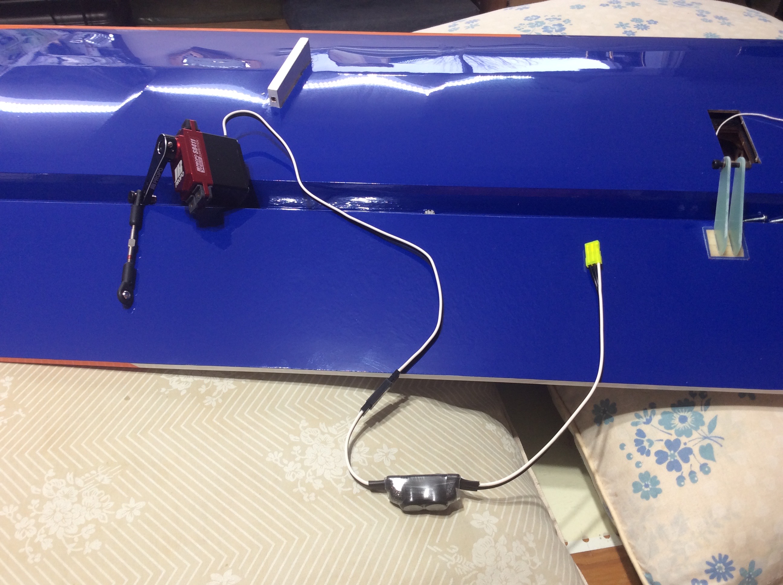

After getting the 2 wing halves to fit I was looking at how to get the 2 servos in the top wing connected to the receiver. We’ll it ended up the run from the servo to the receiver is over 36 inches. So because of the length and 2 connectors between the servo and the receiver I decided to add a servo booster to the 2 servos in the top wing.

Do you believe this 70cc bird will need these?
It’s not the size of the plane it’s length of wire from the receiver. Ok there is more to it also depends on the servo that is on the end of the extension. Fist is it a fast servo, it is over 400 oz and a 2K-hertz up date time and it is digital. So when it is asked to move quickly the voltage will drop, by how much is always debated, but it will drop and it also depends on how many servos are being asked to move at once. so it depends on bunch of conditions. So over the years and building a few bigger planes and noting some anomalies after adding a booster it fixed the problem. The one time was in a 100cc plane with some high powered servos in a very windy day and the plane had a Demon Cortex gyro in it, It did some strange things. After talking to some radio experts they recommended a booster and I believe it solved the problem. So as a rule I add a booster at 36 inches and a couple connections the voltage can see a reasonable drop at the servo.

@TonyHallo I get good feed back from voltages at the receiver but not at the servo. When I was really into at one time I was monitoring the voltage at the last connection before the servo that is when I noticed up a 2 volt drop. And also checked voltage drops across a small JR 3 pin plug seen up to 0.6 volt drop. If you want to do something interesting just run a 7.4 volt 5 amp load across a 3 pin JR connector for 5 minute. It really gets quiet hot.
