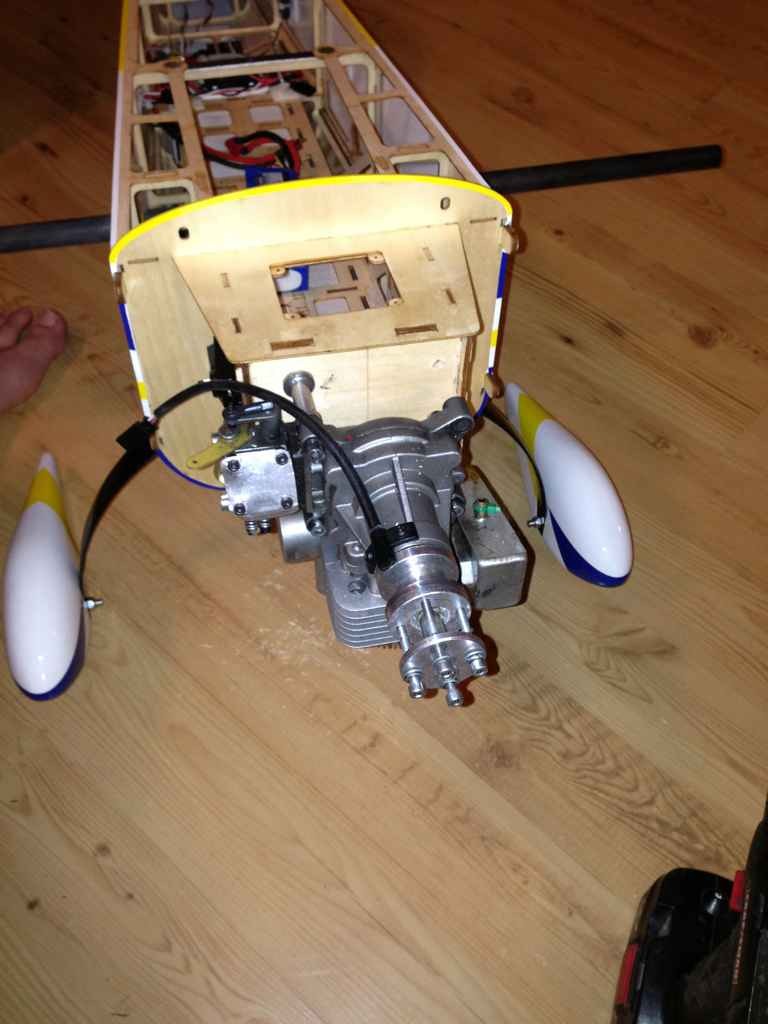

Got all the Rx and servo linkages set up today, and mounted the engine.

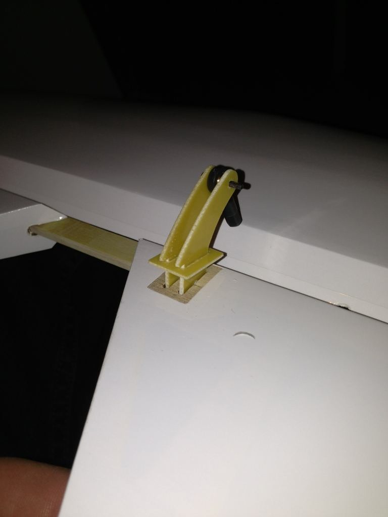

One thing I would like to make note of, when fitting the horns into the control surfaces, make sure you dry fit them before gluing them up. A few of mine had excess glue in the slots from building the frame, and I had to clean them out with a hobby knife. If I would have tried to do it without dry fitting first, I would have been in trouble, because the horn wouldn't have fit down into the slots, as seen here;

Two of my engine bolts were bent when my Slick met its death, so I have to hit the hardware store tomorrow before I can have the engine "complete."
The fuel line fitting was also broken off, so I swapped carbs with an engine I got from someone for parts/spare. The spare was from a rear-carb DLE, but hopefully it will all work the same. The rear carb DLE has a reed block between the carb and crank case, the side carb version does not. I left the reed block out, so it *should* be the same. I guess tomorrow I'll mount the tank and route the fuel lines, and maybe get this bad boy fired up.

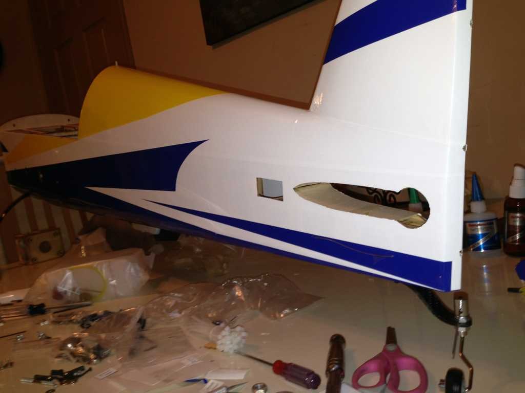

Is anyone else running this plane on gas? If so, have you cut any vent holes in the belly, and where did you cut them at? It comes with the "vented" cover for the tunnel, but I'm not sure if I need to use that or not.

I am pretty sure you need the reed block on the rear engine version (believe it or not, reeds act like valves on a two stroke engine)......and... you need 3 times the intake area for exhaust area for heat release...so, yes, I would use the vented bottom pieces....
SteveT
quadracer
Ooops...sorry, late at night, and got it backwards.....
