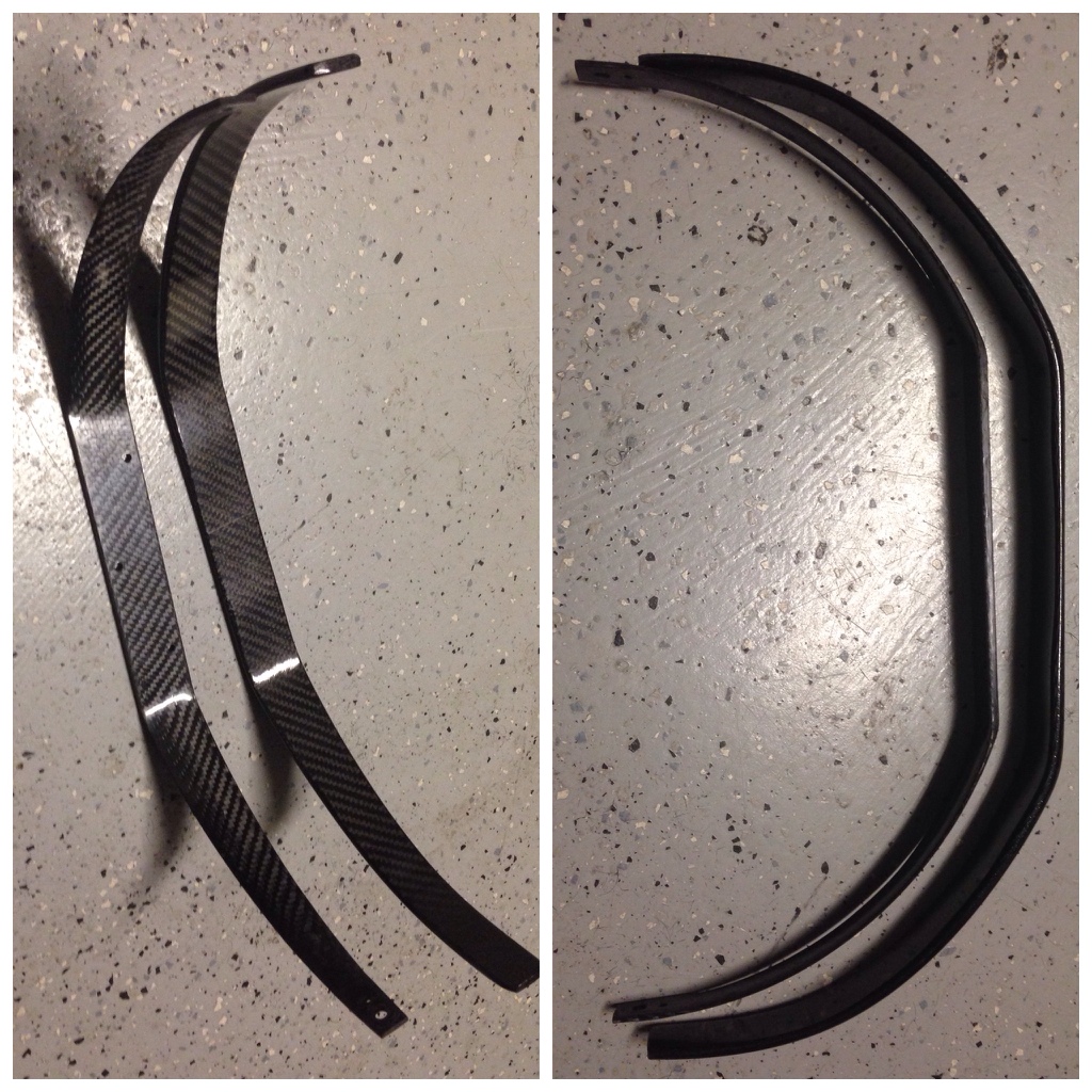

Ok I finally got around to opening the package and comparing the LG from graphtechrc to the original. Here's what I found.
1. The graphtechrc LGs dimensions are not quite the same as the stock units (although I measures them and sent them autocad files).
2. The dimensions are in our favor as far a strength is concerned - thicker and a touch wider.
3. The gear fits perfectly on the fuse but due to the thicker cross section the gear cover no longer lays flat and the since the tolerances weren't held at the wheels the pants no longer fit perfectly either.
4. If you leave off the pants and shave the fuse cover down thrown it's really a non issue and should be quite a bit stronger than stock gear (a counter point though - if the gear is stronger than something else will break first - namely the attachment wood or supports. )
Fit and finish is nice and since it's in stock whenever then this is a great option whenever the stock gear is unavailable.
