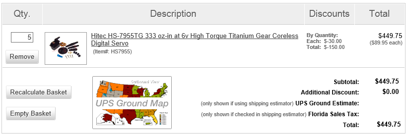

troybuiltmotors.com has them for $89.95

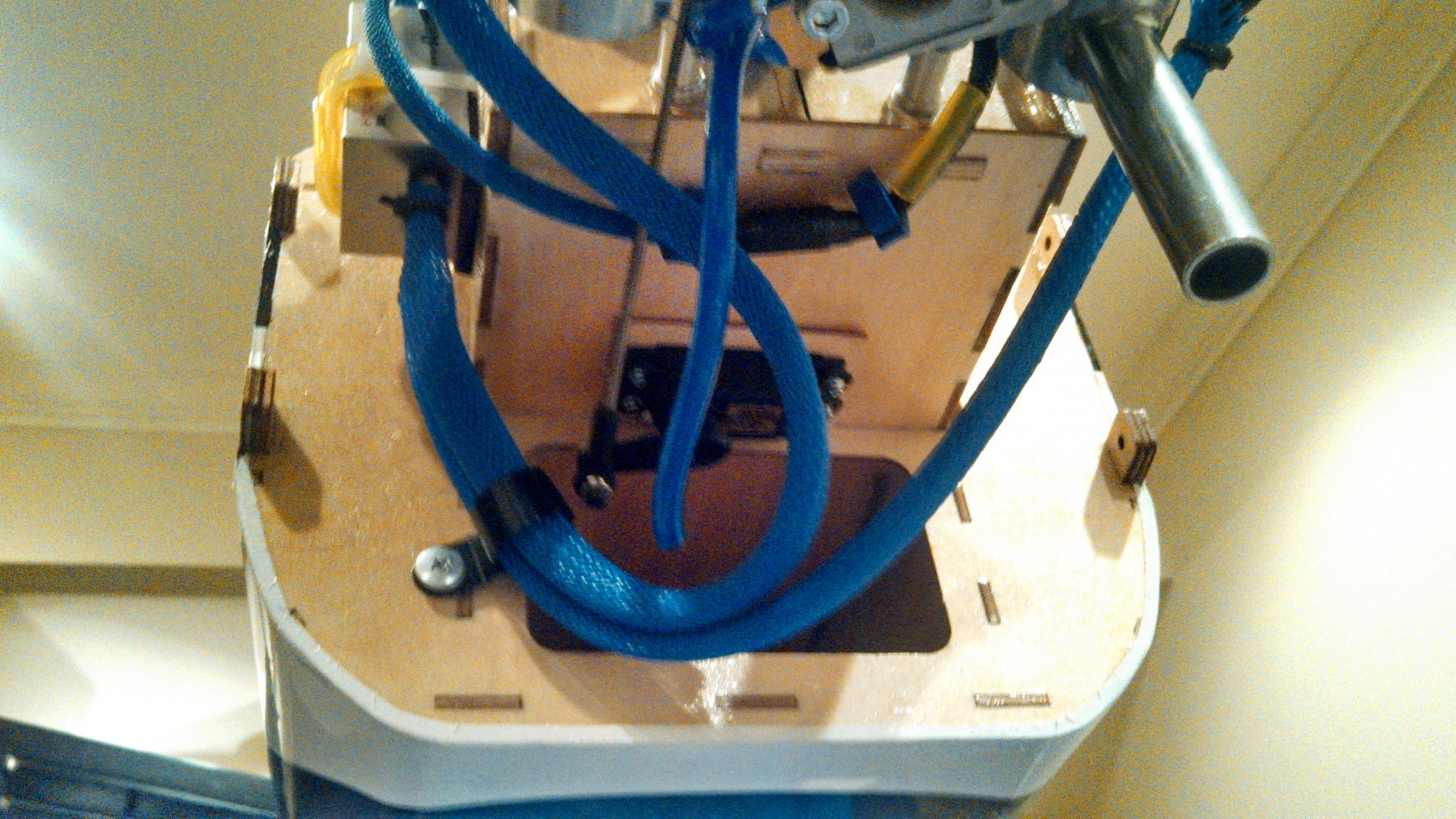

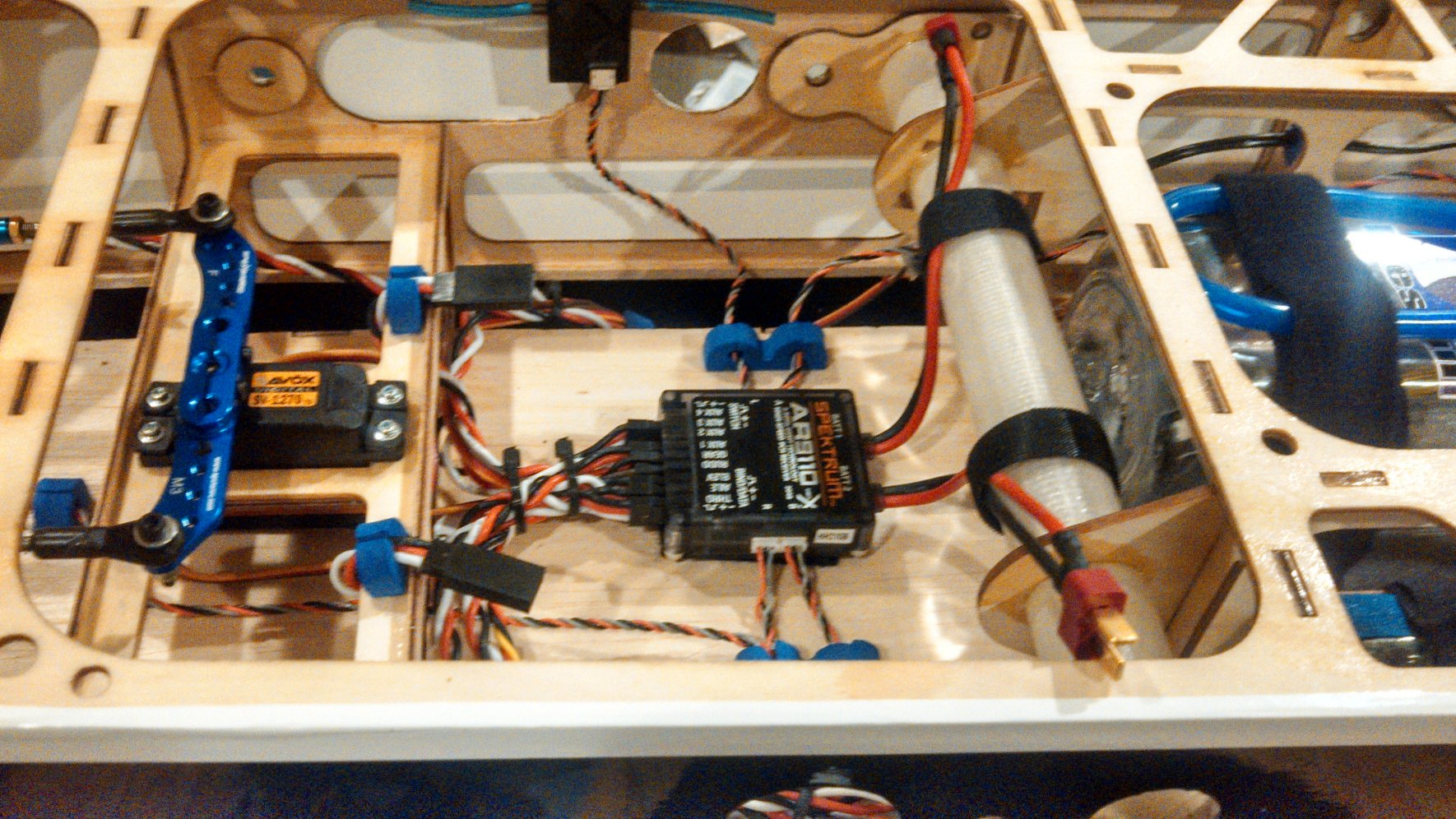

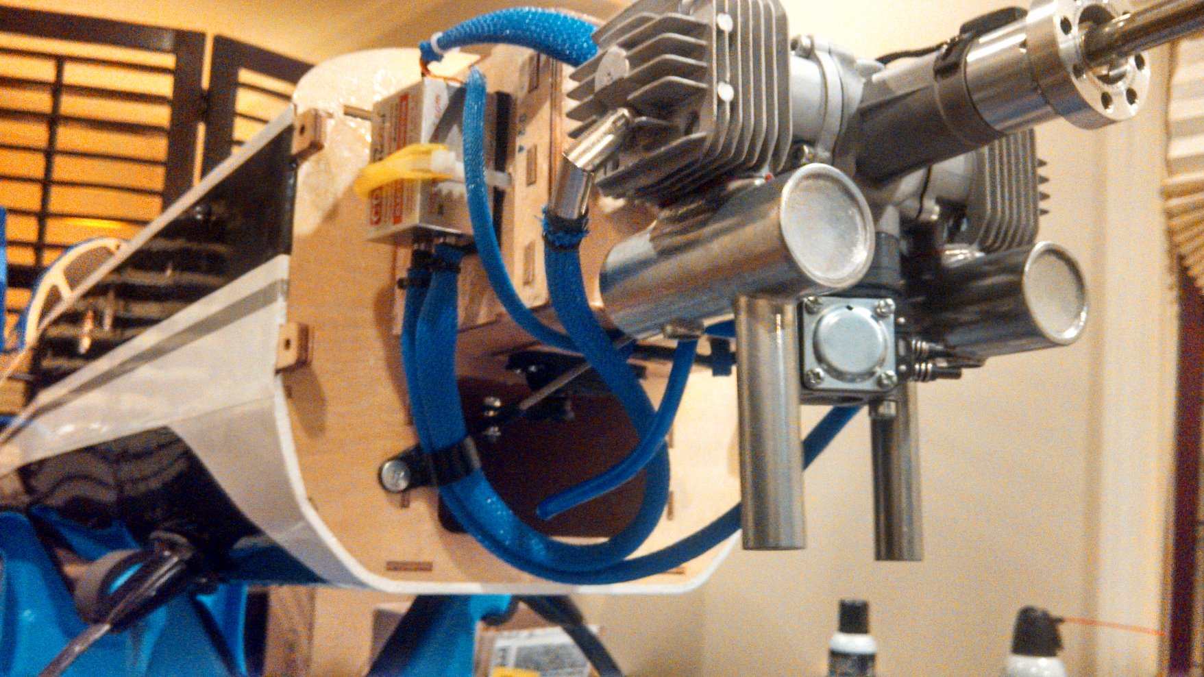

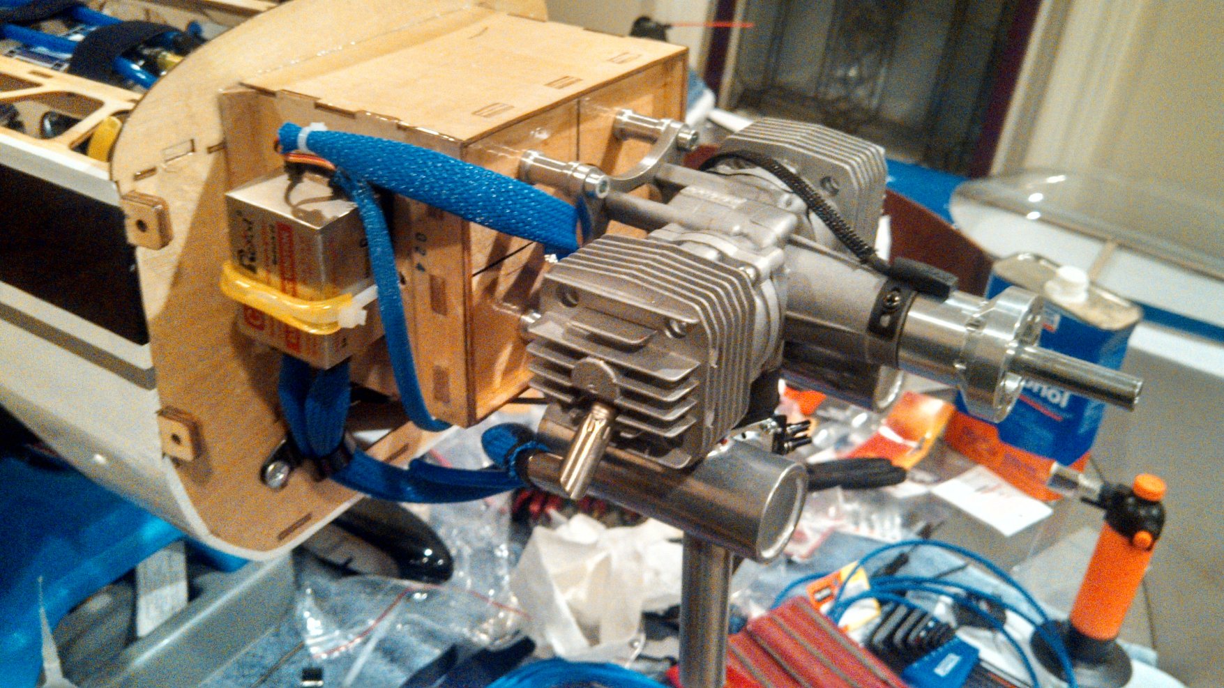

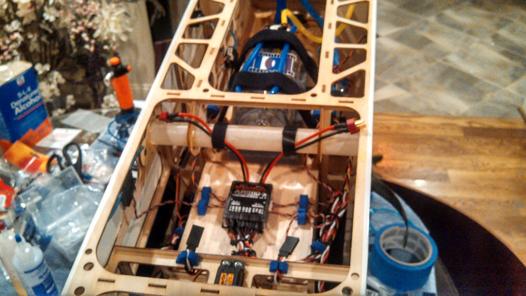

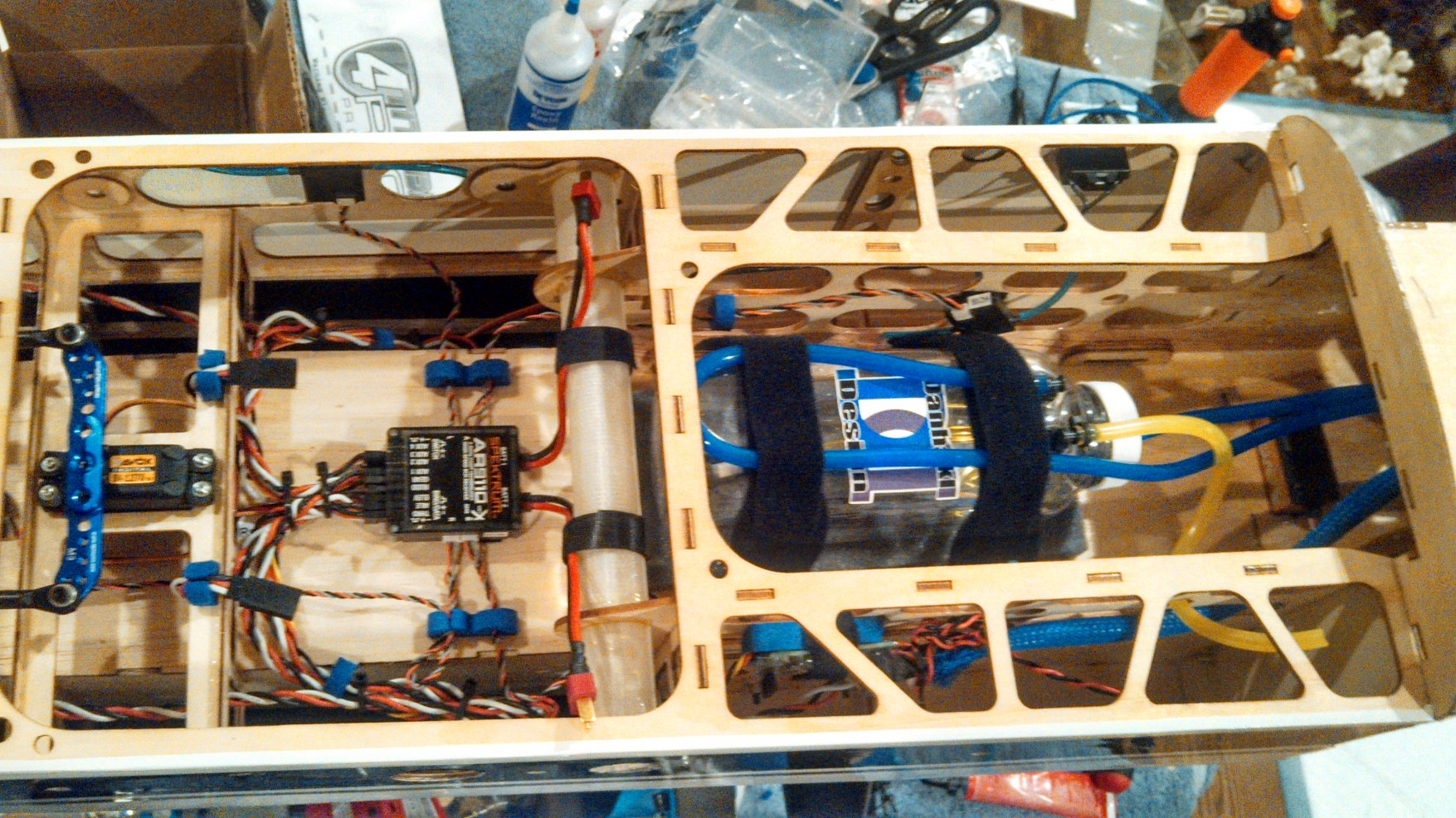

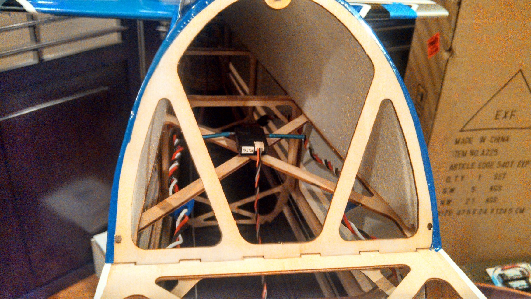

This thread's been dead for a few days. Thought I would wake it up. Nothing left now but a few details. All I lack is mounting the cowl and putting in a fuel dot. I bought a really nice Secraft but it is BIG. Looks like it's meant for 100cc planes and up. No good place to mount it. I have a Spot-On and an Extreme Flight fuel dots on the way. They should be here tomorrow or Saturday. I hope to maiden her this weekend. The Elevator servos have 1-3/4" Spot-On arms and 70mm (the stock are 60mm) Secraft turnbuckles. Otherwise there are no deviations from the factory setup. Azhar at Aztech Aeromodels has been extremely helpful. He's a great guy to do business with.
I have a few questions.
1.Do you guys bother with sealing the control surface gaps on these big planes?
2. I'm going to cut out the covering on the bay between the landing gear and the firewall and open the two round holes behind the gear for engine cooling like Hone1er did. Do I need to put a baffle in the pipe tunnel just aft of the two holes behind the gear? I am a little concerned about the covering over the pipe tunnel ballooning or blowing off.
3. Which prop would be better for break in?
This is my first gasser after a 25 year hiatus from the hobby. If you guys see any glaring errors please don't hesitate to flame me!!!
Setup is as follows:
1. Engine: 40cc VVRC twin
2. Props 20B and 21A Vess
3.Servos Savox 1270TGs all around.
4. Reciever: Spektrum Powersafe 9110
5. Aerotech IBEC
6. 2 each 1350 Thunder Power 25C 2S batteries
7. Engine oil Stihl HP Ultra 32:1
Thank you for all the info you guys put out here. It made this a fun build.

Hey Kevin glad it's coming together. Looks good. I used the 20B from the start. Also, i never had a problem with cooling but i did baffle my engine. I just have those cutouts i showed you and never had an issue with that. I used some cheap foam sheet to make my baffle. Just cut it out and CA it to the cowl. It seems flimsy but when you cut it into smaller pieces and glue it in place it's not moving. I sealed my hinge gaps and i definitely recommend it. Good luck with the maiden!
BTW, i think one of your mufflers is backwards.
RKEstes
Thanks Joe for all your help. I was wondering why they were offset... I will work that out. I wish I had a dollar for every time I've had those mufflers on and off during the build!
