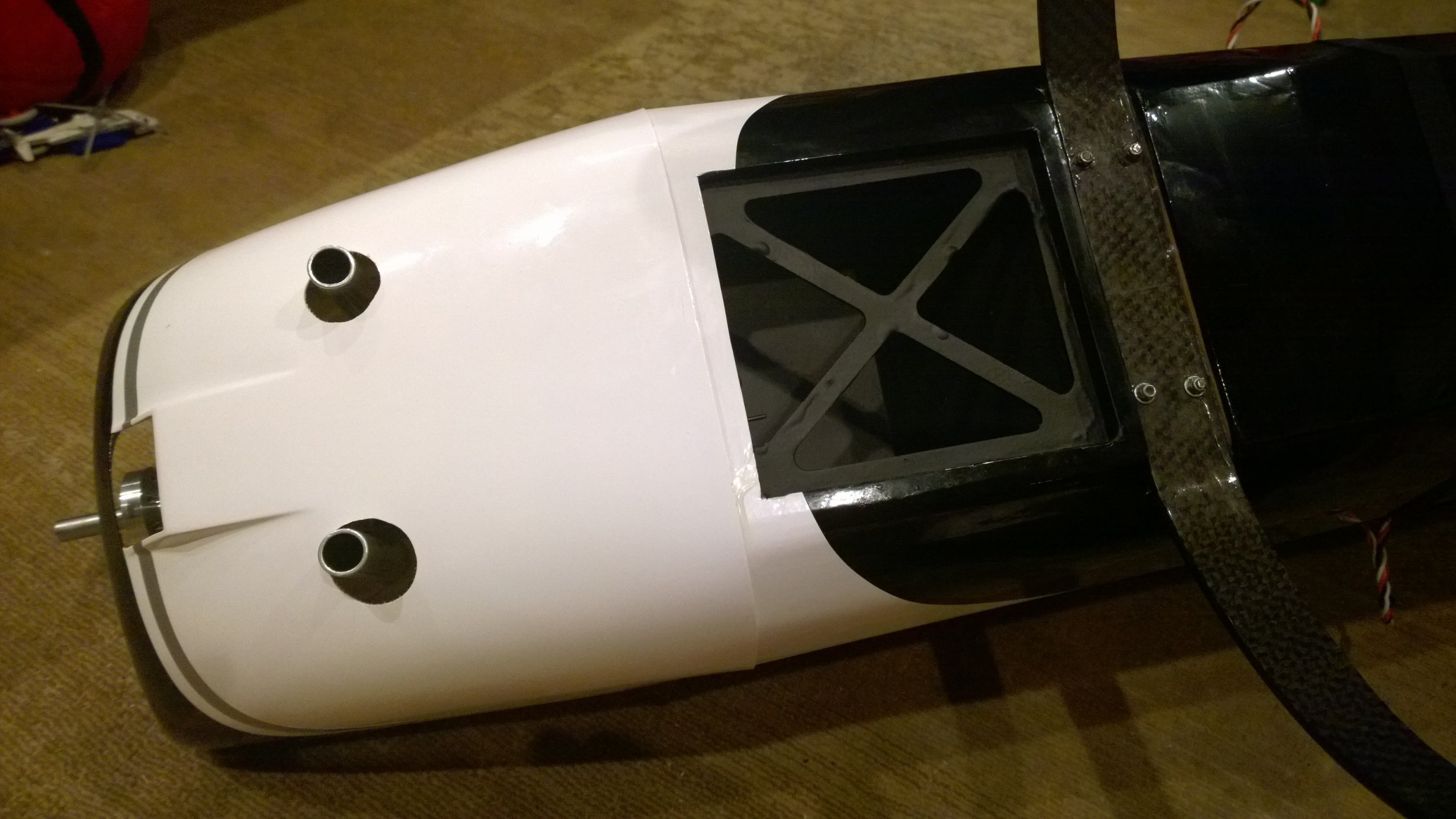

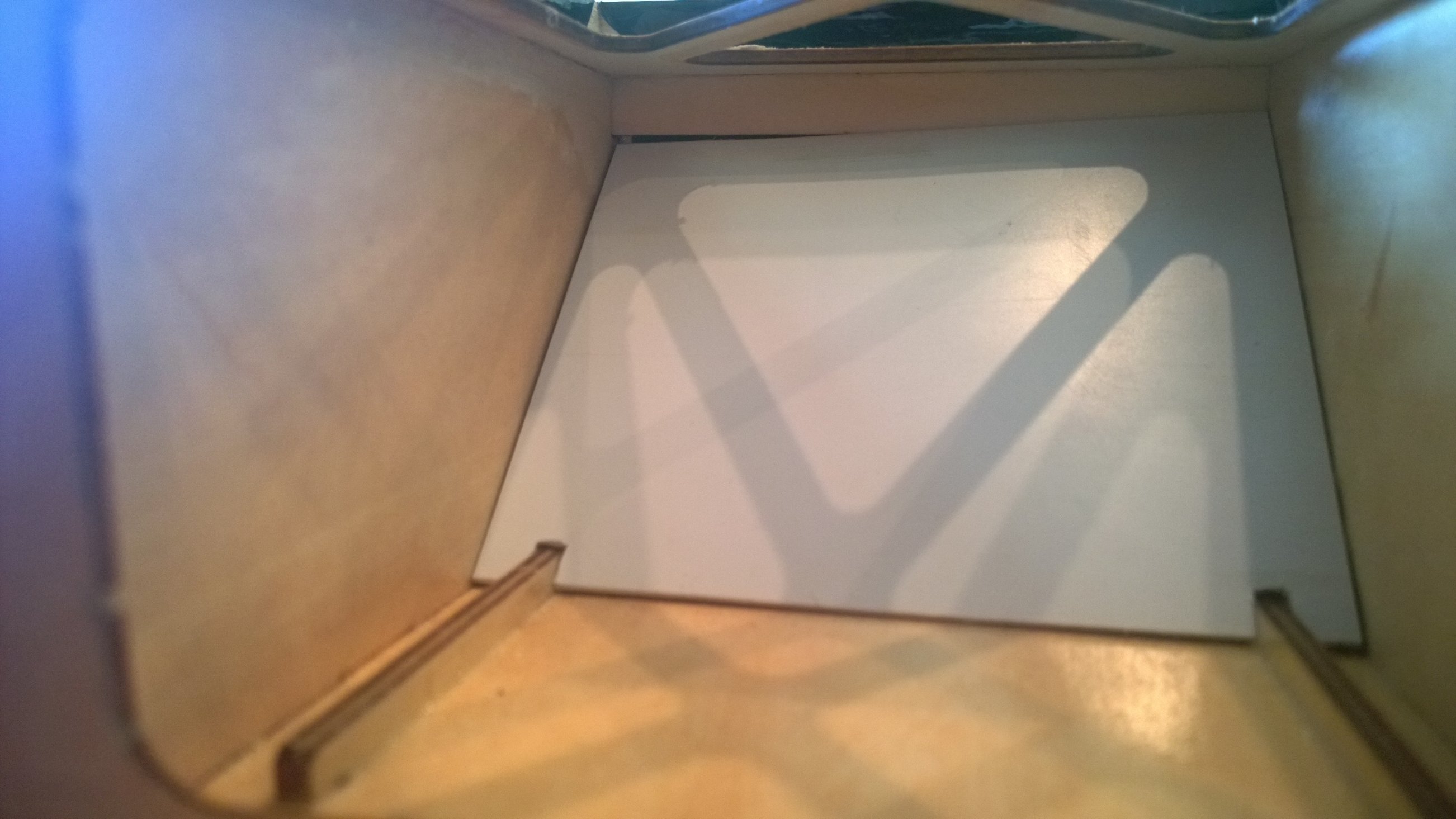

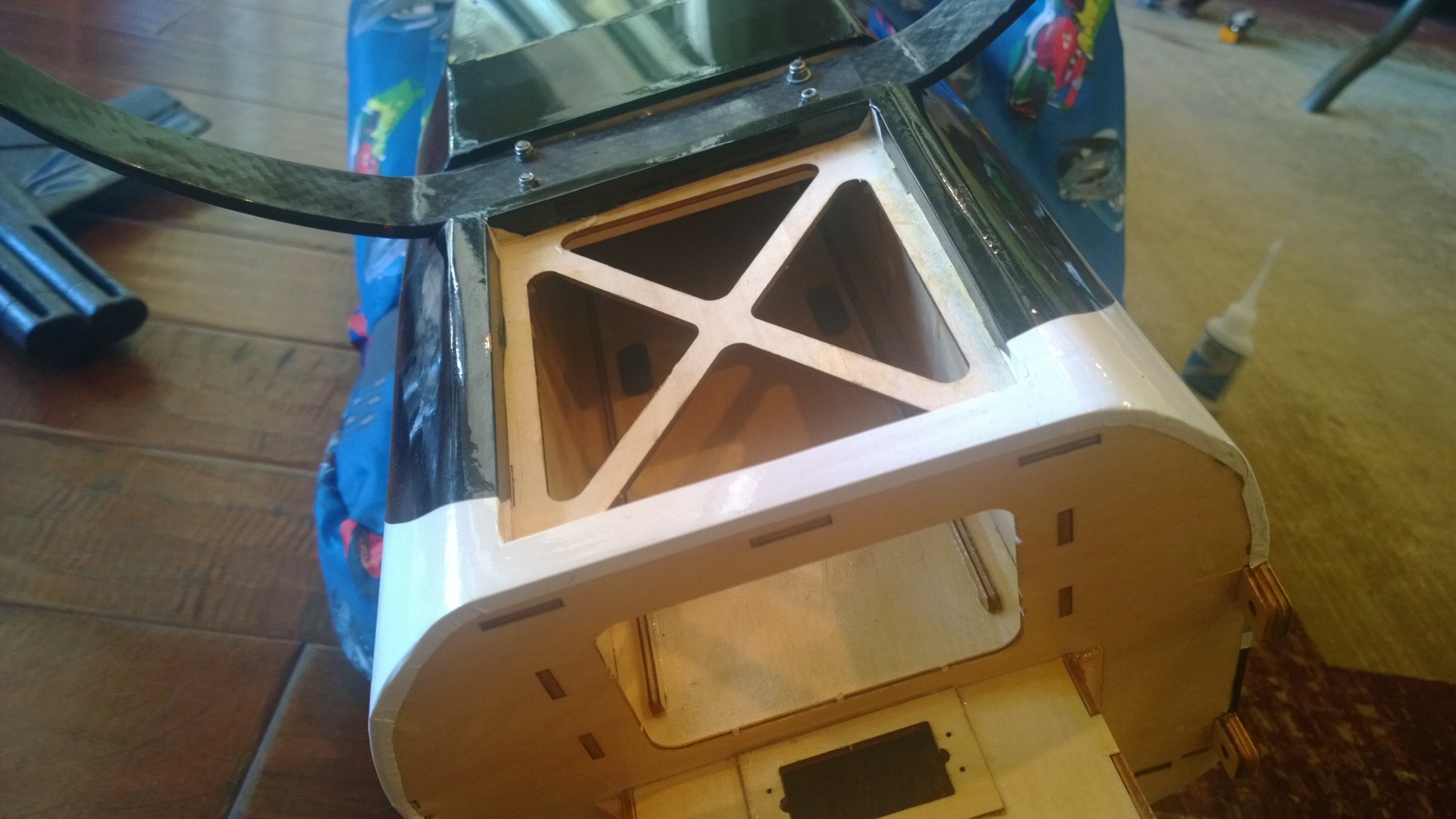

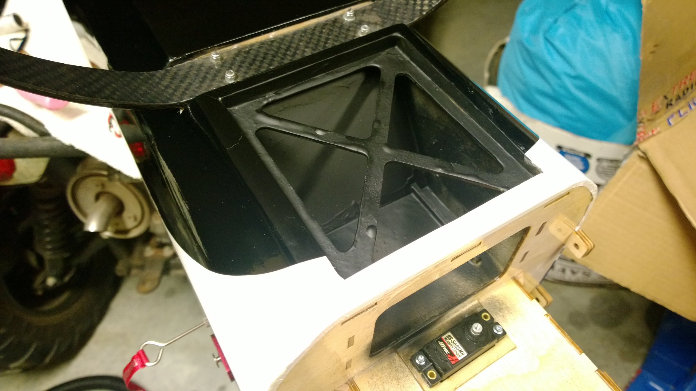

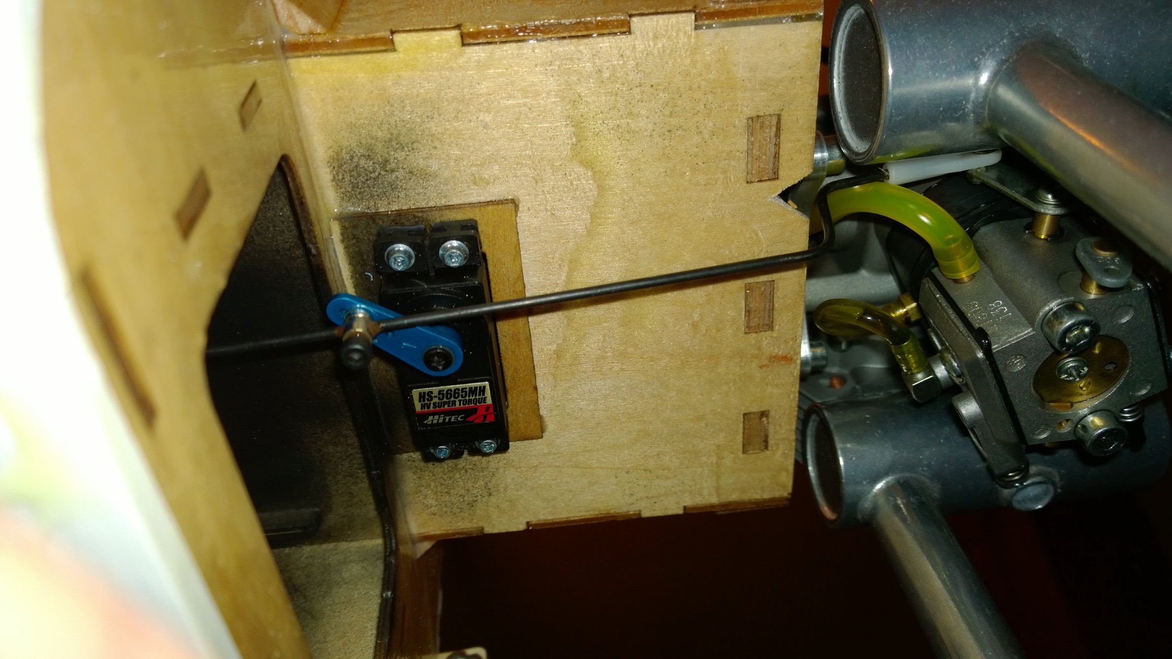

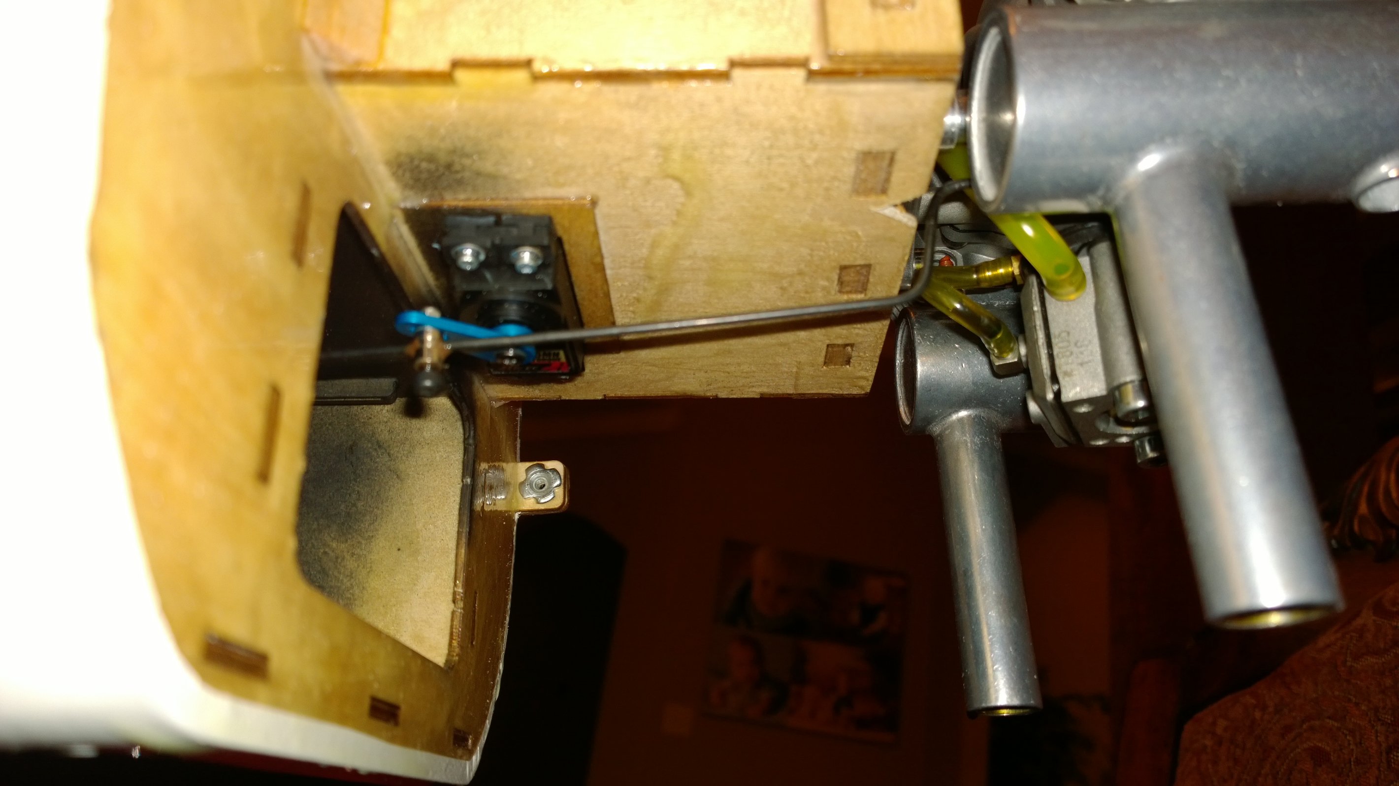

Thanks for the pic's, it gave me some ideas.
I used 2/56 ball links for the thottle. I recessed the non-structural overhang protion of the engine box so there is not binding from idle to full thottle. Also, I found a servo arm that is narrow compared to the plastic servo arms. Before I intalled the narrow servo arm I had a slight bind. As you can see from the pics, there is no binding at the servo when throttle is closed.
I did a custom z-bend to get a custom step for the throttle line vs the throttle body with the same non-structural overhang "notch". See attached picture. I really like this setup better than my first angled attempt.

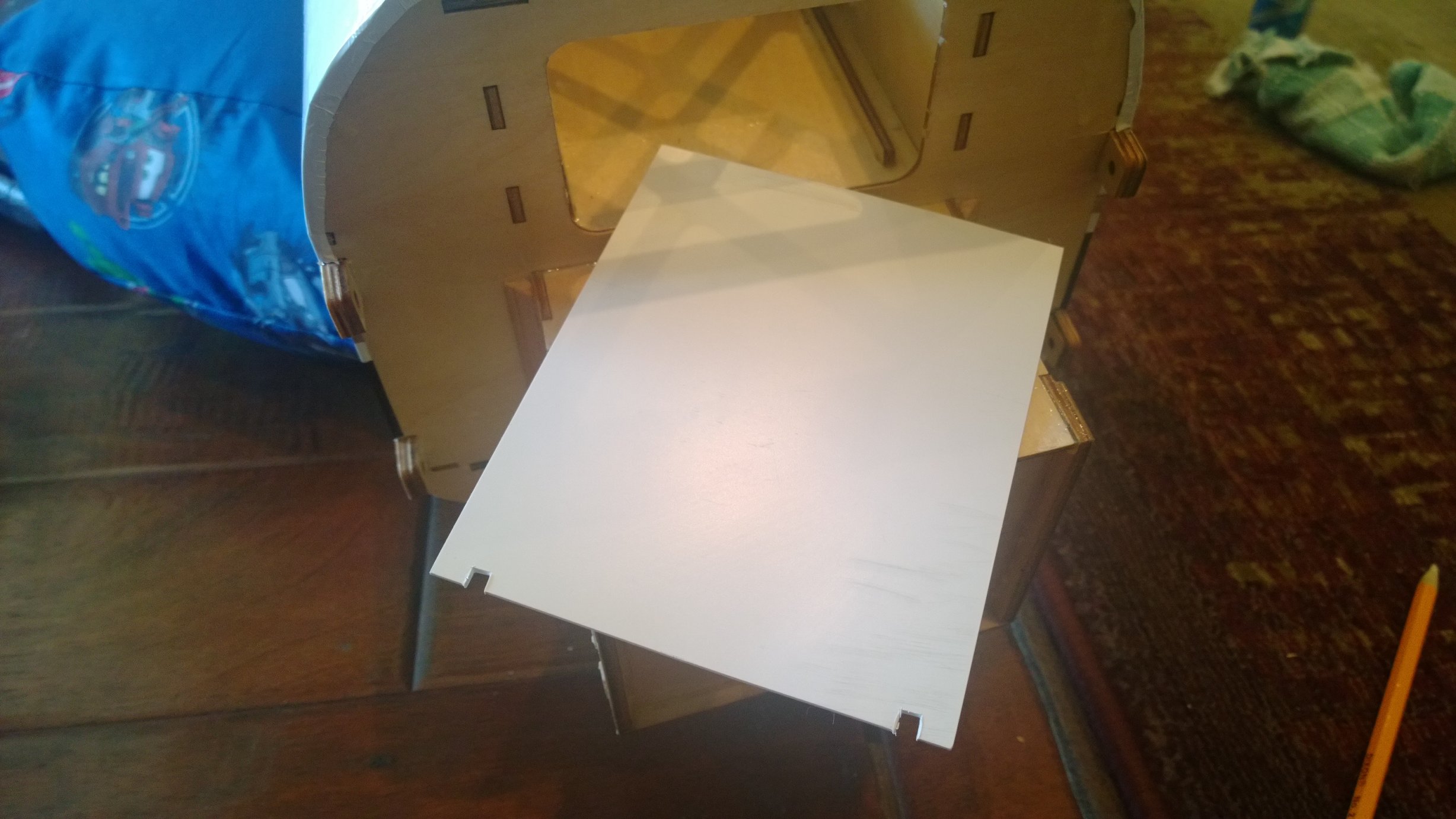

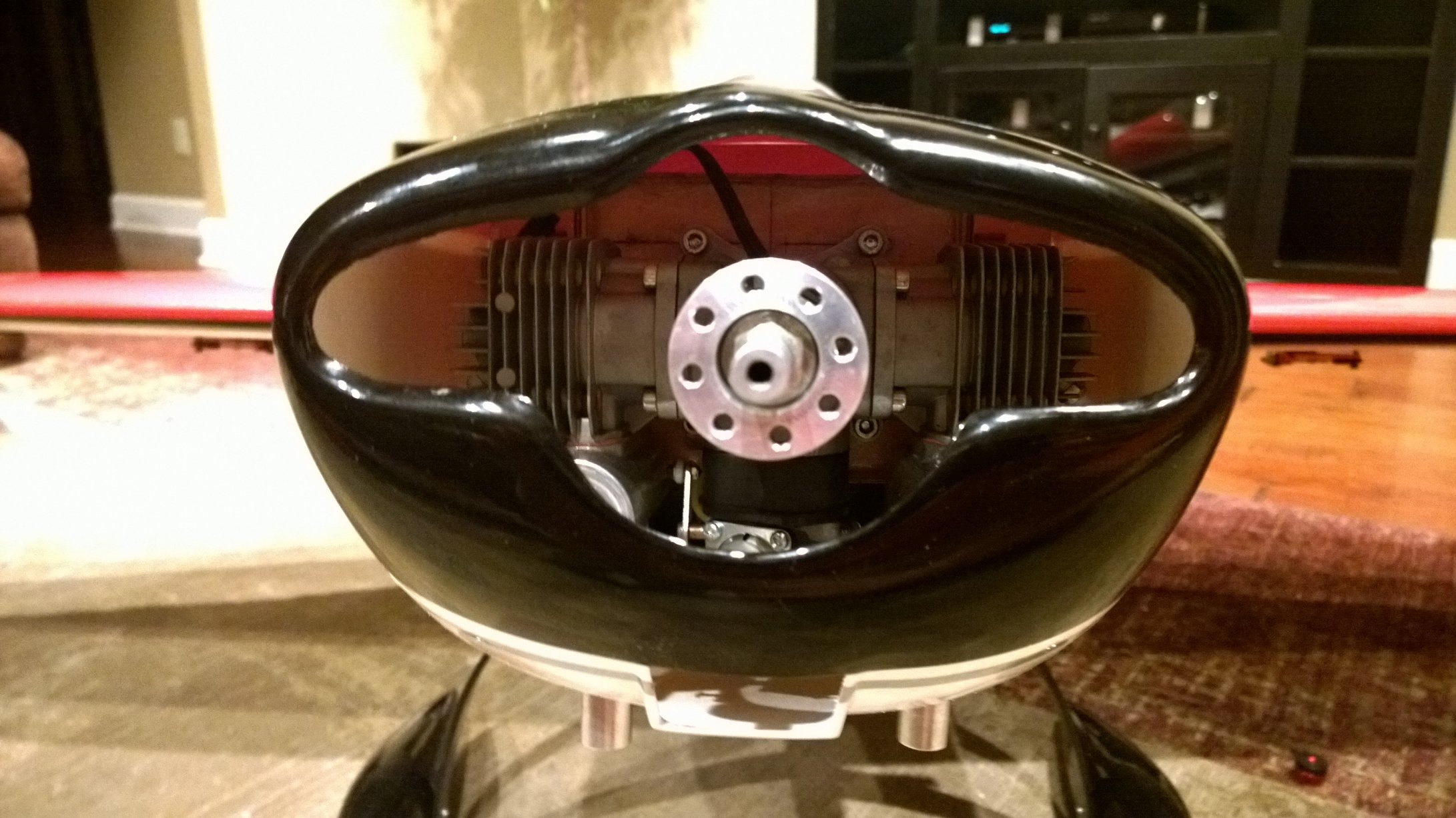

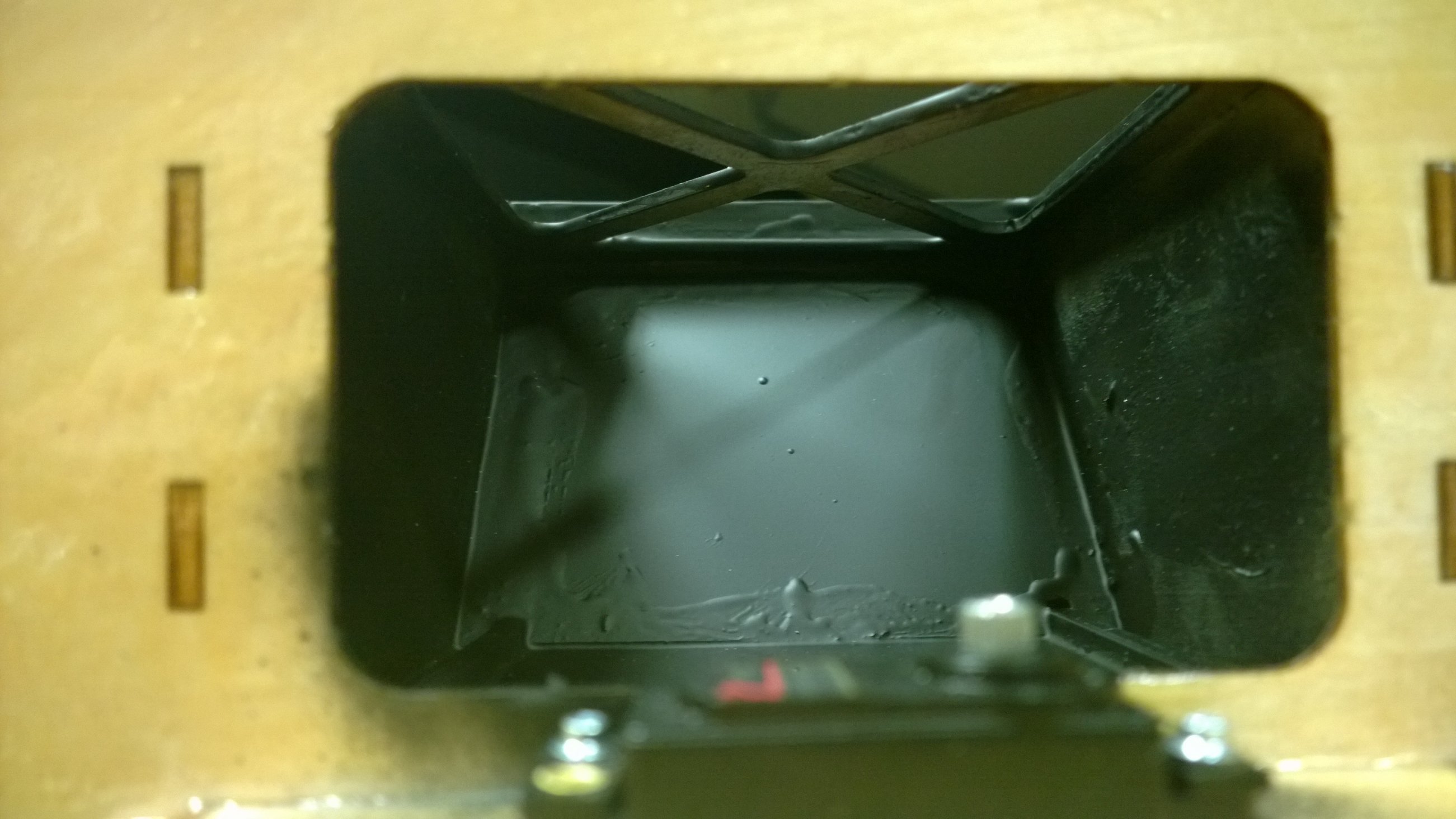

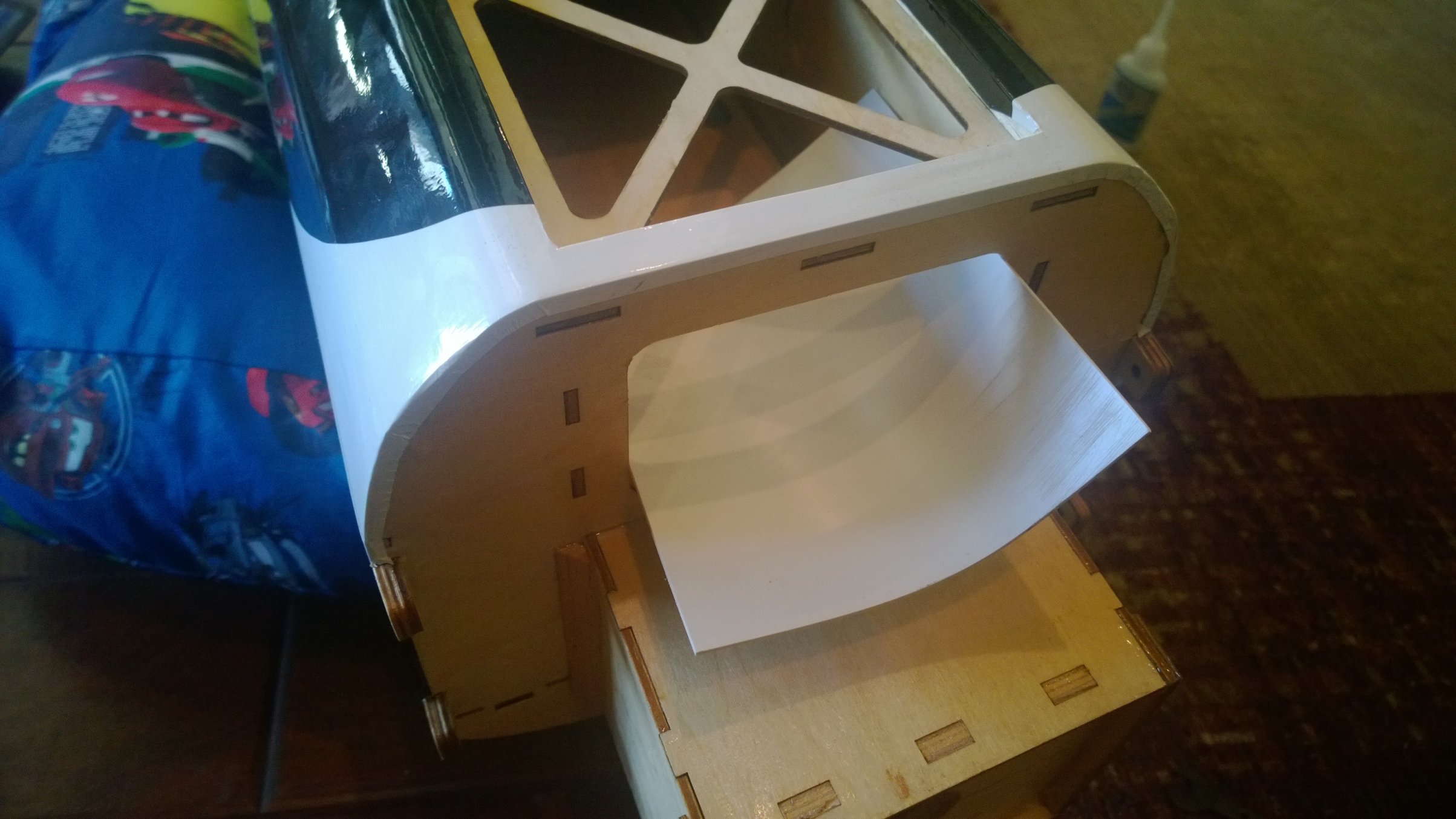

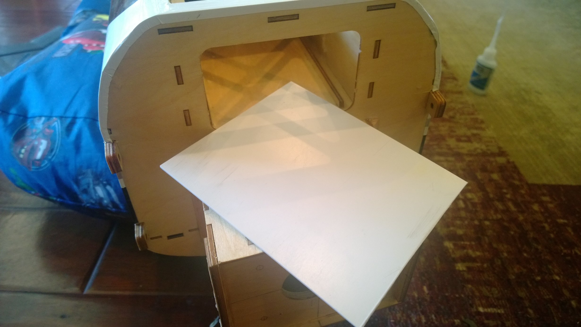

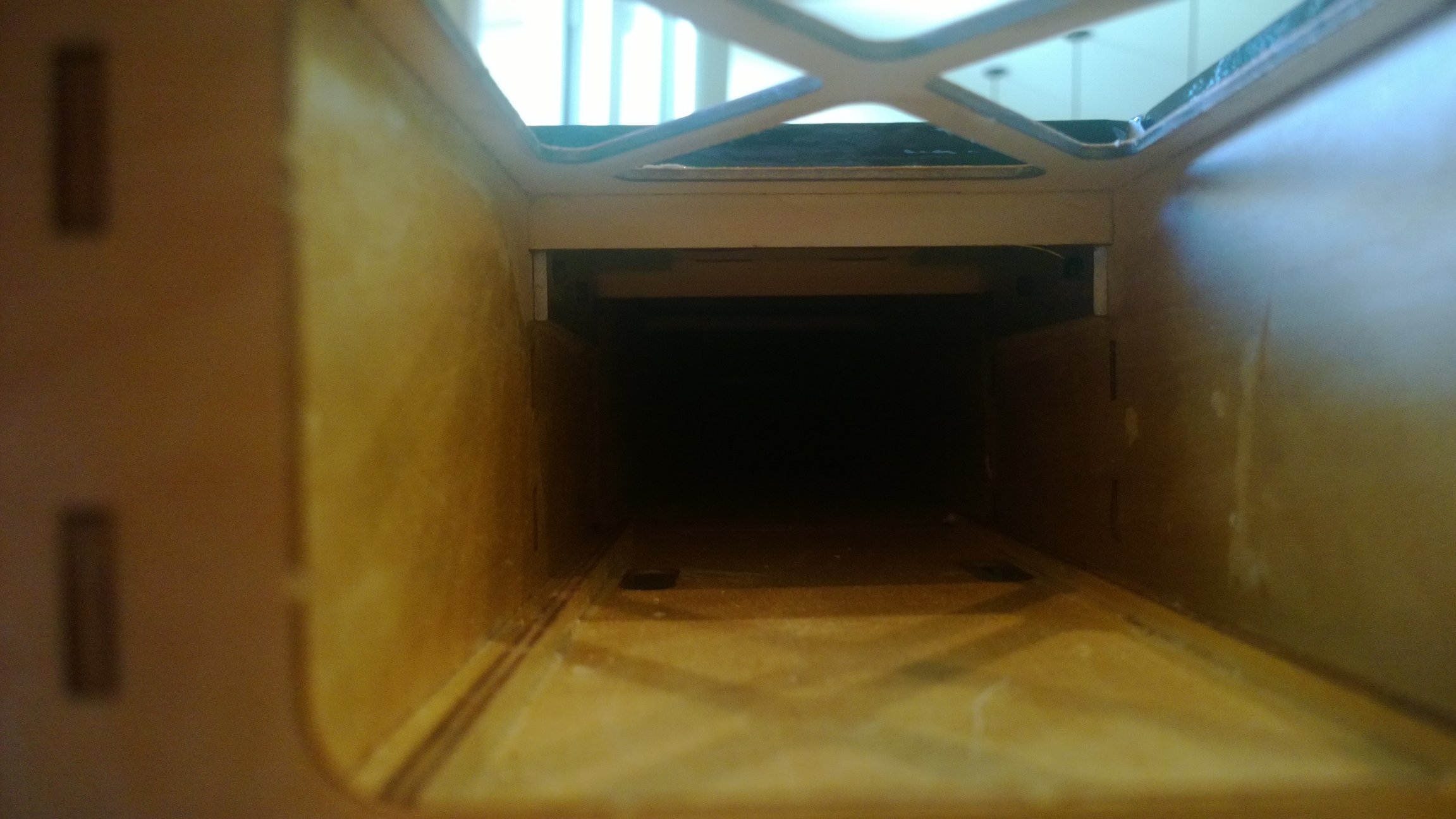

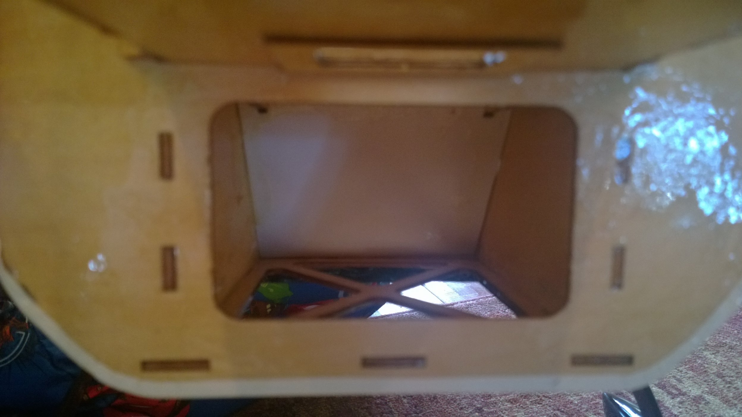

I have a question for you guys running the VVRC 40cc. Are you guys baffling the engine? If so, do you have any good pics? Here are some picks of mine with the 3/8" customstandoffs.com... and spinner gap :) Also showing my cutout and custom air-dam in the pipe compartment. I want to get some balsa and/or some black ultracote to cover up the landing gear like on most of the 3DHS planes.
(sorry for all the pics, just wanted to show in case someone else was interested)
I still have good resolution for the throtle servo, it's at 100%/100%. :banana:

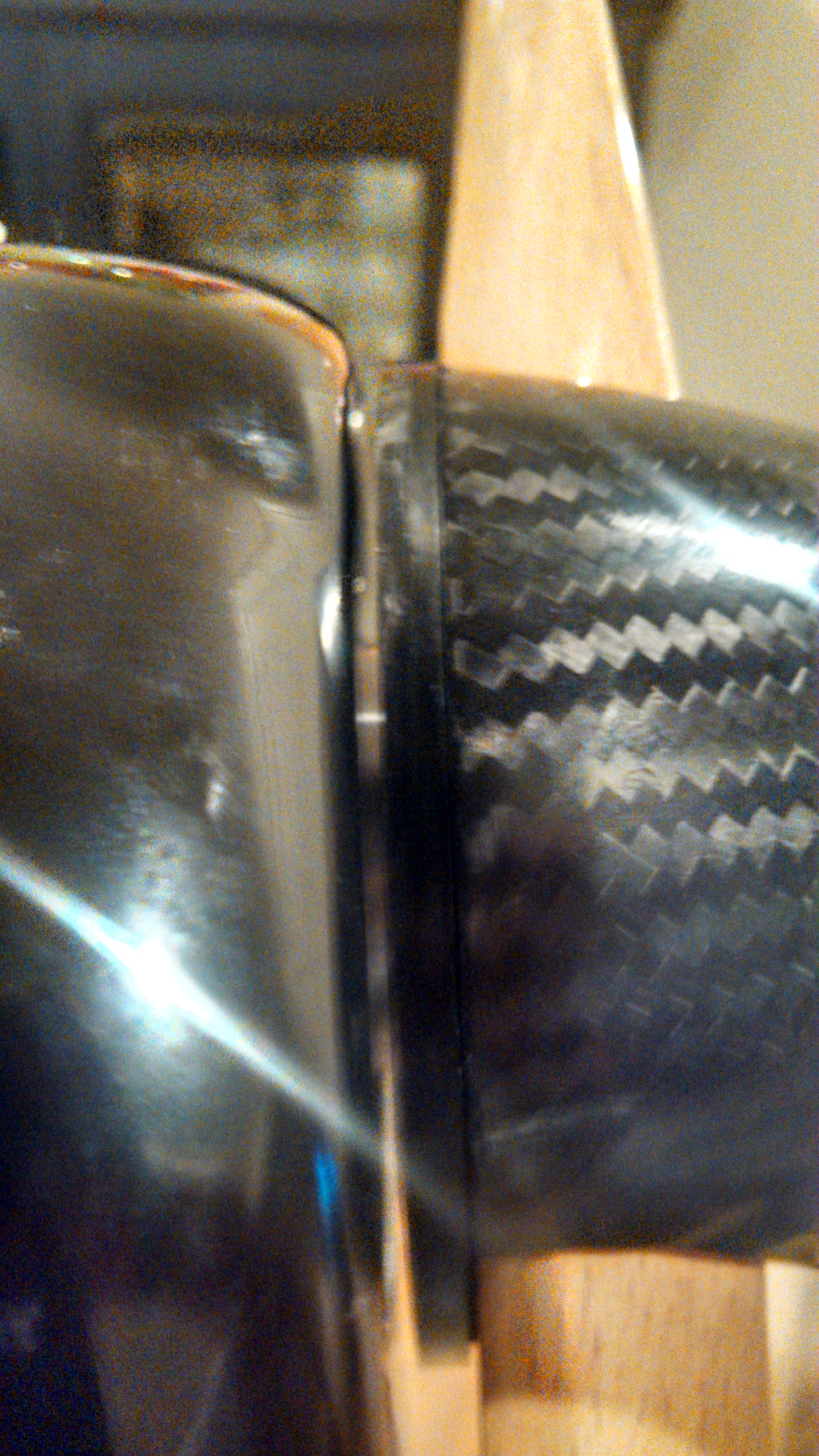

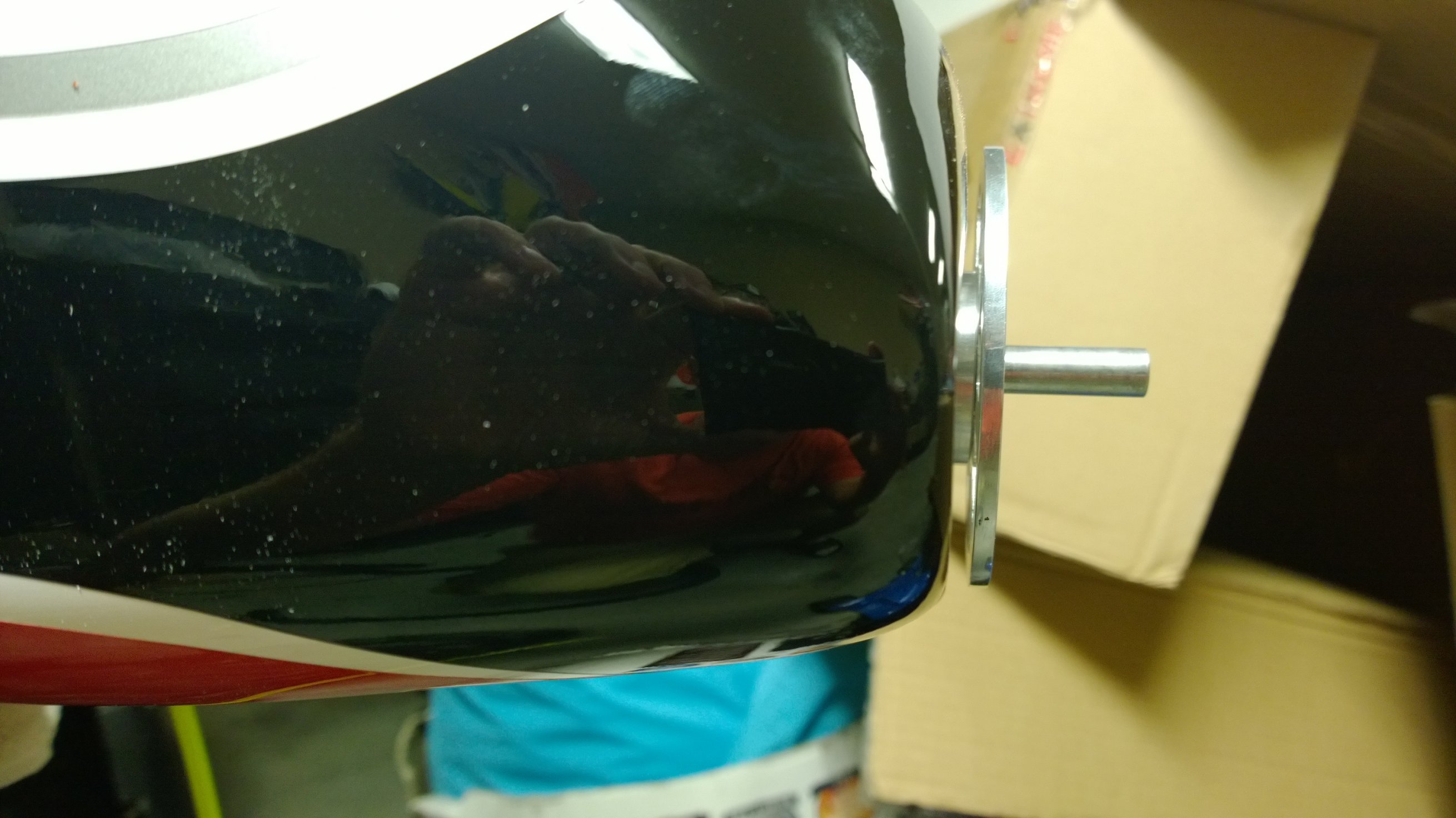

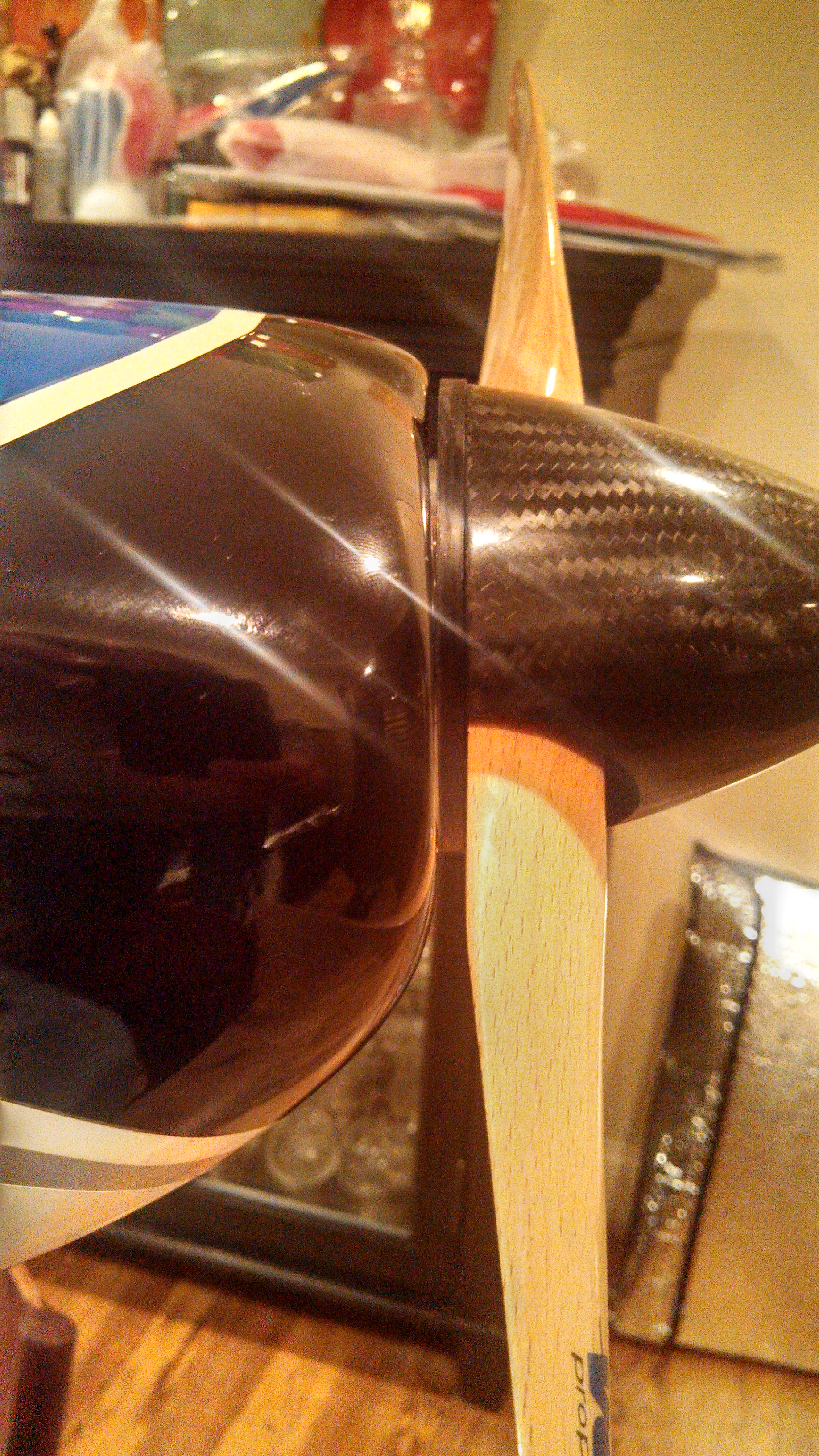

For anyone running the Valley View RC 40cc twin on this airframe and wondering about how to close the large spinner gap with the stock engine standoffs, I received some custom standoffs today from www.customstandoffs.com. They are 3/8" long. I will report the results when I get them installed later this evening.
Pics with 3/8" standoffs. Money!

Cool. My replacement airframe should be here on Tuesday. I think I will make some 7mm Evolution standoffs and washers to make that same gap.
