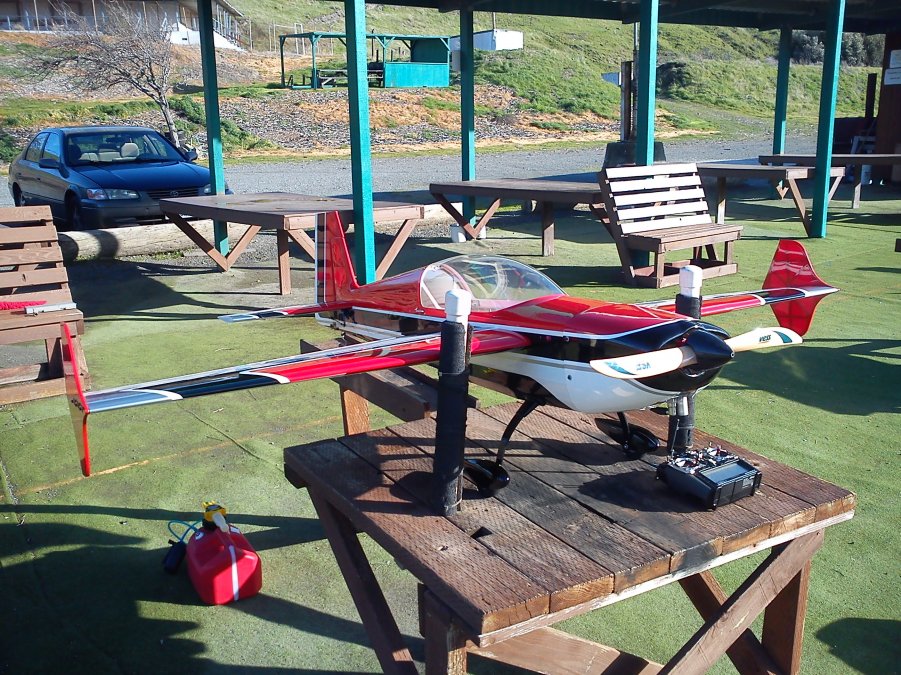

78'' Extra
hone

hone
Got a few more flights on the Extra. Tried a 20b but i think i might need to go down to a 20a. The engine would bog/die if kept at full throttle too long so we richen it a touch and i also cut a hole in the covering so air could come out of the tunnel. That helped but it didn't solve it. The cowl is getting plenty of air in/out. The engine had good transition with no hesitation and idled well so i believe it is tuned good so i think the prop is too much(i'm at sea level). IIRC the tach showed only around 6450-6600 at full throttle, i think others reported 7000 but i don't know his elevation.
Some people don't like that the plane comes with aluminum LG but I actually like that because if i have a dead stick that results in a less than perfect landing i can just bend the gear back into shape. I'll probably get the carbon gear when everything is broken in and running perfect but for someone getting there first gasser i think the aluminum will save you money in the long run.
My CG is a little further back than i like. I'm actually perfectly neutral when i roll inverted but i prefer having it a little forward of that. I'm using 2 x 2s 1300s to power the system and i have no more room to move them forward so i'm going to get some 1600-1800s. Hopefully that'll put me where i want to be and i'll be able to fly an extra flight or two before switching packs.
I wanted to put a ES pipe on it but that would move my CG further back right? I guess replacing the carbon spinner with something heavier would be a good place to start. The one i have is 3'' and looks a little small on the plane actually. Any suggestions for spinners would be great.
Since the engine is still breaking in i've been flying mostly precision and it is LOCKED IN! I love it! Even with the CG not perfect the plane is tracking great. I can't wait to start bringing it down low.

Great report! I'm looking forward to more info as your motor continues to break-in. It should make more power as it breaks in as well so don't give up hope on the 20b yet! I would fly it will a little less load until it is broken in and making more power, then see how it handles the 20b.
hone
Thanks.
I'm going to put the 19x8 back on it until i'm done breaking it in. When i switch to full synthetic i'll go back up in prop size but i'll probably put the 20a on there.
I really like how fast this plane is in the air. It's feels a lot quicker in the air than my 6s powered 71'' Slick. I think it has a lot to do with the airfoils on the planes too though. The AJ has a REALLY thick airfoil compared to this Extra.
