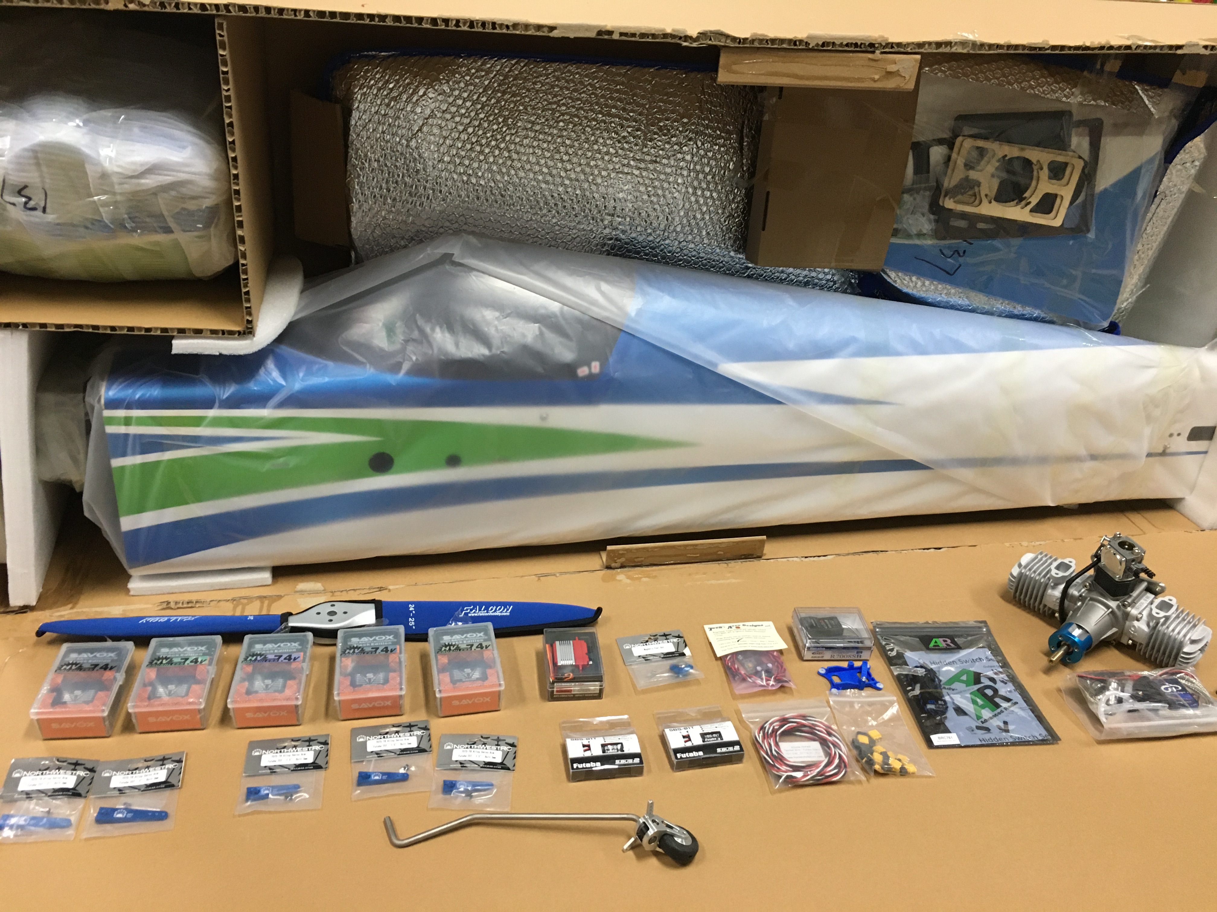

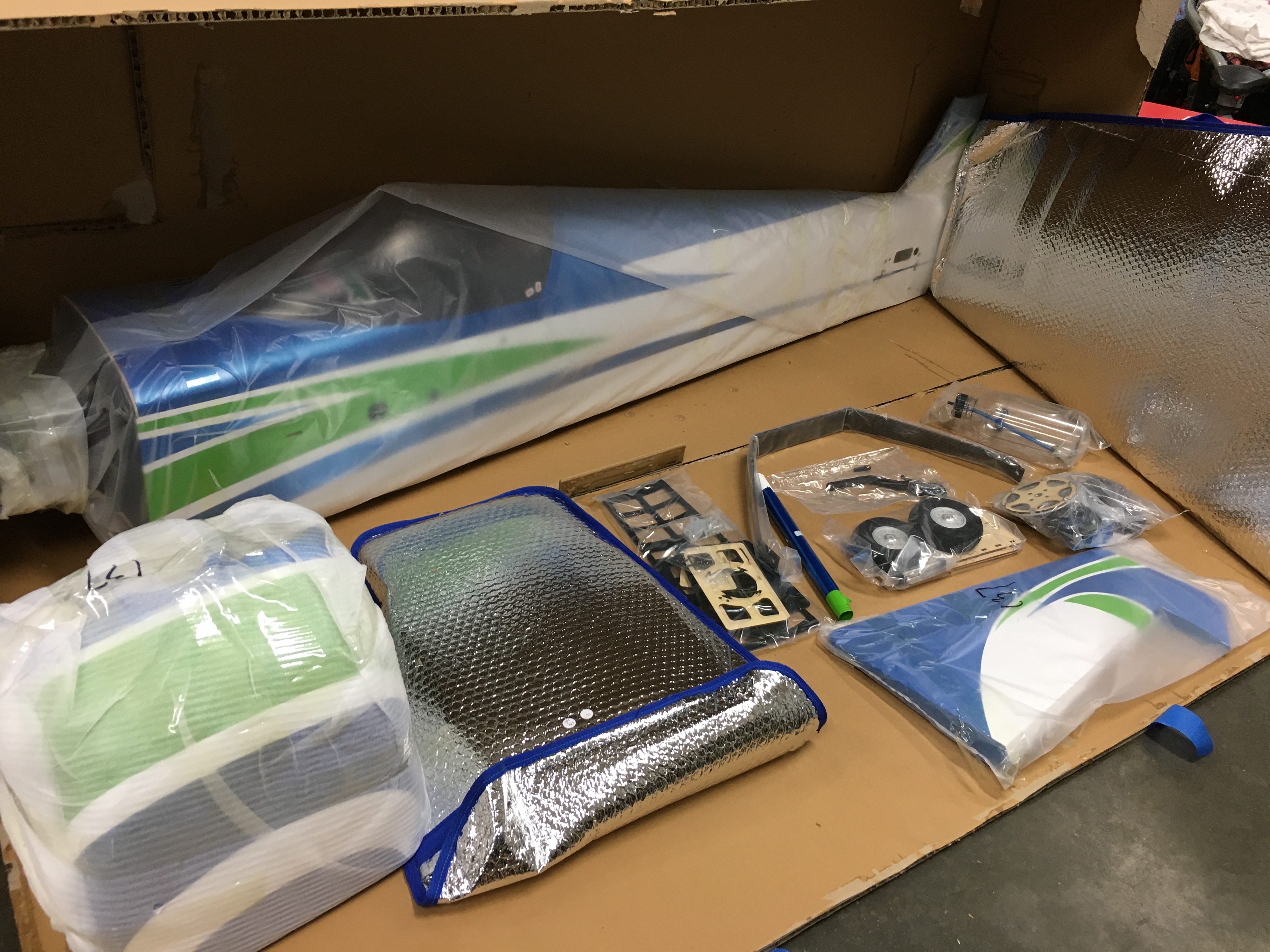

    Double box removed and the inner box exposed with all the goodies I’ve collected for this beauty!
    8CFE7316-F307-4E73-87D7-826AA90DF882.jpeg F0AF0BC3-0361-4721-8C2F-478BD0540D55.jpeg
    note the roll of extra covering material scraps included for repairs.

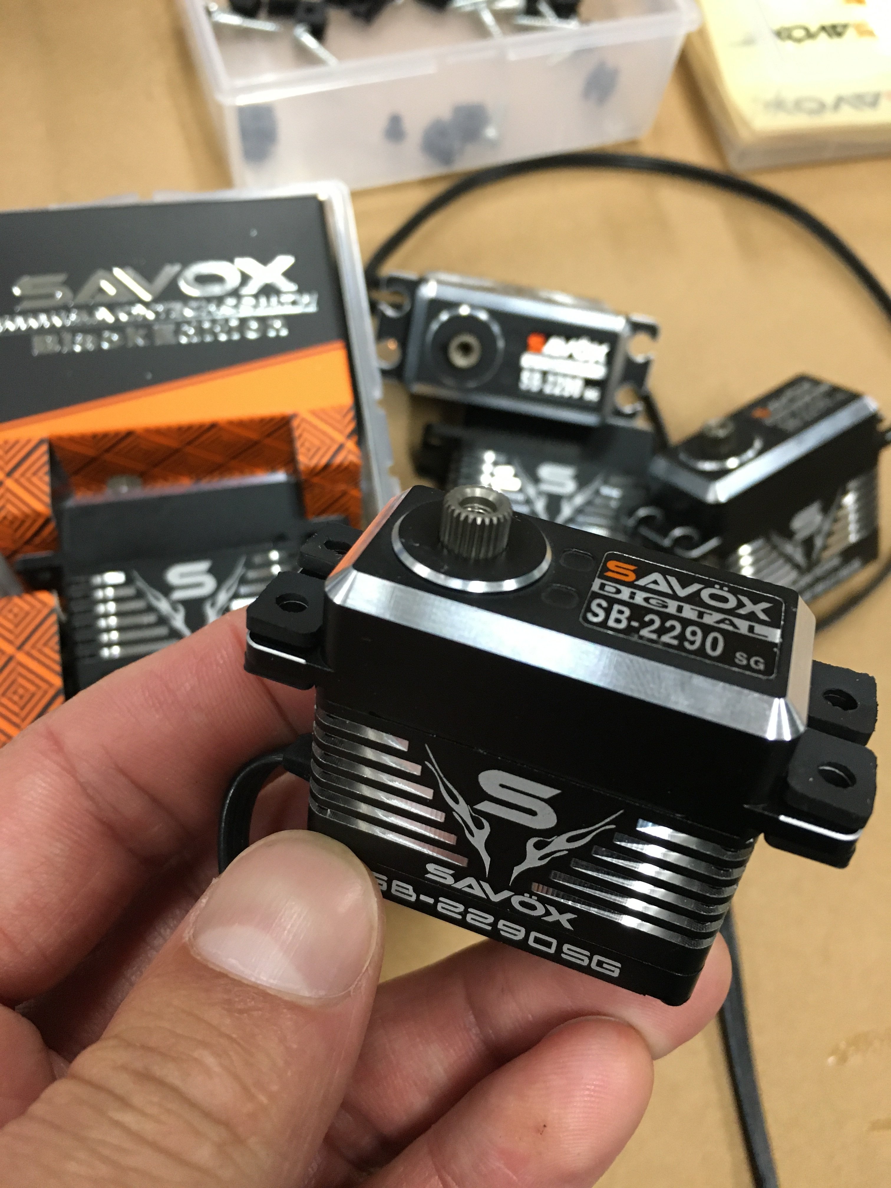

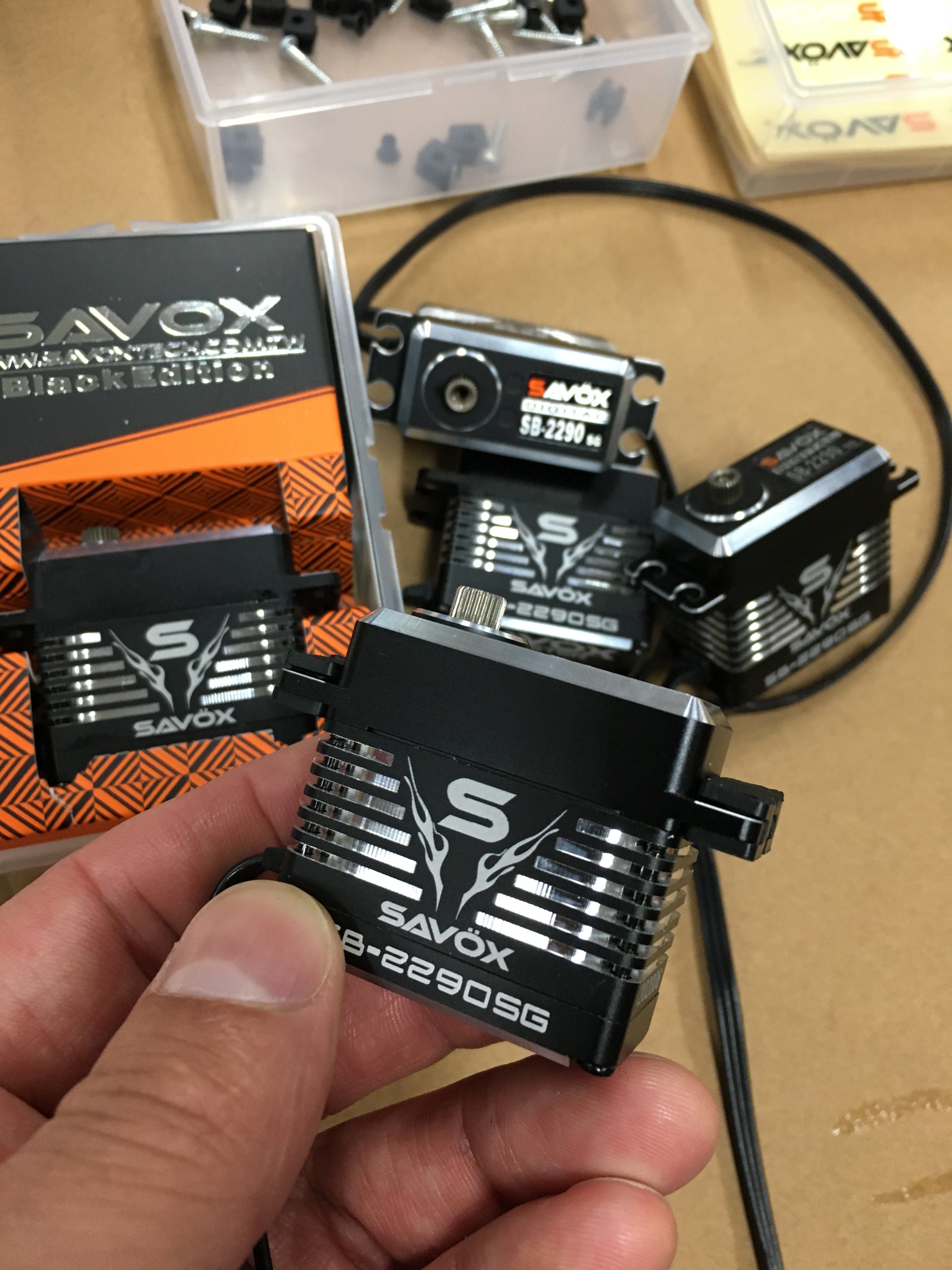

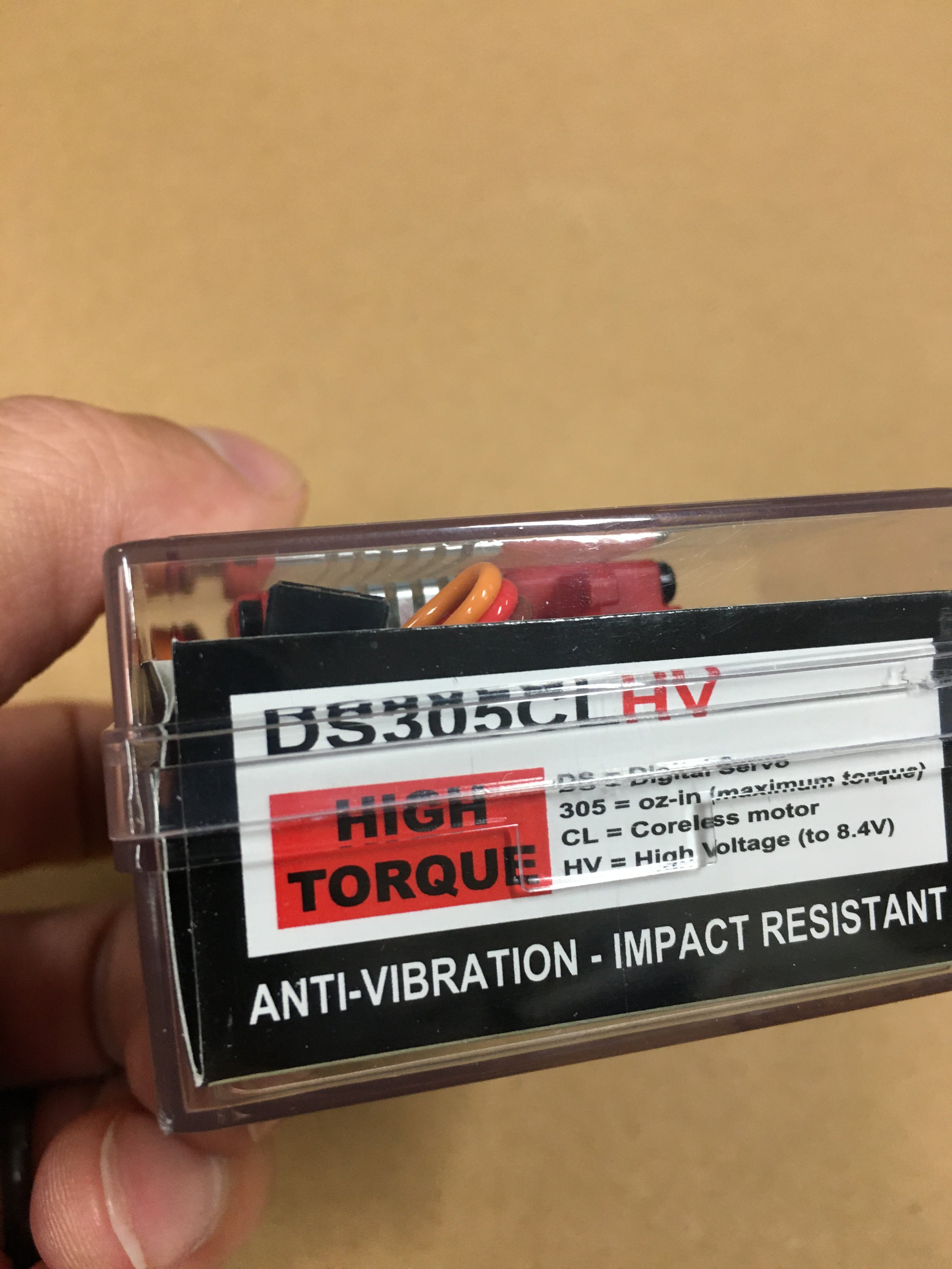

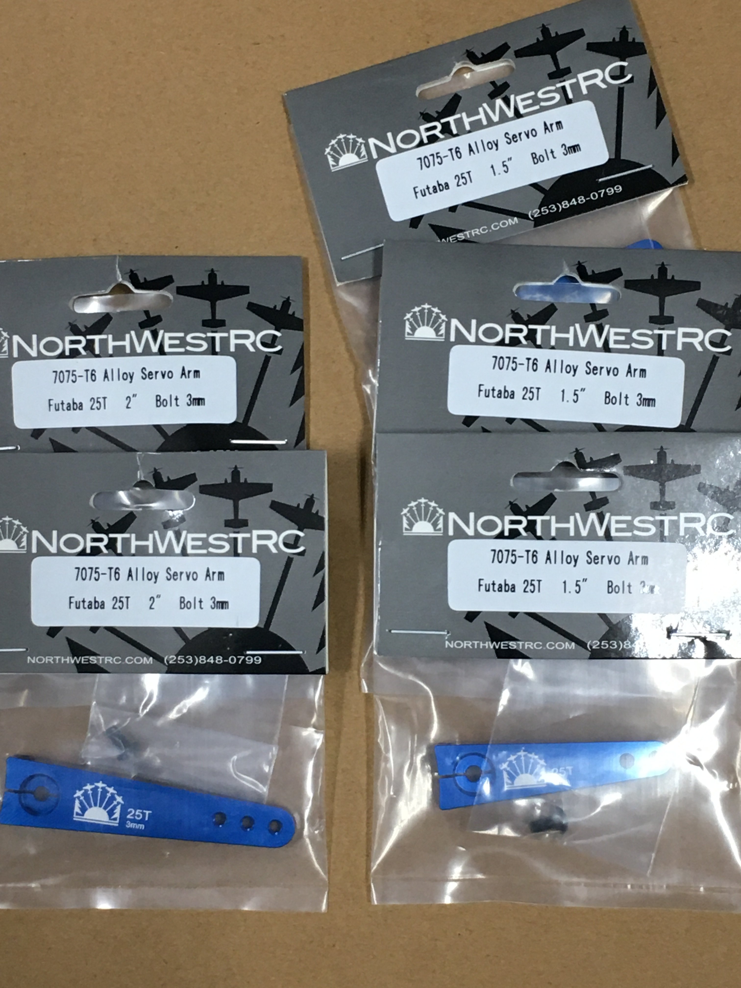

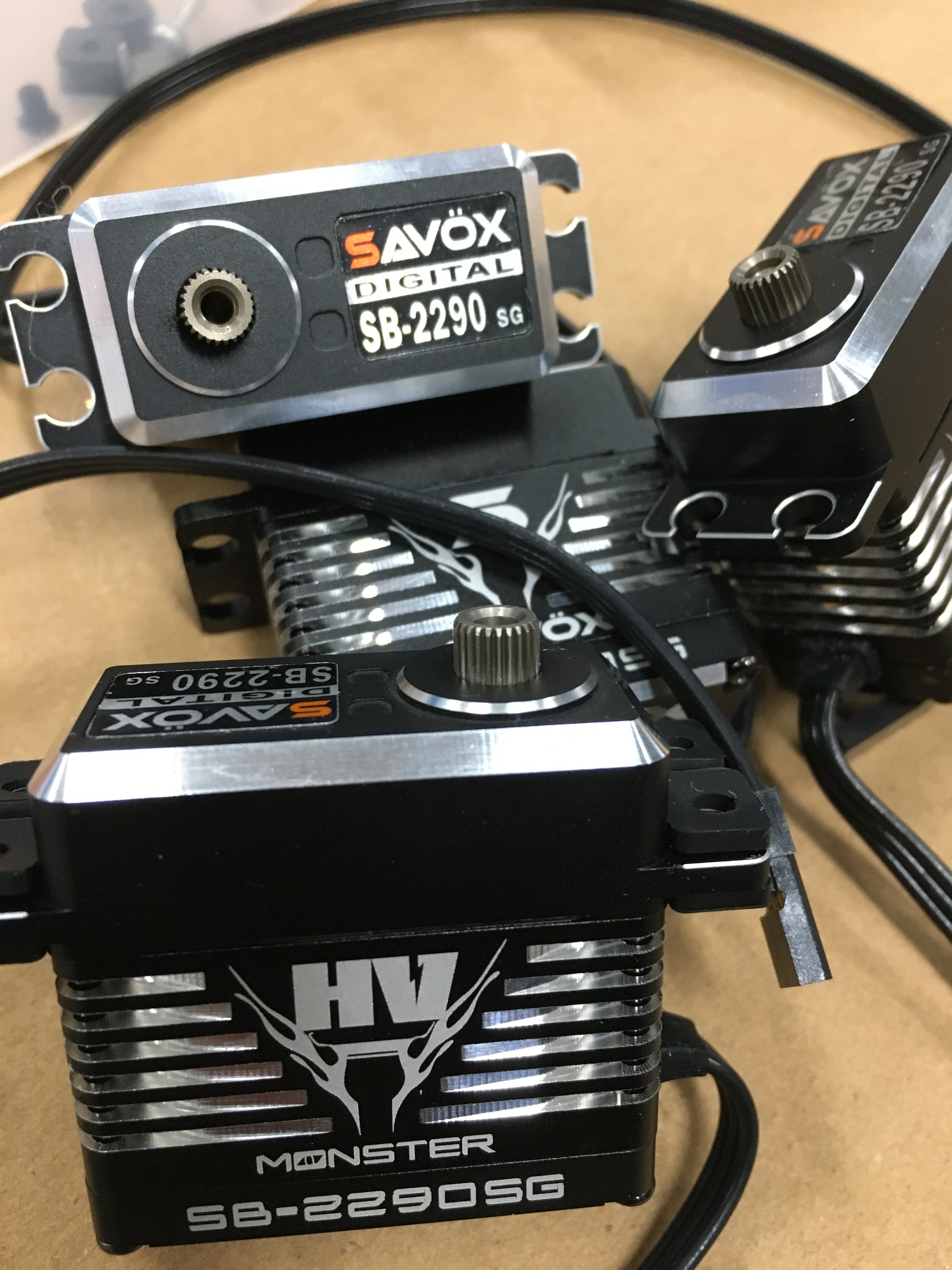

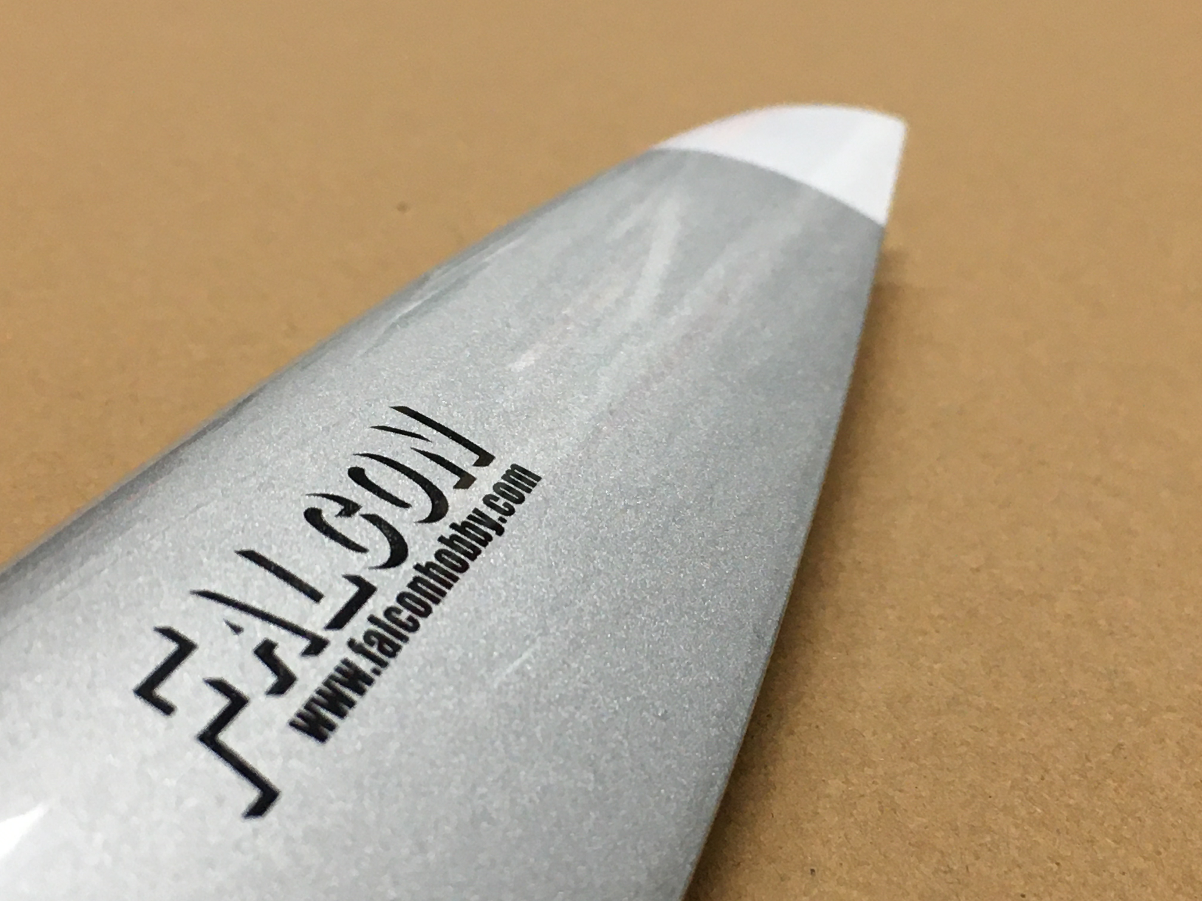

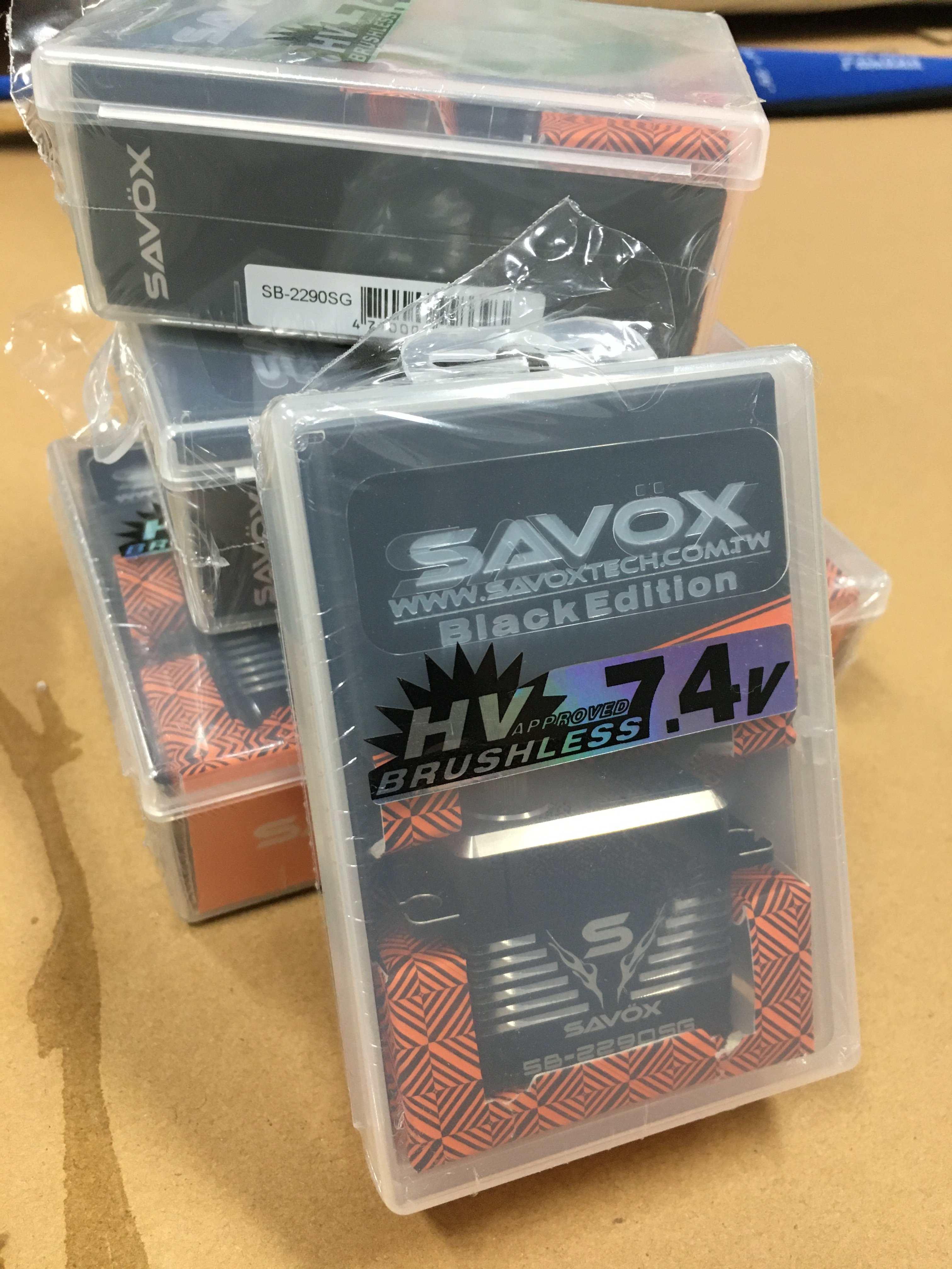

    Here are some of the goodies.
    9016B5BE-C082-47F5-AF57-4A40F8C2E255.jpeg DB92860D-7C9C-4E3D-9E0C-D8875EA54D42.jpeg AA00F75A-E98D-4779-A71D-21A5BA510767.jpeg A4A7C580-6BF8-4CAC-B7DF-49B7B38C6BF6.jpeg F0D5DCD7-F684-4060-8595-1DF99D8431D2.jpeg 052A9DDA-9F27-48B6-BE7D-0E5A789A6528.jpeg 933C3B55-ECD6-422A-84AF-5075E498591A.jpeg 087A0C8C-96FD-4BE3-AA31-5A78D0BBD087.jpeg B6FEA7D5-8F36-4F01-986E-7304415E3172.jpeg 7122CD20-C37E-4F58-854C-3F7649E8F5DB.jpeg 0FB2F8A0-5125-464F-8392-3A805F1D0902.jpeg AA578E91-37F3-4BD9-BC05-298F8BE5A7E6.jpeg 4452E346-CEF3-4B3F-8AB7-4DE3A7F4D2E4.jpeg B6244EDB-48CC-493F-A3D8-F8EC620492C7.jpeg 3FB80396-773A-49EB-AB9F-D2211F571D03.jpeg

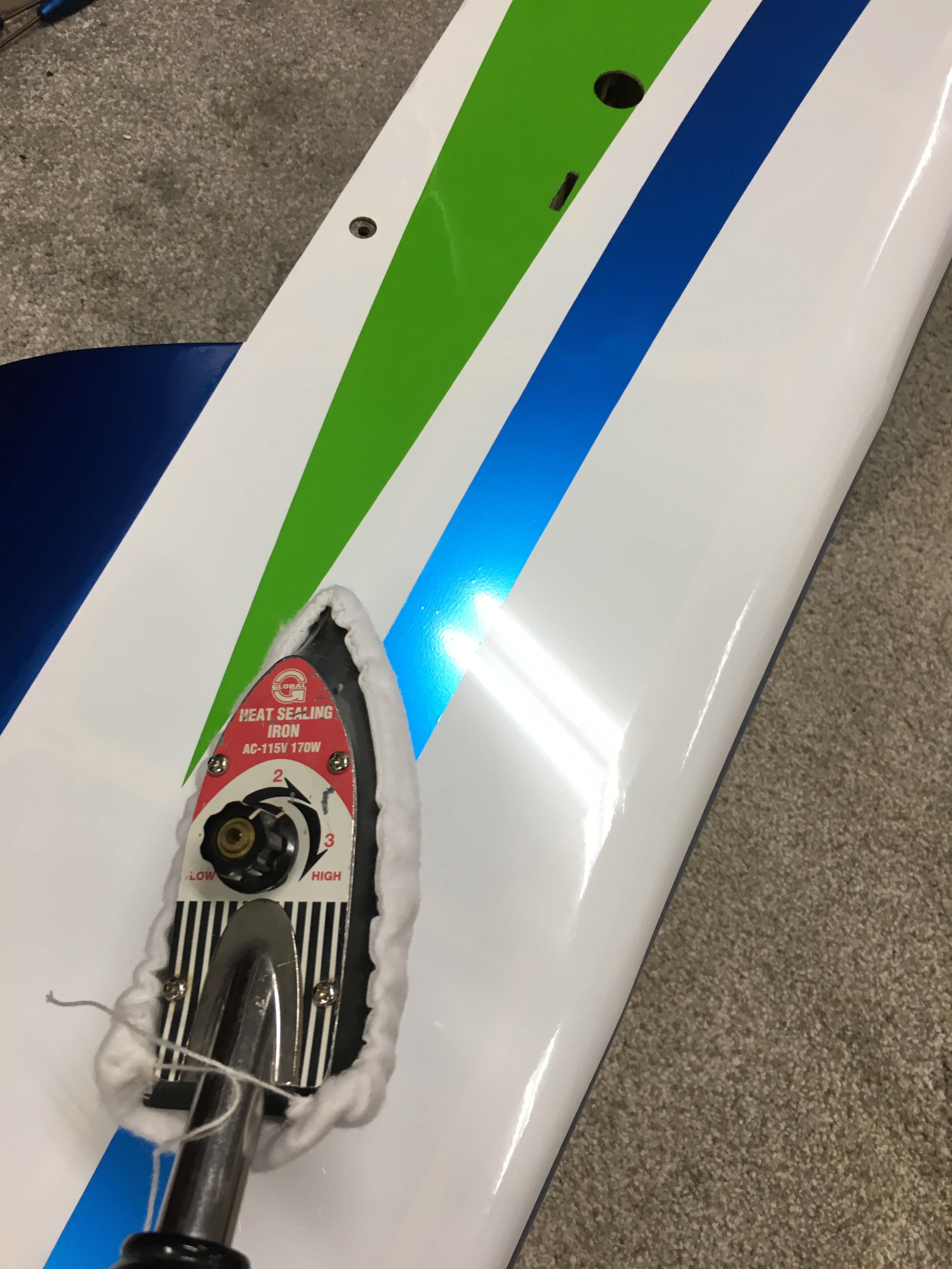

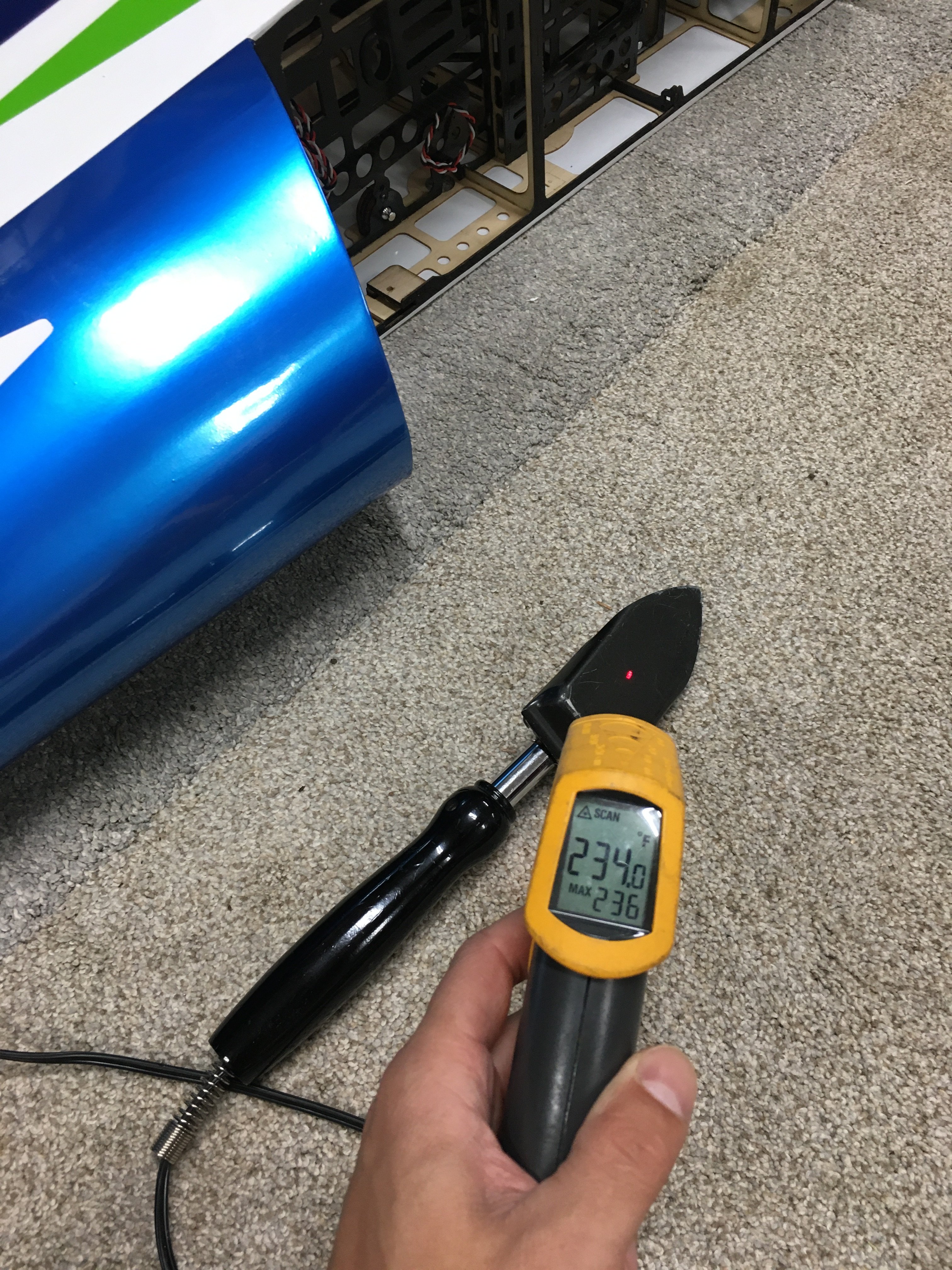

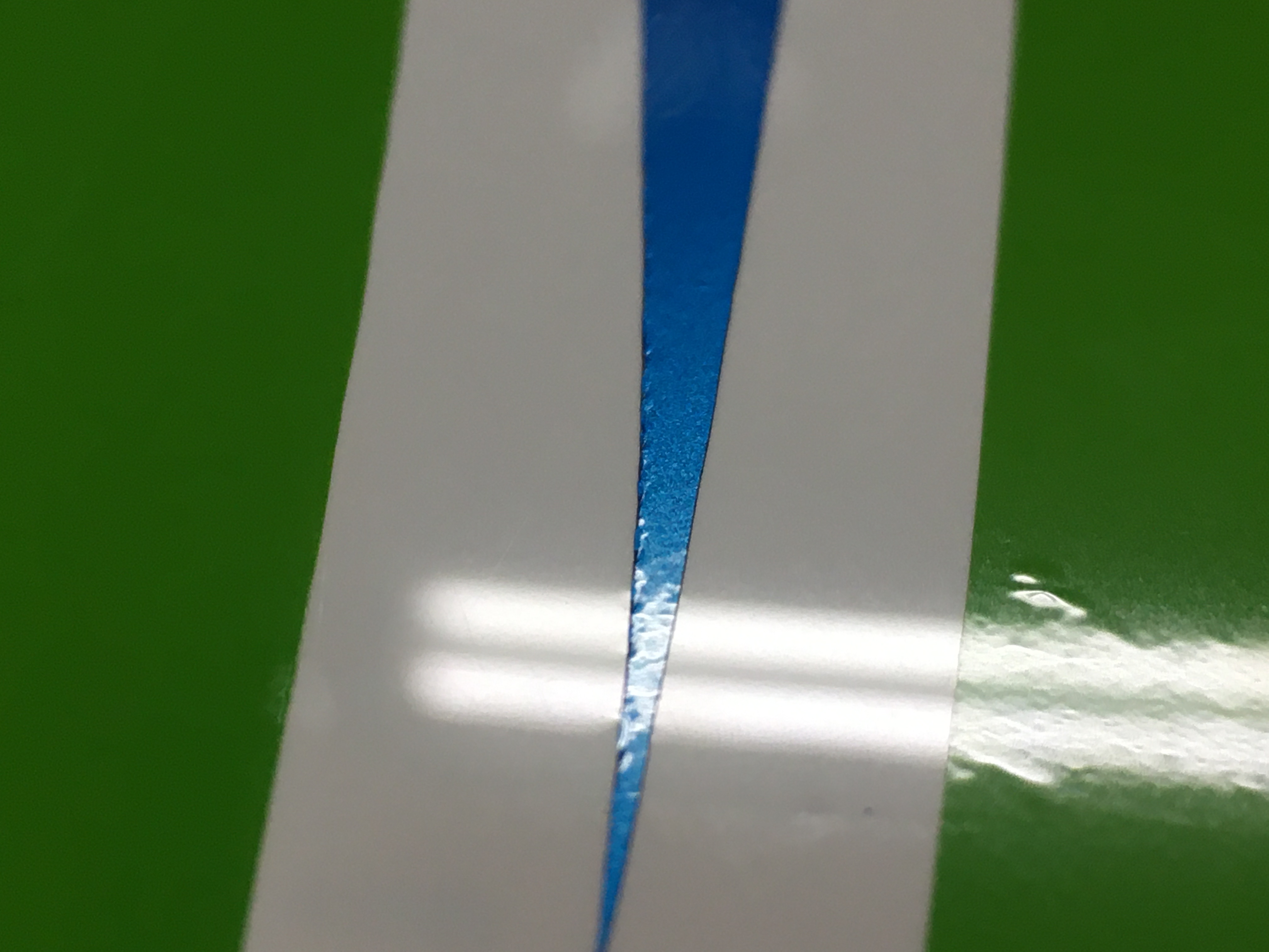

    First things first. Hitting everything over with an iron.
    230-240F the metalic covering sticks
    250F it pulls and the white backing will show around the edges.
    260F bad things happen. Be very careful and don’t use a heat gun. Low temp is your friend.
    I had a hard time with the sock, so it came off.
    986DE06E-6712-47CF-9ABA-C85AF323DC14.jpeg 22EC5706-CD4A-4717-8515-DCC8448D0090.jpeg

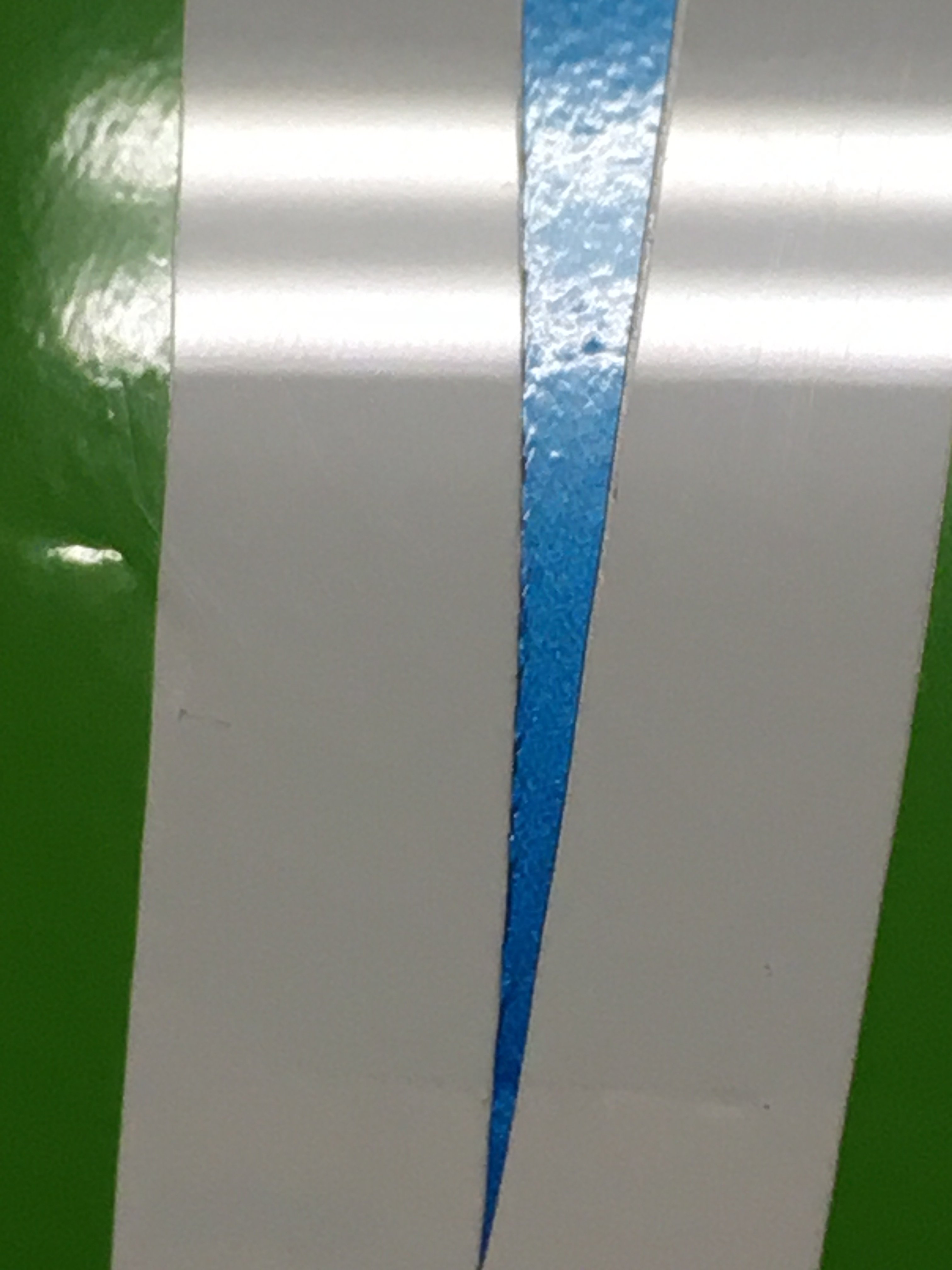

    Before and after tacking down the trim better. I will say that they use dull blades too often. Pretty jagged here and there.
    74485C32-3346-4819-B94D-809625E6F3DA.jpeg D840C58E-8A6A-44B4-89C2-DA3A7C56C78D.jpeg

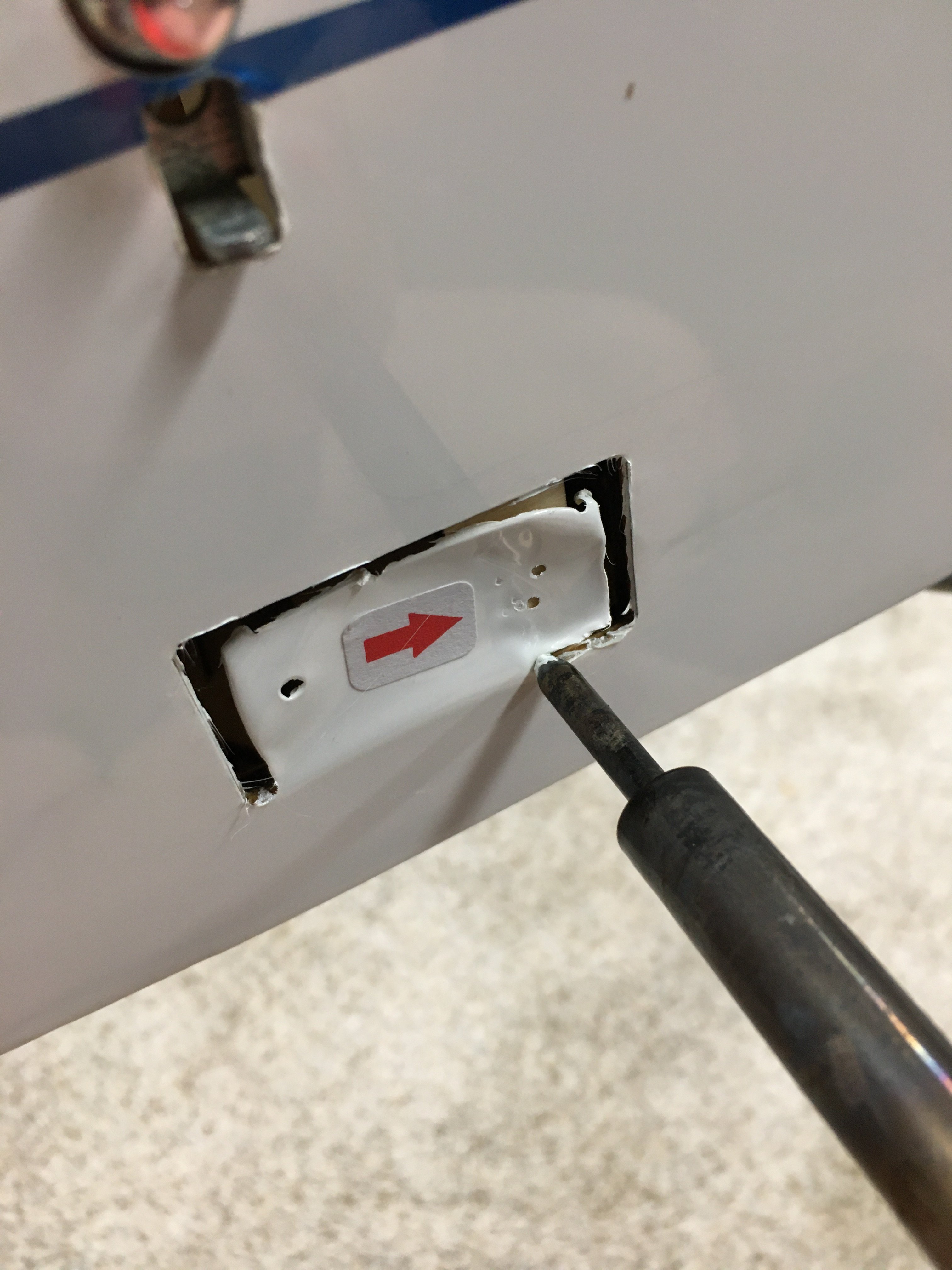

    Skywing likes to put little arrows where something is hiding... like an easy scavenger hunt. In this case it's where to open up the rudder servo bay.

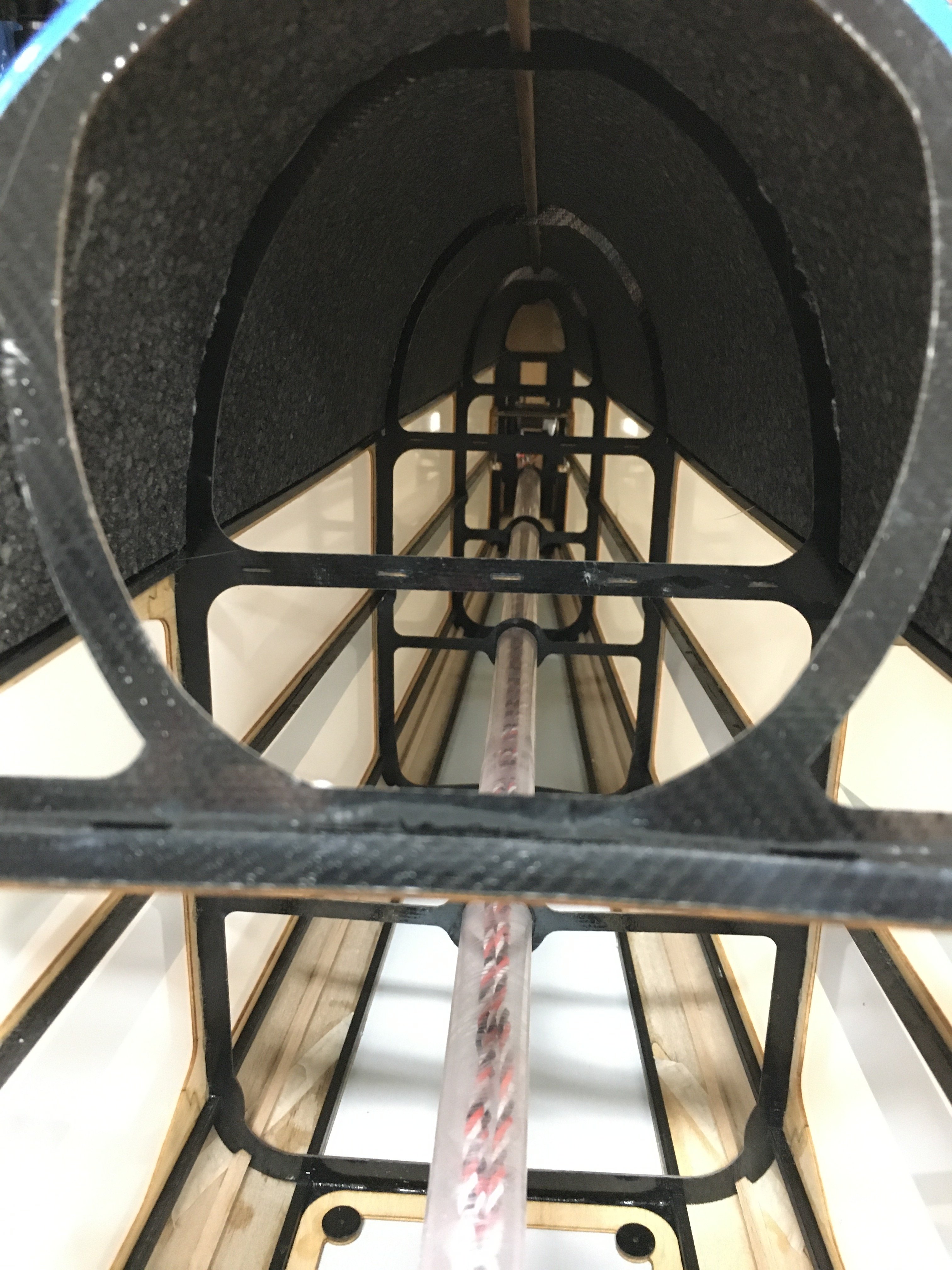

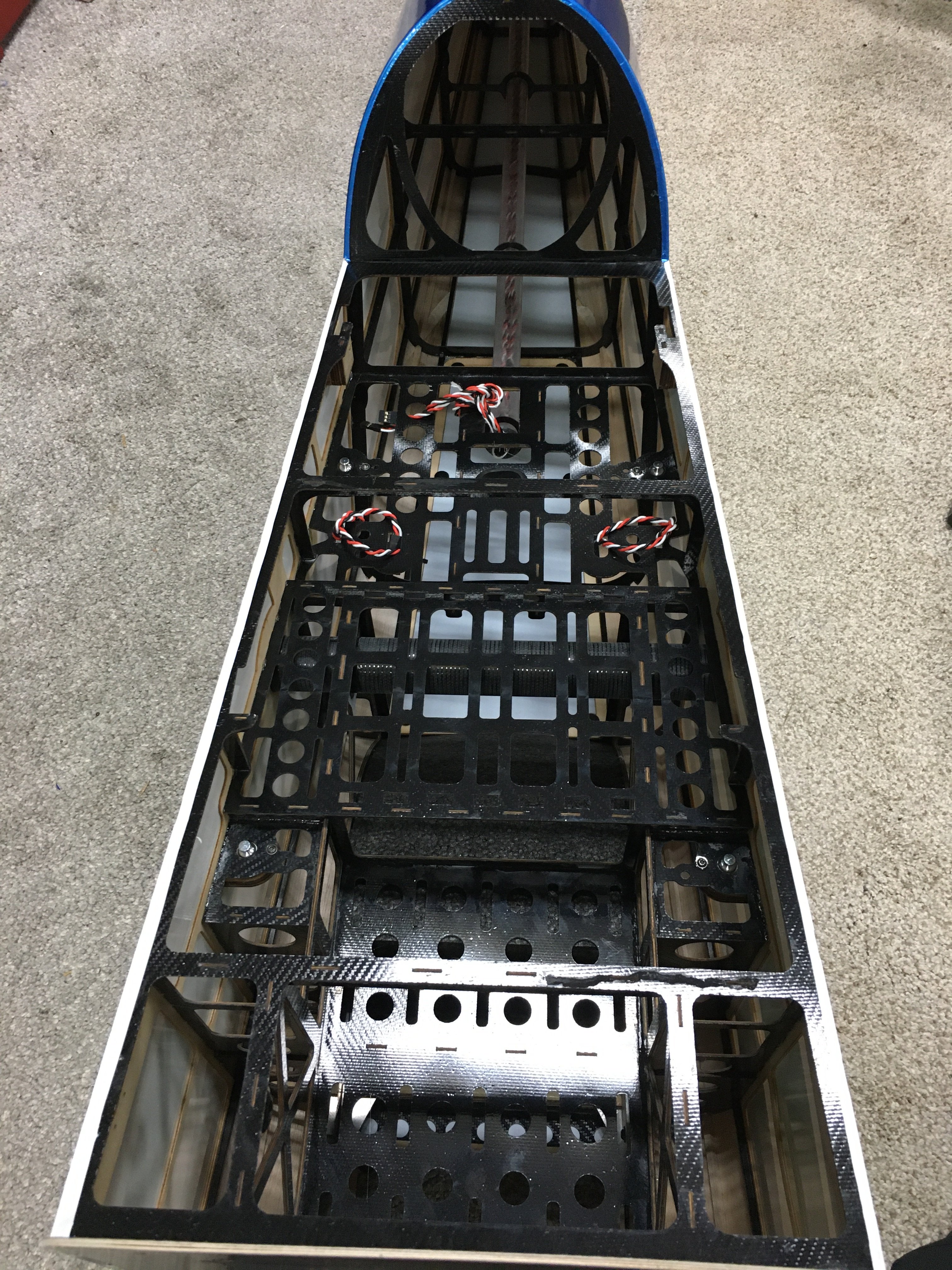

    Here are a few inside pics.
    Gotta day that this whole carbon/fiber/laminate is 100% eye candy.
    31FD52F5-872F-459C-9599-E0DD0F836277.jpeg 79497B16-0C85-4260-831C-EACB4DBCCBE1.jpeg

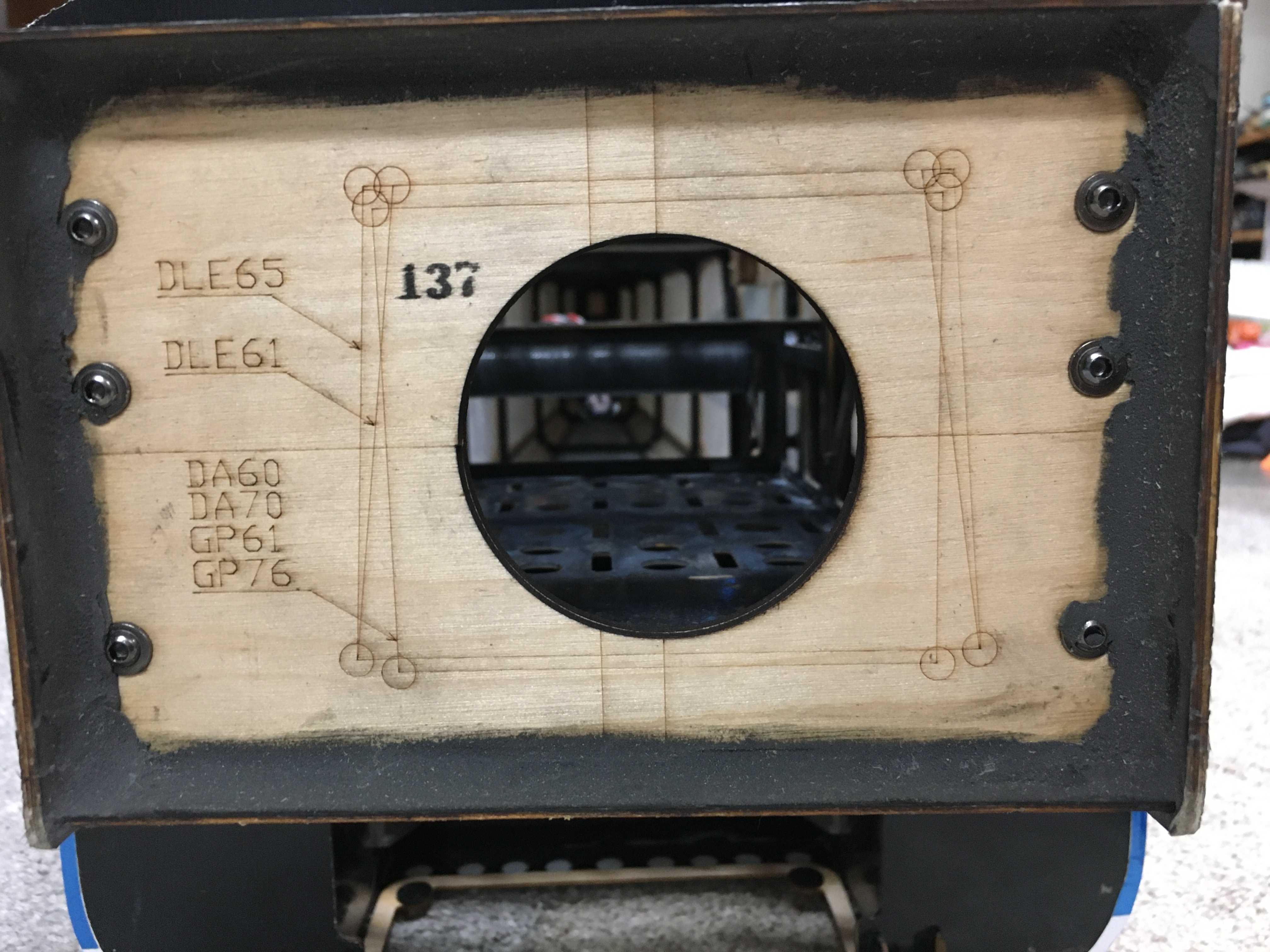

    check our all the powerplant options etched into the firewall. Even the new DLE65! I was considering it over the GP76, but I don’t like to be a test pilot for new engines... although I hear the DLE130 is a splendid engine.
