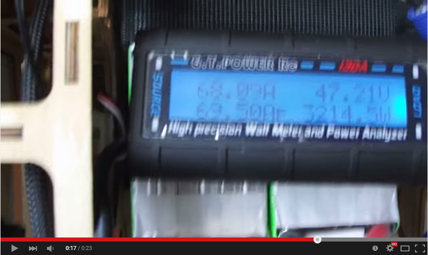

Okay so here the latest update for those that wanted to know. Got some actual measurements for ya. Hope you enjoy it as much as I did doing it.
Kind of a challenge doing on your own, hopefully you can see it alright. I put down the numbers on the page.

Close enough, kind of like the weight. I had the benefit of being able to slow the vid down to see where it peaked. Below is what I wrote up under the vid.
Published on Jul 6, 2015
Alright fella's I finally got around to taking the actual measurements of this motor setup. So here it is.
Motor: Motrolfly DM 4330-216Kv
Prop: Xoar 20x8 wood
ESC: Mezon 90 w/RPM
Batteries: 2 Pulse 3700maH 45C in series
Looks like it peaked out at 3214.5 watts
Plane weighs 9.5 to 9.75 pounds don't have a digital scale "Need to get one" I used the 9.75lbs for my calculations.
So If I have done my math right that should be 3214.5 divided by 9.75 for 329.69 watts per pound. Think the max amps it pulled was 69 amps. So not to bad, Im right at what manufacture said was the max wattage of 3200. Guess I wont be putting those 5000maH batteries in.

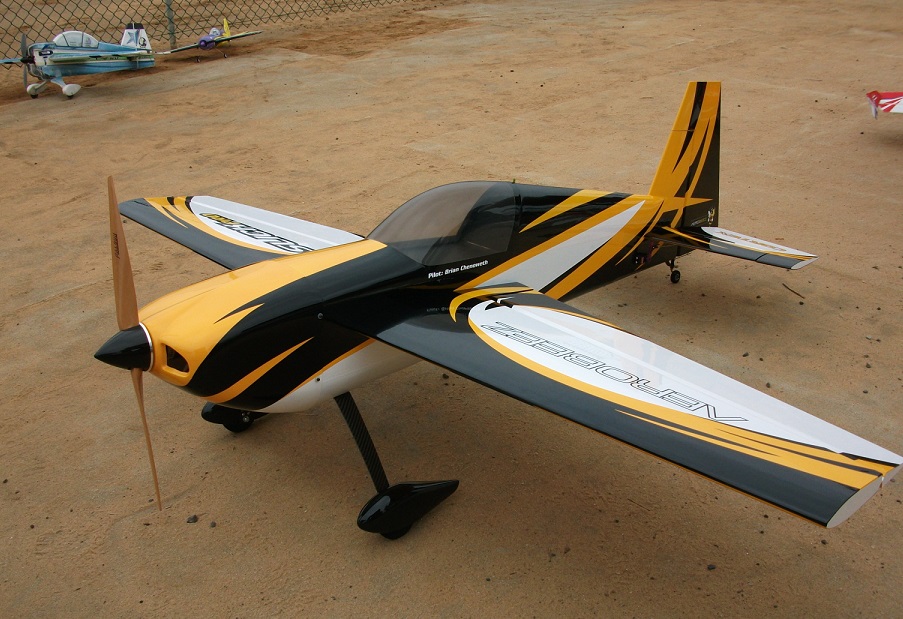

Maiden successful! Got in a couple flights flew great, controls were set up was pretty far off of what I like so I'll have to hold off on the comments for a while until I get her dialed in. It balanced with my 6S 6200 packs right up against the wing tube, if it was nose heavy there was nothing I could do but add tail weight. I'll definitely be getting some lighter 6S 5000's.
I will say I KNOW this will be a real hoot once I get some more time to set it up.
