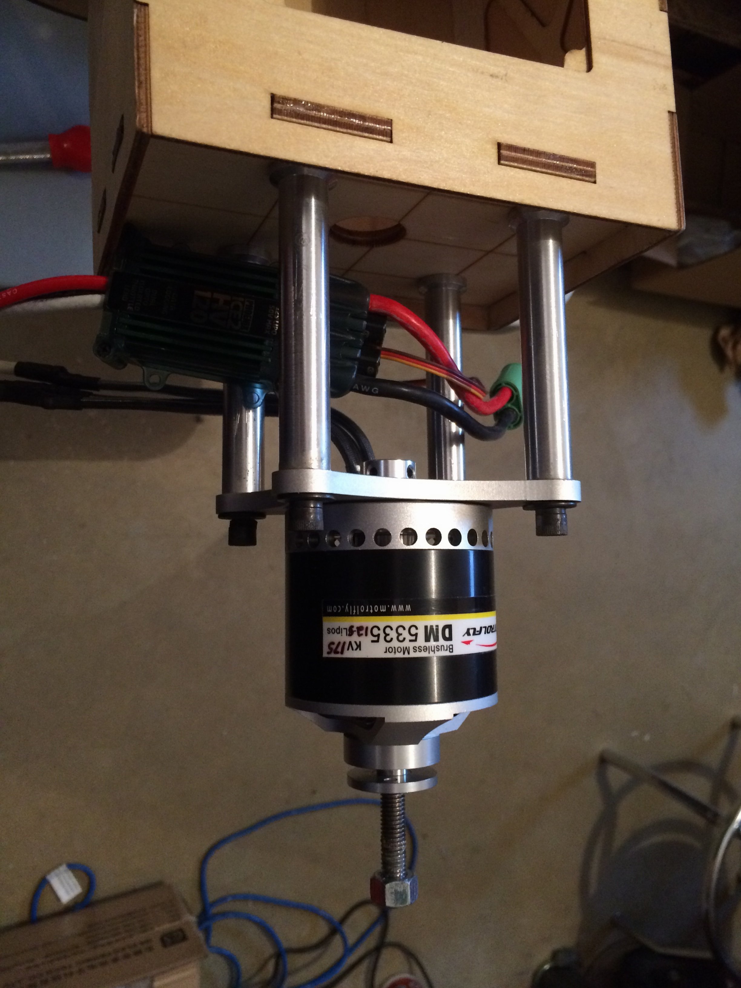

I'm new to posting here, been mostly perusing threads. I didn't see any threads on the MXS-R so I thought I'd post up my build experience and process. I picked this little gem up about a week ago. It's my first Aerobeez model and I have to say I am very impressed with the value and quality of this product. I will be building this ARF as an electric setup to be able to run it at Watts over Owatonna; a local all electric event here in Minnesota. It will be setup for 12s running a Motrolfly 5335 but may receive a Scorpion test motor in the near future.

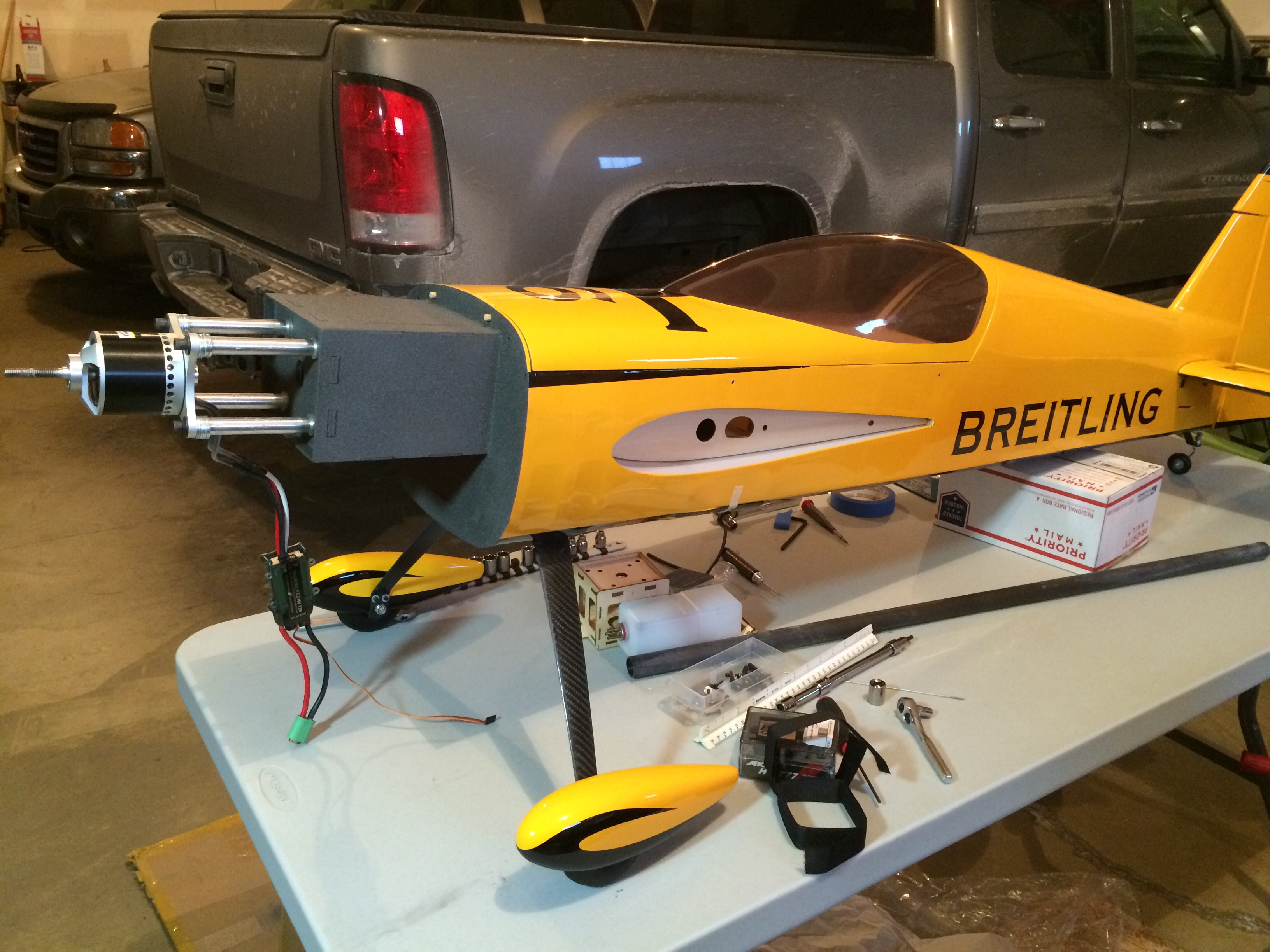

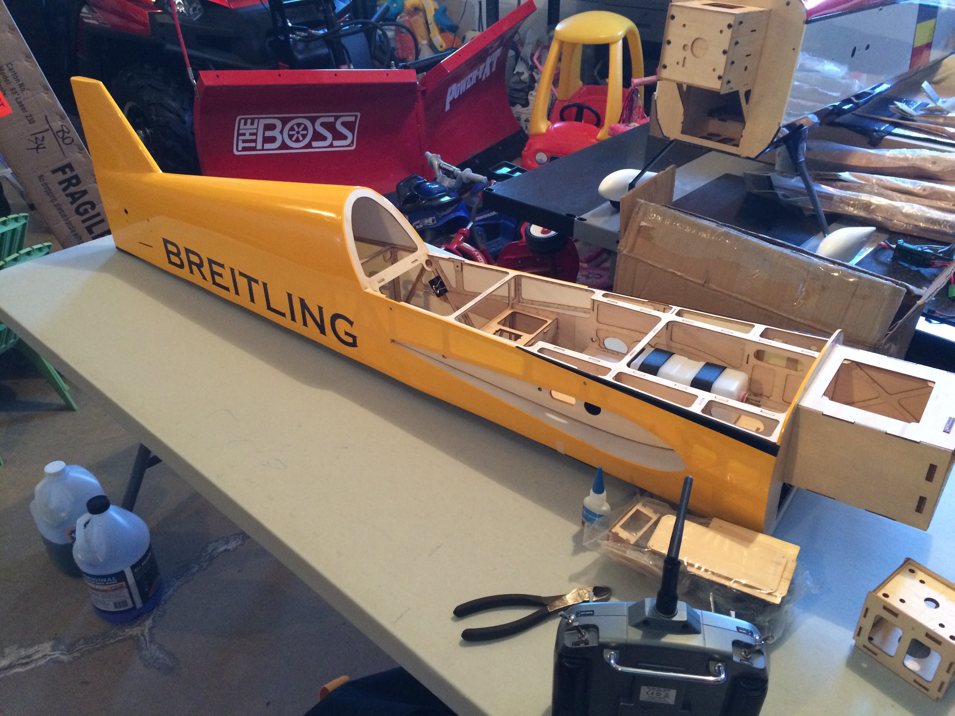

The fuse out and inspecting. Please forgive the mess in the background.

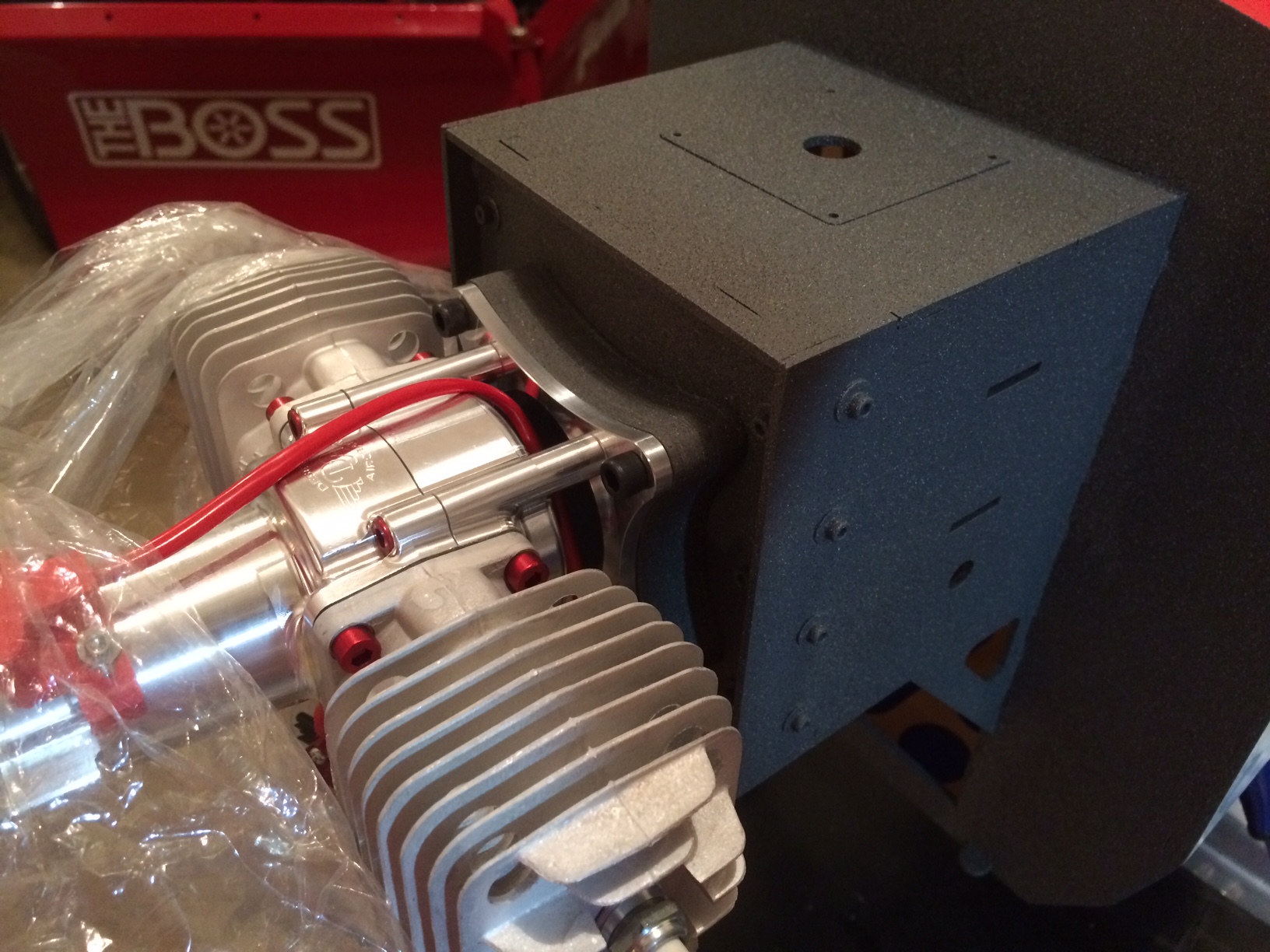

Test fitting everything...real tight fit!

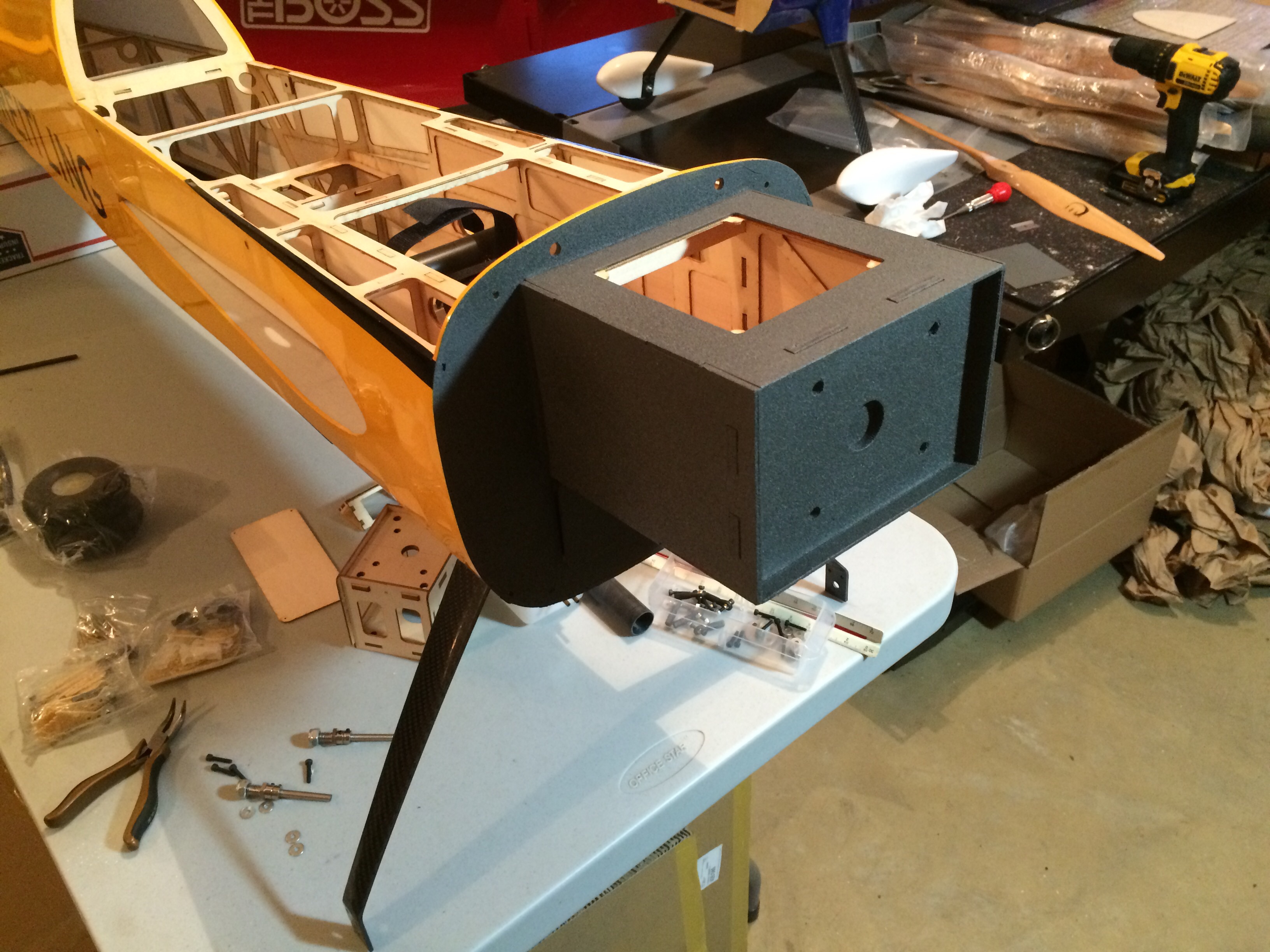

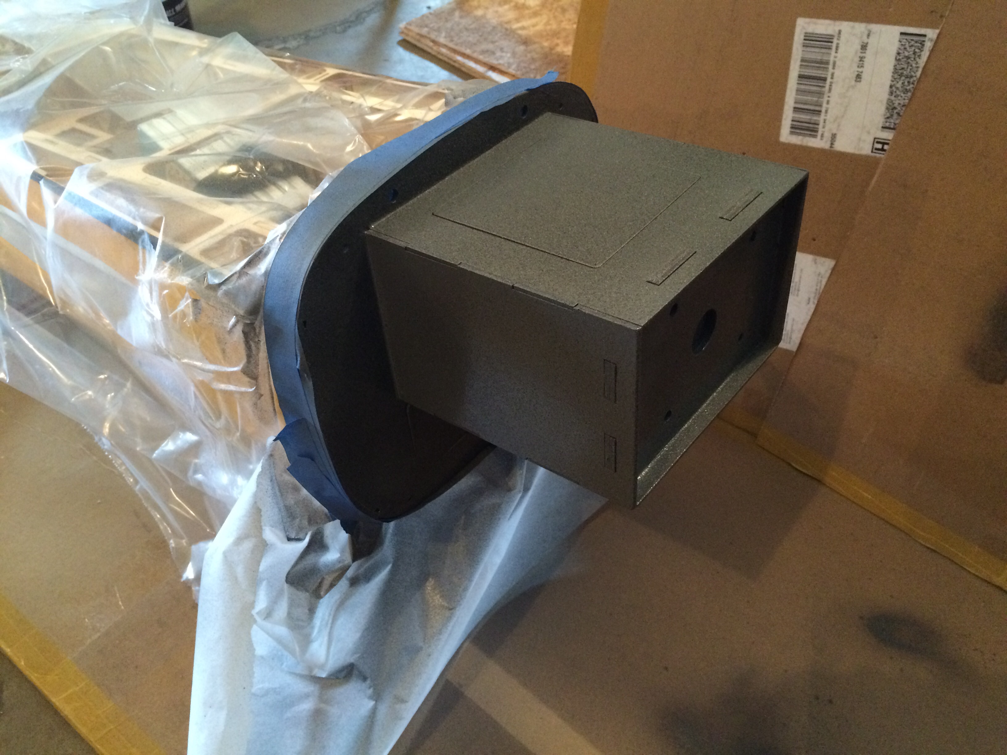

Firewall drilled and motor test fitted.
Stand-offs are short by 3/8". I'll have to make some new ones.
All my large scale models receive a little paint work.

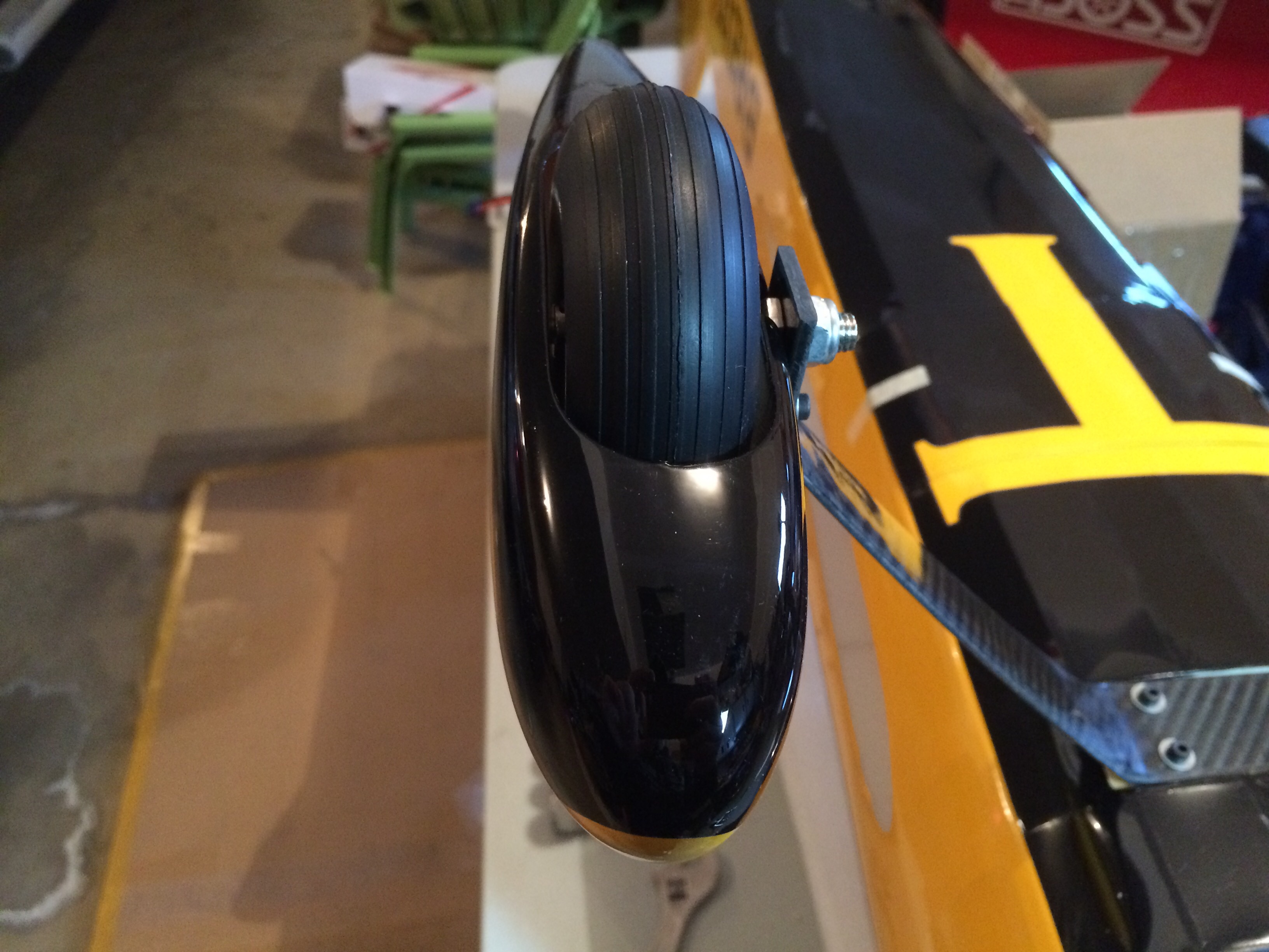

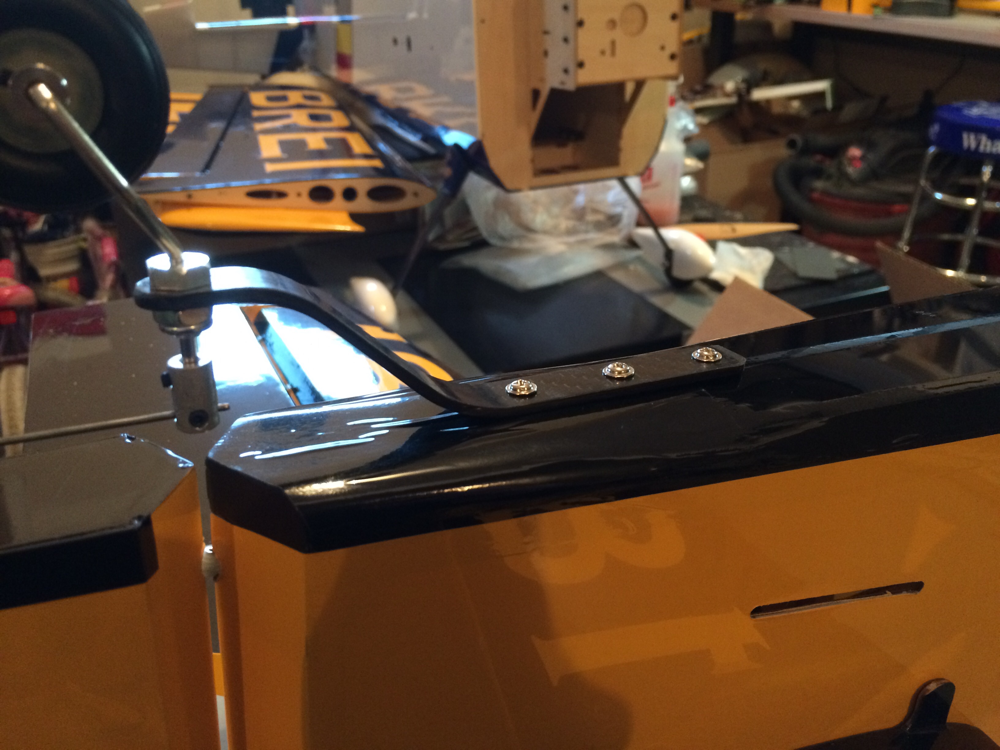

Installed the wheel pants and centered the wheels. The mounting holes and the blind nuts lined up very well and was a clean and smooth installation.
I assembled the tail wheel and installed it. Most other kits the assembly is pre-done. Just a little more work here. Mounting it to the plane consists of 3 wood screws. 2 of the 3 screw holes lined up well within the mounting block but the 3rd hung off and was lining up with one of the spruce ribs. I'd prefer all 3 in the block but that wouldn't allow for the tail wheel pivot to line up with the hinge line. It should hold up just fine though. (Would love to see blind nuts here on future models.)

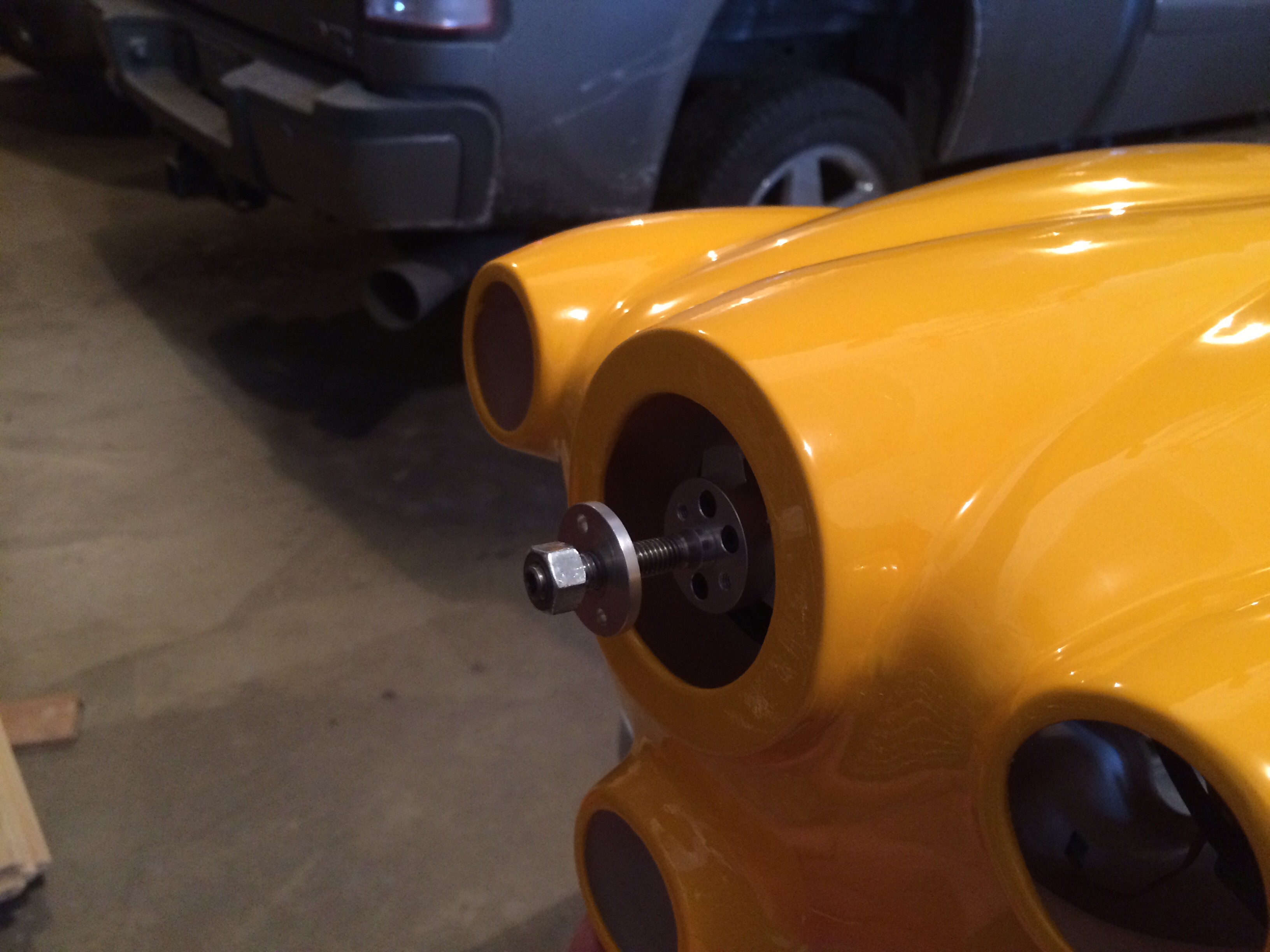

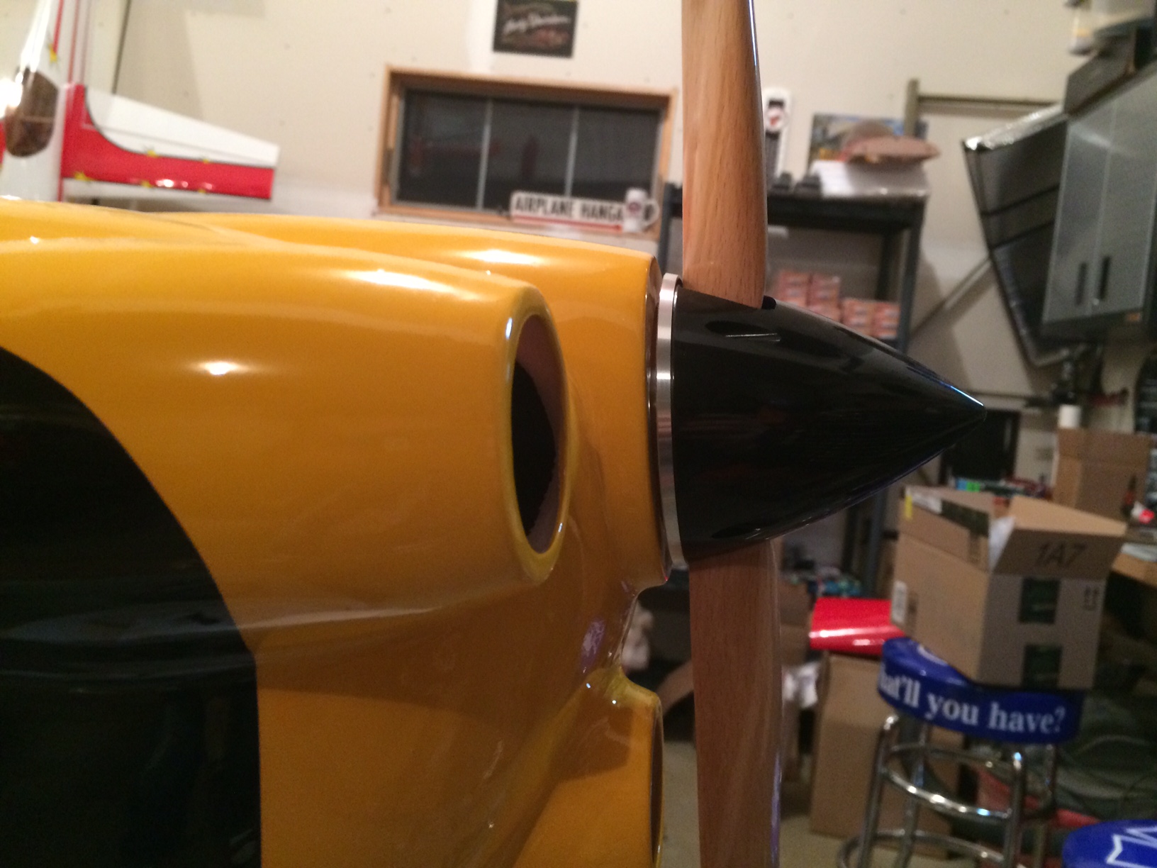

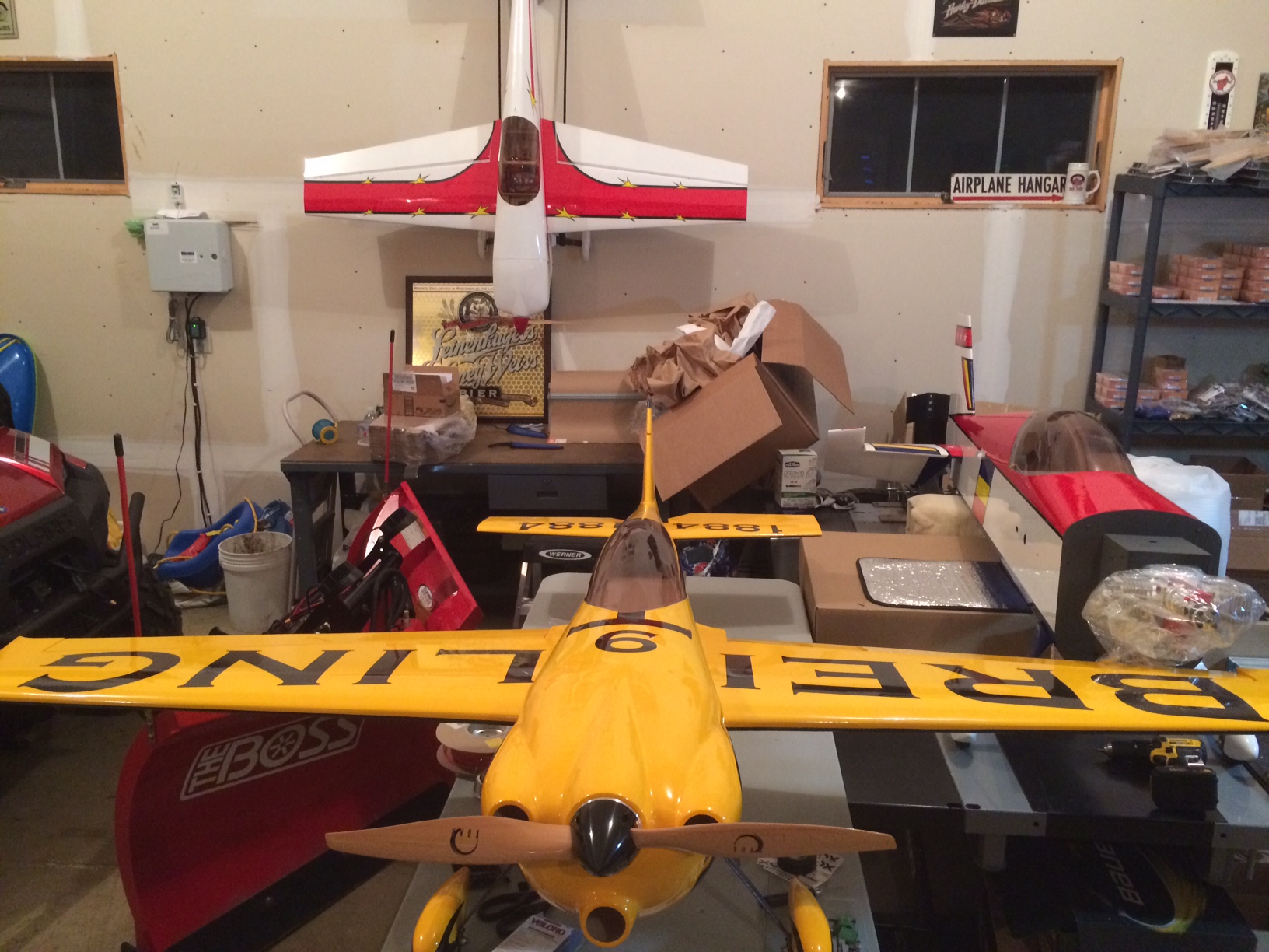

It took a little time and adjusting but i was able to get the cowling to fit nice with a very tight Spinner gap.

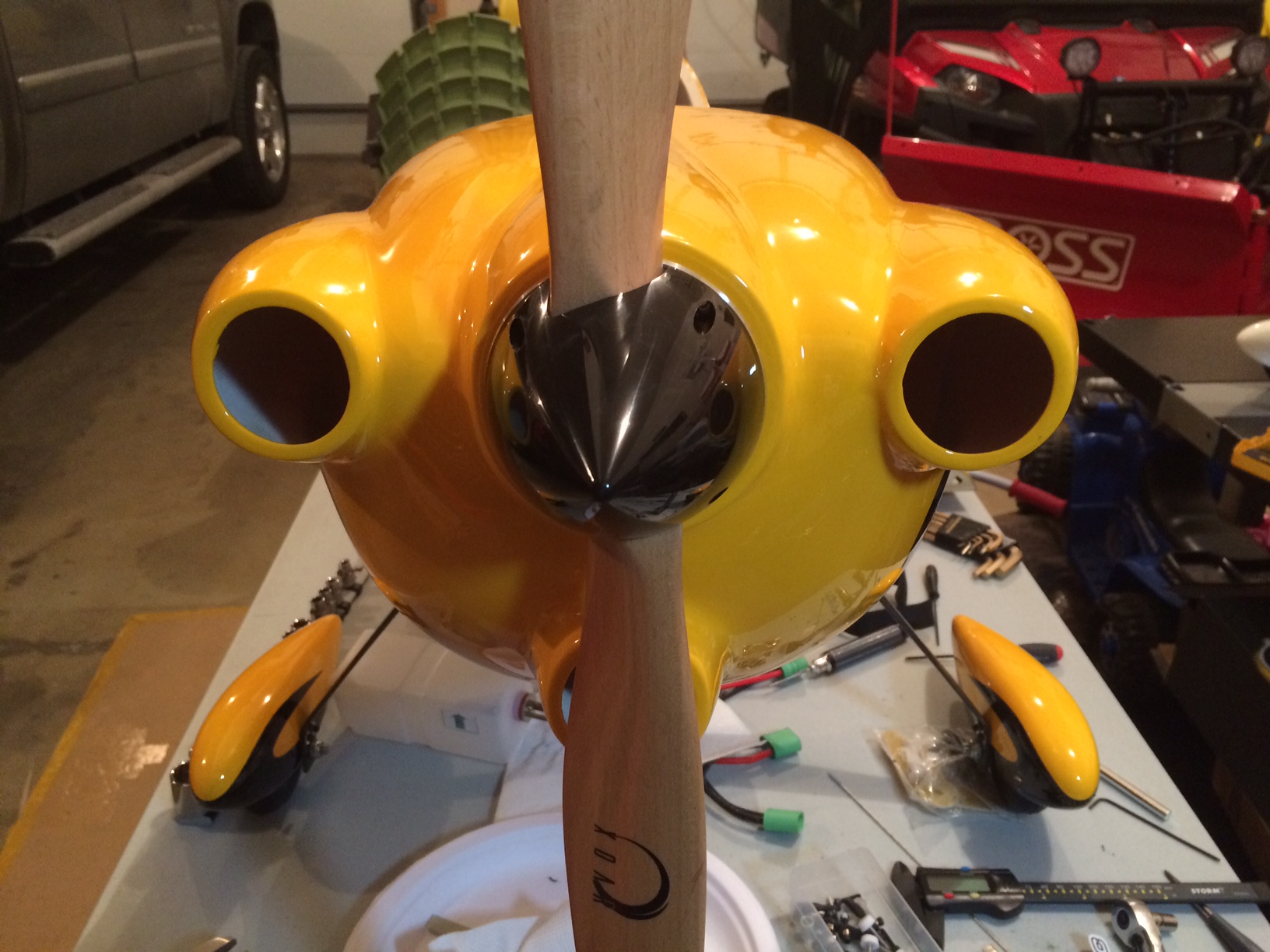

Since this is an electric setup I had a hard time finding a spinner the right size. I settled for a 3.25 Great Planes for now. Looks a little small but will keep searching.

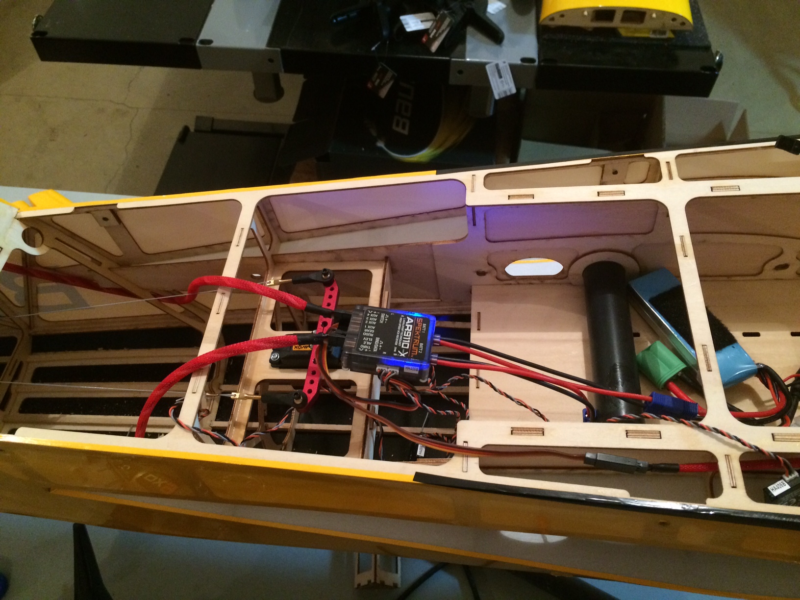

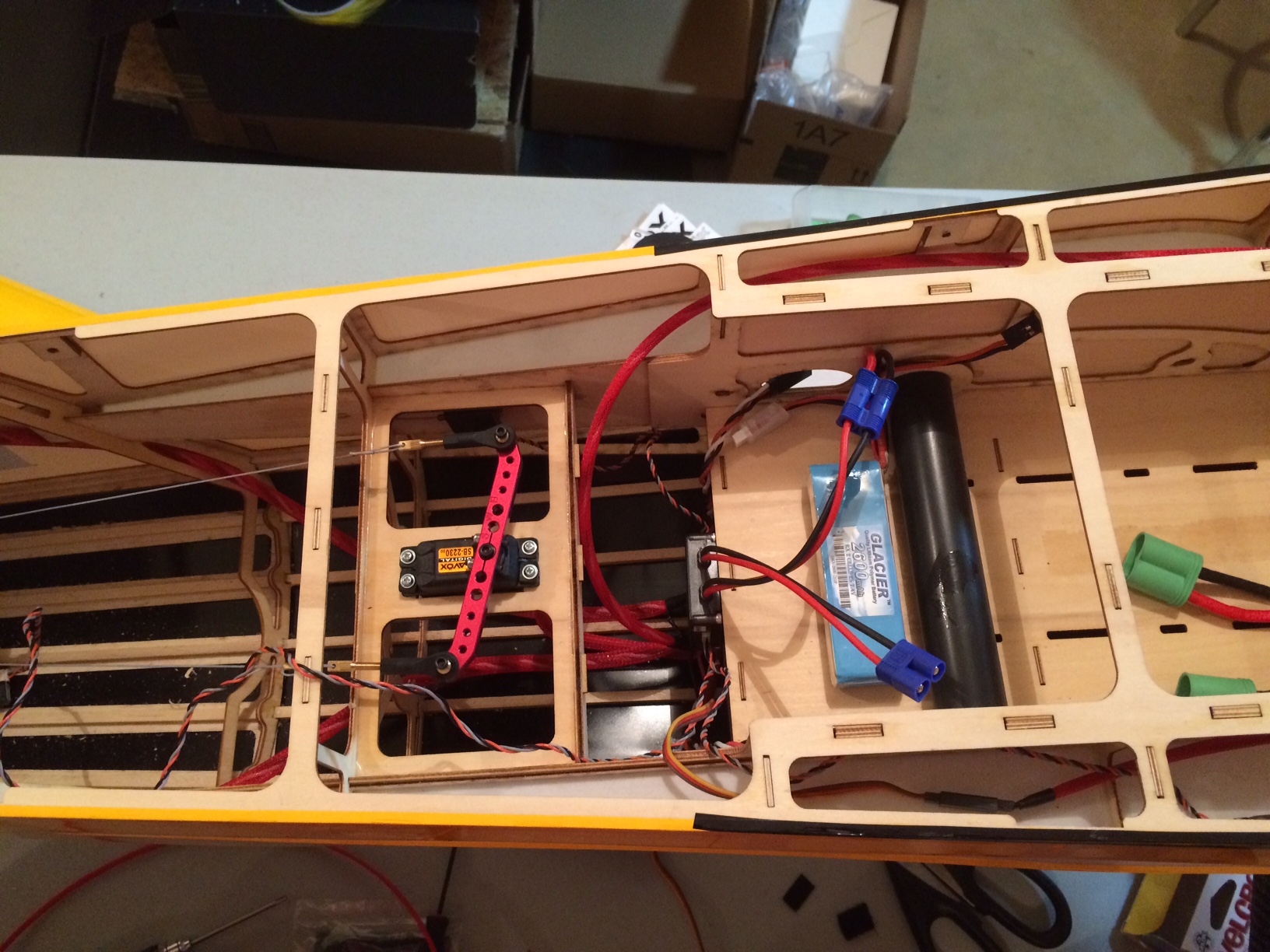

I was able to get all the Savox servos installed and extensions sleeved. I am running SV-1270 for elevators and ailerons and I'm giving the SB-2230 a run on the rudder.

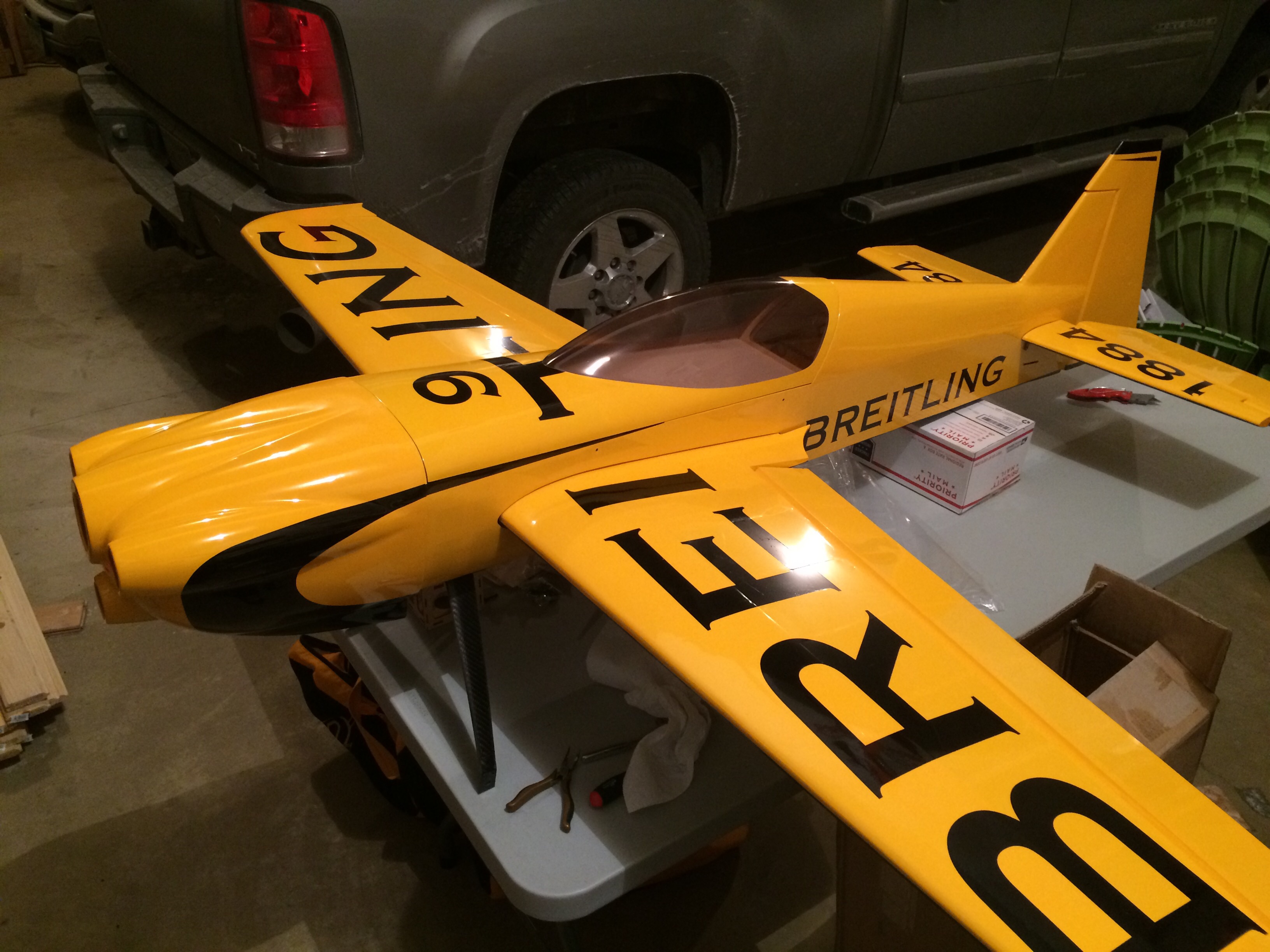

Finally, wings are on and nearly ready for a maiden flight. Ailerons are slightly warped so I will have to try and straighten those out and program my TX then I'll be... :flyer:
