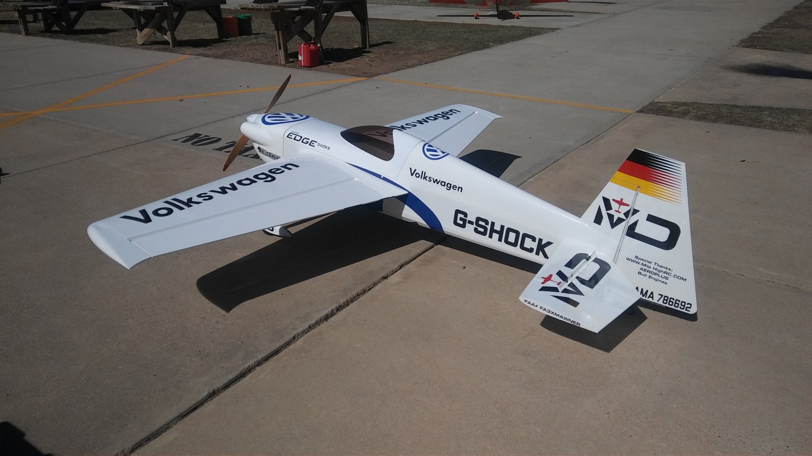

It came in at 9 pounds 3 oz I had to put a chock servo in and I believe that just put over the 9 lbs. when I get chance later this year I will take another look to see if I can eliminate the choke servo but for now it going stay as it is.

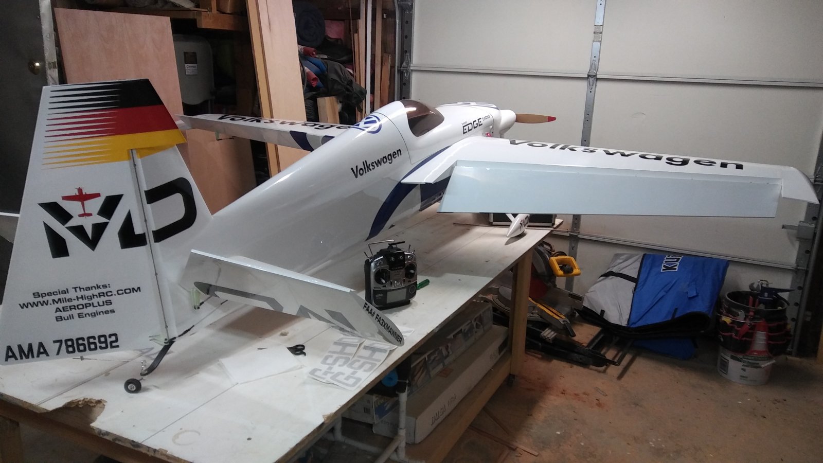

To get my CG at the recommended starting point I ended up moving the flight batteries as far forward as possible, installed an 8oz. White rose prop washer, and filled the tank just to get close to the "6-1/6" inches from the LE. With no nose weight and the recommended battery placement it was closer to 7-1/2"

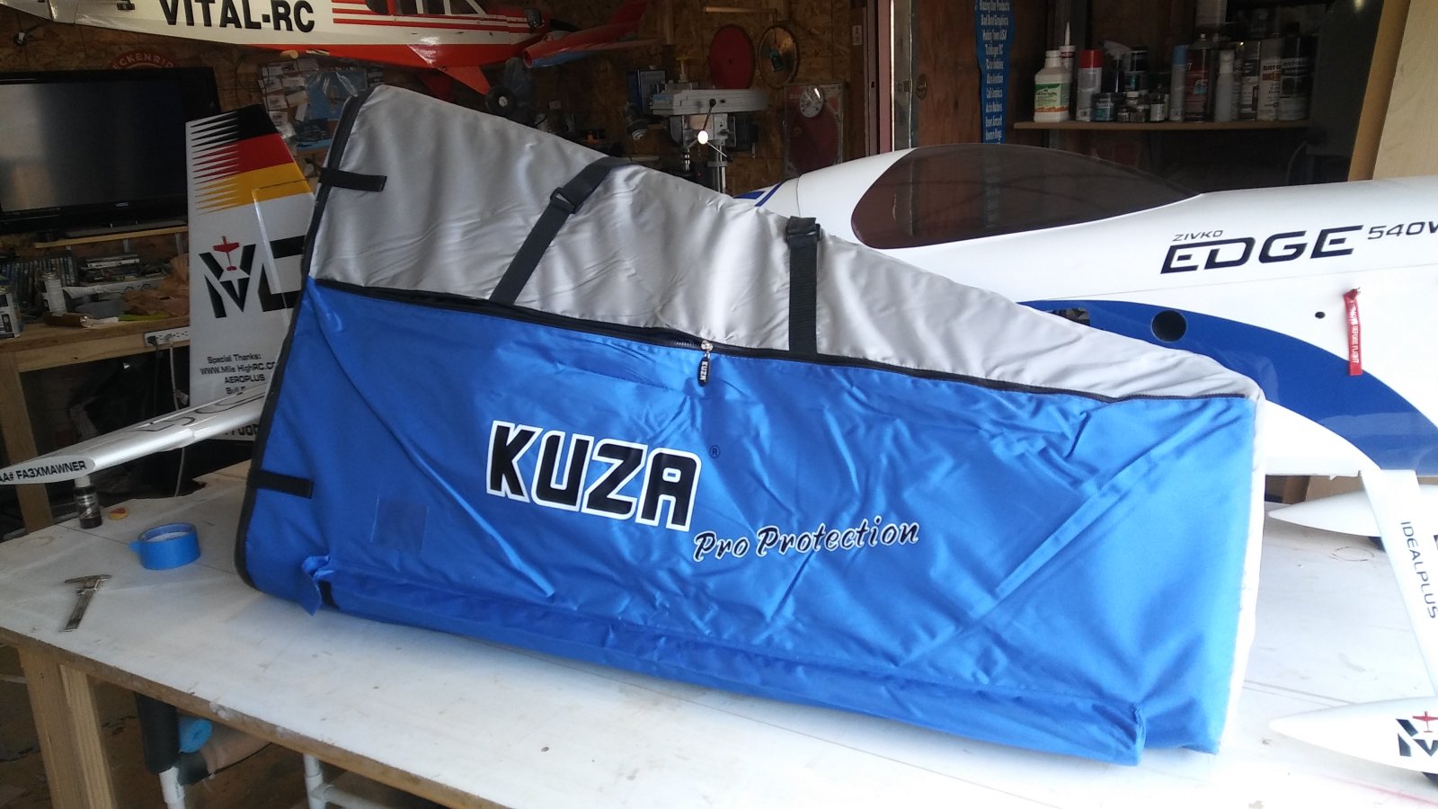

I really like these MileHighRC.com /Kuza wing bags! Light weight, heavy duty nylon, padded wing pockets, wing tube sleeve, plenty of room for 111" wings, complete with 2 large stab pockets that will each hold an entire horizontal stabilizer.

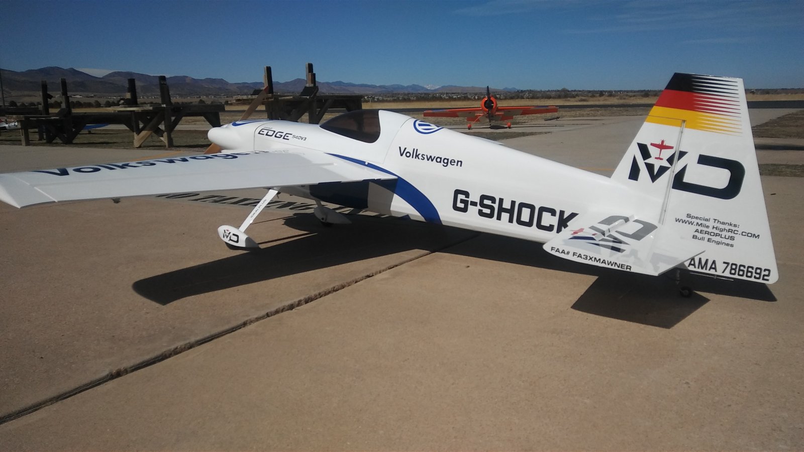

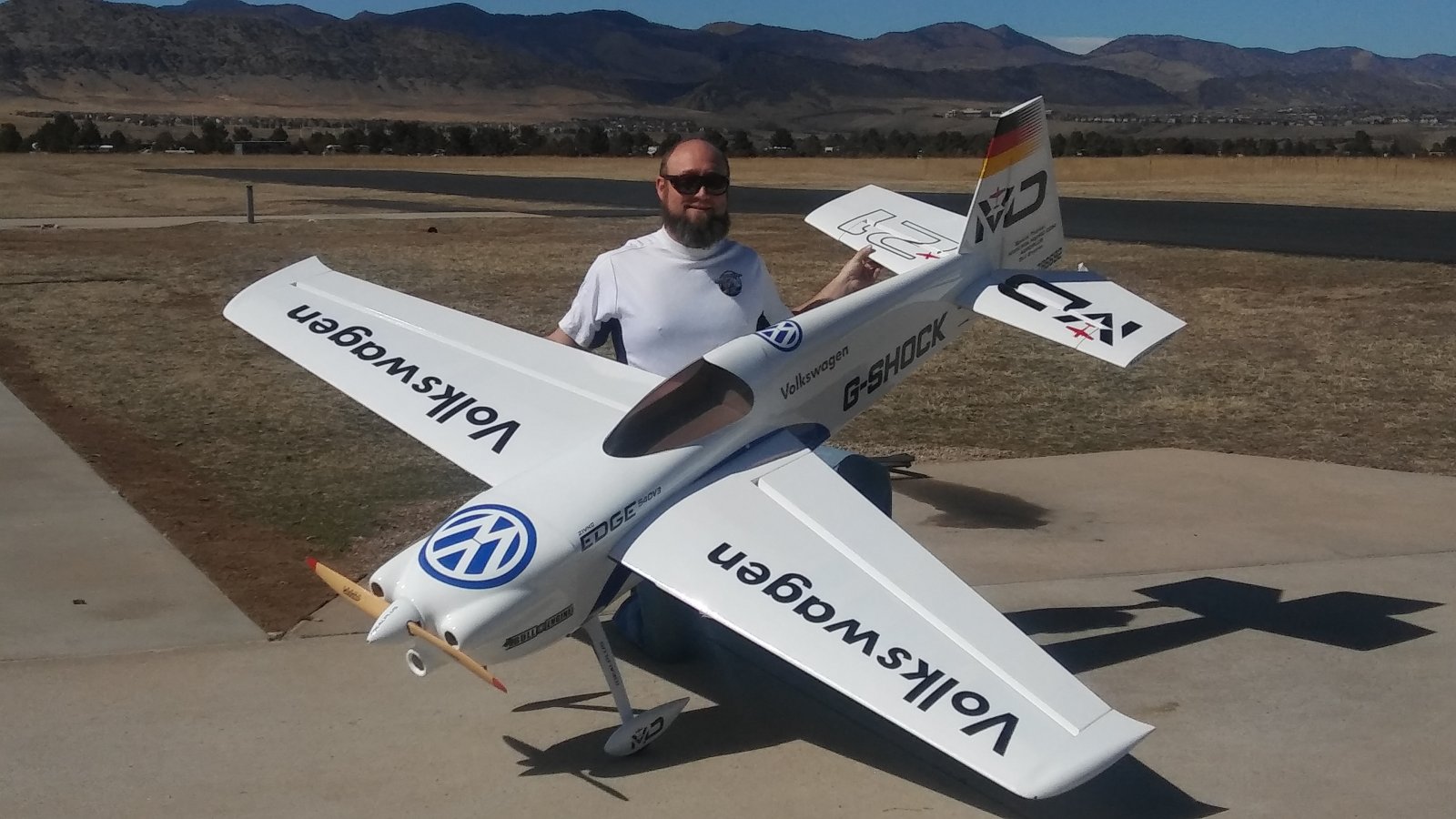

Despite some very gusty conditions we managed to maiden the Edge today! A bunch of flying buddies decended on Chatfield. It was great seeing so many familiar faces!
Getting the BE 124 running was a bit of a saga. I had already made sure the carb was primed with fuel before I even left for the field. Once there I immediately discovered made sure the tank was sealed properly. After flipping the motor with the choke on about 50 times it popped once and quit. Choke off, repeat. Took the cowl off and went over all electrical and fuel connections. Choke off, pop and quit. Repeat about 20 times. After backing the low needle out from 1.5 to about 2.5-3 turns it finally stayed lit. I fattened up the high from 1.5 to about 2.25 turns and ran it through a full tank with variable throttle settings before trying to tune it. After another half tank and a lot of starting and stopping we ended up closer to 3 turns out on the low for a decent transition. Cowl back on, and another 10 minutes of tweaking, fattening the bottom needle and leaning the top end some more we got it to the point we thought it was good to fly.
First flight, it popped off the ground no problems. Elevator was sensitive even on low rates and factory recommended CG. Two clicks of down and two clicks of right Aileron and it was tracking straight. As soon as it was airborne the engine started burbling like crazy. I kept it high and did some basic trimming. Inverted 45 pulled to the canopy pretty quick. Knife edge had very little coupling but barely pulled to the canopy. Changing the attitude of the airplane changed the way the engine ran. After 5 minutes I landed and went over everything and charged the batteries. To my surprise the batteries were almost depleted! Just from tuning and one 5 minute flight it burned 2700mah!
I moved my freshly charged batteries back to the stock location. Taxiing out in a heavy crosswind the tailwheel split and fell off the hub. I took it up for another 8 minutes. Inverted 45 was almost straight with a slight fall off to the nose. I flipped high rates and holy cow! This thing is responsive! I did a wall and the plane rotated 135 degrees! That's from upright flat and level to inverted 45 in an instant. Then, for fun I hit full down and full throttle and it did a crazy blow over. After a few more laps I brought it in for a landing.
This flight burned 600mah! My buddies said they could hear some binding, so I'm going to go back through my servos and make sure they are all still matched properly.
Engine is still running rough in the air, so I'm going to try to cover the bottom inlet in the cowl with some screen to diffuse the air. Hopefully it will dampen the effect of the air hitting the vent on the carb.
Whew! Lots of words! It was great seeing so many flying buddies today. Two successful maidens. Good day
