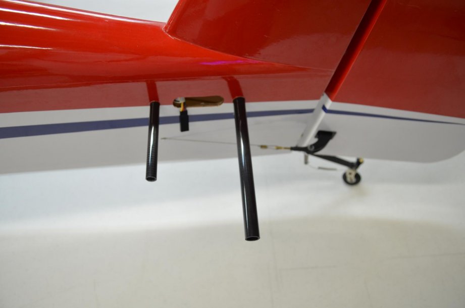

What did you use to keep the extension from falling back in to the fuselage? I am thinking of using tie straps around the fwd stab tube sleeve in the fuse.
Is the offset rudder horn needed or will a straight one work?
I'm thinking that it would work. I personally used the offset one. If your worrying about deflection of the rudder, don't worry. It's super affective despite how small it looks as compared to the large airframe.
