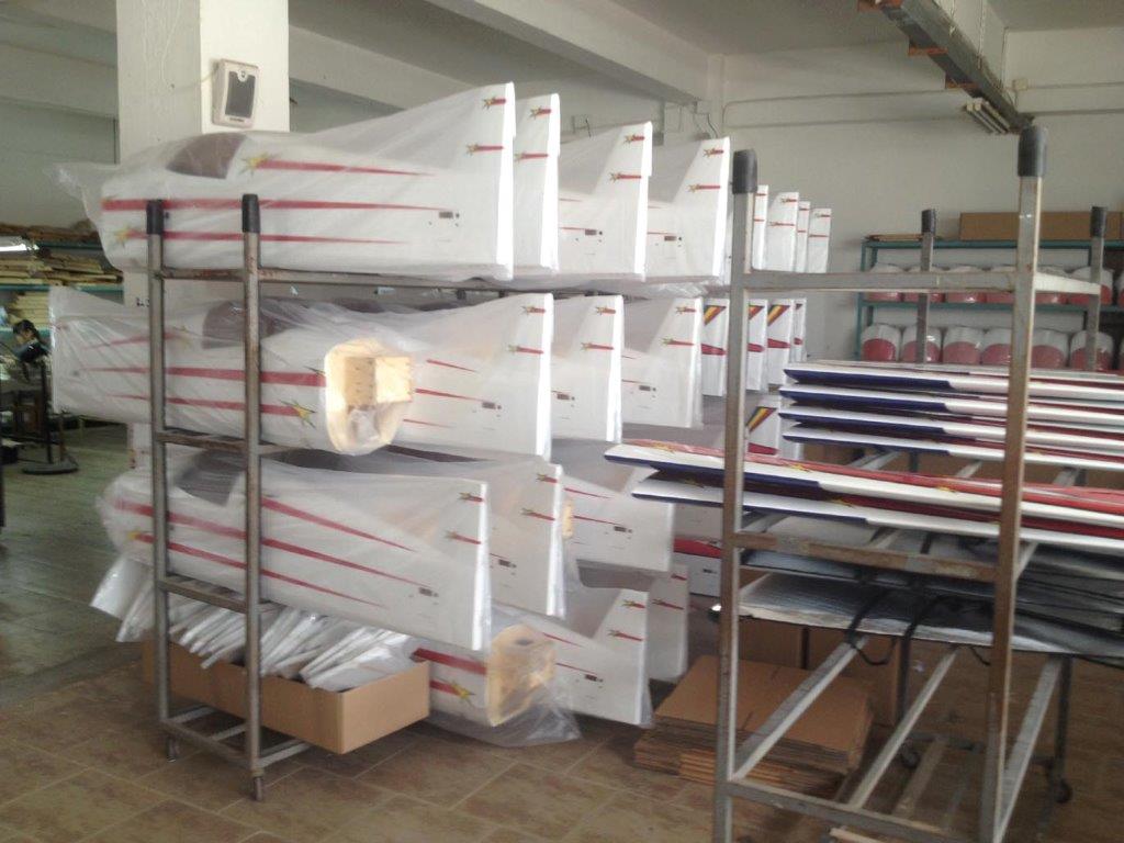

I see my 92" on the middle rack with it's firewall waiting for my DA-70.
