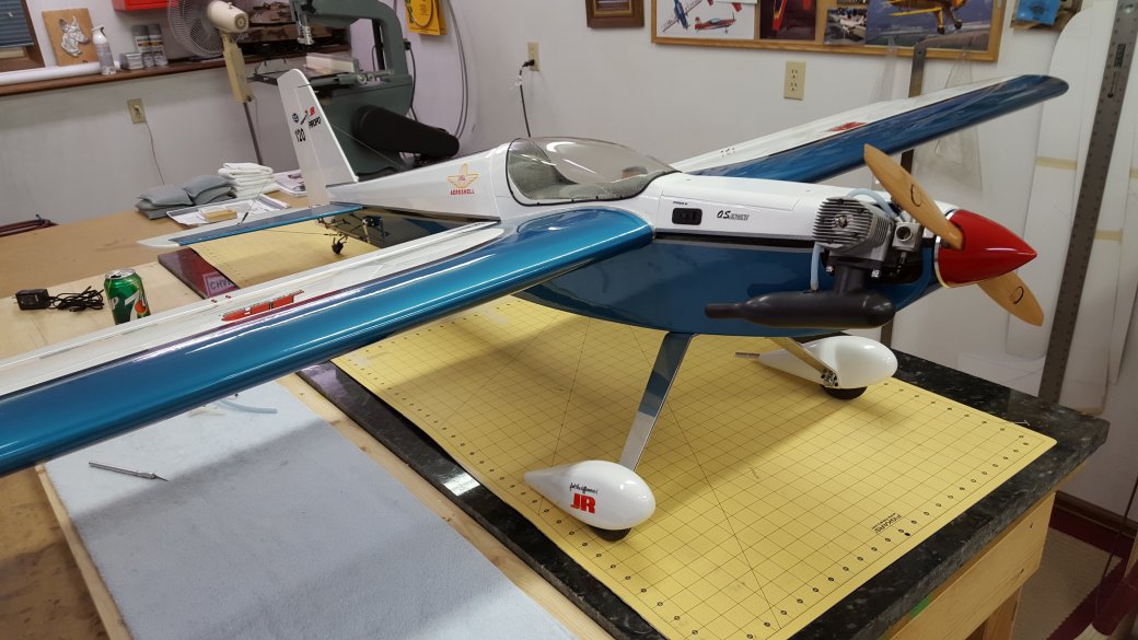

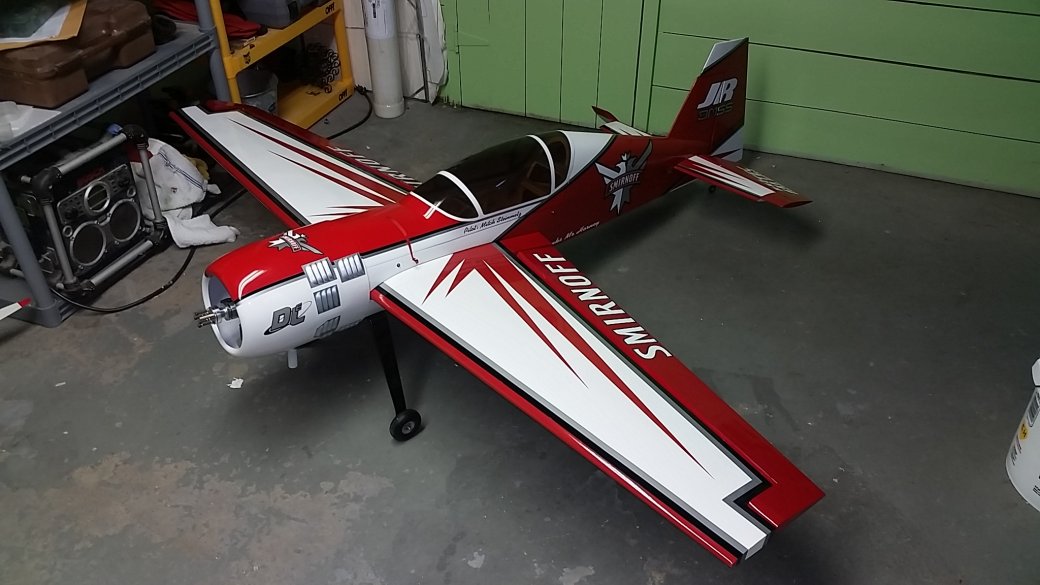

I had issues with true red, color didn't match from roll to roll. I was able to make it all work. This plane was covered a few yrs ago
