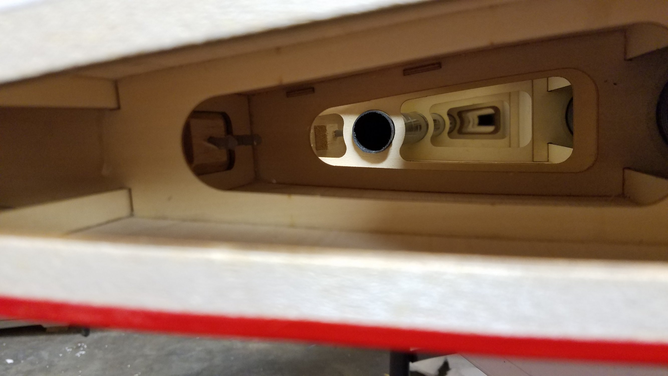

:focus: haha
First plane I've seen with extension tubes in the wings... nice. :)

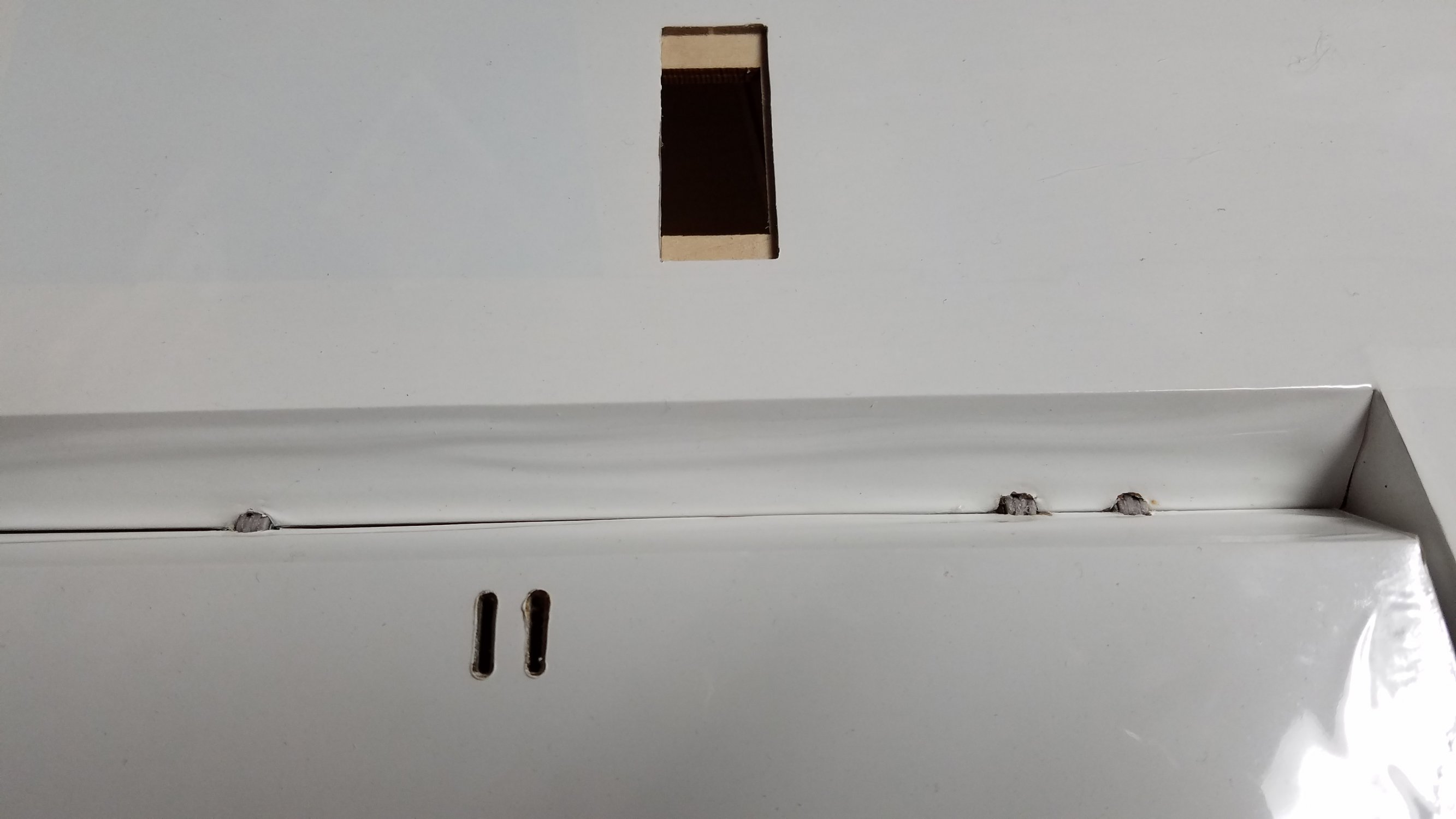

Joe Hunt
After all these years the truss control horn slots are still not cut far enough apart to use conicals. They only allow for a balljoint between them. Hard to believe.

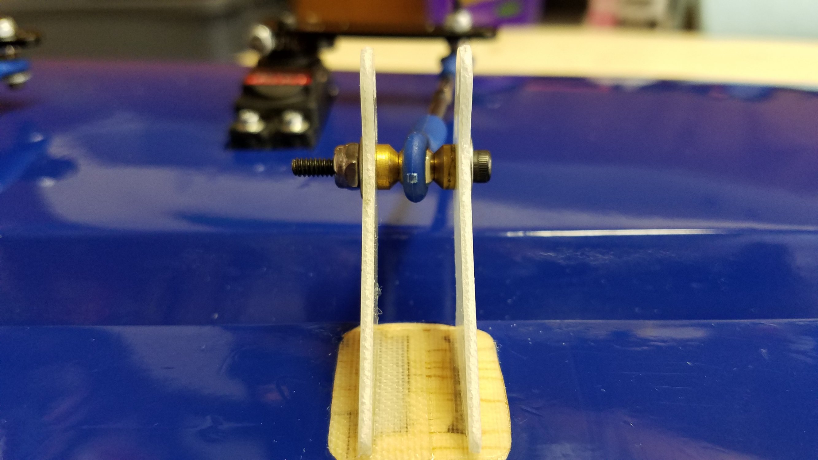

Joe Hunt
I'm going to add a slot closer to the servo... like I did here on my Pilot RC 122" Extra.

Xpress
Definitely could be an issue if the spacing is too close. You would figure this would be taken into account, but maybe it works fine with stock ball links?
Knowing you, you probably have a set of DuBro's already lined up, ready to go in.. :sneaky:
