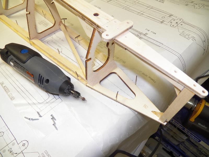

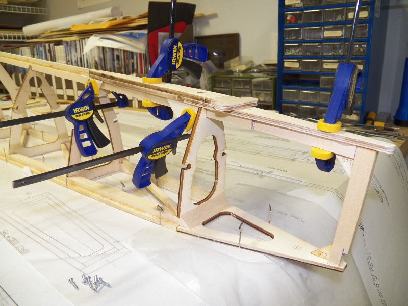

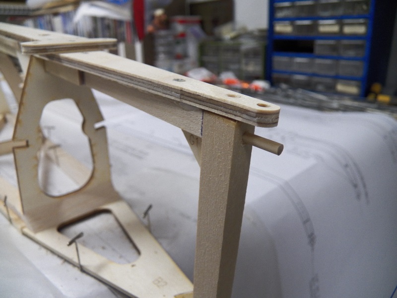

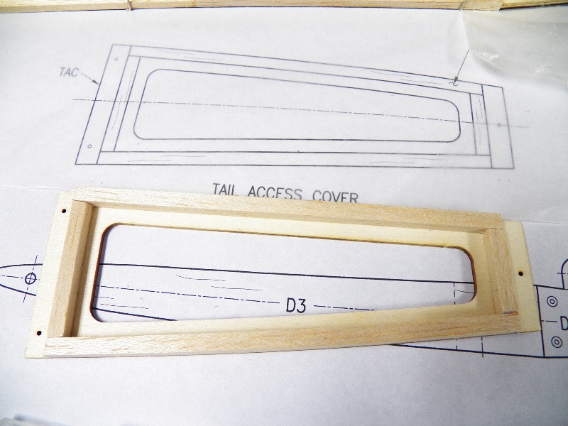

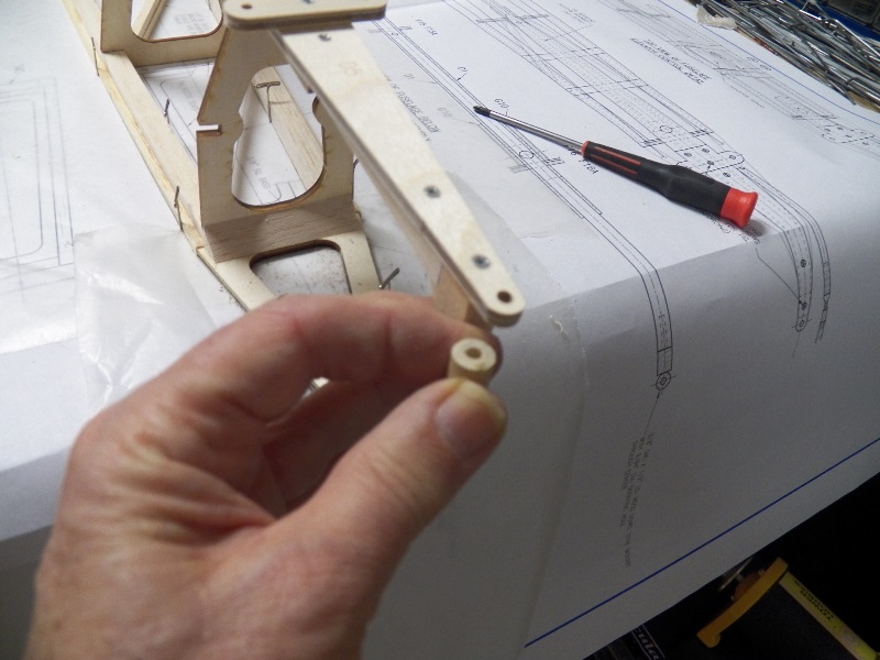

Hardwood blocks and triangle gussets were added to the "spine" under the stab mount platform. The holes in the stab mount platform will be drilled on down through these blocks in an upcoming step. Small wood screws and a dowel pin were used to strengthen this whole assembly. A cone shaped bit in the Dremel tool as used to countersink the screw holes so that the heads will pull down flush with the surface of the stab mount. While the glue was setting up on this, we constructed the access hatch door.

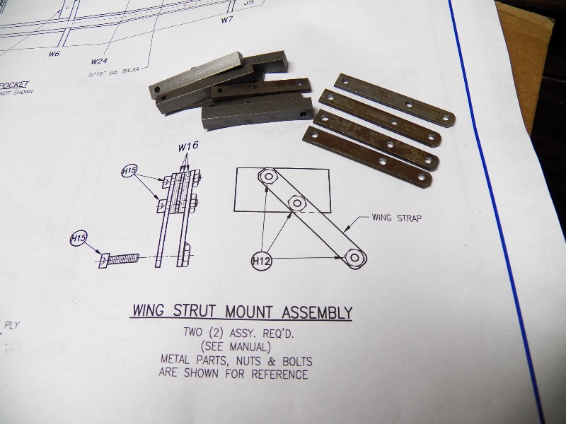

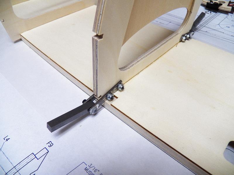

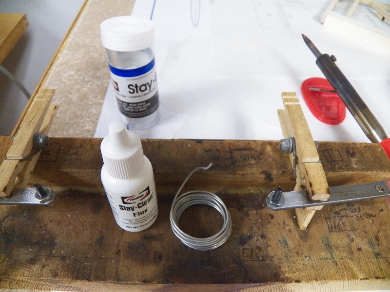

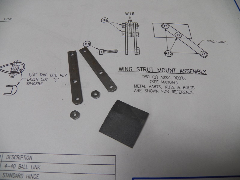

Next, we located the steel parts bag and identified the straps for the lower strut attachment. A hex nut gets silver soldered onto one end of these (on the finished model, you insert the end of the strut into this strap assembly and screw in the bolt to hold it in place. The nut is permanently held in place making the assembly process much easier).
