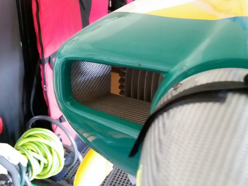

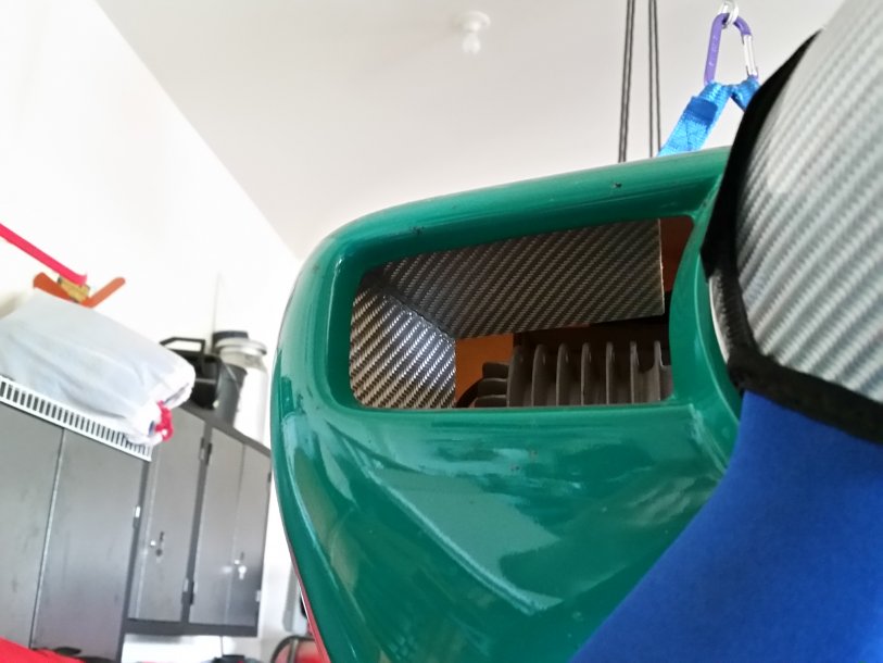

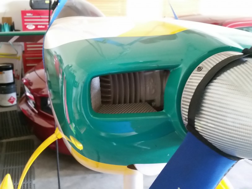

I say yes, baffle anything with a twin is not really an option. Some of the ready made extensions for other planes are fine but they also let a lot of air escape out over the top of the head since the baffles go straight back. What I typically try to do at a minimum is close off the area between the bottom of the cowl opening and the heads and the side of the cowl opening to the heads angled back to just above the top fin. I have found that many times this is enough unless you find that you have issues or if it is a round cowl airplane.
I have a GP176 in my Extra I can take a pic when I get home tonight of my baffles which has worked well.

Terryscustom
What you use really doesn't matter you can use balsa Lite plywood foam or just about anything that will stay rigid and hold up the temps. I use light plywood that has texalium fabric laid up on it. I make this myself. I tack it in place with medium CA but then go over all the seams and joints with goop in a syringe.
