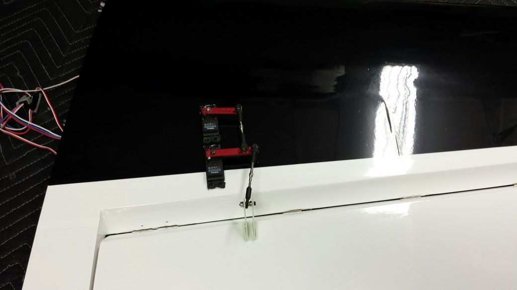

@Spats Glad the flight ended in a safe landing. You think a voltage drop caused the lock out??? I'm thinking six stalled servos and when you add the 4th then 8 stalled servos!. If it where me I would be thinking of doing separate batteries just to power the ailerons alone.
Spats
Lol it was hard on the nerves to say the least. I feel extremely lucky. I'm not sure what happened but I don't think the receiver could handle it. I have the same set up on dozens of planes but with the old 6014 receivers.
Spats
Sooooo I have switched receivers and added a 4th servo to the wings. This is the provision Tony made for a 4th servo. What do you think? It's the inside servo. I think it might have been better spread out in the wing. I will find out tomorrow :dancing-chicken:
That's the way the big Krill Extra is set up. But the composite ailerons are very stiff.....just say'n.

I got several flights on it today. With the old Futaba 6014 receiver I had NO problems. The ZDZ is a power house. I am really liking the power and smooth transition, even with it still running rich. These ailerons have SO much authority! Does whatever you want to:fist_pump:
