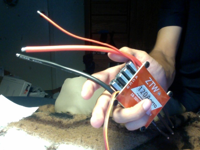

Photo on 2012-10-27 at 17.40.jpgI just got my ZTW 120A opto ESC. It looks nice but i have some questions. What is the extra red wire coming from the battery leads? And do i still have to take out the red wire from the RX lead even though it doesn't have a bec? I'm going to use a CC BEC pro with it.
View attachment 2689I just got my ZTW 120A opto ESC. It looks nice but i have some questions. What is the extra red wire coming from the battery leads? And do i still have to take out the red wire from the RX lead even though it doesn't have a bec? I'm going to use a CC BEC pro with it.
Joe, the red wire is for spark prevention. If you make a small connector and separate lead on the red wire from your battery, and then connect the two red wires prior to mating the connector, it prevents the big spark.
I didn't use mine, as the spark wasn't big enough on 8s.
Also, you don't need to cut the wires on an OPTO esc.
Hope this helps!
-G
hone
It does indeed help. Thanks Gary. I probably won't use the extra red wire either. Now i just need some servos and a motor and i can get this thing going.
