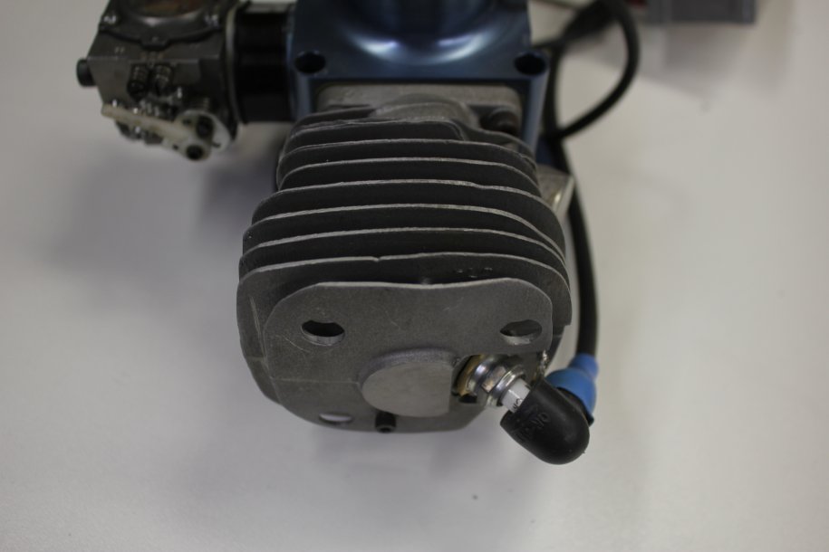

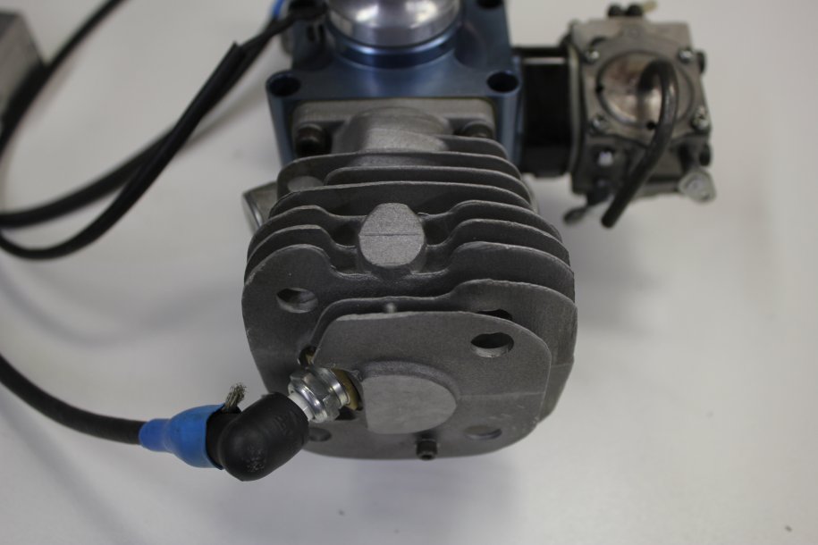

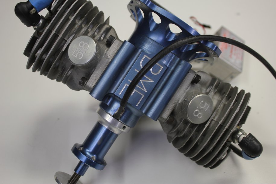

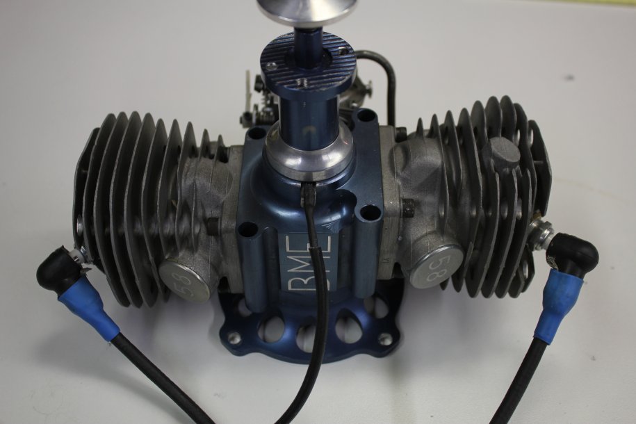

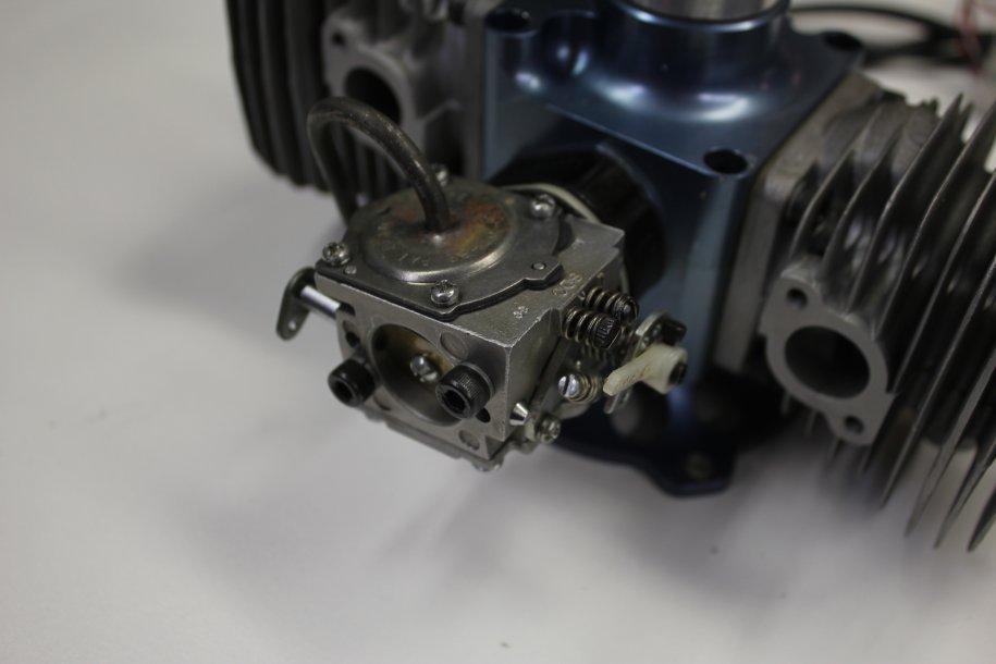

adding photos of the engine
IMG_9368.JPG IMG_9369.JPG IMG_9370.JPG IMG_9371.JPG IMG_9372.JPG IMG_9373.JPG IMG_9374.JPG IMG_9375.JPG
les2097
Bartman, The ignition caps have the grounding wires cut/broken off... The plug wire braid should have a connector to be connected to the little bolts in the top fin of each head... or the caps have to be changed to metal caps... the ignition won't work as shown in your pictures...
Not a big job... but a job none the less... Bill Carpenter of CH ignitions used to charge me $50 to change a single plug cap...
Bartman
Defender of the Noob!
Intersting that you point that out, I was wondering as well why the caps seemed unusual but since the engine went to BME for a rebuild and once over by Tom I assumed they'd be fine that way. I'll email Tom to ask him about it and will post here whatever I find out from him. I could also just wire up an ignition battery and see if there's any spark when I turn the crank.....I'll have to try that.
