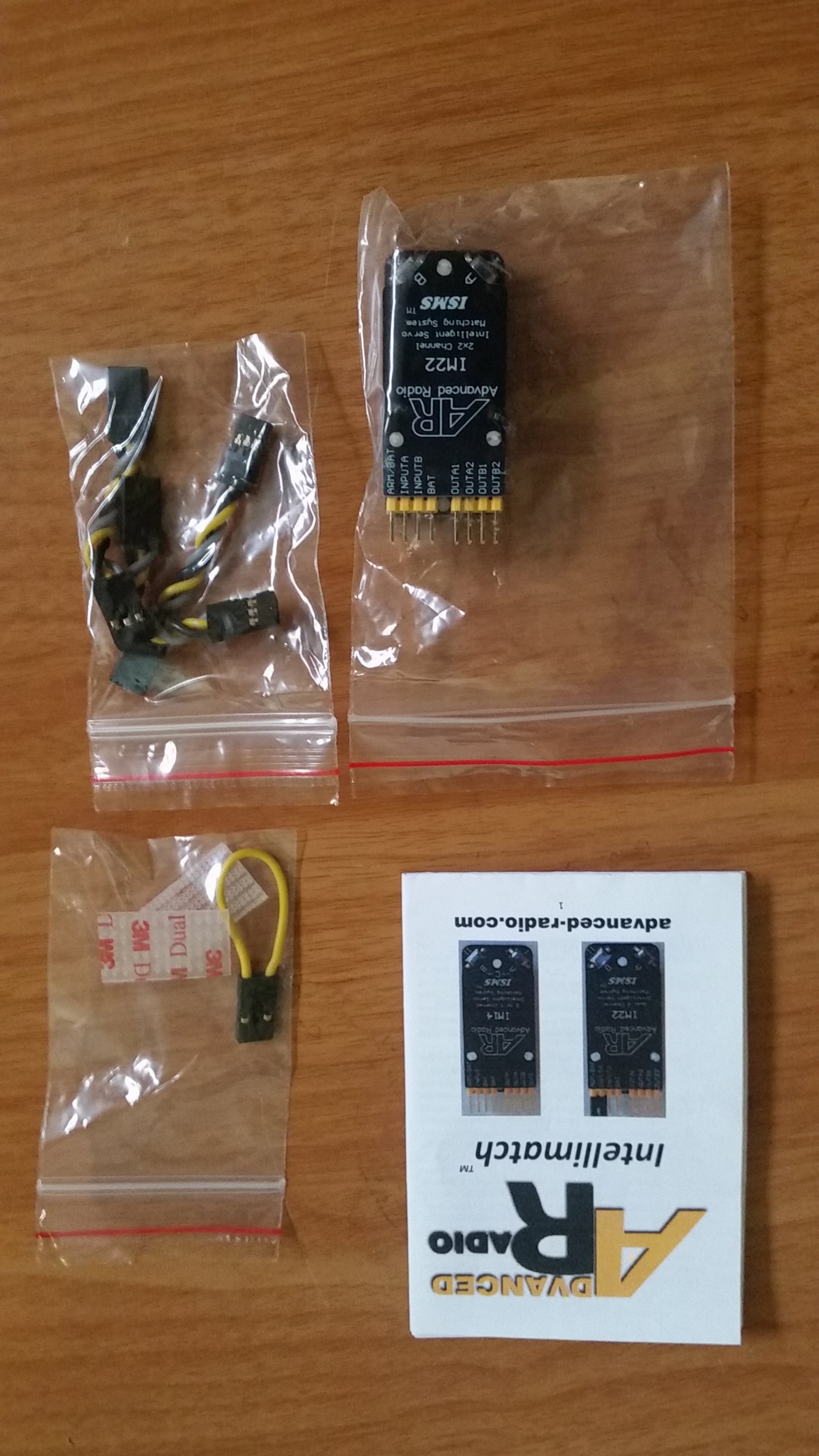

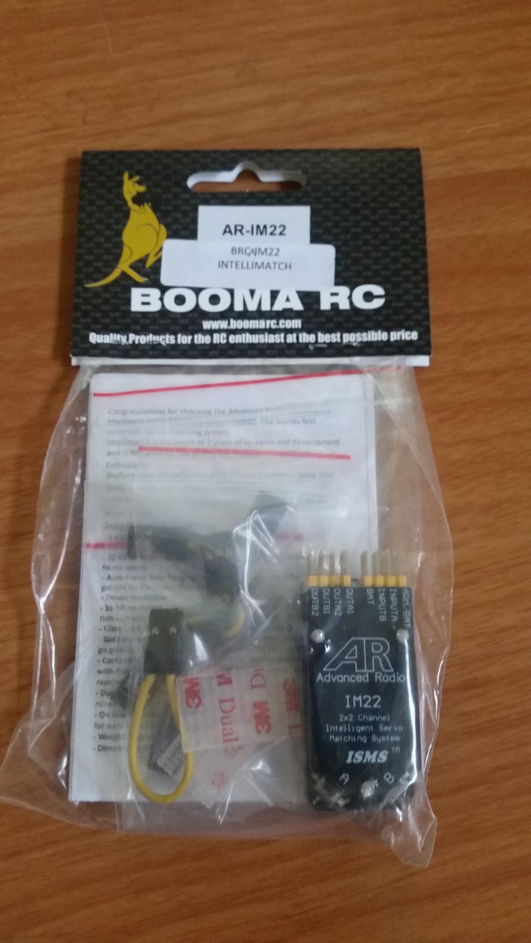

The IM22 comes in a small bag with all the cabling and hardware needed for installation. This includes a bind plug and some heavy-duty velcro for mounting the device.
The build quality seems top notch and the electronics are well protected inside the device. They also seem to be covered in epoxy or something similar. The only minus would be the male-male wires for hooking the device up to the radio/power bus. They are only about 1.5" long, which makes placement of the device a bit tricky. It's probably done to make minimize signal loss and interference, but it introduces a few challenges when installing.

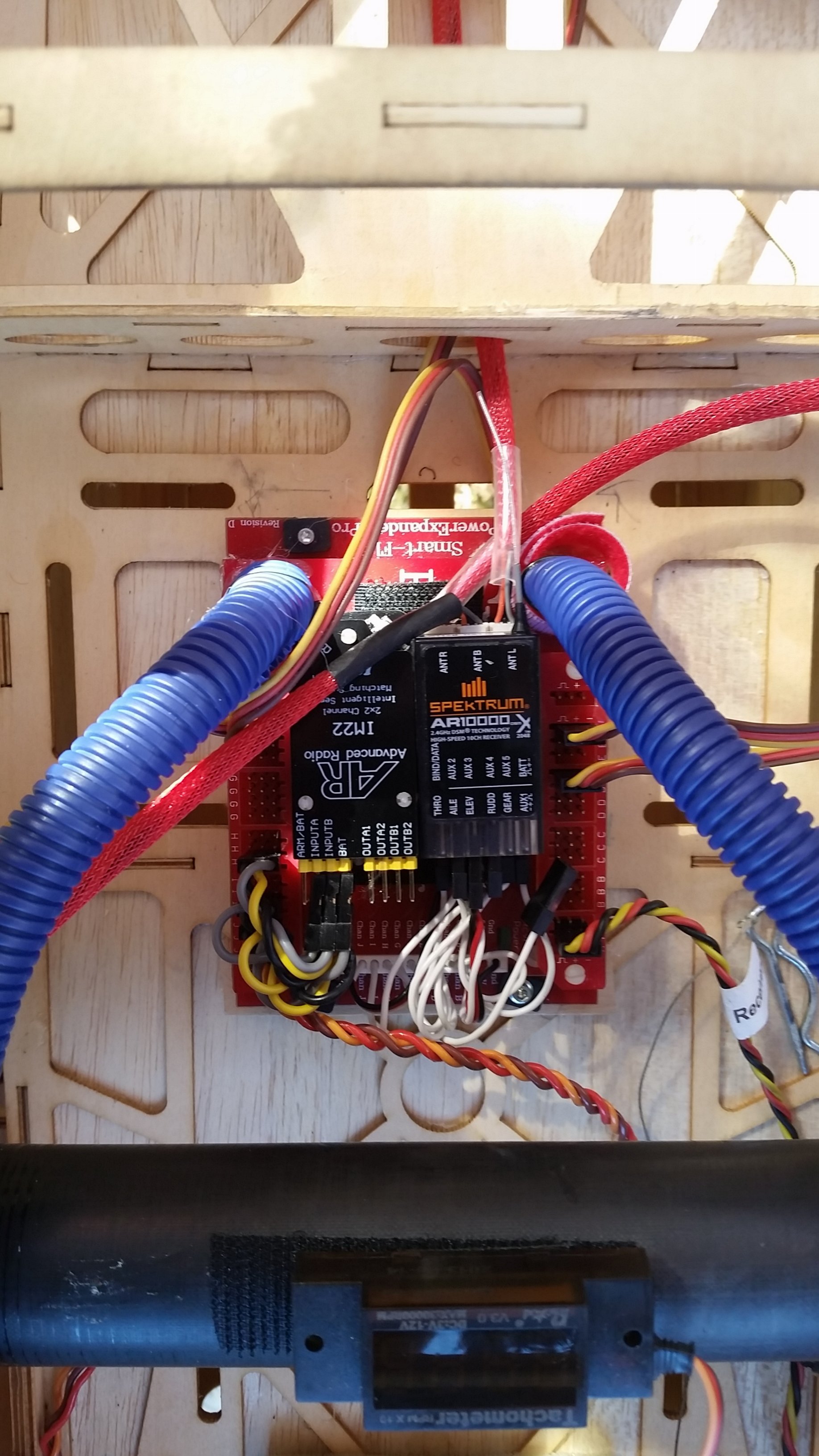

Once you've found a good spot for the device (which can be a bit challenging due to the short wires), installation is a breeze. Just anchor it using the supplied heavy-duty velcro and hook up the inputs. If you have a power distribution unit, you have to hook up the Intellimatch AFTER the power distribution, i.e. between the power distributioin and the servos. The reason for that is that the Intellimatch works by sensing the current flowing to the servos, so the power has to pass through it. There's an extra power input, so my four servos are fed through three wires from the power distribution.
Here is what it looks like in my plane:
