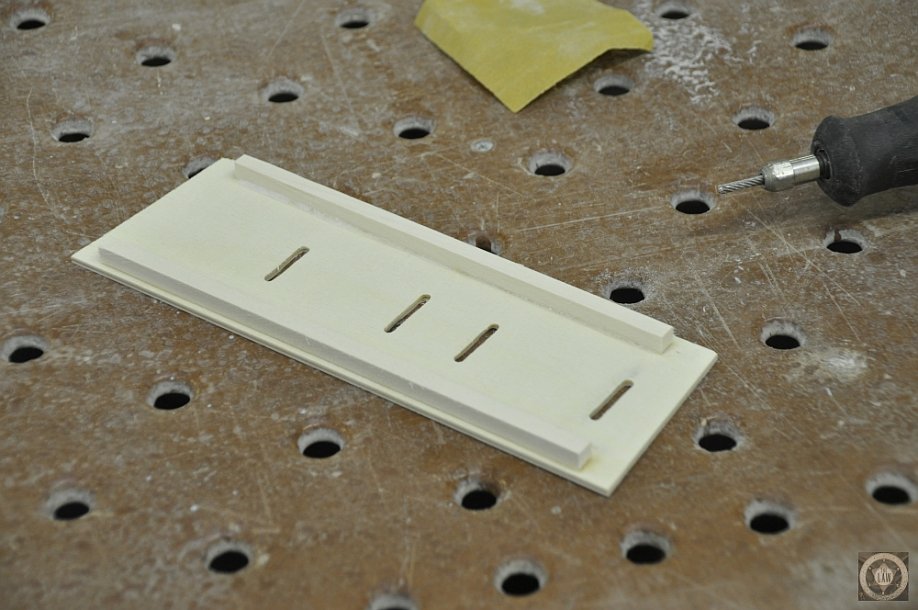

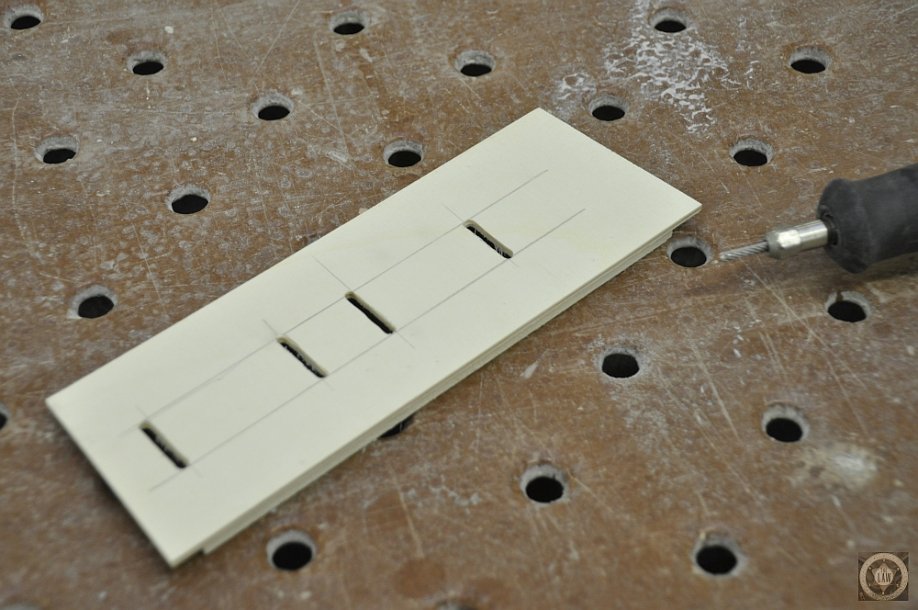

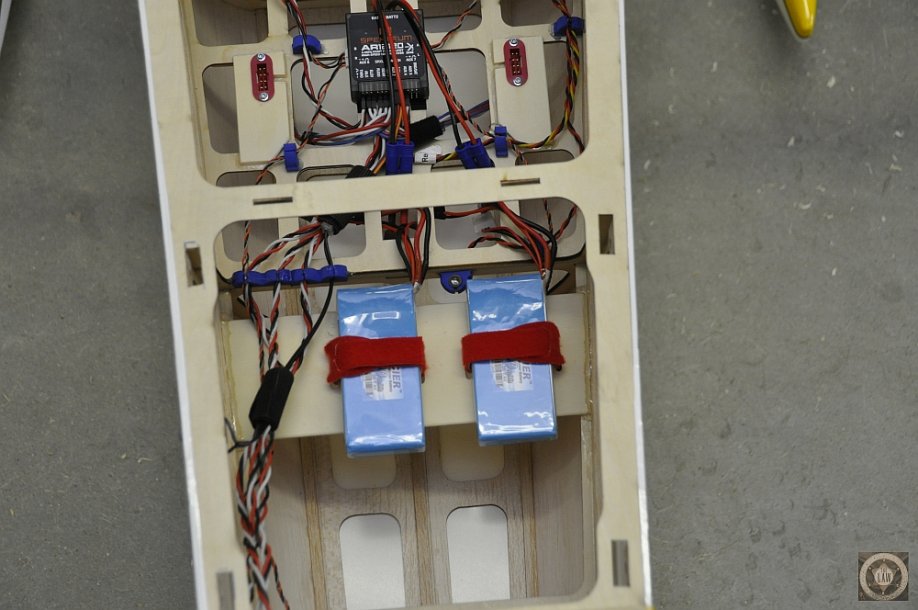

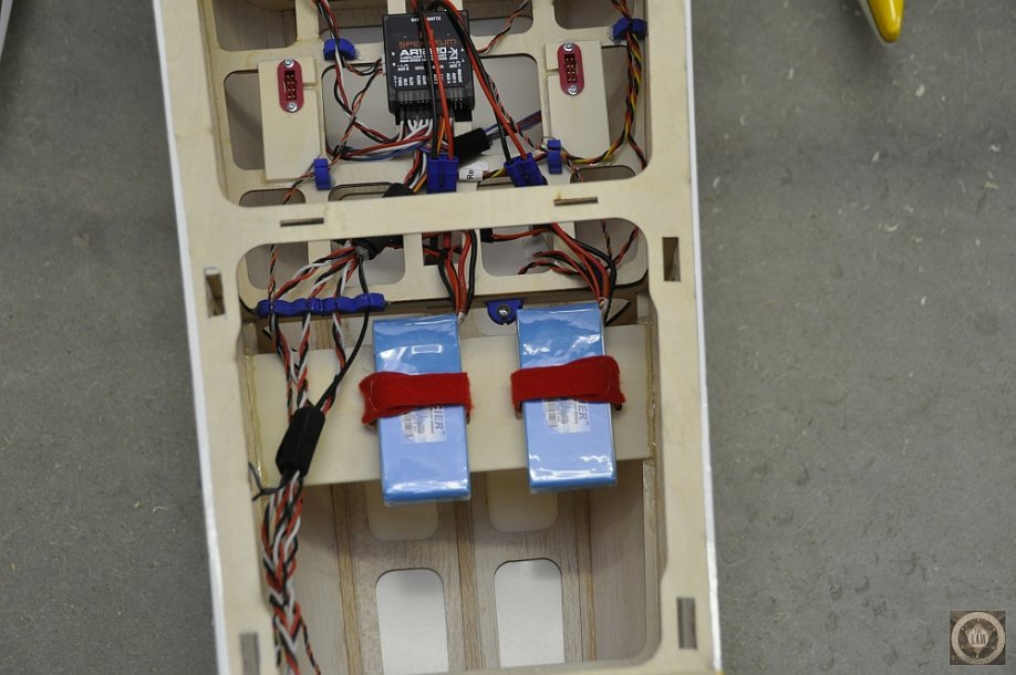

I determined where my batteries will be placed and made a small tray out of lite ply. I used basswood rails on the bottom to give it strength and cut some slots for velcro wraps with a ball end mill in my dremel tool. I was going to do some lightening holes but the whole thing was less than an ounce so I left it. Since it holds 10oz or so of batteries there is a lot of G-forces there.

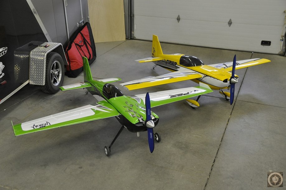

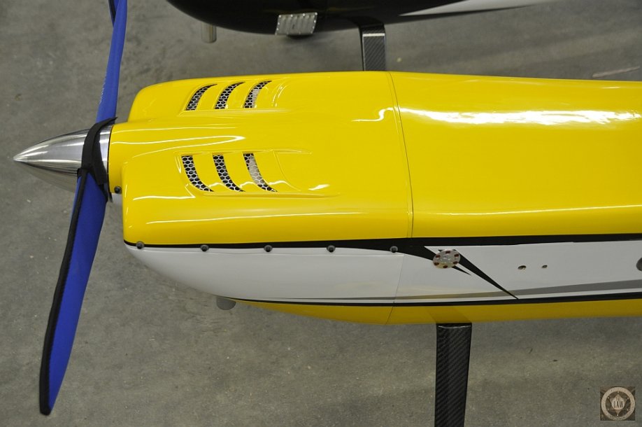

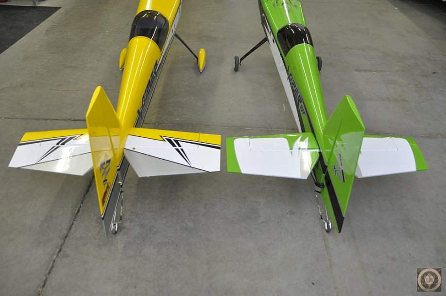

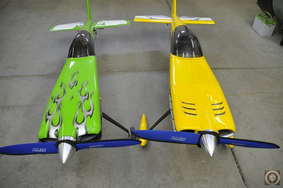

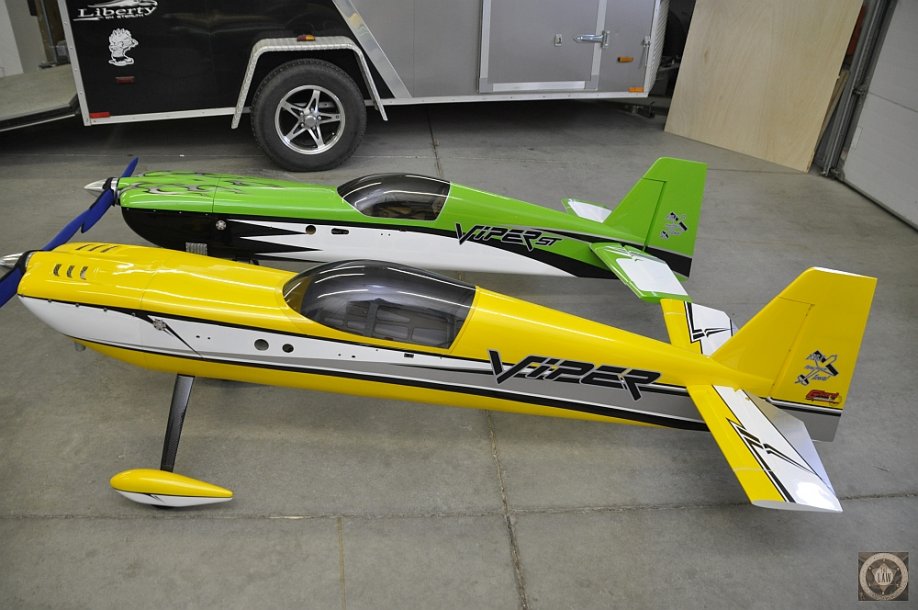

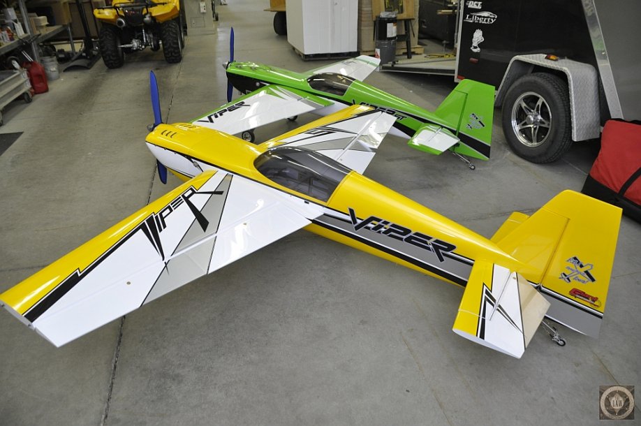

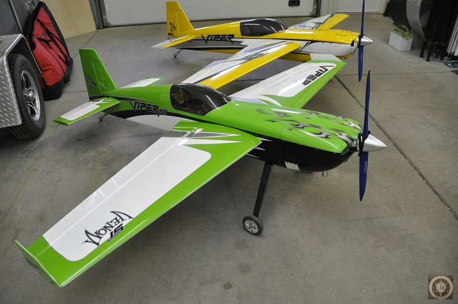

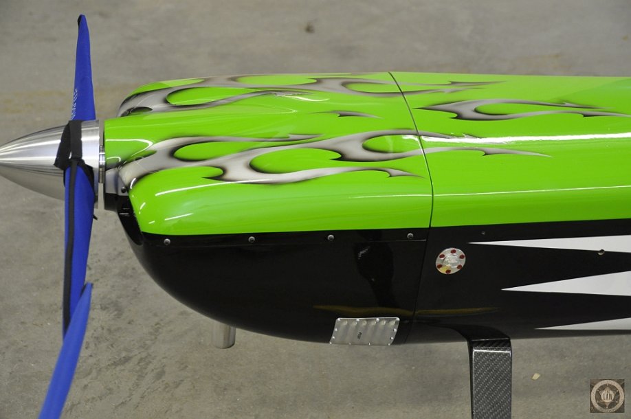

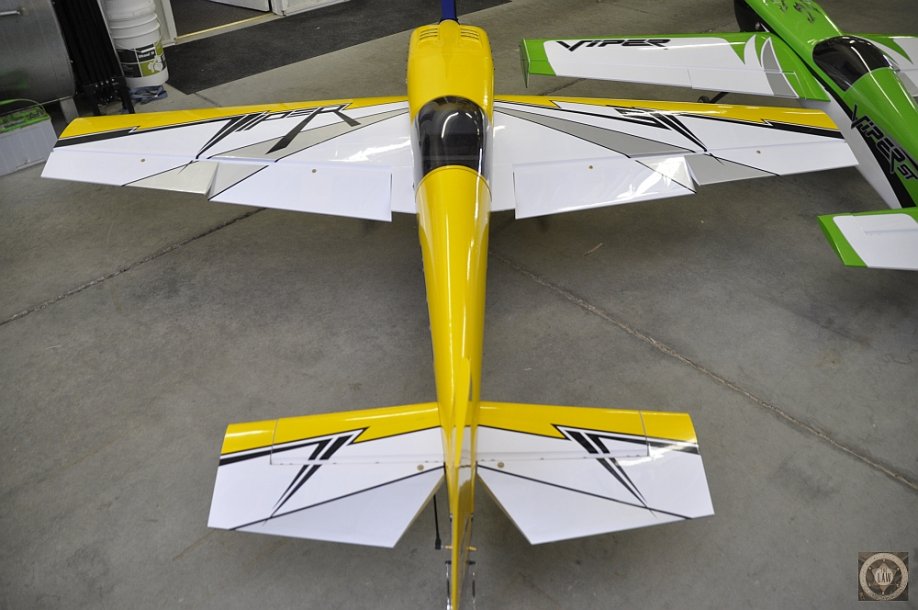

Sun is shining, perfect day for a maiden!!!! If it were not for the 26mph sustained wing with 37mph gusts:mad::(.

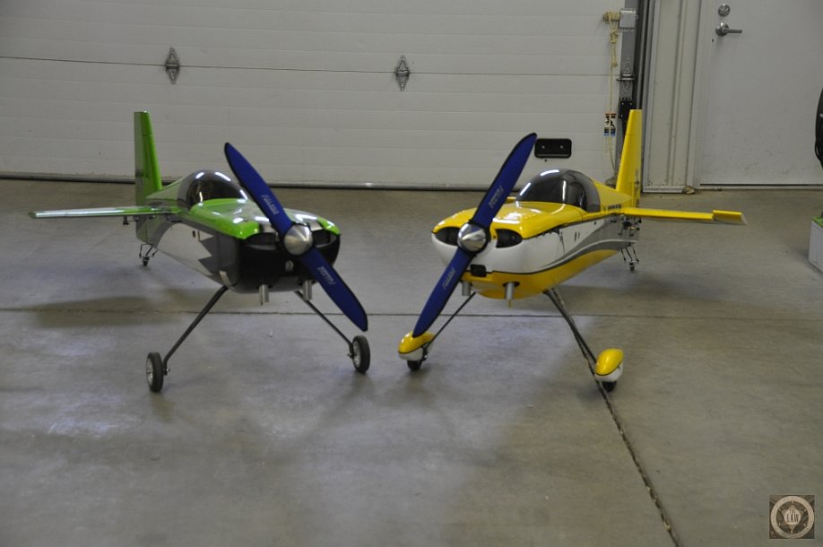

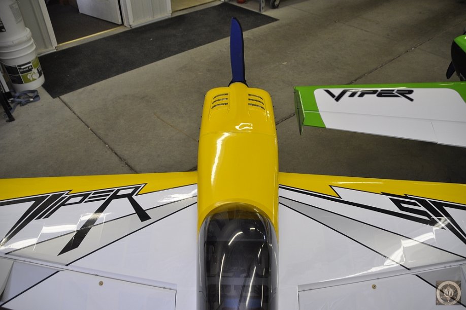

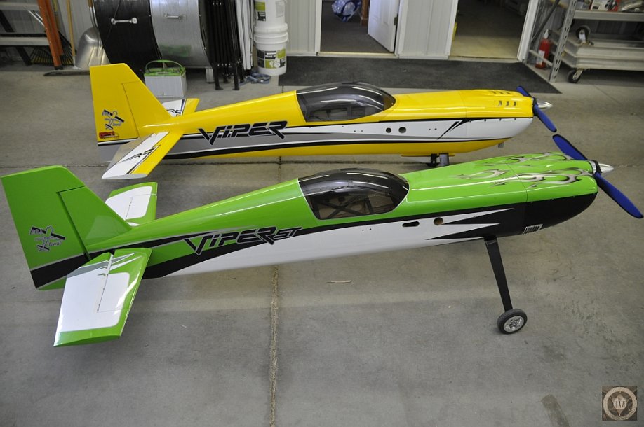

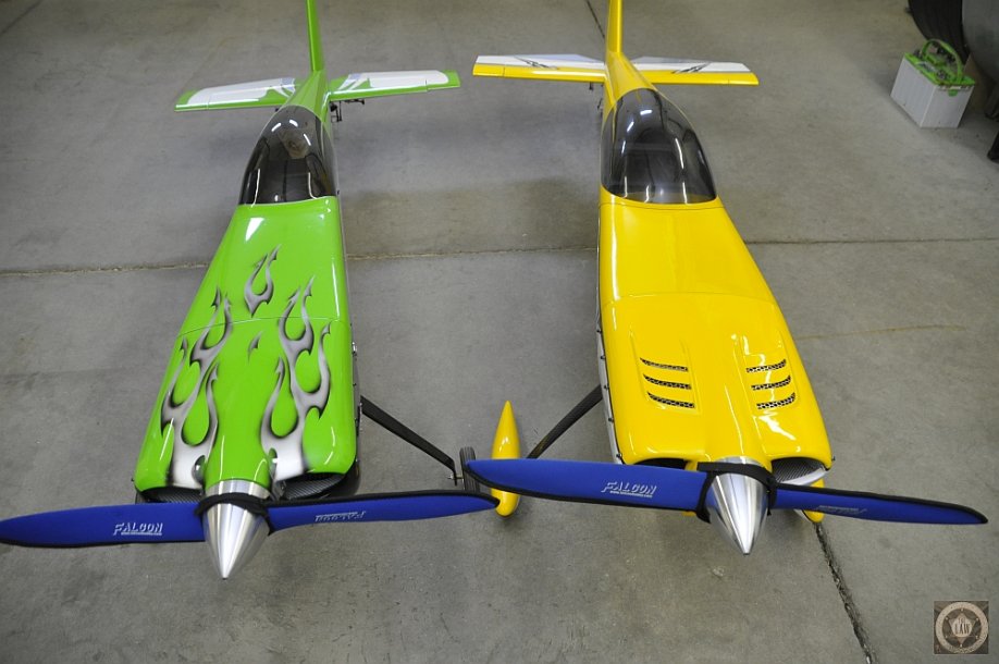

Well, figured before I pack the plane in the trailer for a calm day I would get a couple of family reunion shots with the kit that is currently available vs the new PAU ARF. I've been getting quite a few questions regarding the difference. Basically as noted the ARF is basically a few inches more wingspan, a couple hundred more sq. in. of wing area, a few inches longer, almost exactly the same finished weight, and the elevators are quite a bit larger which will be AMAZING.
and ready to assemble with a couple days work!!:dancing-chicken:
Really really looking forward to this maiden flight!!!
Oh, and obviously the ARF
will come all built, covered

Love them blue batteries right there buddy!
3Dchief
Speaking of G-forces, do you have anything holding those batteries in besides those straps? They are great for side to side movement, but I would be worried about the fore to aft movement and possibly unplugging your batteries in flight! Either a velcro patch on the bottom of each battery or another strap front to back would be cheap insurance and not make the batteries any harder to remove.

Two damn fine looking flying machines!:yesss:
