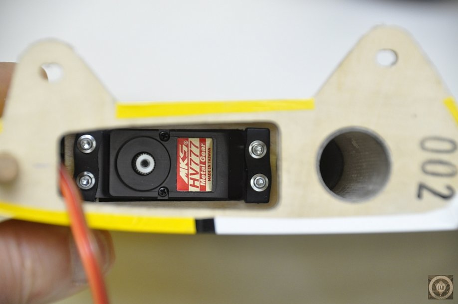

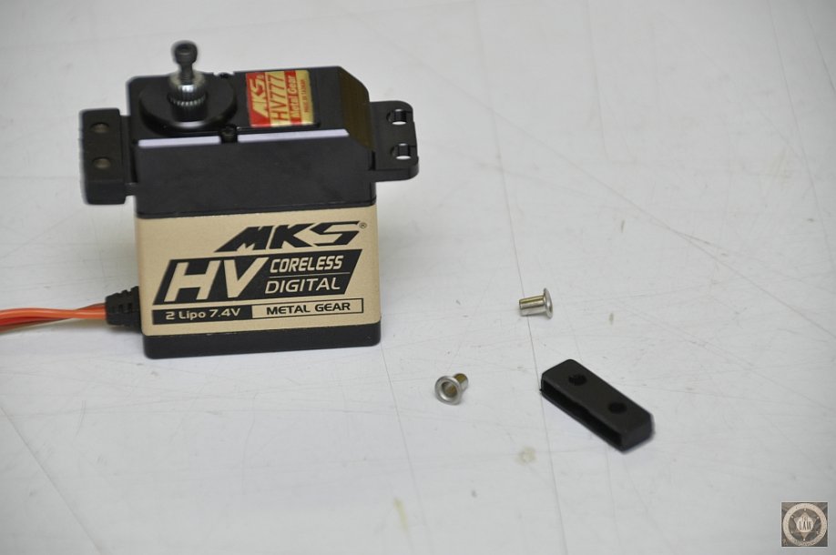

One thing that I noticed that is small but nice is the mounting bushings are thinner than most and allow for adequate vibration isolation but flex much less side to side. This is very important when the servos are perpendicular to the control horn like on Ailerons, very nice!! Also I was a little concerned about the taller servos fitting in the stabs easily. As I was bracing for a little fight they simply fell in.......LOL, I'll work with that!!

Well as many of you that know me know that I don't jump around with brands hap haphazardly and without research and proof of form and function. I also don't fly circles a lot and I fly my planes pretty hard and love every second of it!! I discovered a flaw in my Viper setup and have chosen to address the issue with a new product, MKS servos.
I started this process a few weeks ago and pulled the trigger last week. Thanks very much to all the people I talked with about these and I appreciate all the honest feedback and data. Special thanks to @Islandflyer and Thomas from @MKSservosUSA for getting these to me. Time is tight this week so I started the process on the tail and need to make a few new push-rods for the elevators. I'll work on the ailerons and transmitter setup in the next couple of days for some test flights this weekend

I am using @Taildraggerrc arms on this bird. Over a year ago I tested them on a scratch build that was going to get stress tested and no issues, I've bought several sets since without issue. One thing is I drill out the little 2mm metric lock bolts because almost all of them break, I installed a 2-56 with a nut and all good.
