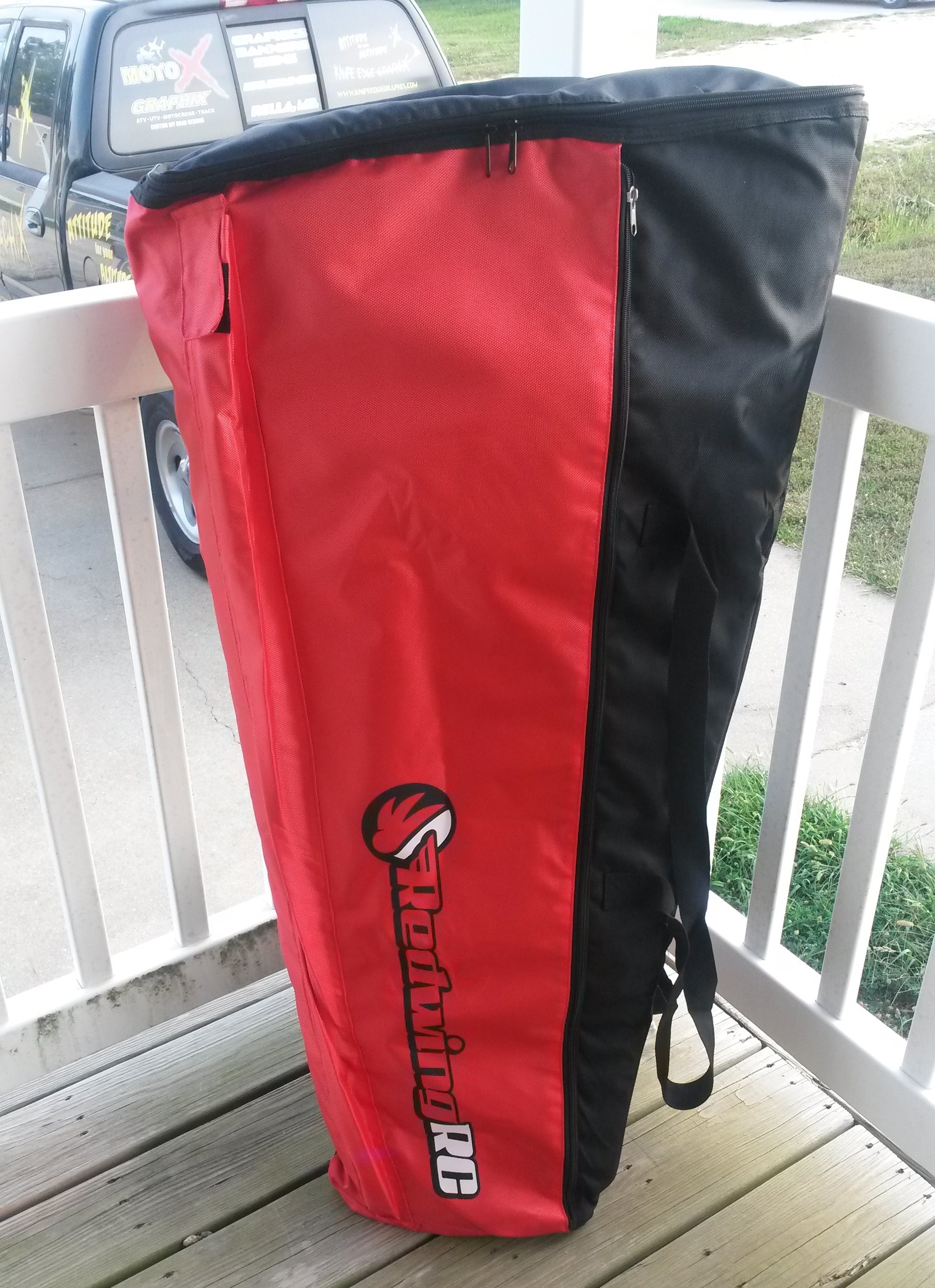

Here's the really nice wing bags I got from Redwing RC.
