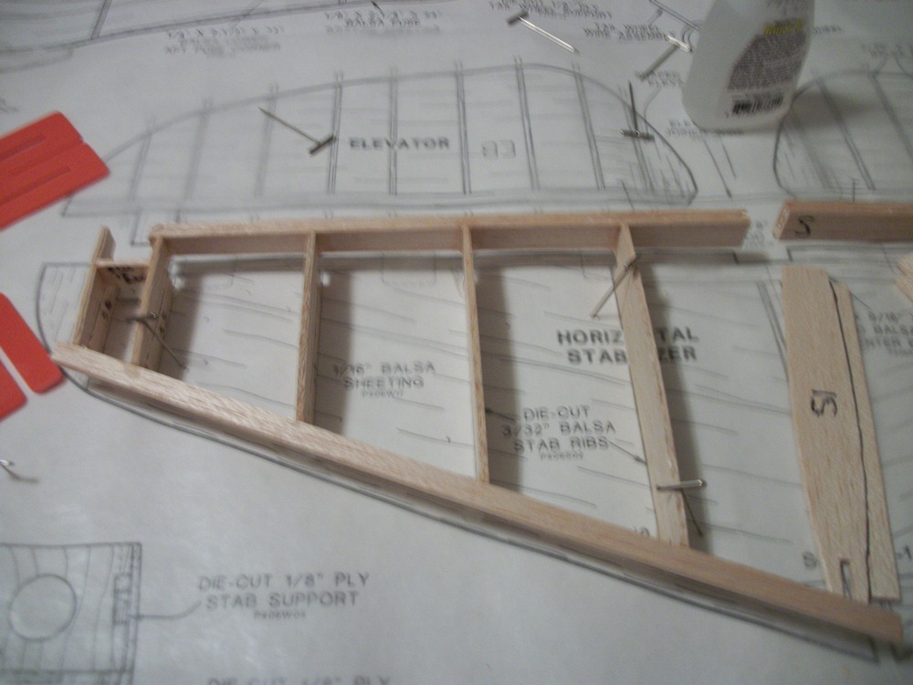

    Bought the kit NIB at a steal off of the local Craigslist back in October or November. Then had to find the right table and gather building supplies.
    Finaly started the stab last night (2-4-13).
    Nothing fancy, just got the TE and LE ready along with punching out the ribs and getting the two pinned to starting.
    [​IMG]

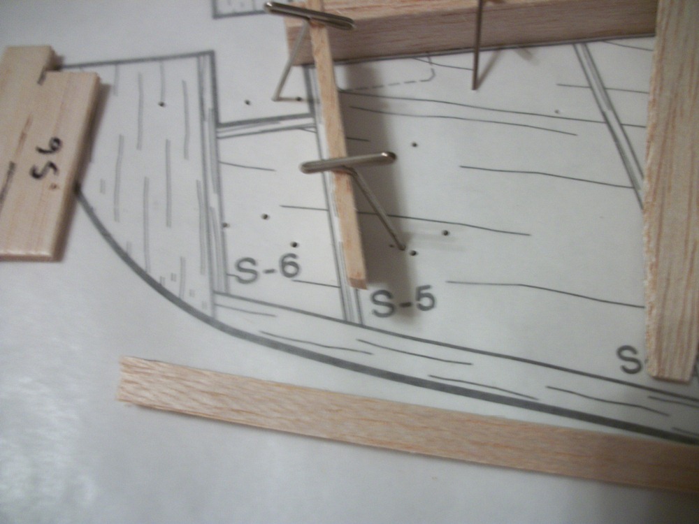

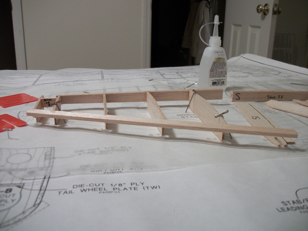

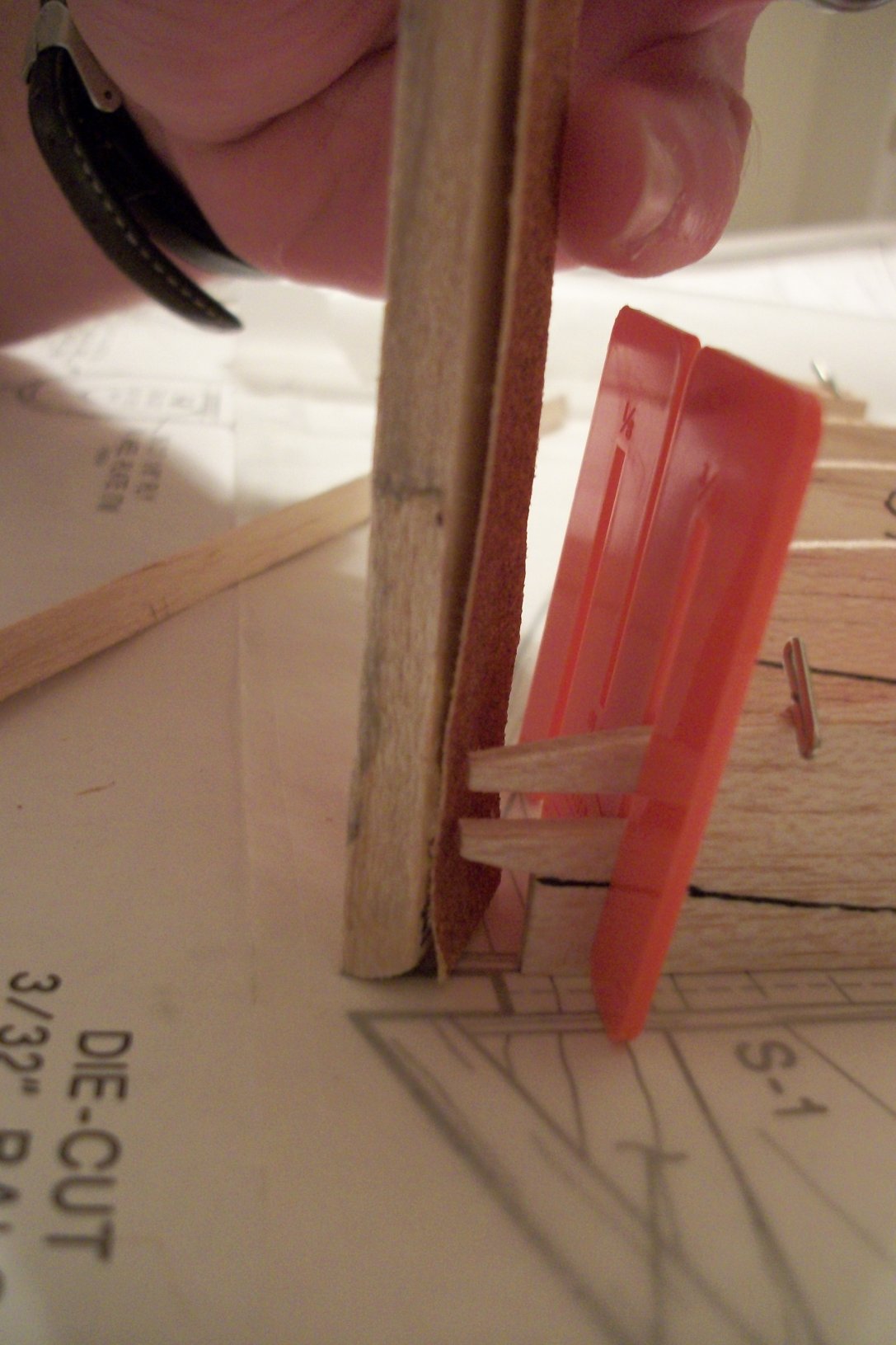

    Right side of the stab framed up. Nothing fancy or troublesome here.
    LE of the stab ribs were beveled to create a nice flat smooth junction with the LE.
    Beveling the rib LE
    Right side all glued in. Rib #1 gets glued in later due to have the stab joiner that goes up front and joins the two halves

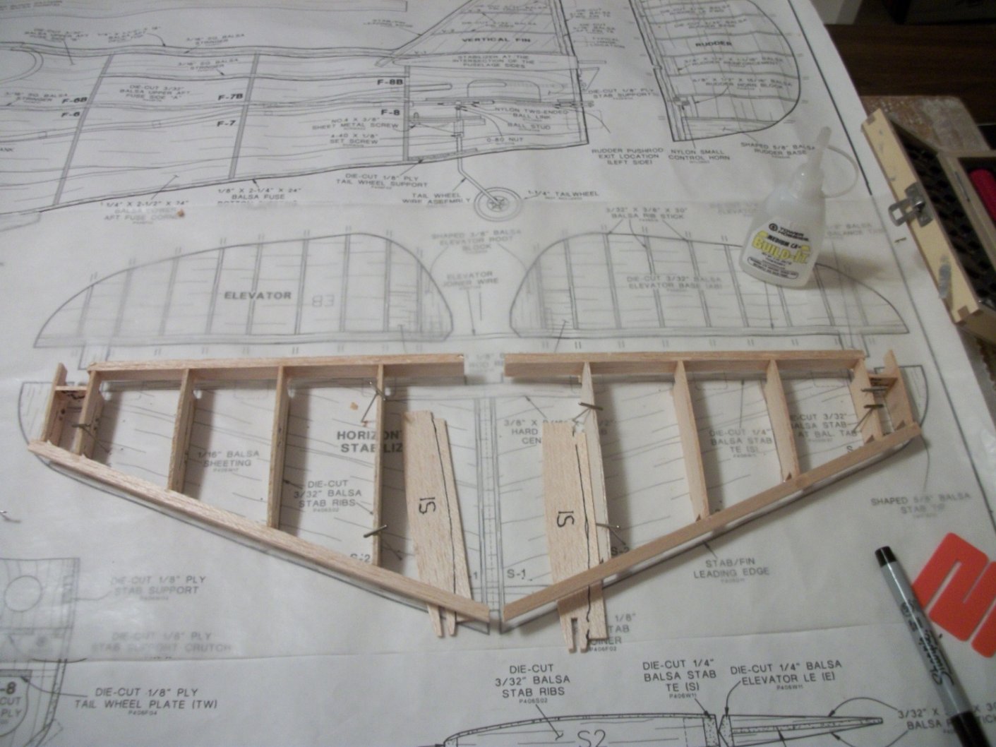

    An hour of working last night resulted in the left half being framed then the two halves getting joined together. Nothing fancy here, just CA and balsa. Next step is prepping and sheeting the top if the horizontal stab.

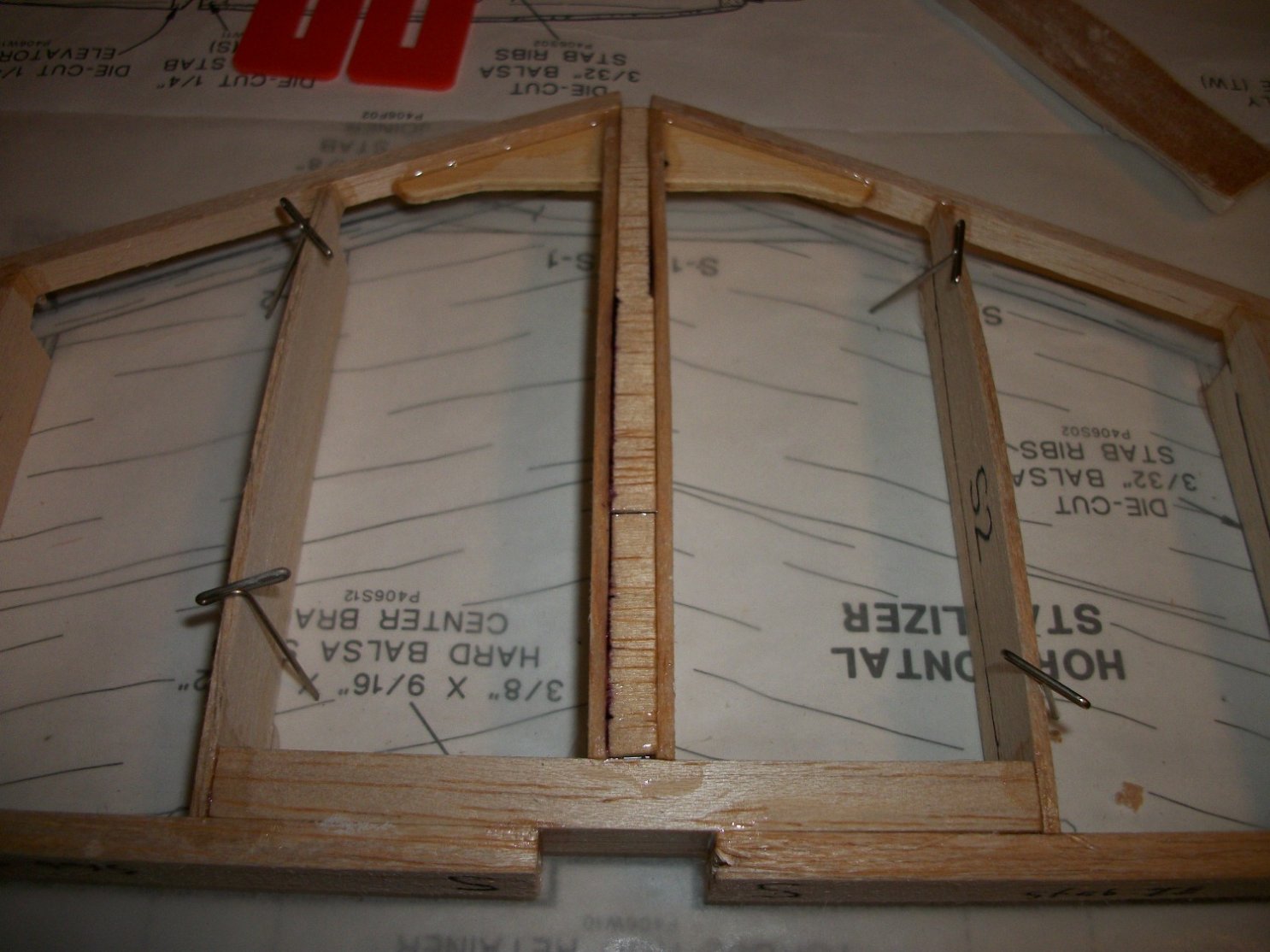

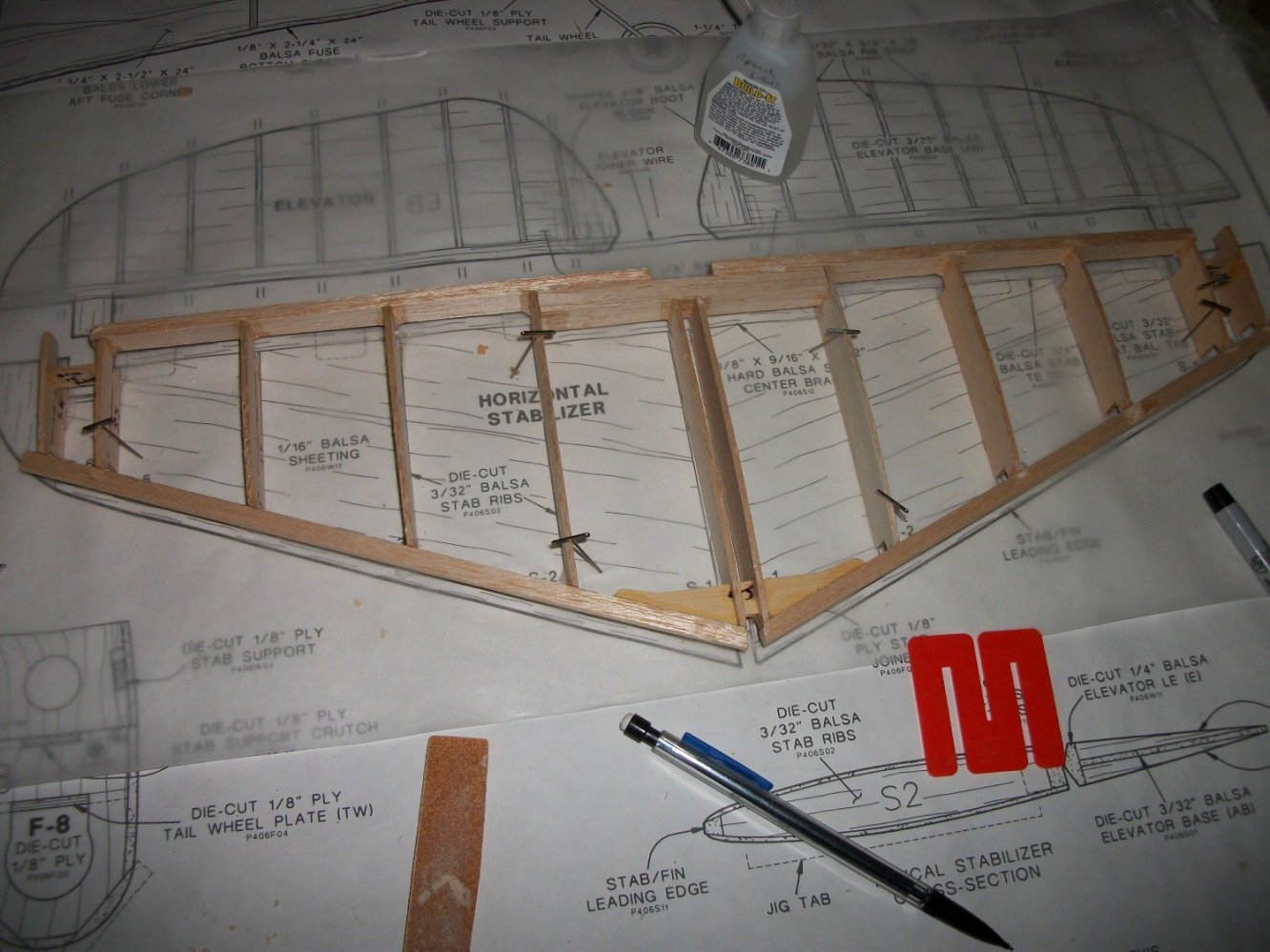

    Took the past couple of nights off from building to catch up on sleep. Without the proper amount of sleep I won't build a good plane. I got 20 minutes worth of work last night. This only involved cutting some sheeting to fit between the S1 ribs and sit flush with their top and hitting glue joints again to make sure the joints are solid. I've been email my dad to get tips/instructions on making and applying sheeting as I haven't done sheeting before. I also spent some time trying to make a sanding block since I'm to the point of doing some sanding to get the LE flush with the stab ribs. Included are pics from Friday night with the second half completed and joined as well as a close up to the 1/4" pieces of sheeting between the S1 ribs.

    Hopefully your dad told you that with sheeting it is much better to use regular wood glue rather than CA....CA is VERY hard to sand.
    Takes a little longer for the wood glue to set, but it is well worth later.
