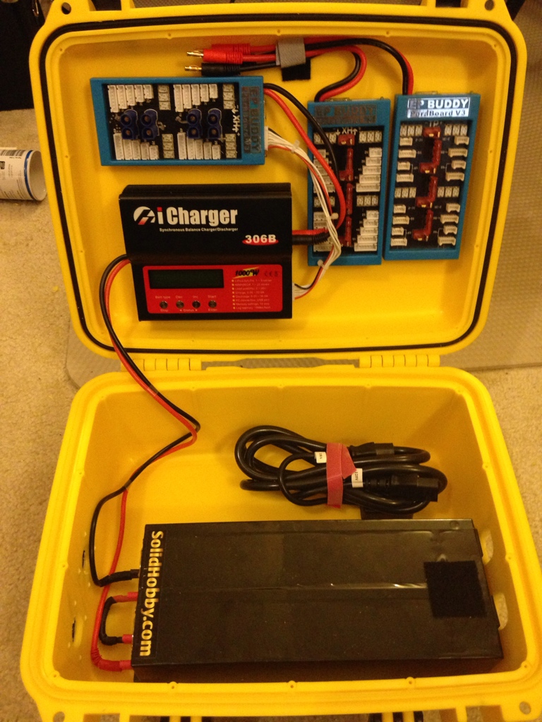

So I just finishing building my first portable charger case. Pretty simple actually, anyone with a little spare time can do it.

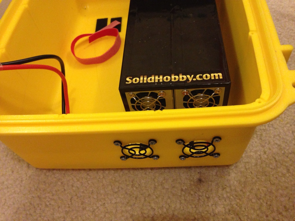

I bought a Seahorse 530 case off amazon for $55 shipped. Also got a couple of 40mm grills, and some Velcro from Amazon for a couple more bucks.

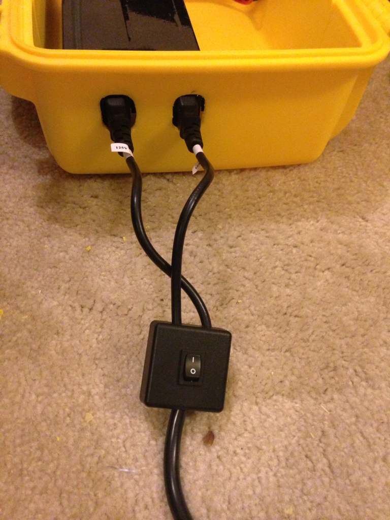

Installed my nice Power24 power-supply from SolidHobby. The dual switched cord makes it simple to turn the system on and off, and easily plugs in from the outside.

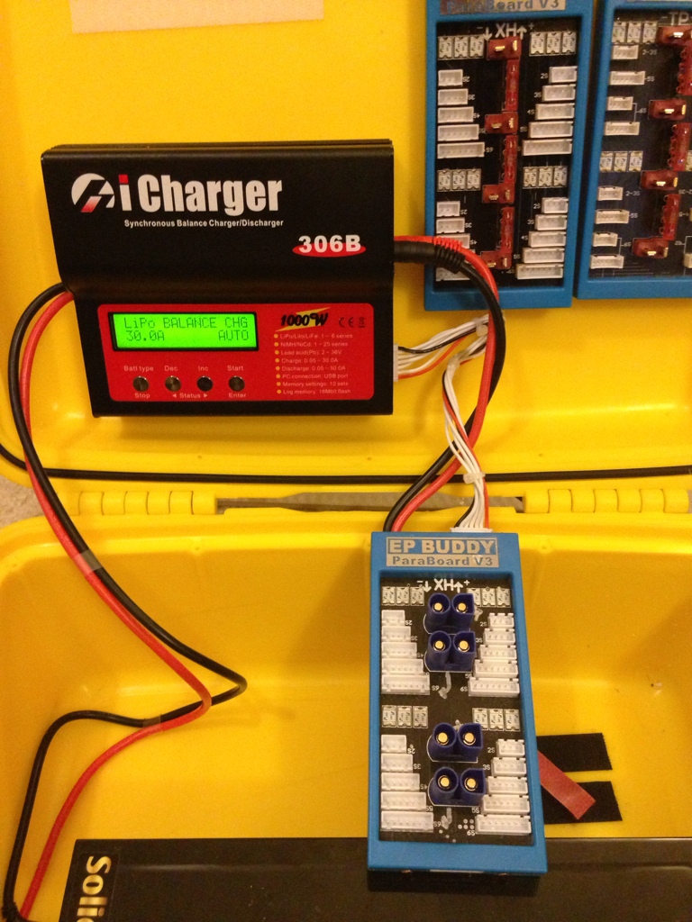

I went with an awesome 1000w iCharger 306b and some 40a paraboards from BuddyRc. This is the perfect 6s charger for parallel charging, and gives the most bang for the buck with the 1250w power-supply.
For the "build" I just drilled a few holes for the power plugs and vents, used a dremel with a sanding bit to size them the way I wanted, and then installed everything with Velcro.
Everything fits nicely stowed until it's needed, and I can even leave the primary paraboard plugged in.
