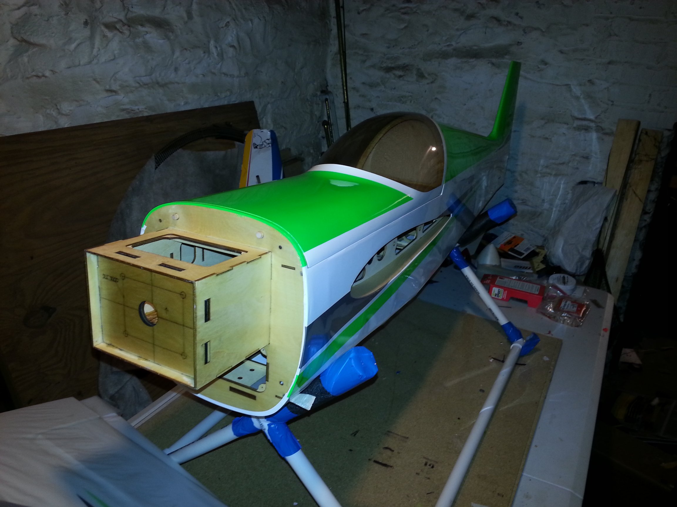

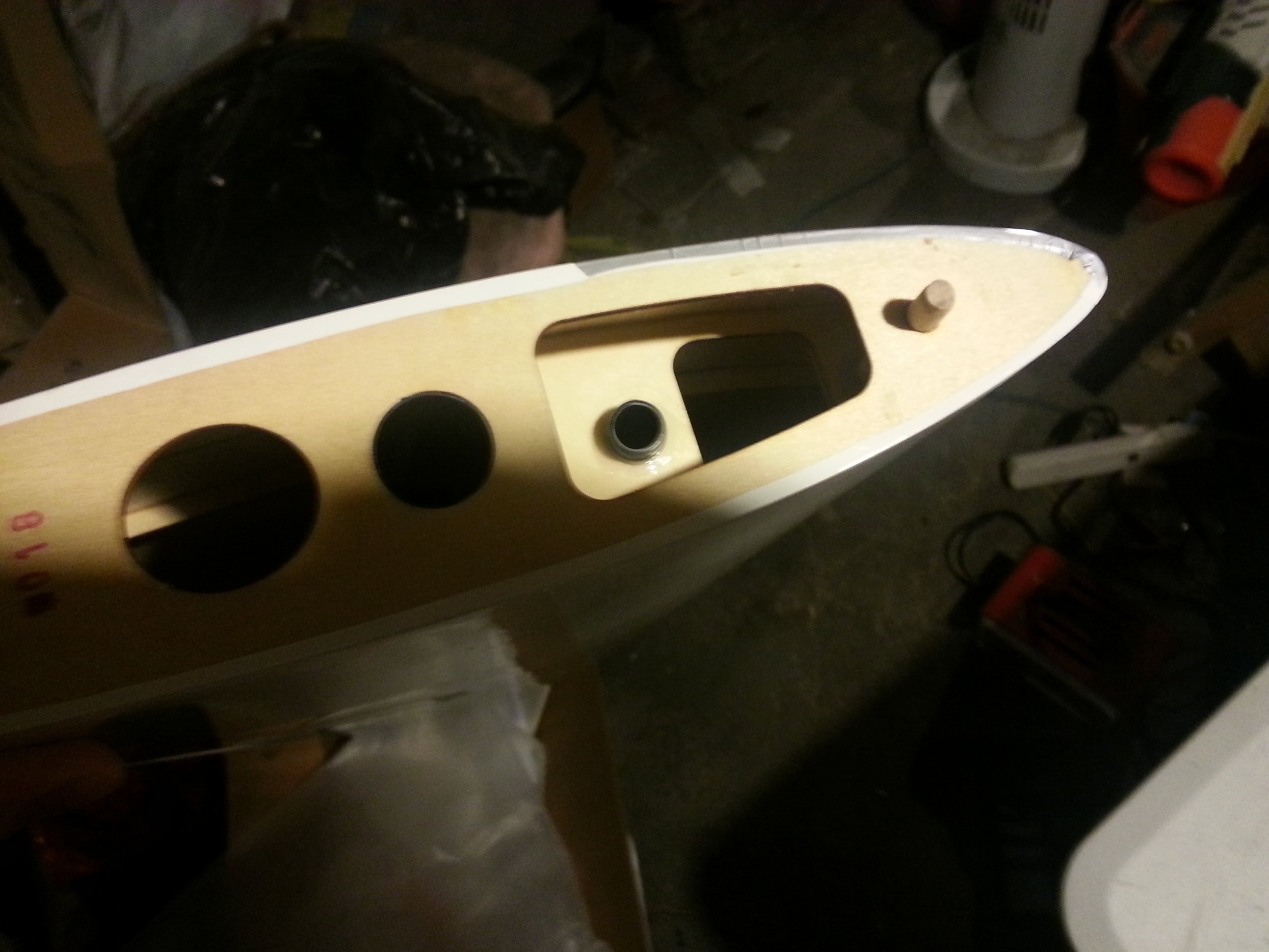

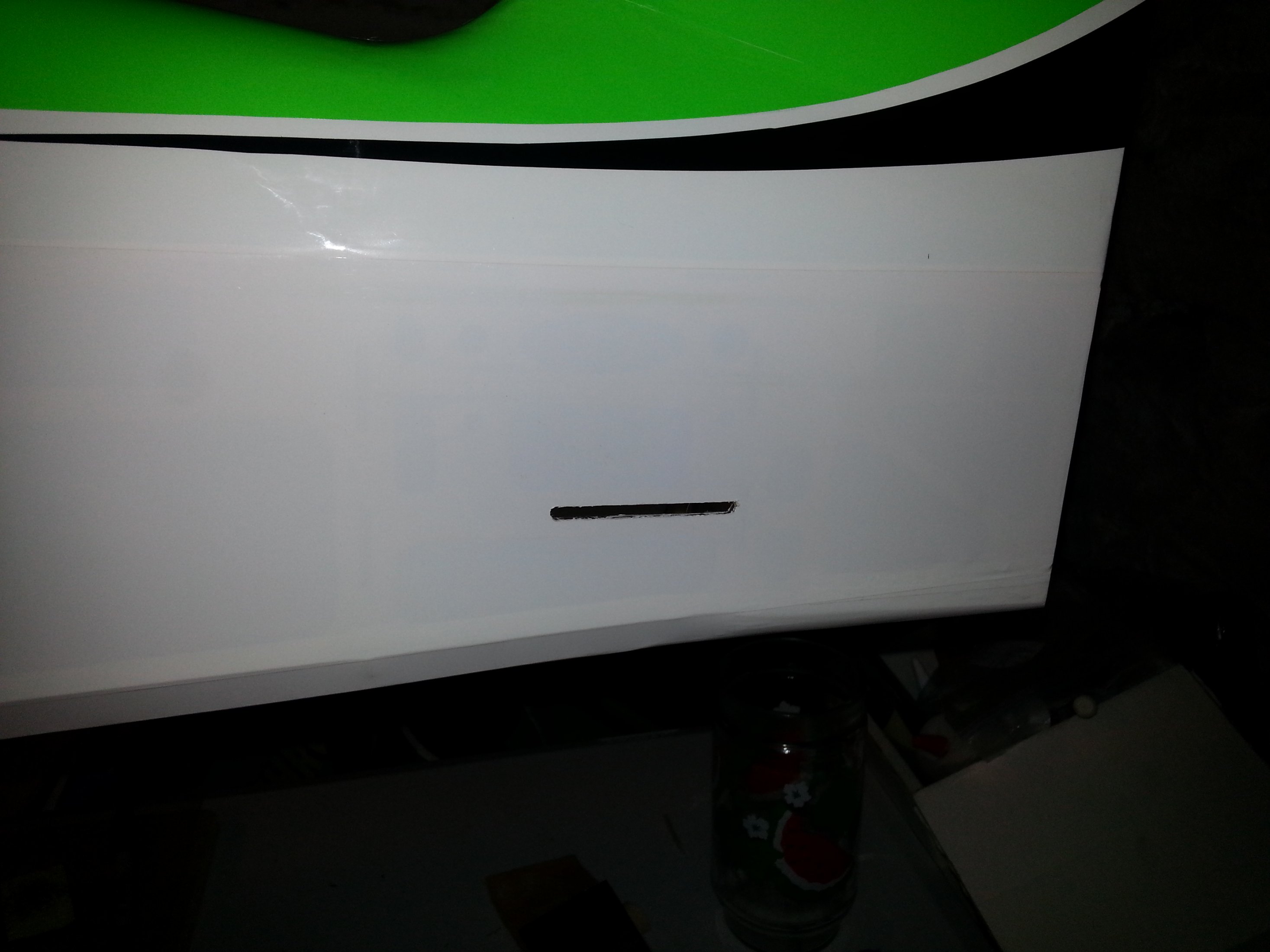

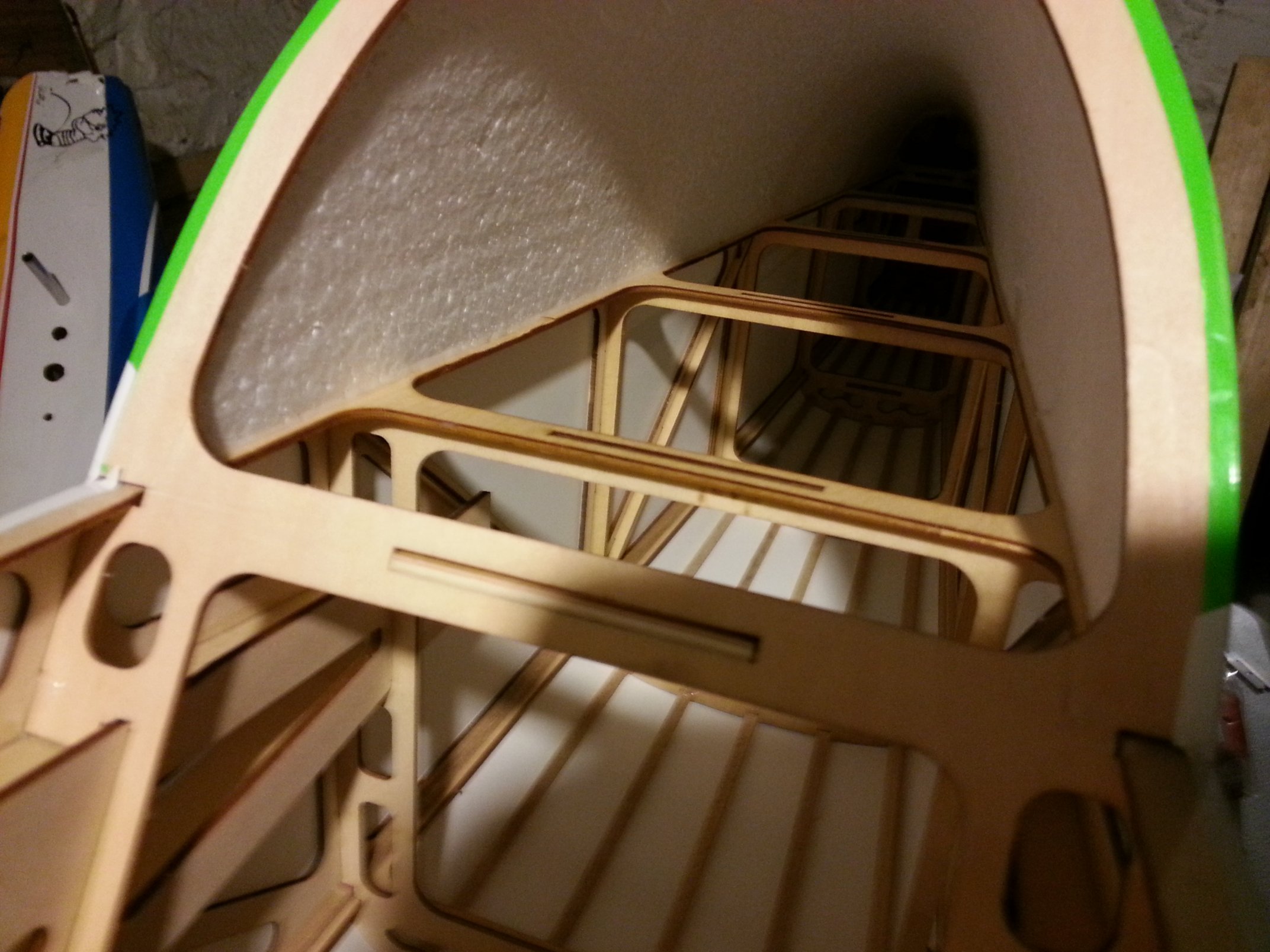

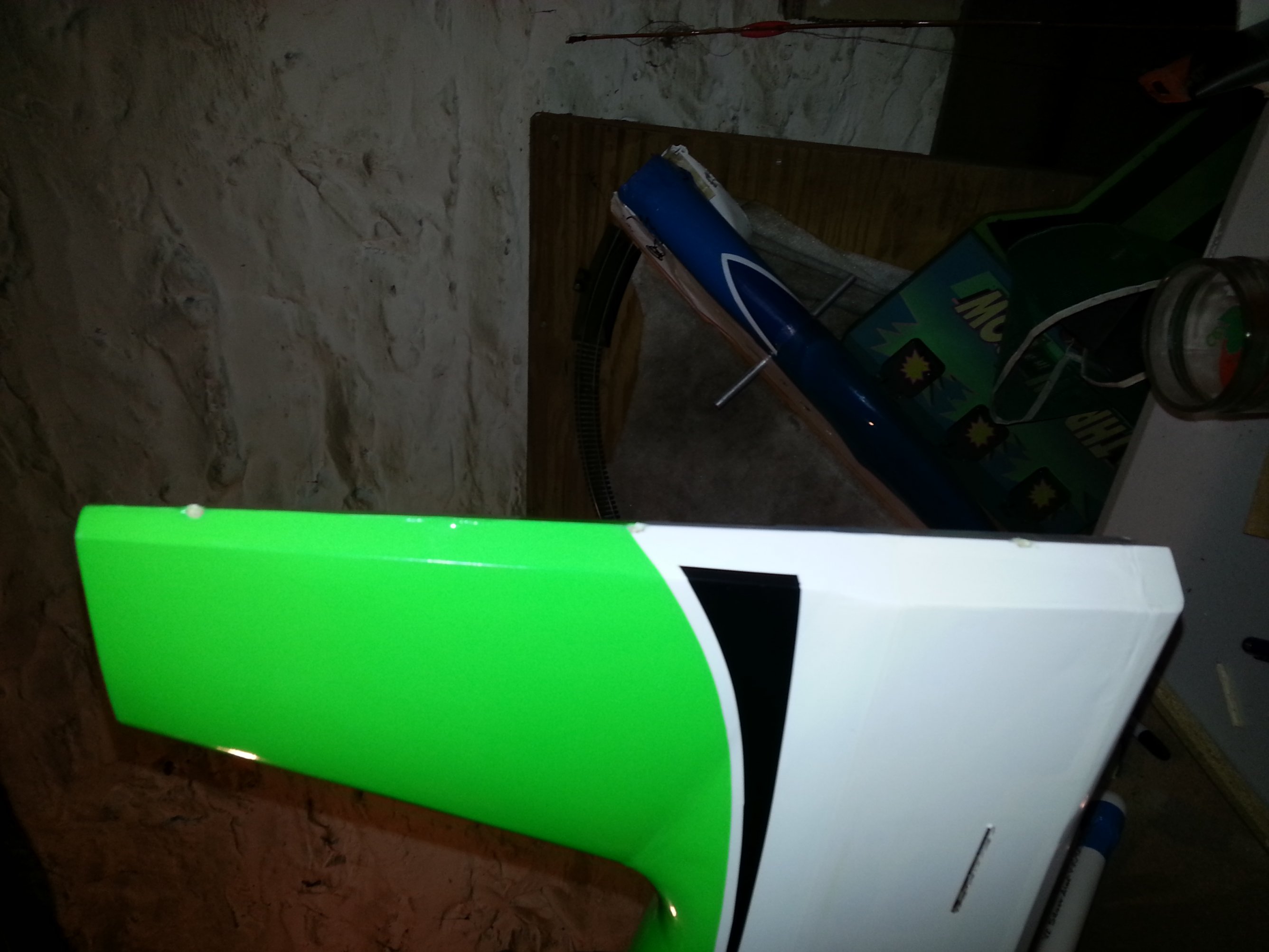

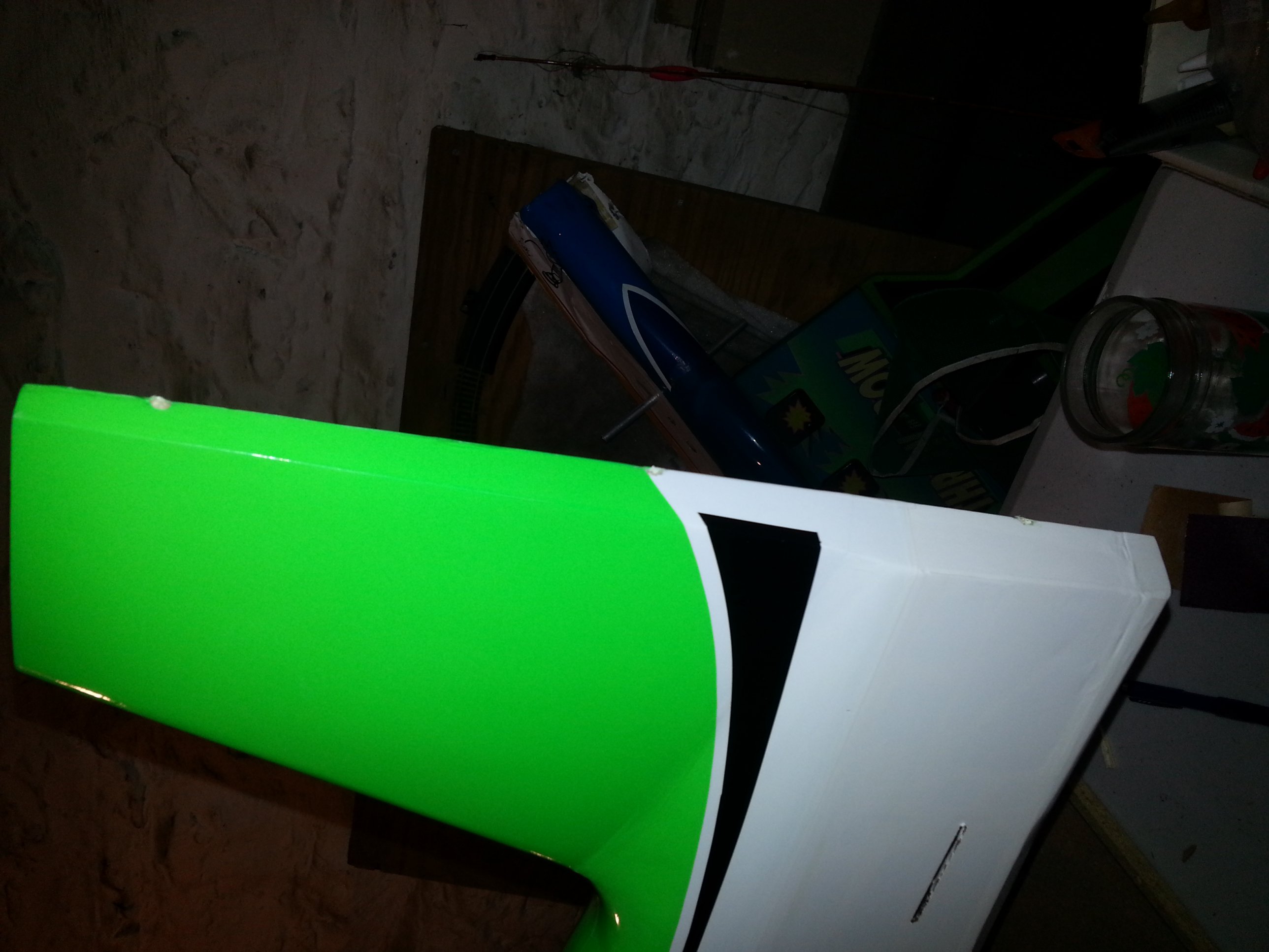

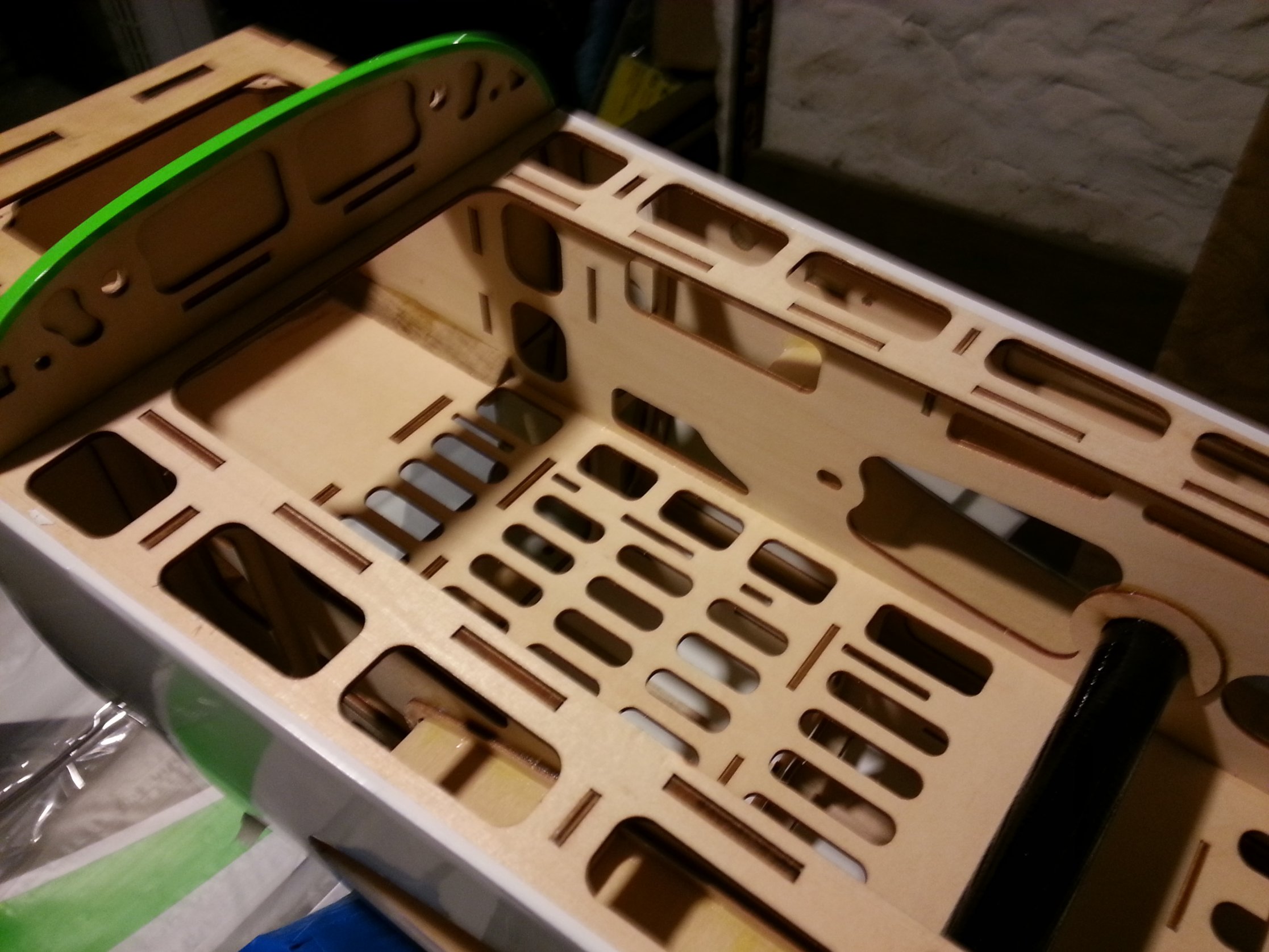

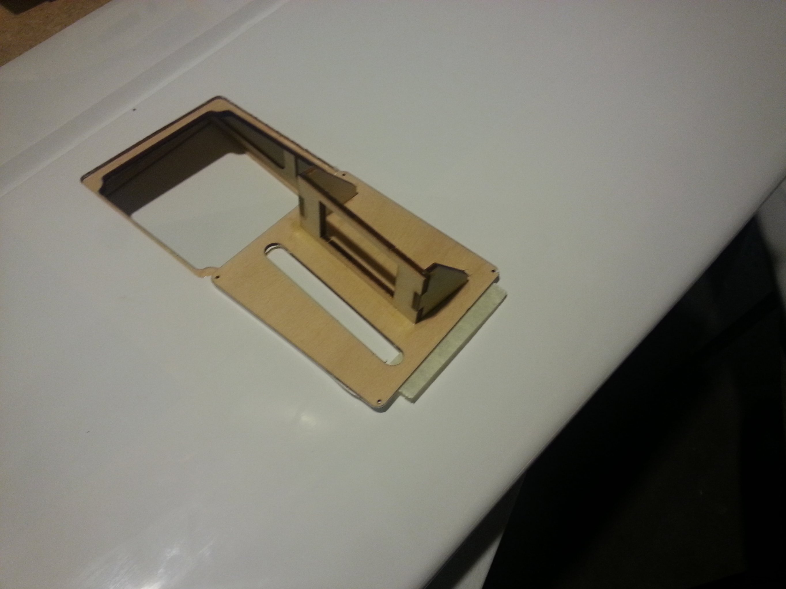

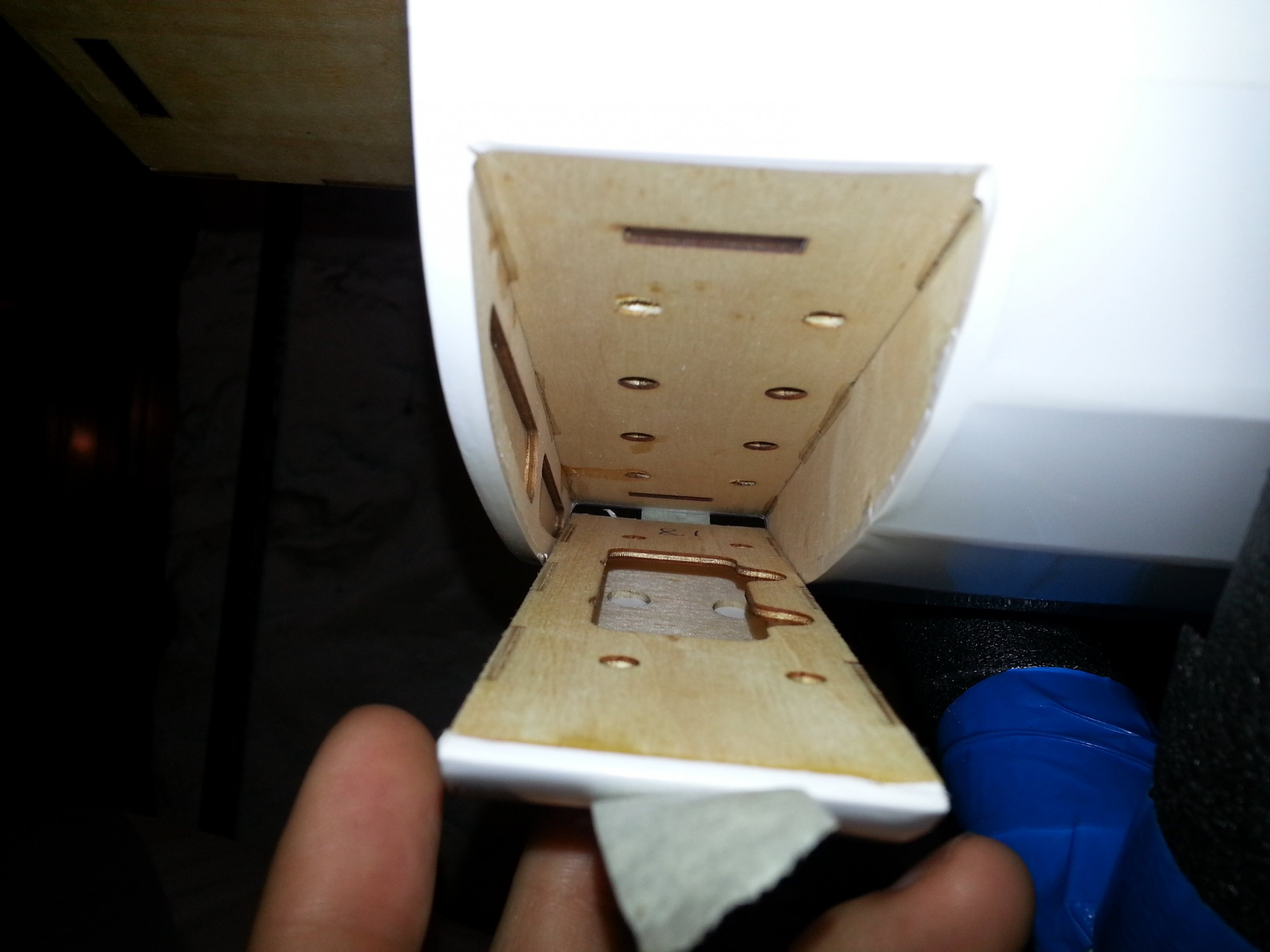

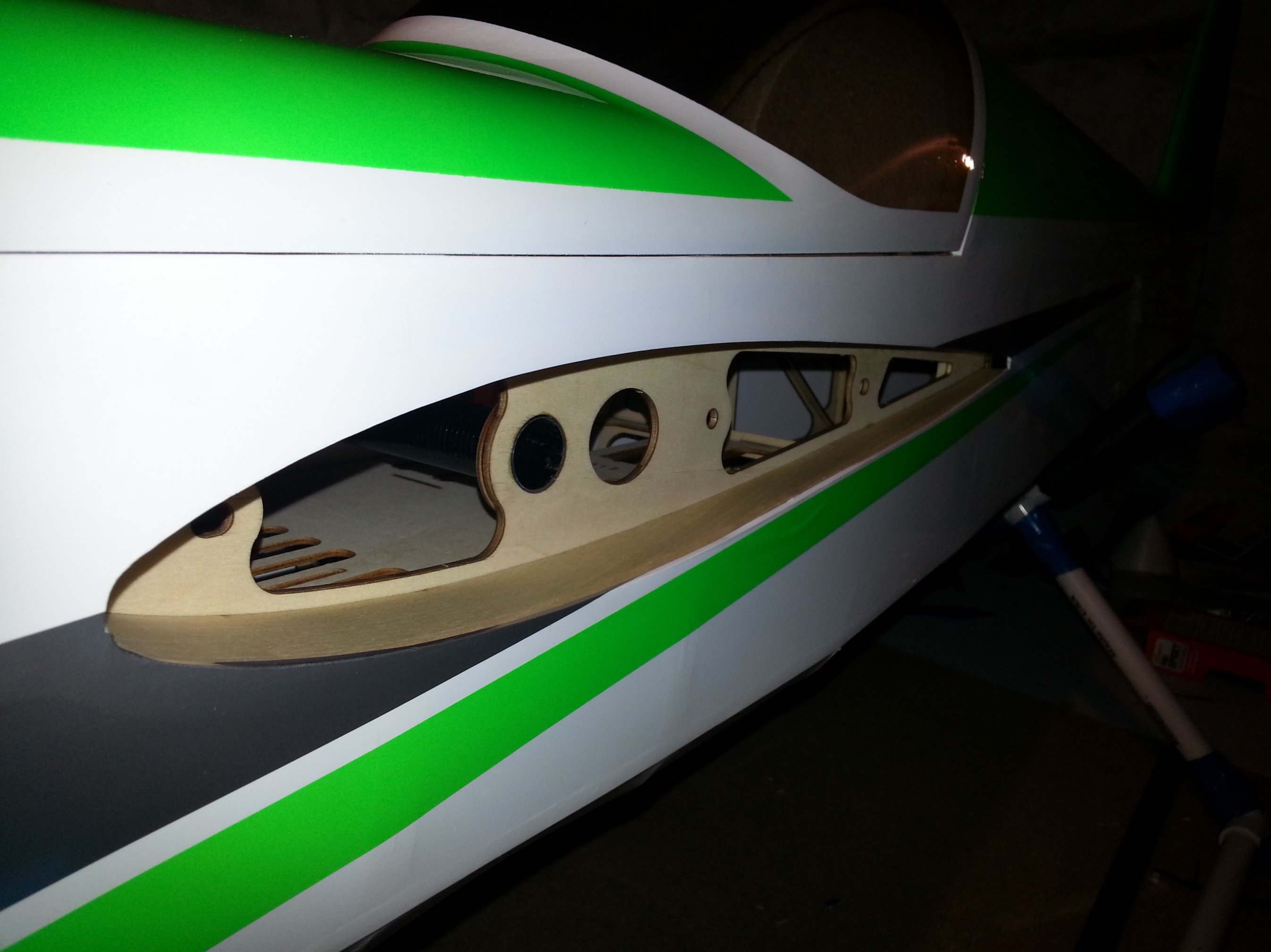

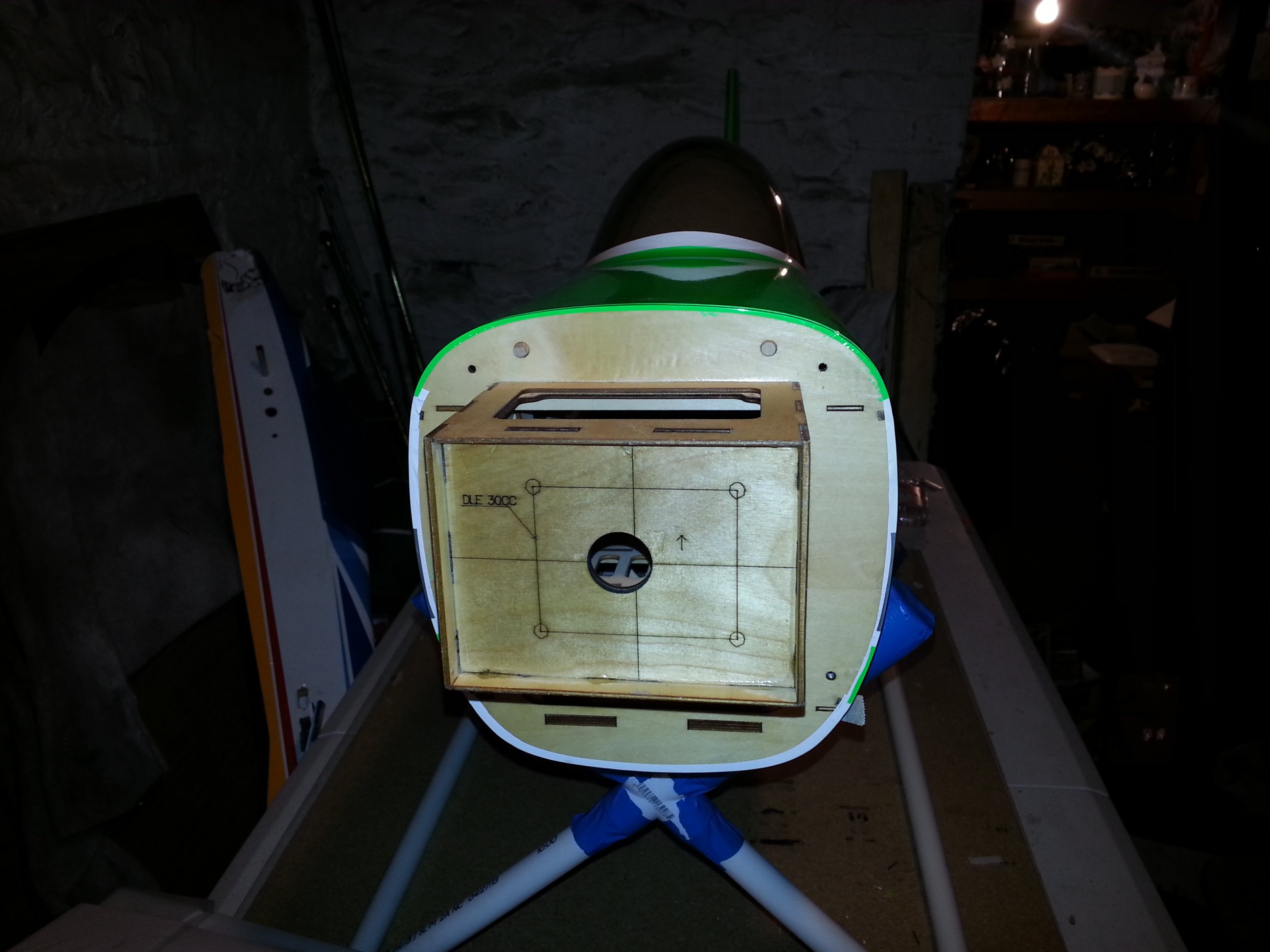

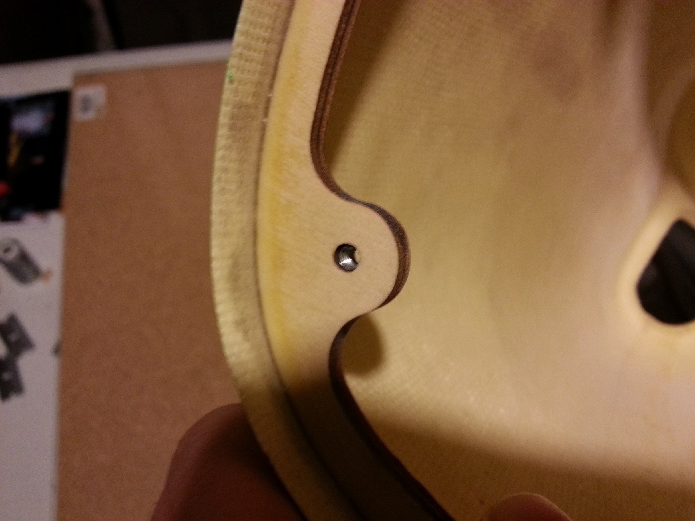

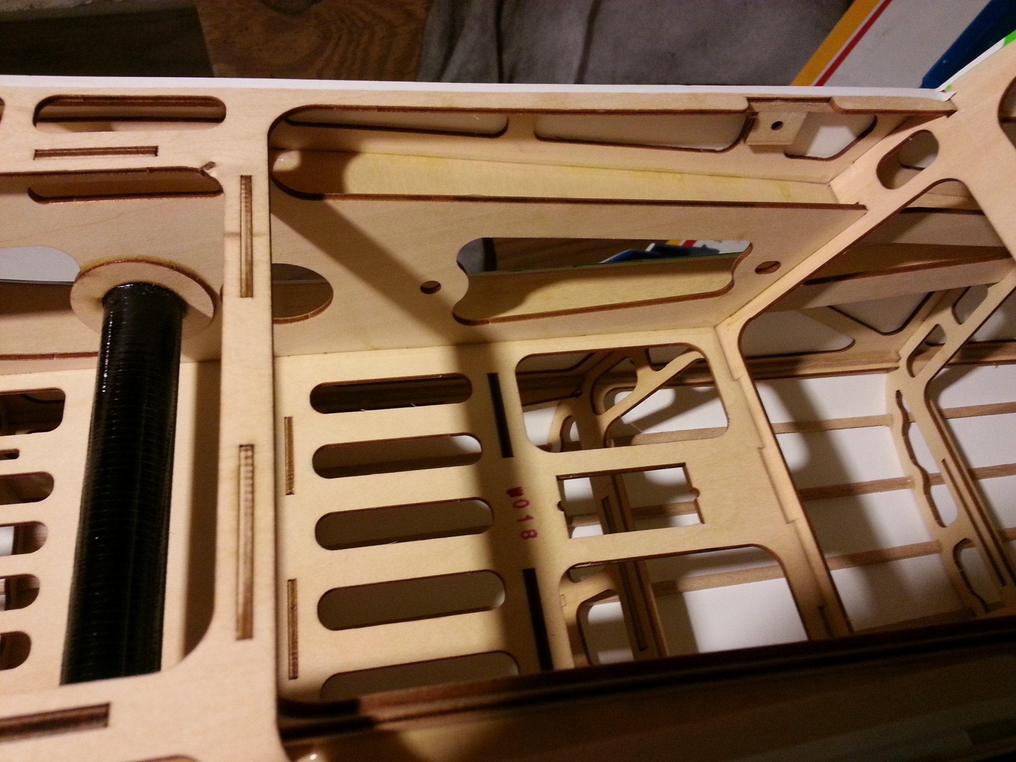

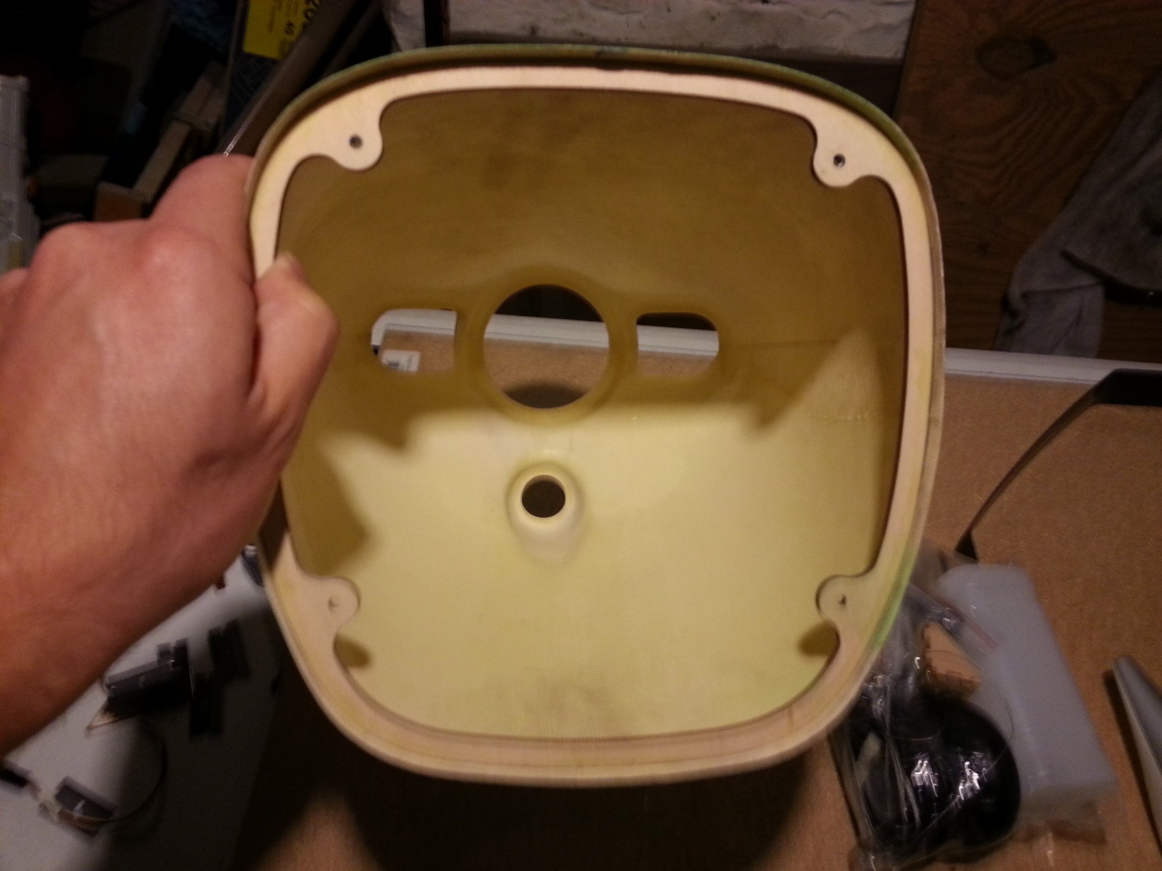

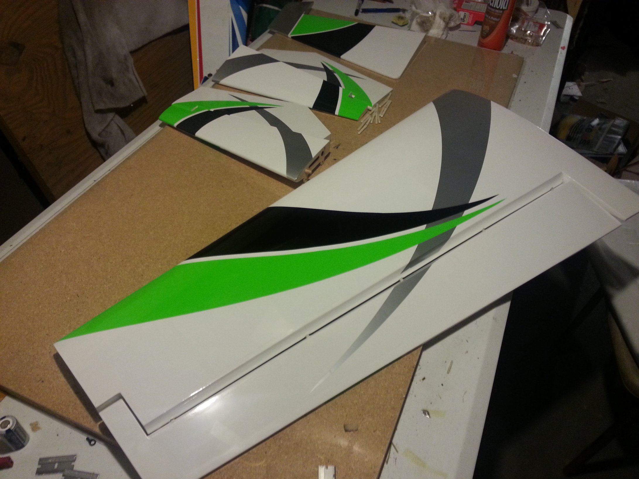

I must say that green really is the new black. Well it is for me at least. I preordered this back in August when I first saw it because I was on the market for a 30cc plane and have been poking around the Redwing's website for a few months doing plenty of drooling. Out of the box, I really like this airplane. It is gorgeous, is built strong, and should be a fast build (by design). Here are some of the features that I like: It has a ringed cowl, recessed wing roots, carbon accessories, turnbuckled metal servo pushrods for easy adjustment, and precut holes for switches and fuel dots. Here are some initial pictures.

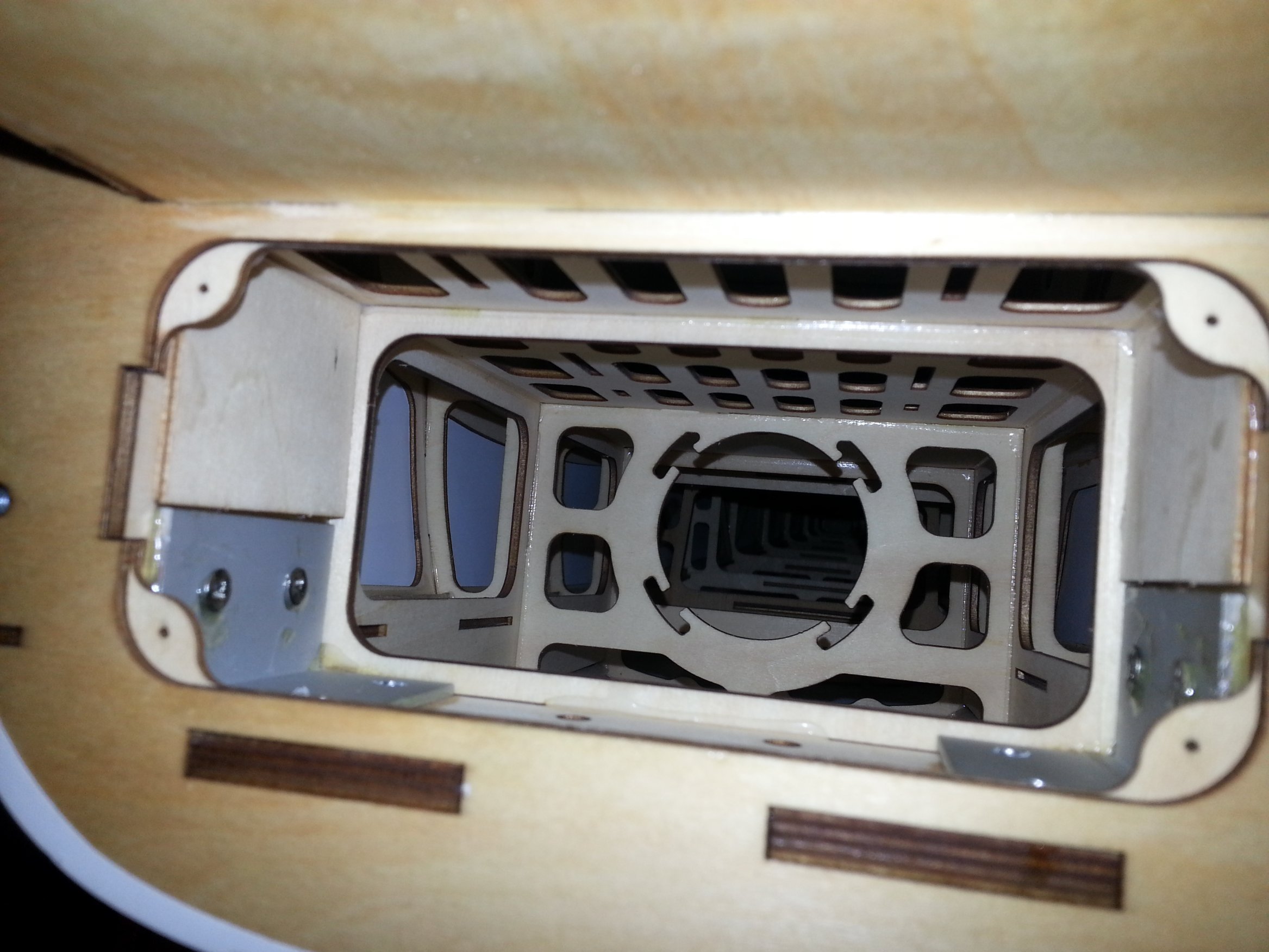

Some things that I forgot to mention in my previous post are the cannister tunnel and the aluminum reinforced cannister tunnel plus a complete hardward package.

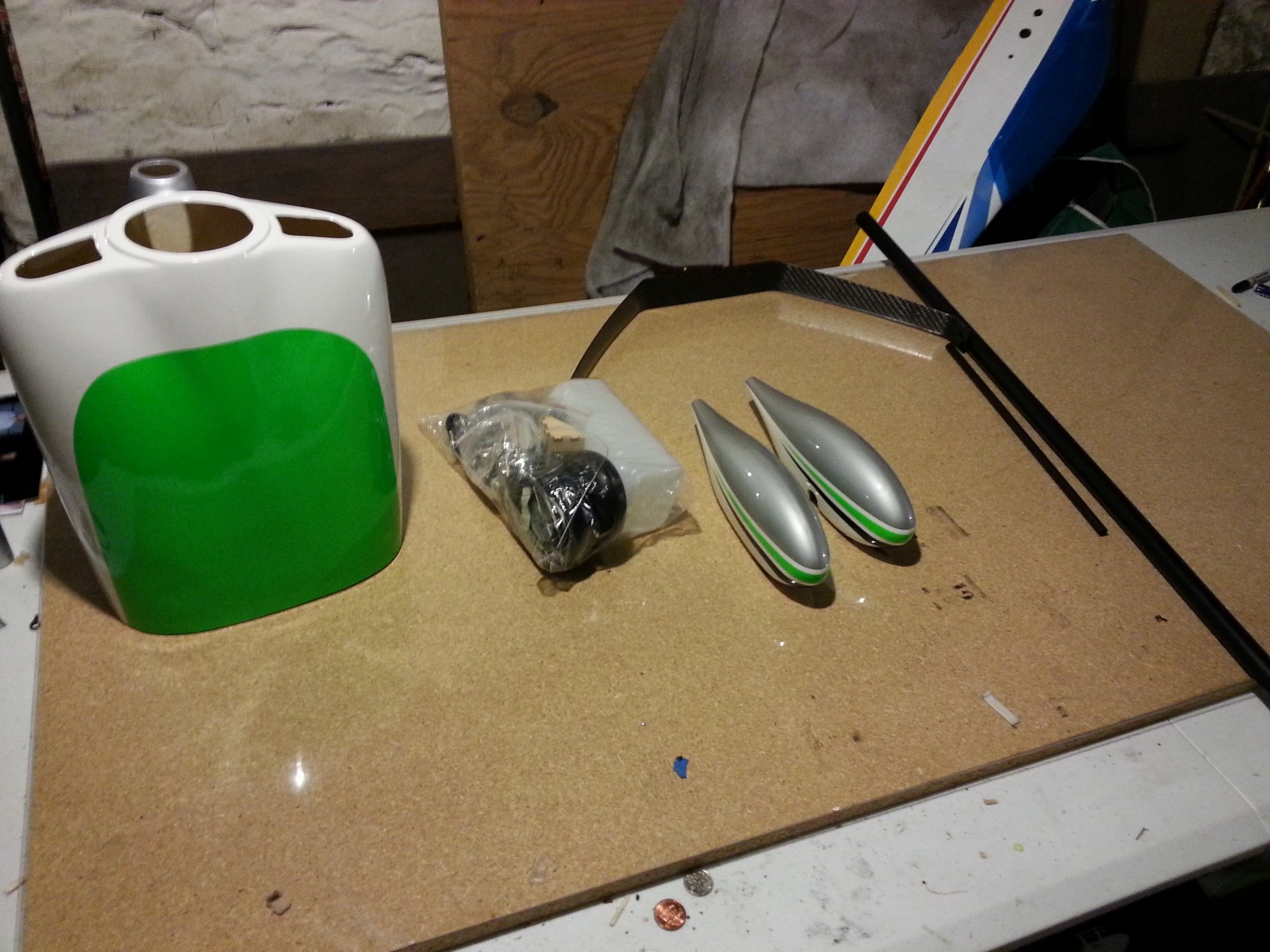

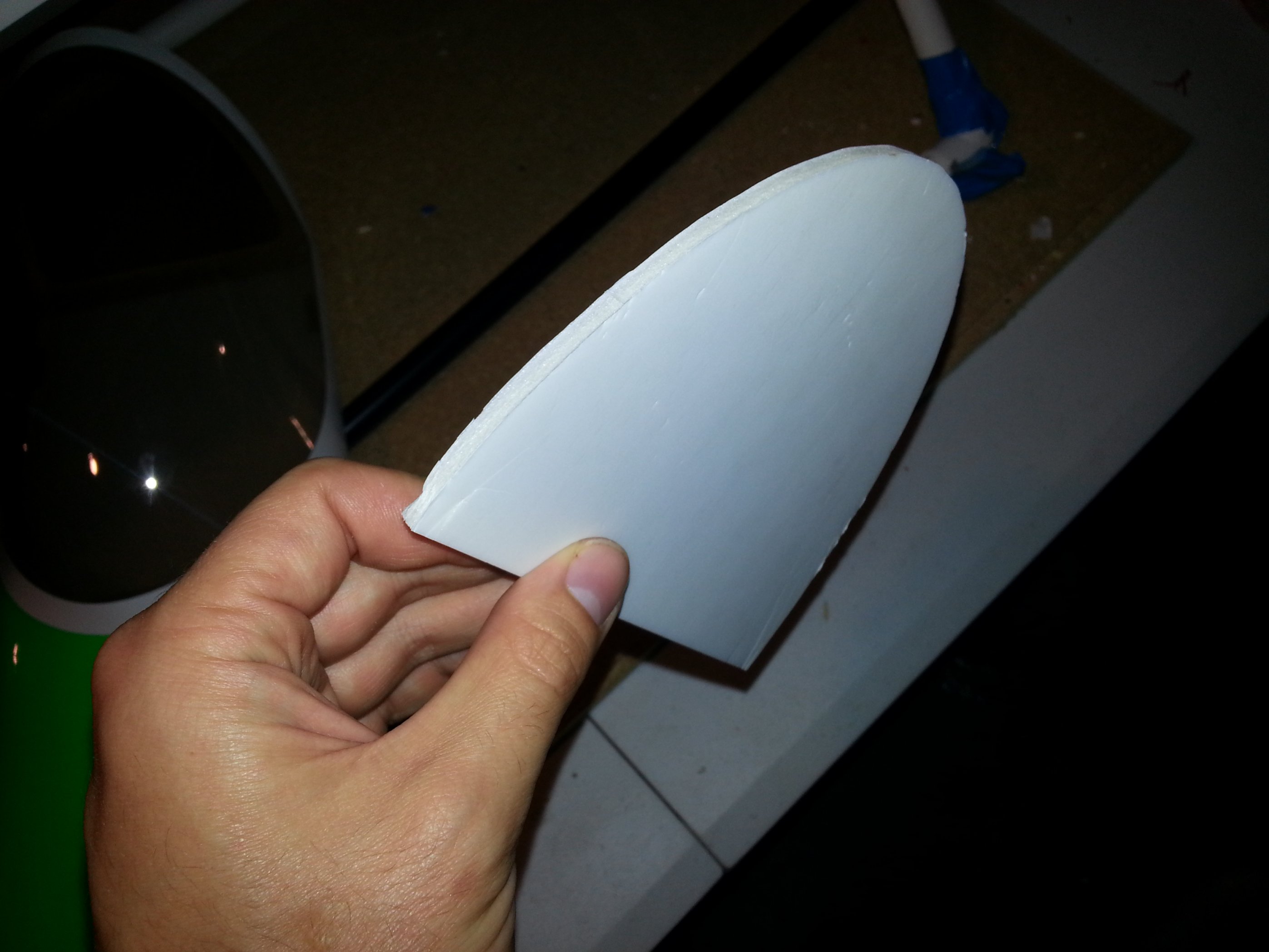

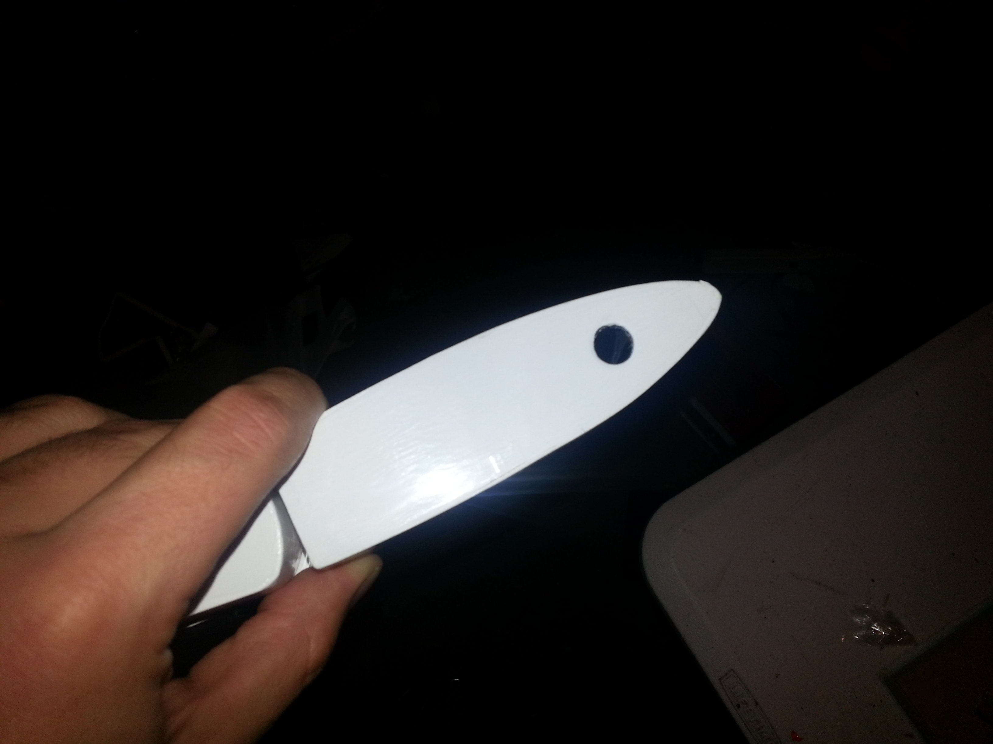

My other criticism is with the wheel pants. The paint job on them is absolutely gorgeous but if you are lucky enough like me to fly off of asphalt, you'll actually want to put them on your airplane. The issue is they are a hard plastic and I am worried about cracking them up over time. Now I also don't consider this a serious issue either because I know that many of you fly without wheelpants due to their catching in grass. I also go to a lot of local events during the season on grass fields and will have to take mine off pretty frequently as well.

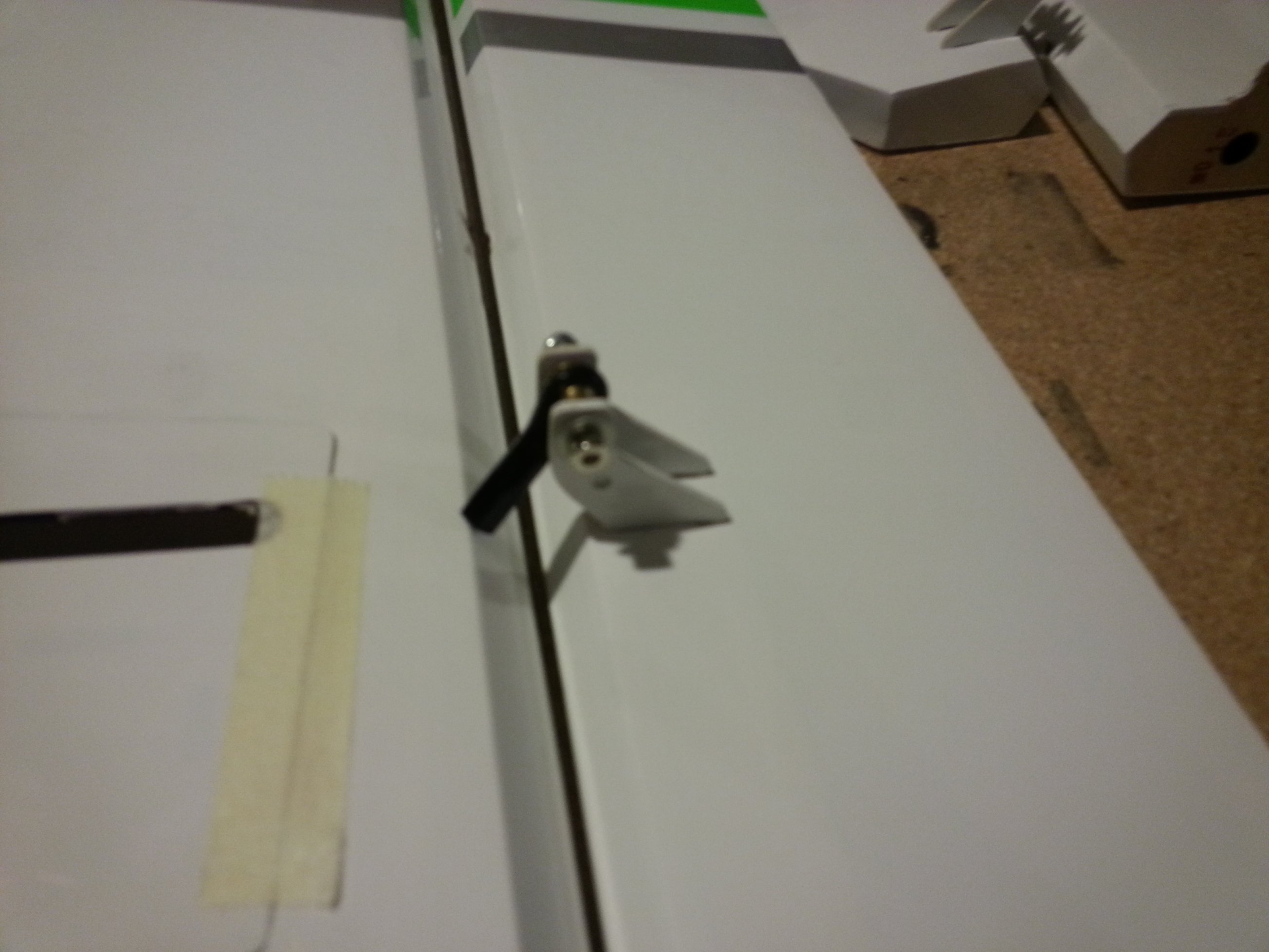

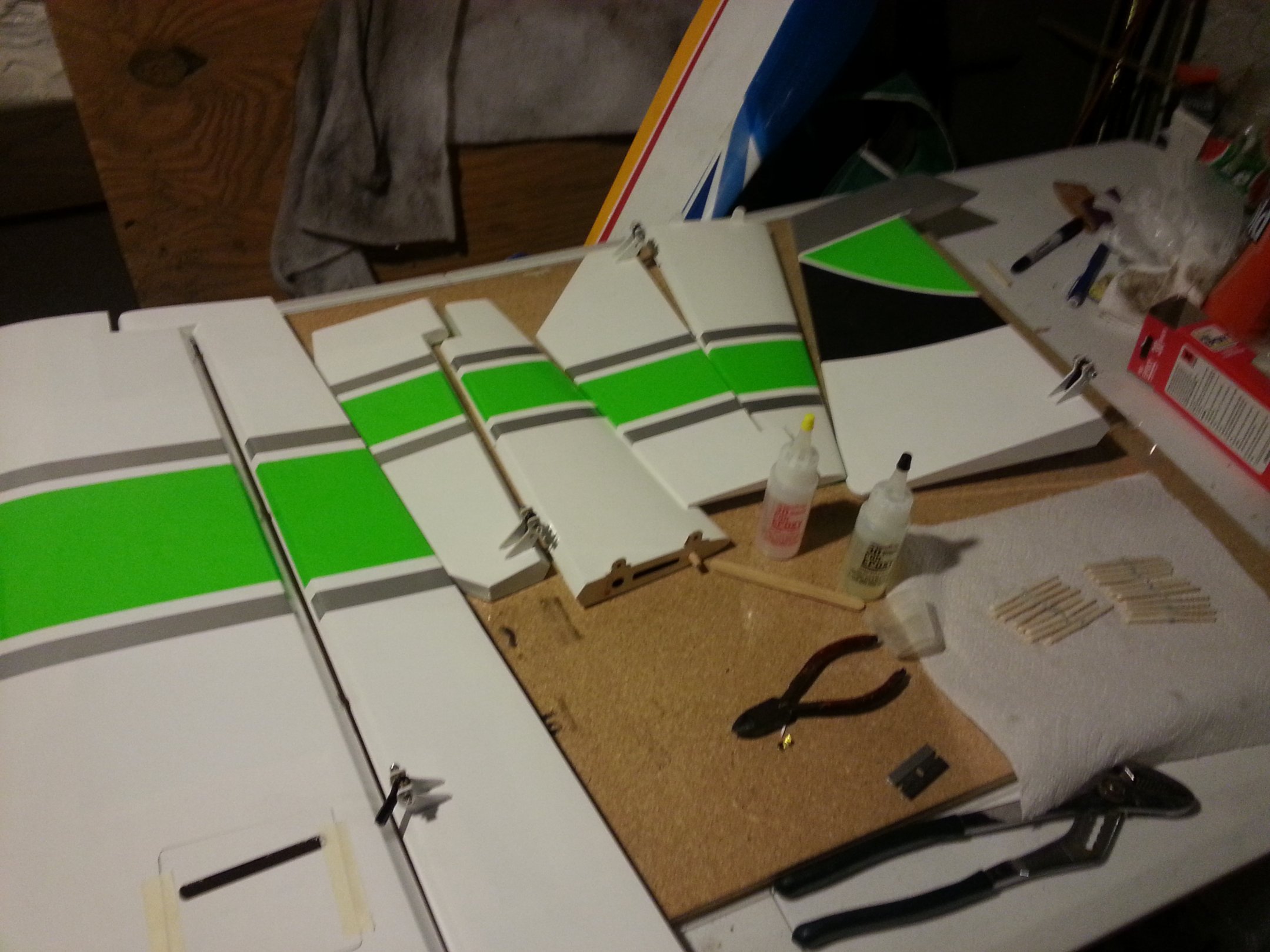

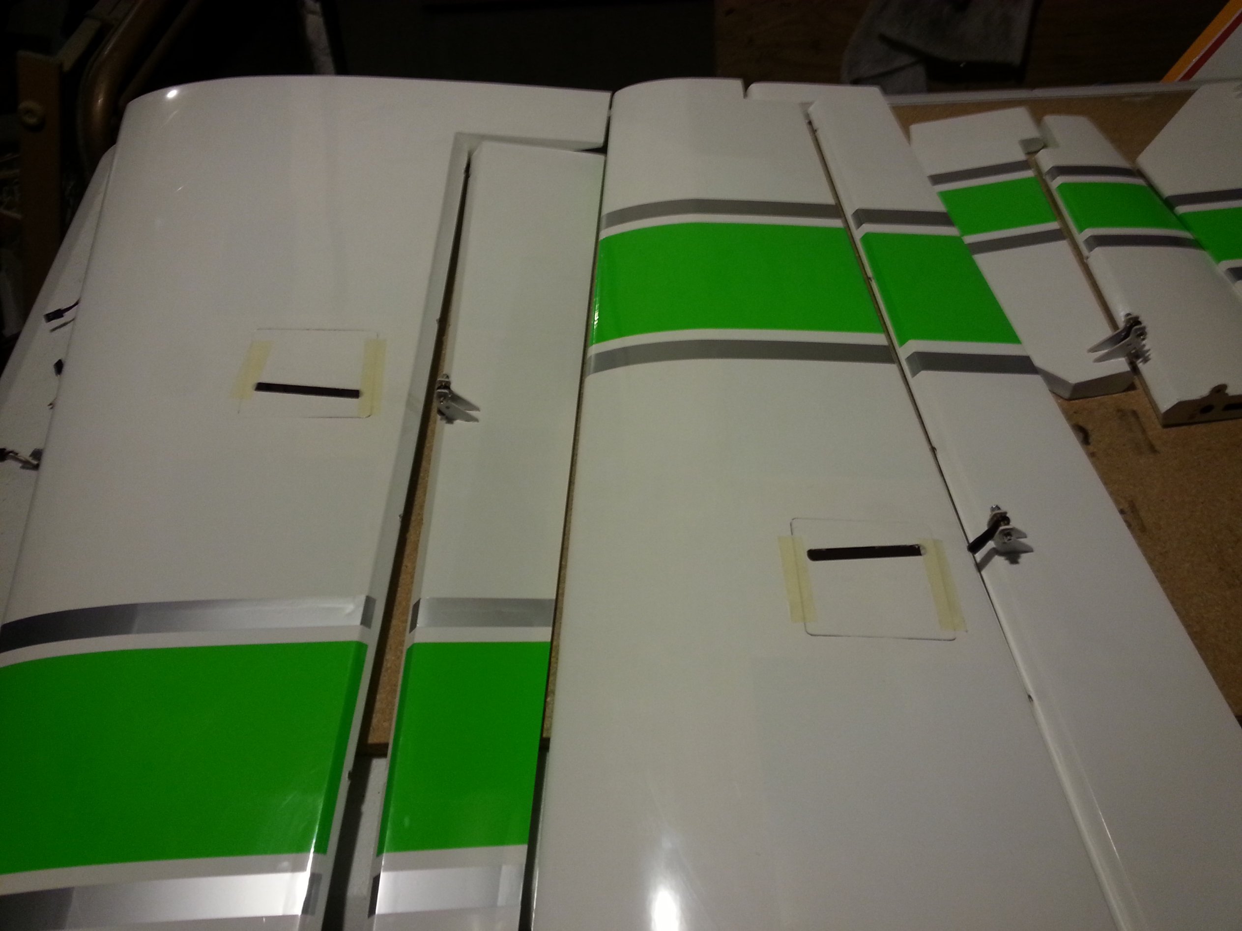

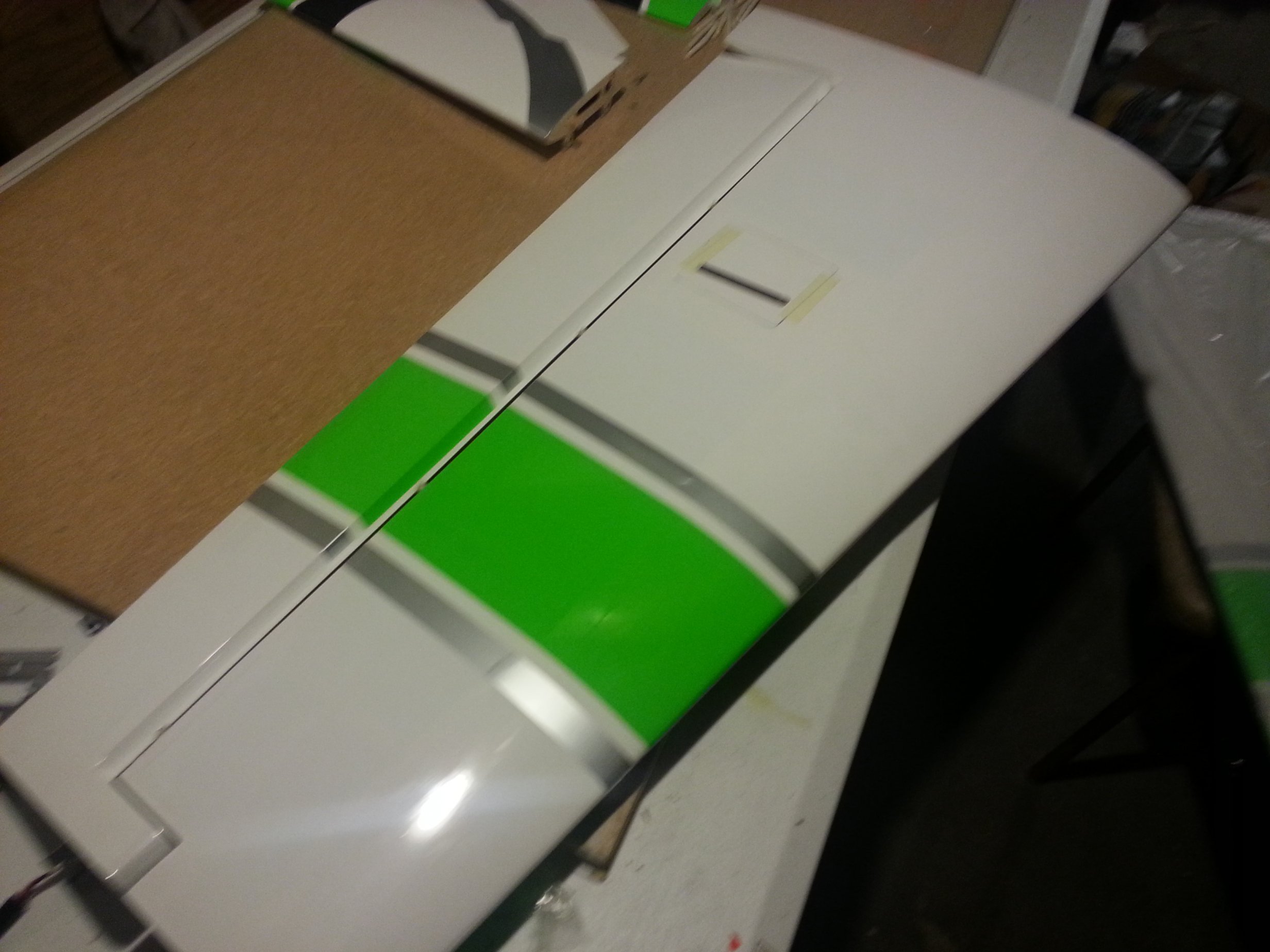

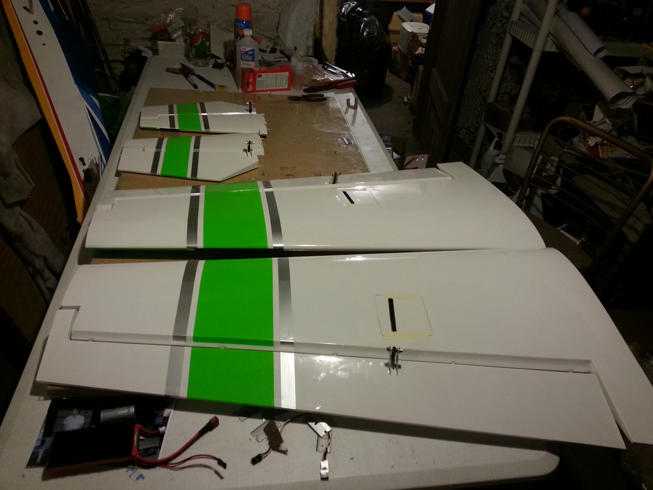

You can see here that the hardware pack includes painted double truss phenolic control horns. Just like in the video, I cut the bottom tabs off of each one and dry fit them all. I had to cut just a hair more than the bottom tab off of the rudder horns because they were interfering with one another from fully seating in the rudder. I also took this time to dab some Vaseline onto the hinge points of the Robart style hinges so that I wouldn't accidentally epoxy them. I mixed up some nice slow 30 minute epoxy so that I would have enough time to do everything at once. Between seating everything properly and ensuring proper hinge gaps, I had to move quick. I did not want to do that so I just quit halfway through the process and made a second batch of epoxy to finish the job. In the future, I will leave this as two separate steps. It all went together fairly easily so far. Here are the results.

Also, my wheel pants on the 50cc are holding up great. They seem a little cheaper but actually they are more durable I think. I'm guessing 40 flights and on one of my last ones, motor died, put it in the beans, it was flipped over and no damage, thought for sure the wheel pants or gear would have had damage. We are talking beans that need harvested not nice green mid summer beans.

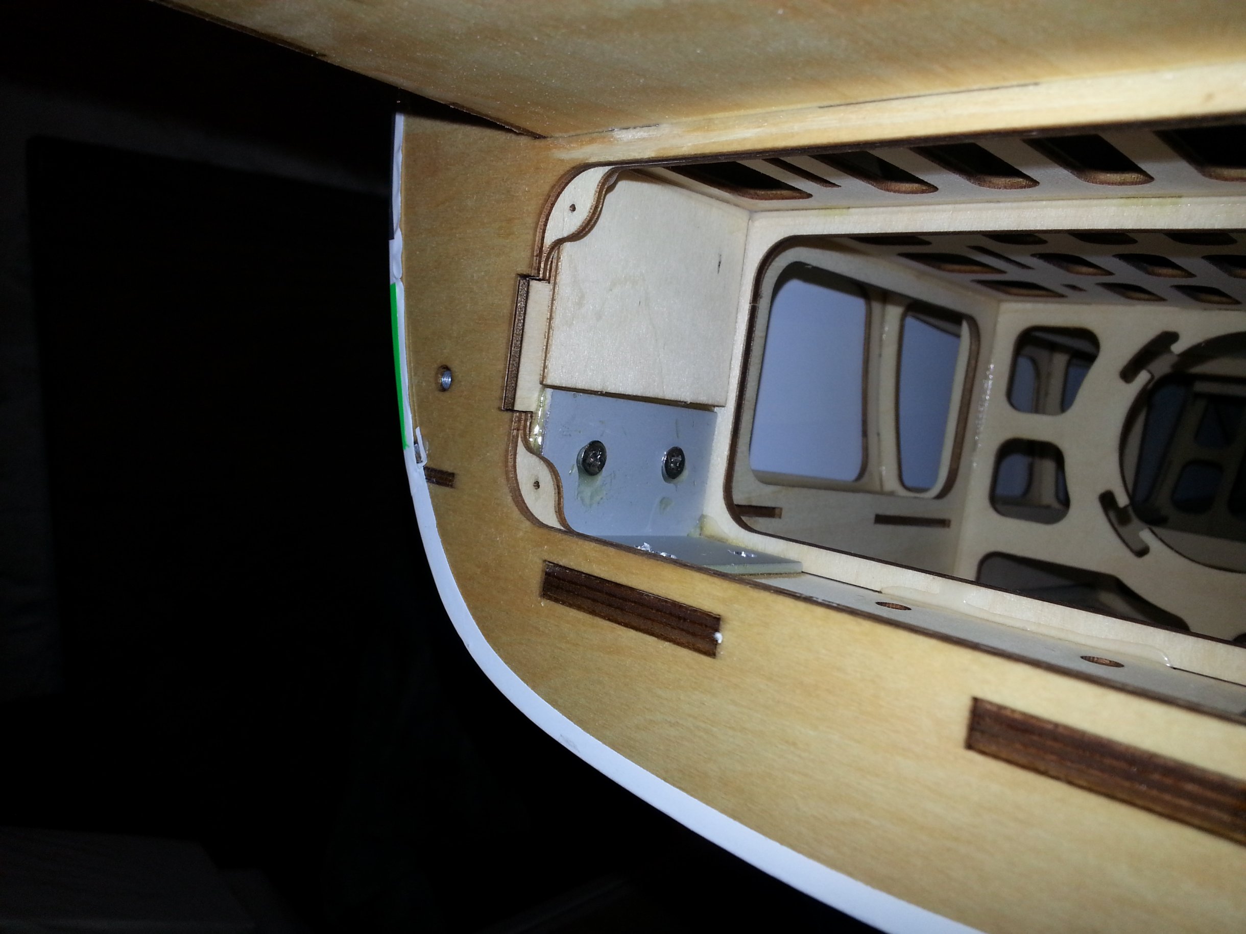

There's a gear cover that came with the kit that wasn't mentioned in the manual or any of the build videos. Based on the hardware provided I made a best guess as to how to mount it all. I think I got it right but I'll post a picture tonight showing what I did if you wouldn't mind checking my work.
I had a little trouble fitting the wheel pants to the gear. The hole in them that slips around the bolt that you use to tighten the axle to the mains is tight and I had to make sure the orientation of the bolt was such a way for the pant to slip on easier but it was tight. The bolts that secure the pants were also a little long and I had to reposition my wheels on the axles for clearance. I'm debating going back and cutting the bolts down for better clearance but it's all attached now.

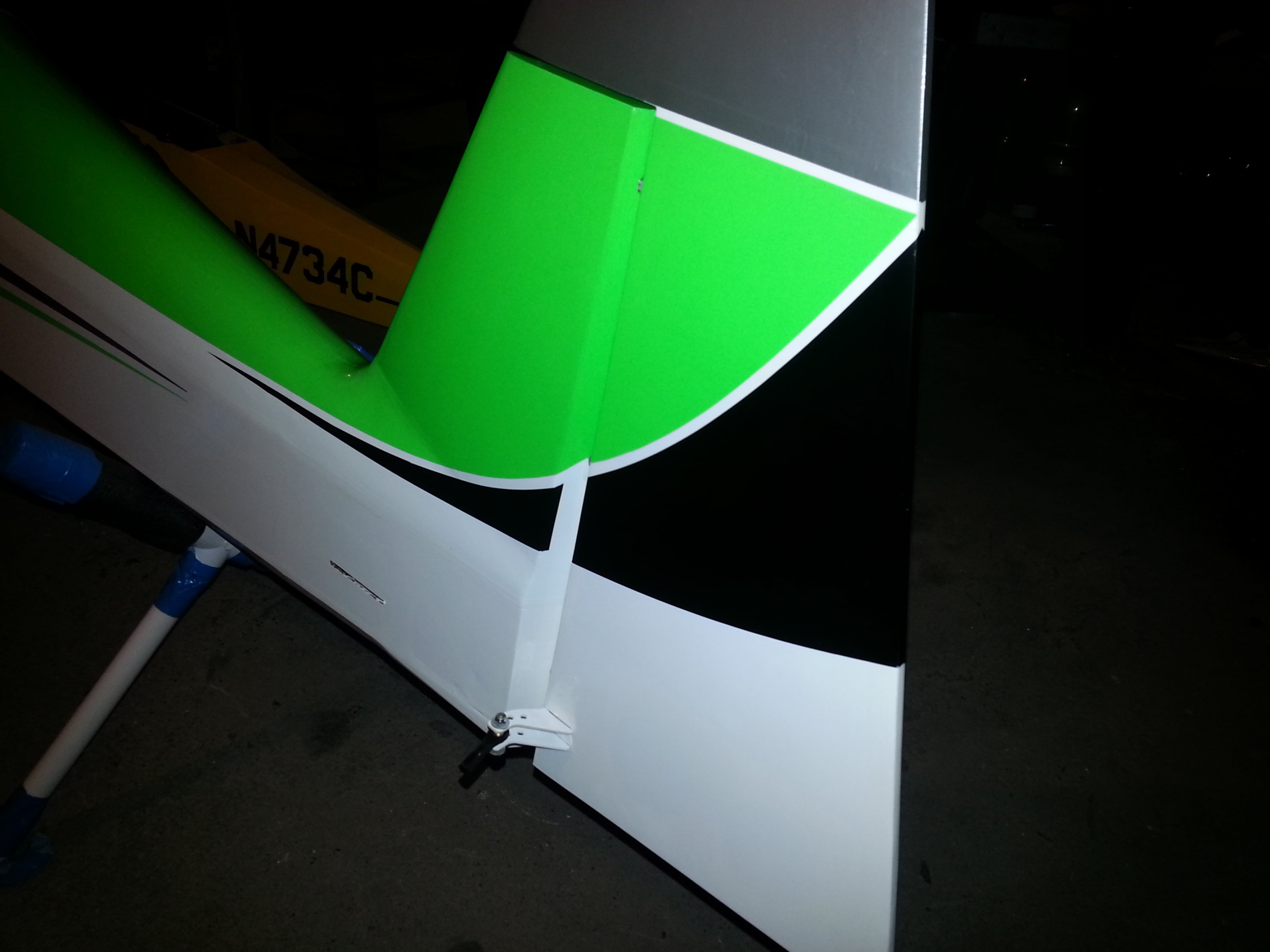

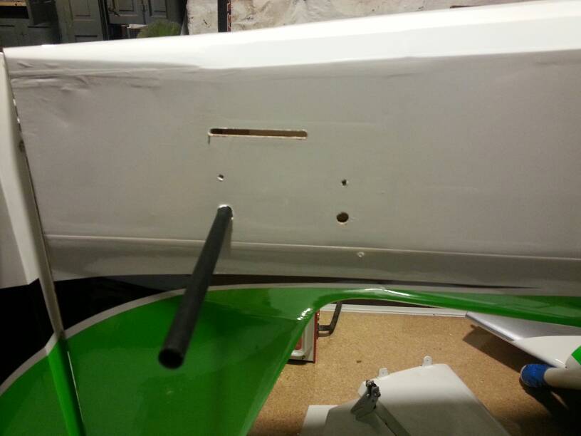

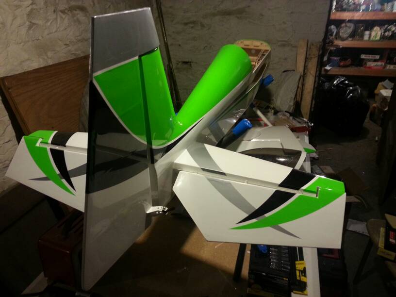

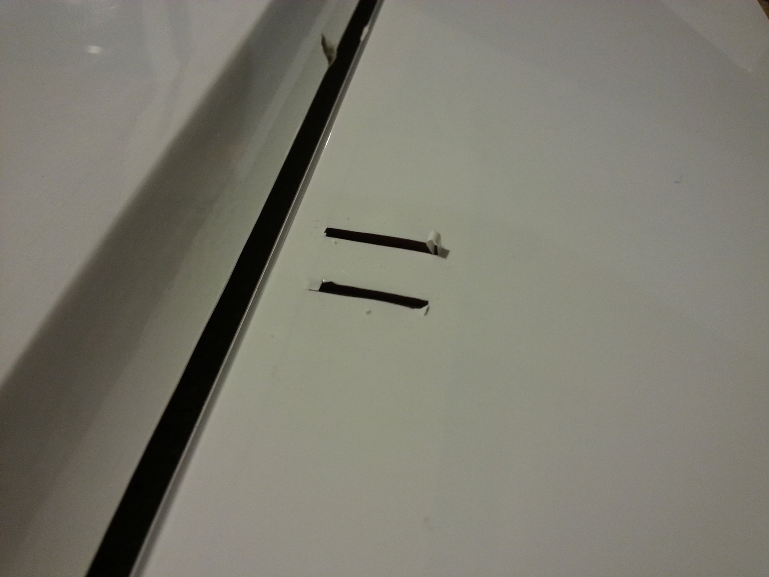

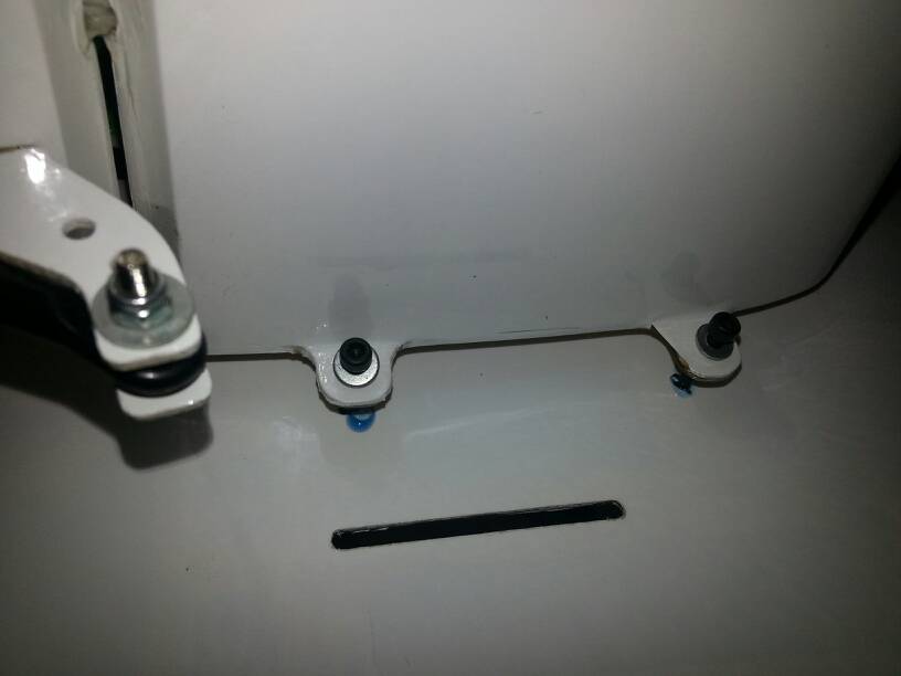

Pictured is the bolt on stab. I was originally going to use split lock washers to keep it removable (I drive a Rav4) but I didn't like the idea of assembling and disassembling the servo linkage at the field so I ultimately used blue locktite. Each stab slides onto the carbon shaft and then bolts on with two bolts. The holes are covered initially but be careful cutting them open as there are blind nuts pre-installed. The slit for the rudder cable was precut.

I don't even lock tight them, I just check them in preflight. But a lot of guys do. Or use rubber bonded washers. Here is a thread on GiantScaleNews a good friend of mine started. He's building an orange one.
