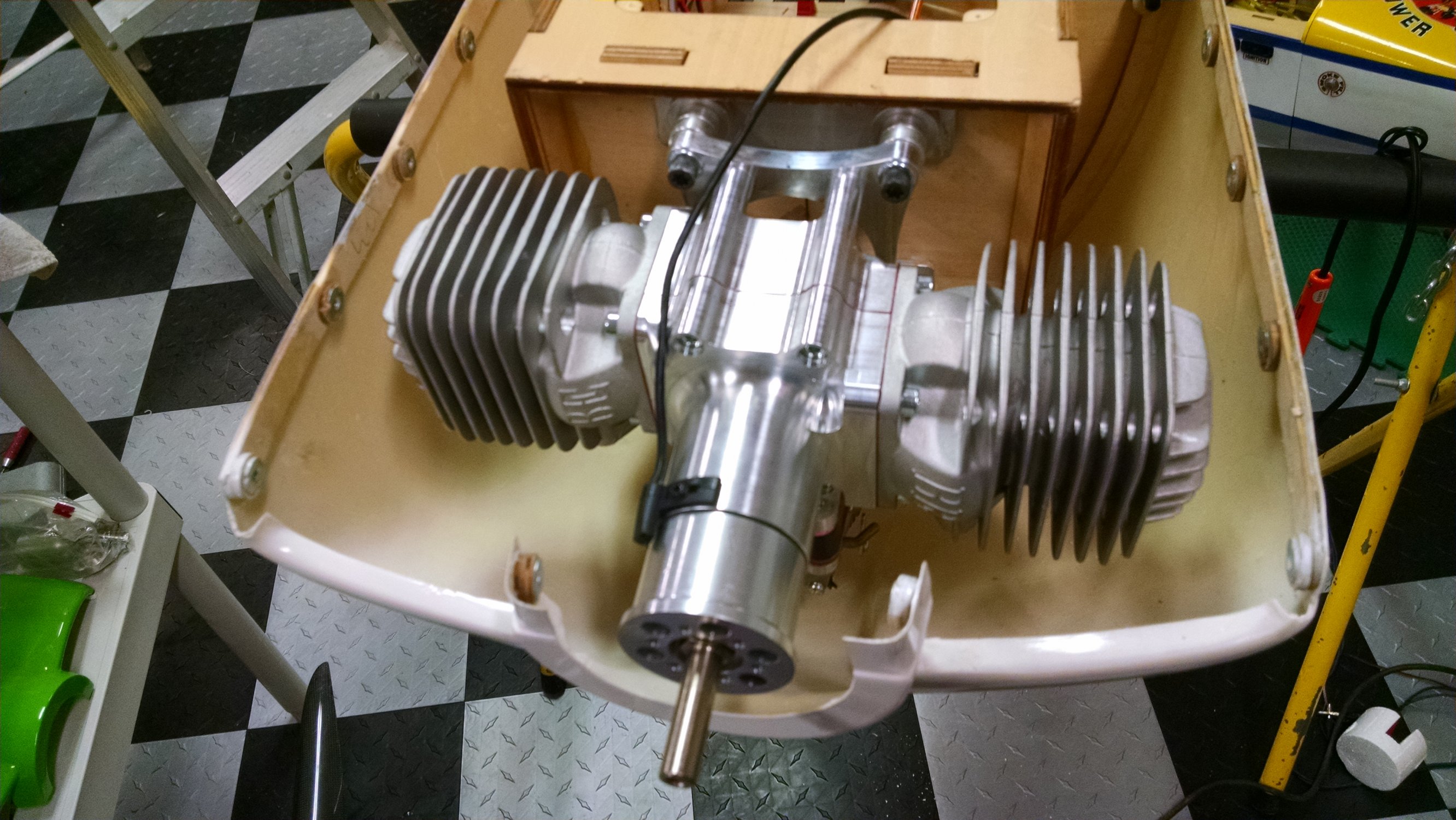

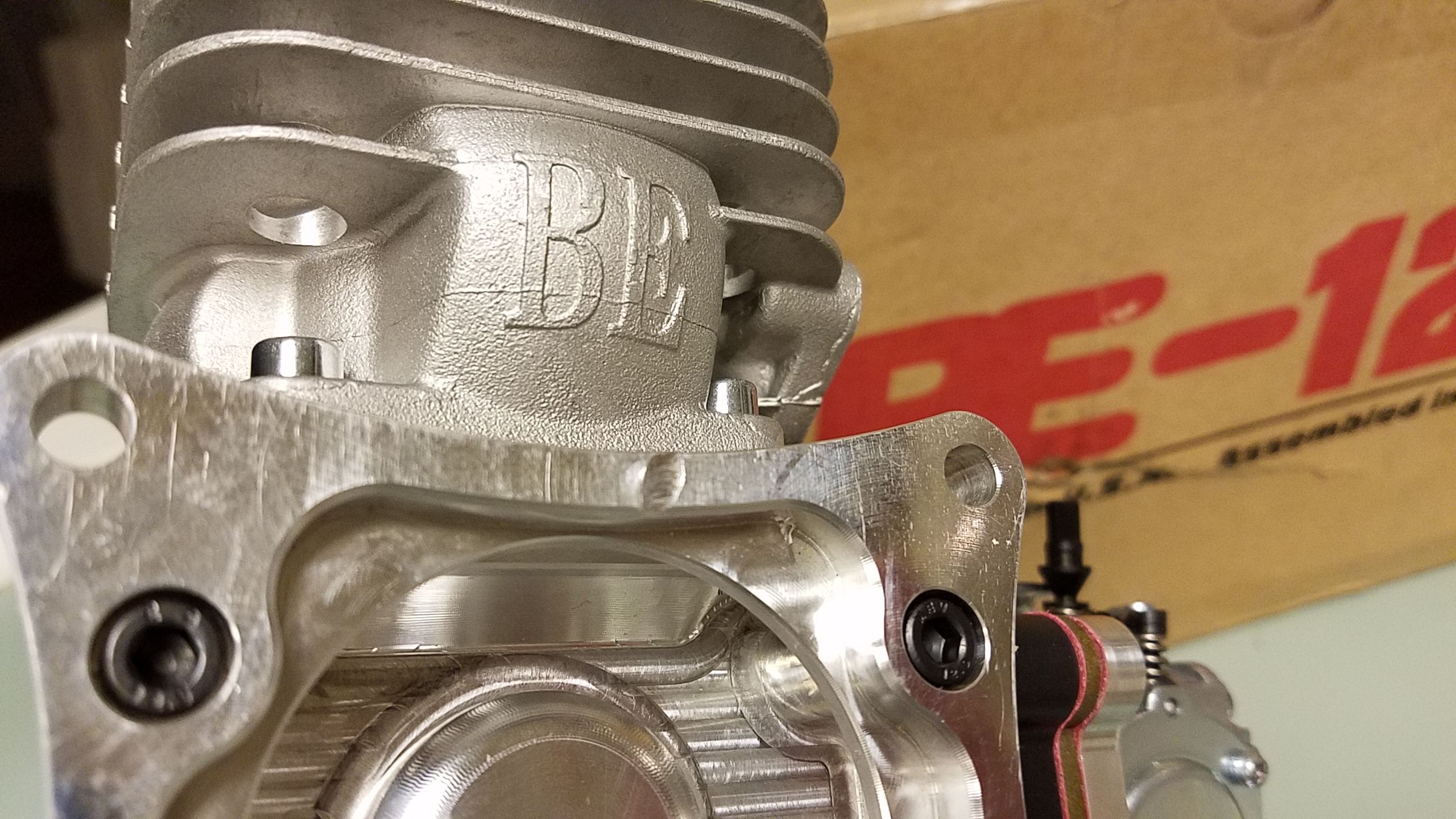

Well I got mine today and started mounting. Impressions:
-Motor looks good and mine came with a thick polo shirt
-it mounted in same pattern as 3w
- mufflers can be mounted stacks forward or back. Stangflyer said he gets more rpm with them back. No smoke nipple and if you put stacks back you need to put nipple on the front or side or it will go right out the pipe.
- for me...i hated the auto choke feature. I cut that plastic tab off
- the choke is backwards compared to 3W. So that is going to play havoc as I always pulled choke lever forward and its now opposite.
-throttle linkage extension it comes with has a little play. I'm going to JB weld it along with the screw to keep it tight. But I got it mounted with my servo.
I'm nitpicking.......hoping I can do a test run soon, but I need a few parts first for the plane

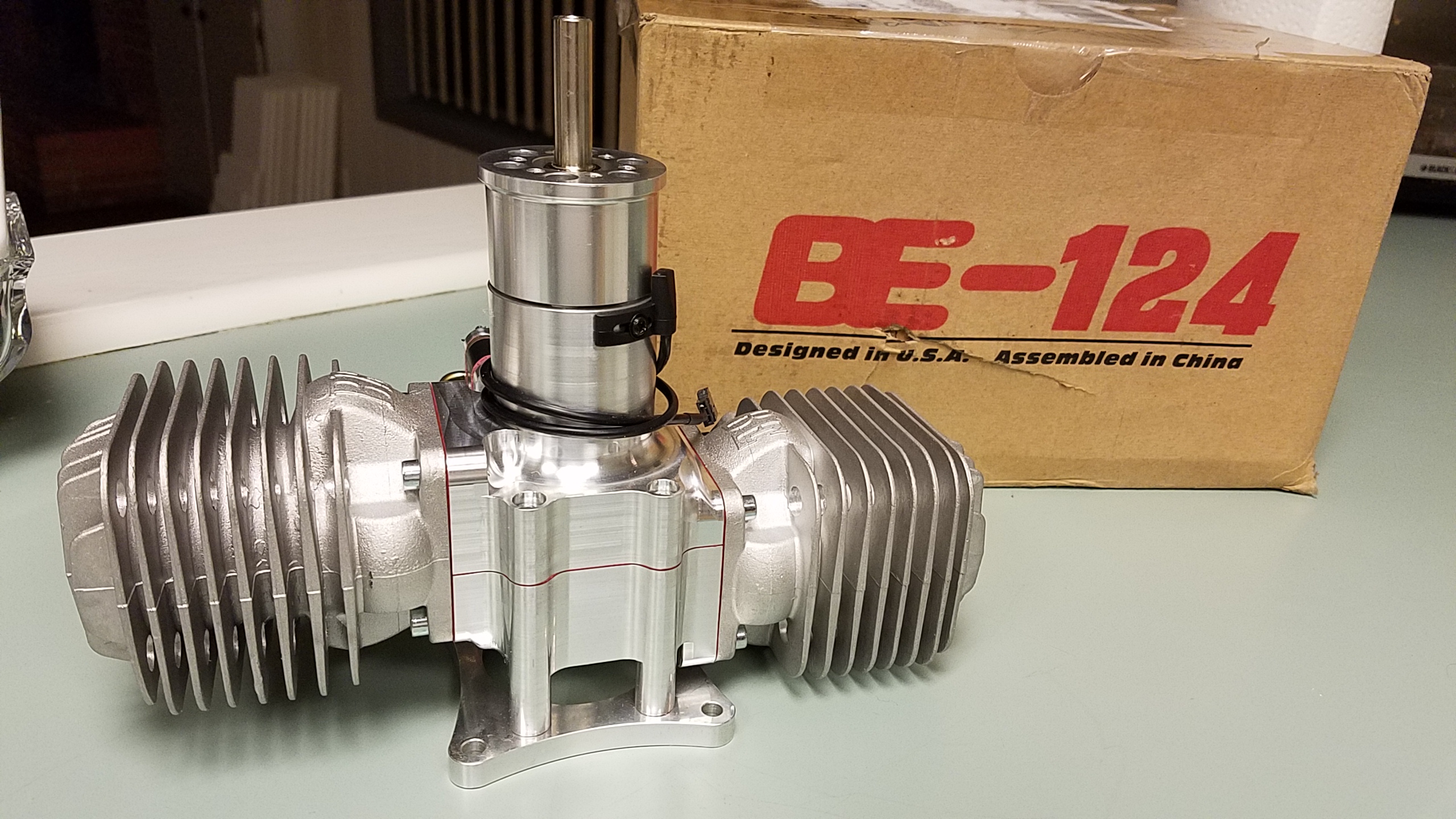

. Never ever had an issue with USPS, UPS or EMS but I'm sure they have the same issues.
. Being I know how the first generation DA 120 performed it is going to be interesting to see how this engine performs compared to it. I find it curious however that the box says "Designed in the USA"...."Assembled in China".
