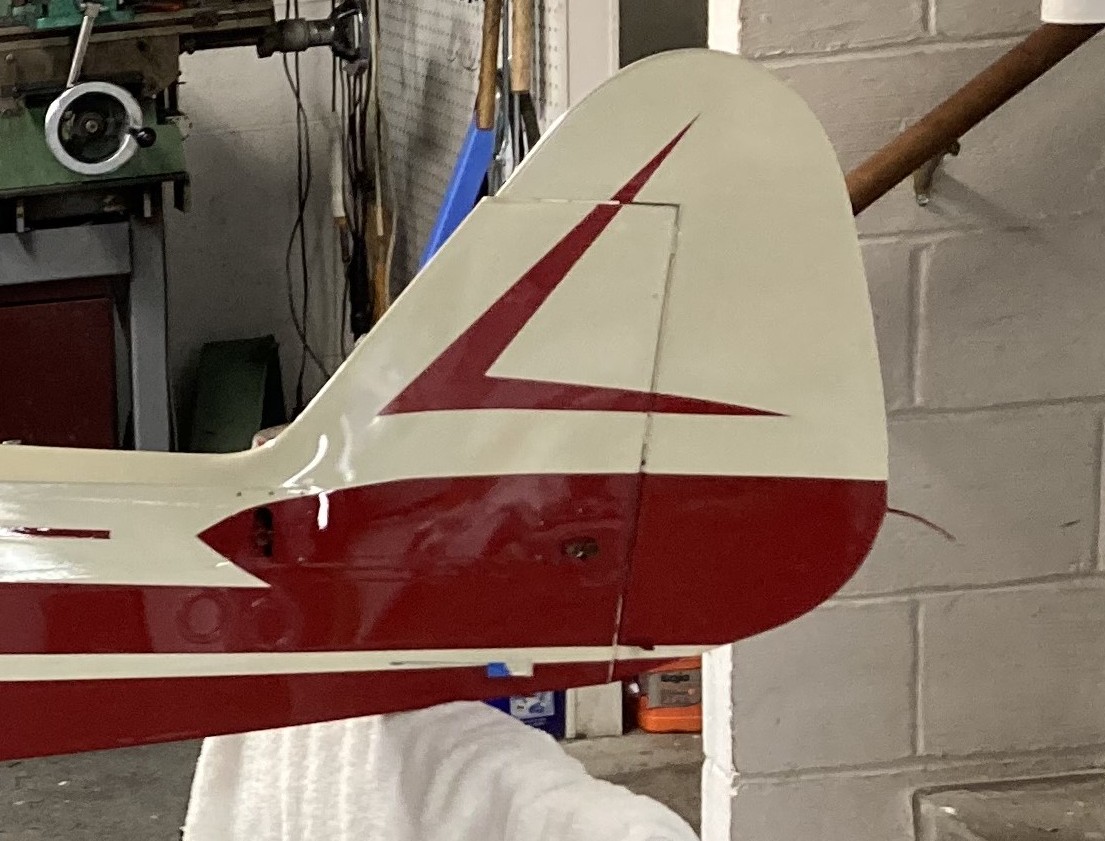

Very interesting! I’ve seen several envelopes sewn for full scale but I noticed something interesting on the drawing posted on the other thread.
I’ve taken a screenshot of that drawing and attached here. Seems that one side of the fabric is wrapped around the center stinger and the other side is glued to it, then covered with a tape.
I'm leaning to this approach..

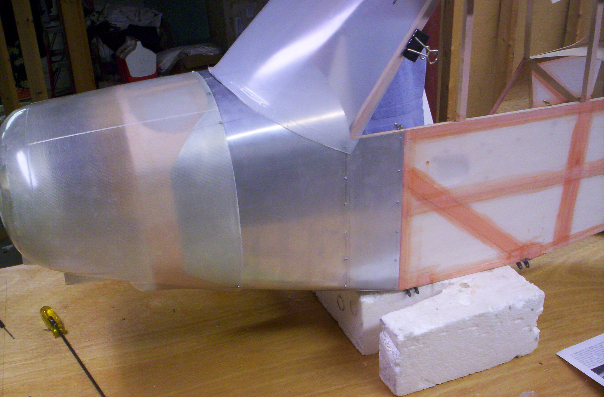

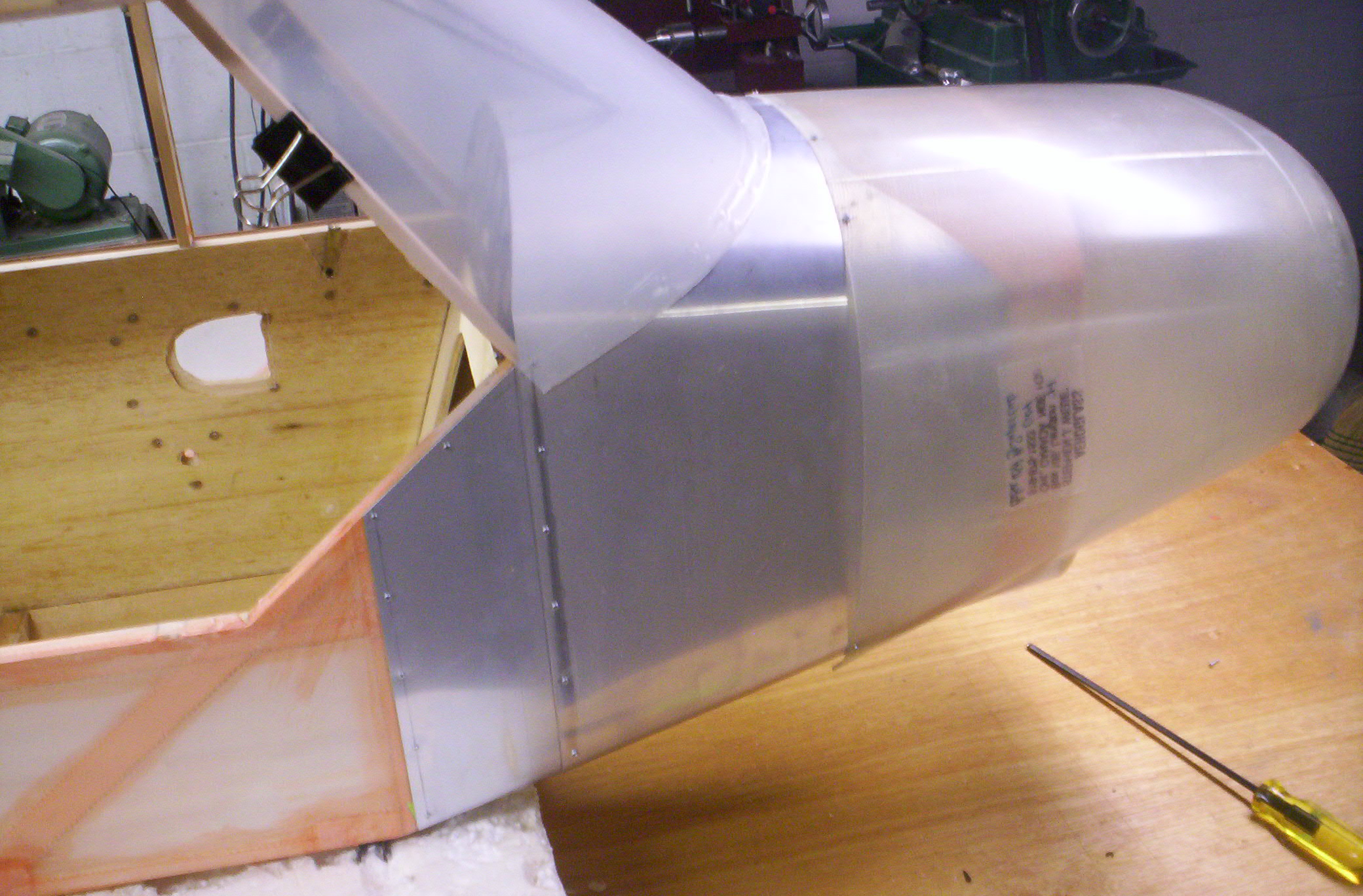

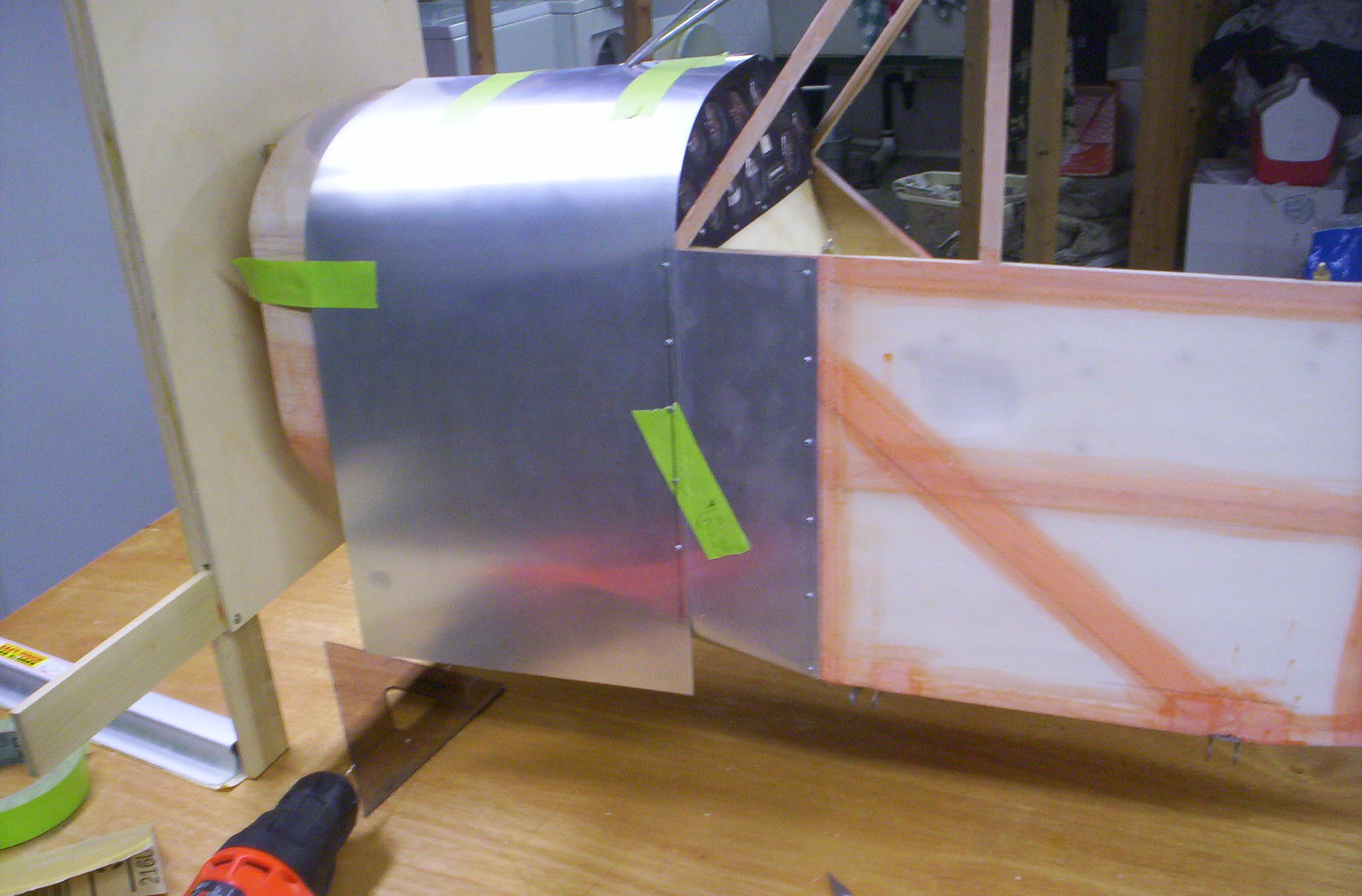

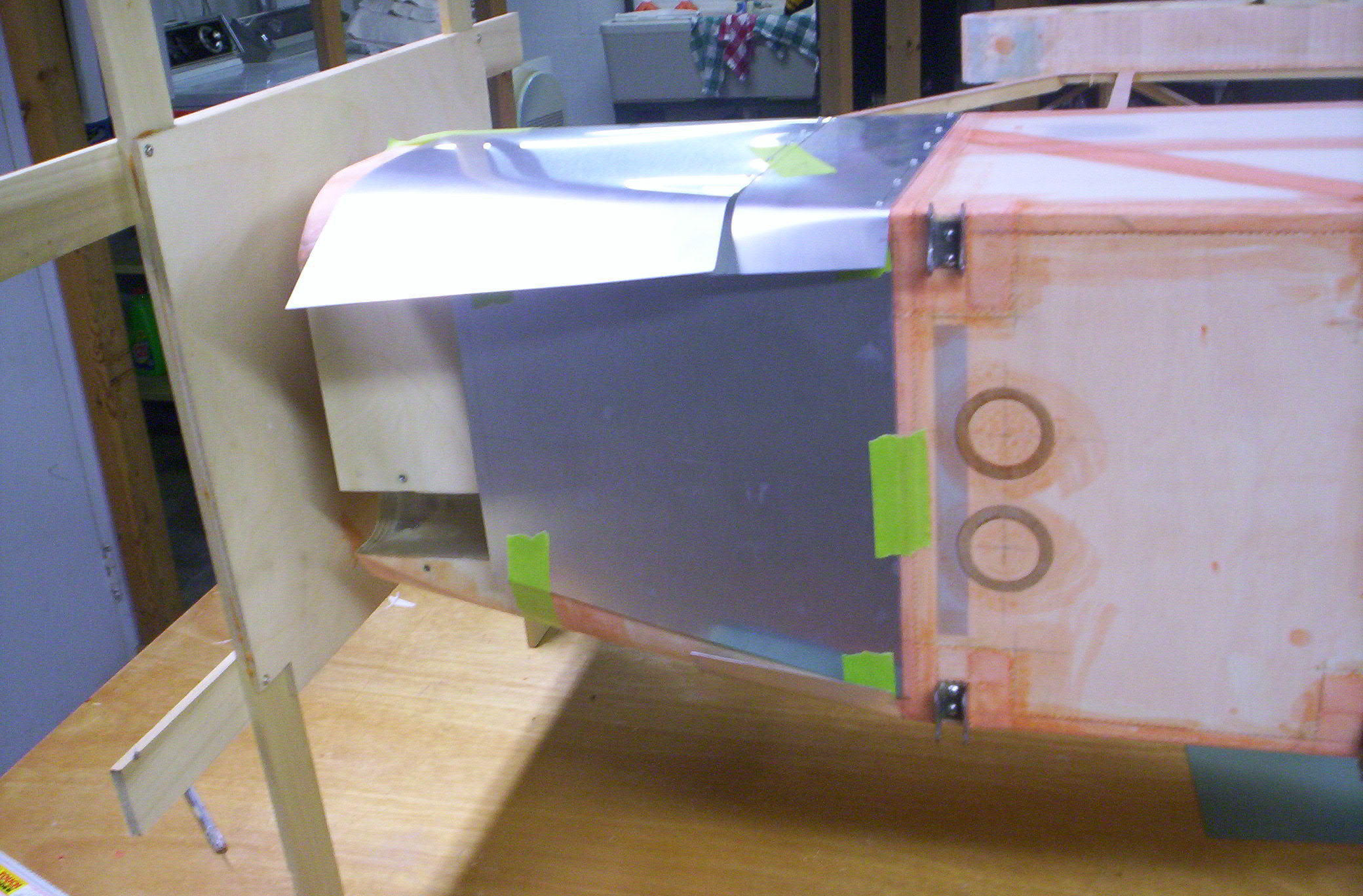

Looking at photos of Cubs, they don't appear to have the additional aluminum panel bethid the boot cowl. Doubled sided carpet tape is used to hold panels in place as the screws are only going into balsa.

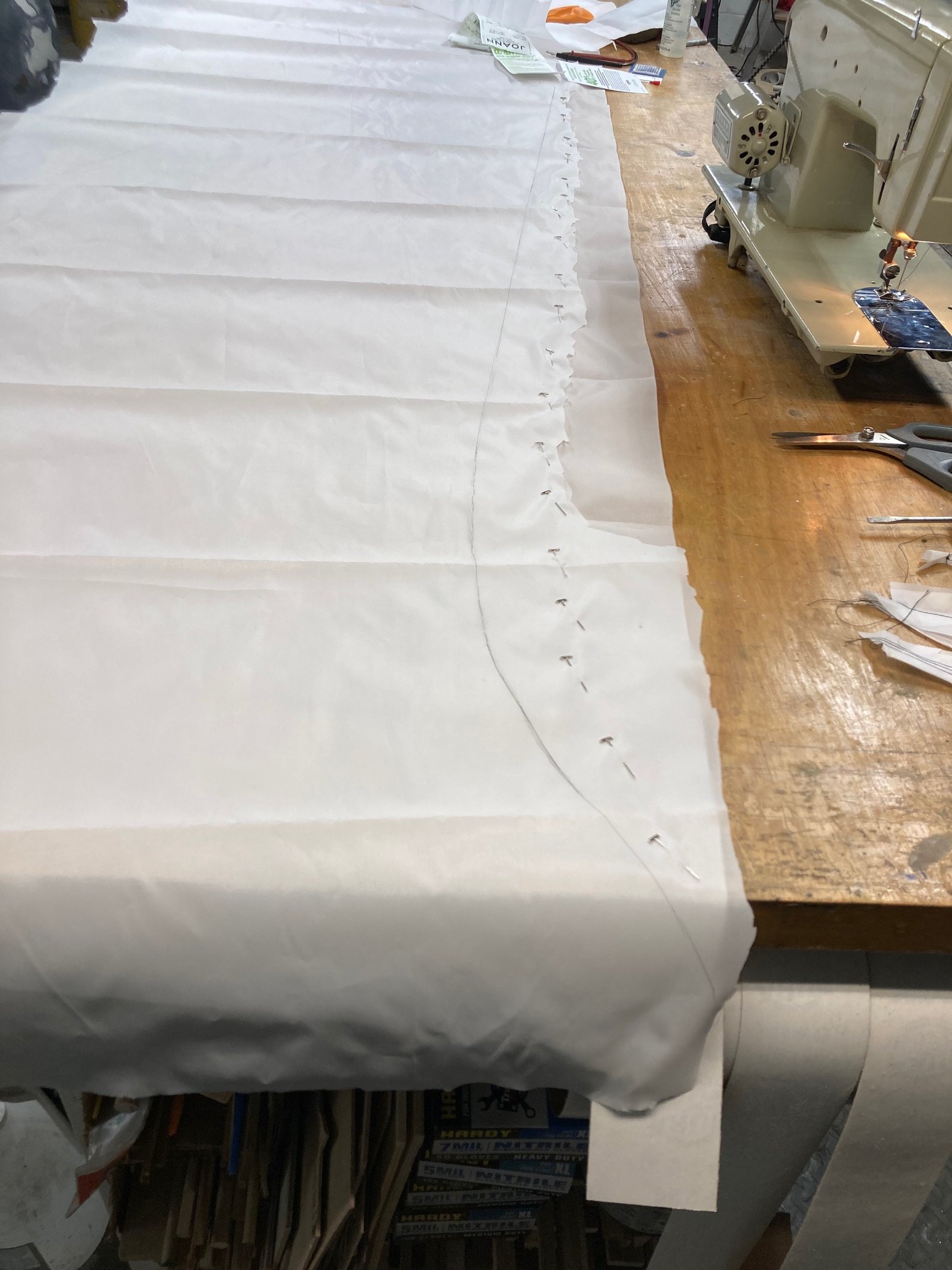

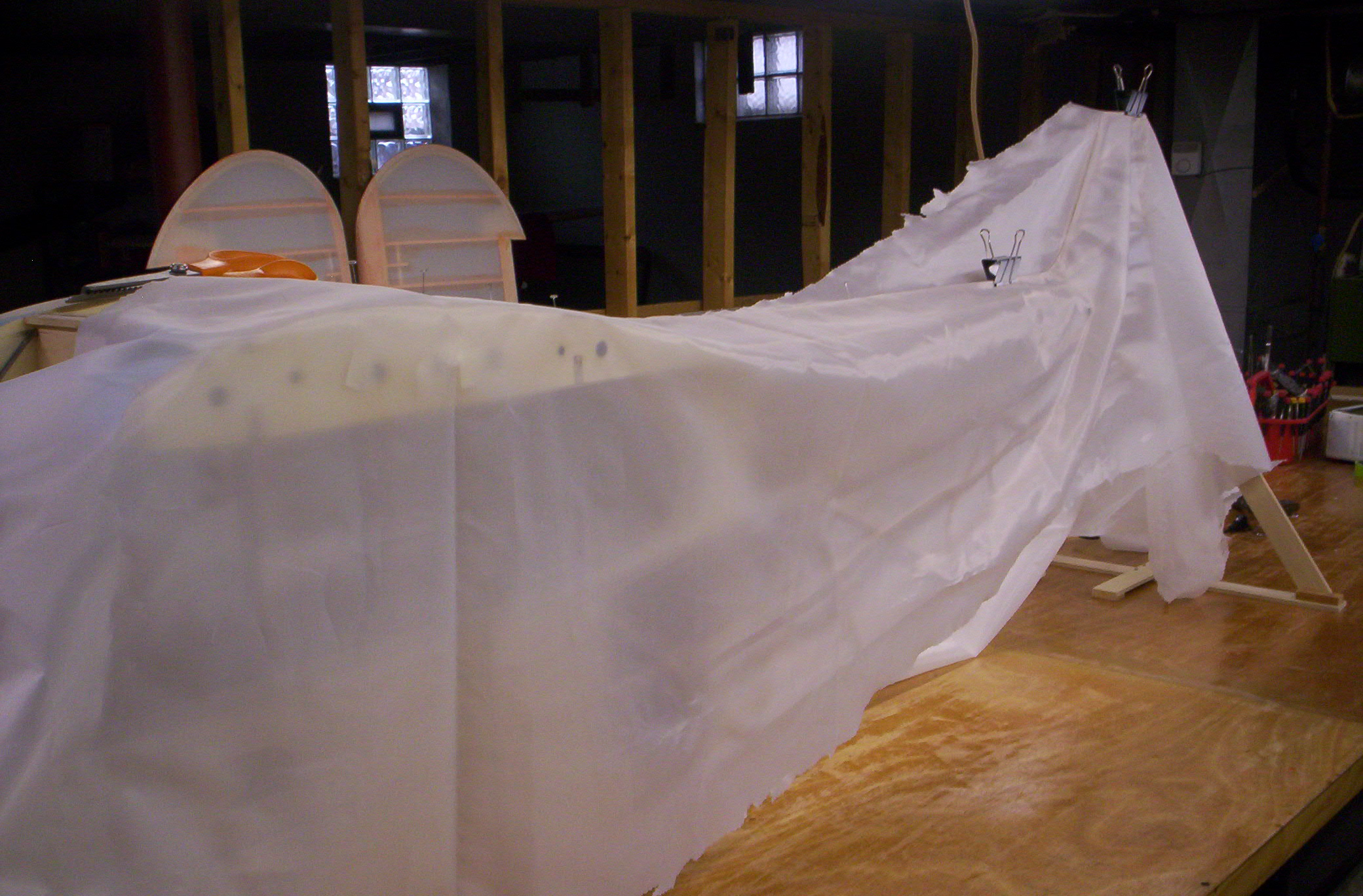

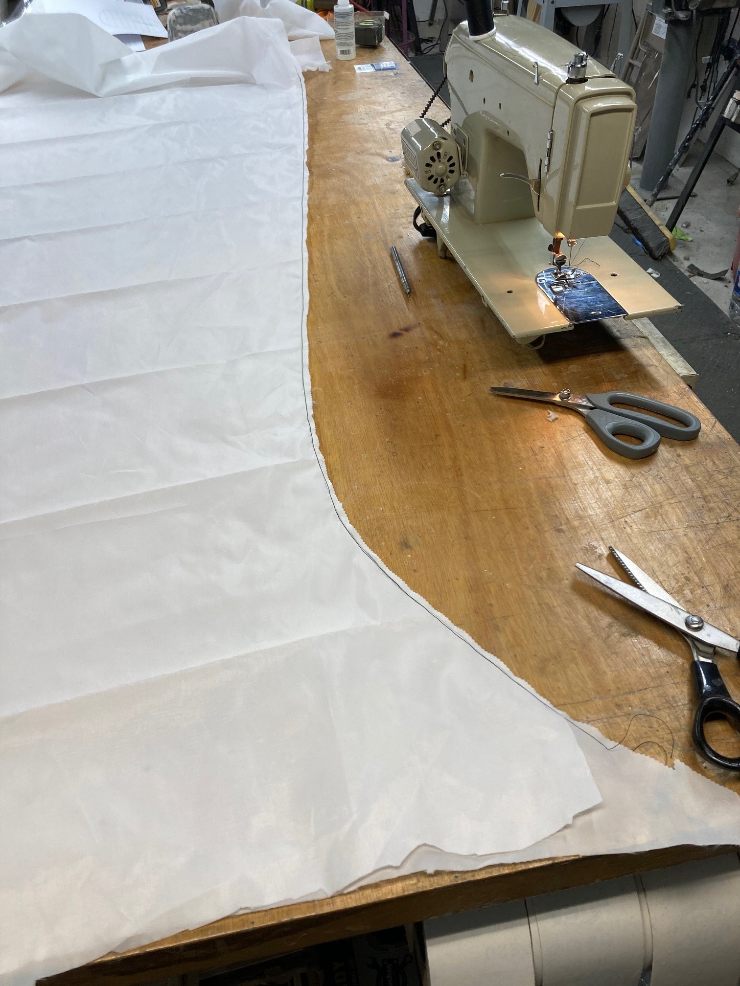

I had previously covered the bottom of the fuselage so it is time for the envelope. A large piece of fabric is draped over the fuselage and pinned in place to mark the center stringer with a pencil. This is pinned to a another piece of similar sized fabric and sewed together on the line. Excess fabric is trimmed and then turned inside out finally fitted to the fuselage. The fabric is first glued to the center stringer and fin, then glued around the perimeter finally shrunk providing a very pleasing curvature at the fin.
I did make one prototype, on the first seam I didn't notice the bottom fabric had folded over and was sewn in three places, I able the salvage the top fabric but the bottom one got a little cut in it so it was replace.
View attachment 121764View attachment 121765View attachment 121766
Going to visit my mom next weekend. It just occurred to me that it would be a GREAT time to use her sewing machine skills……. I need to get a move on this idea……
