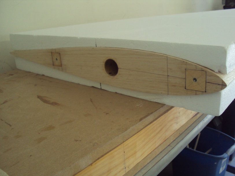

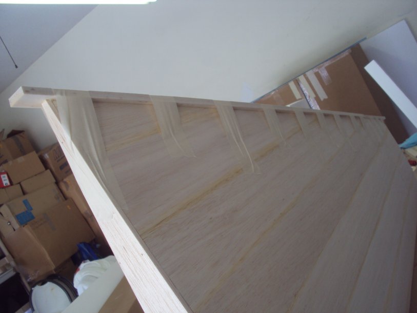

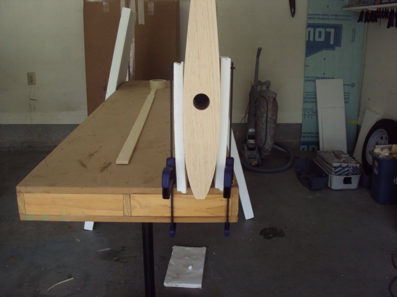

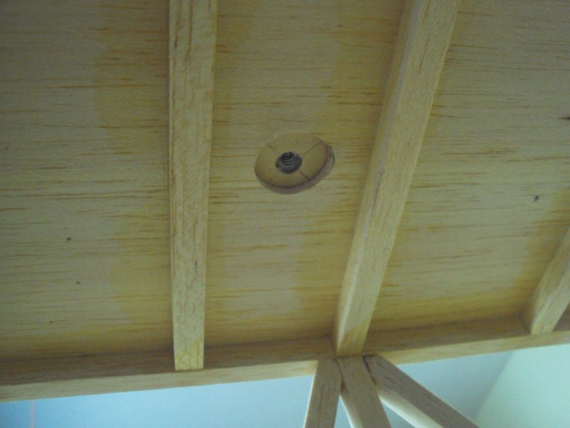

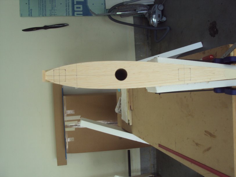

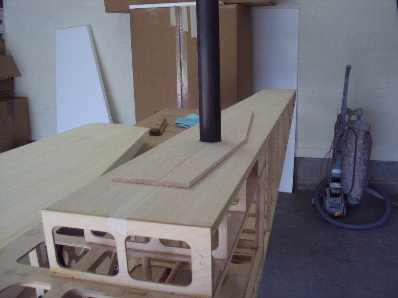

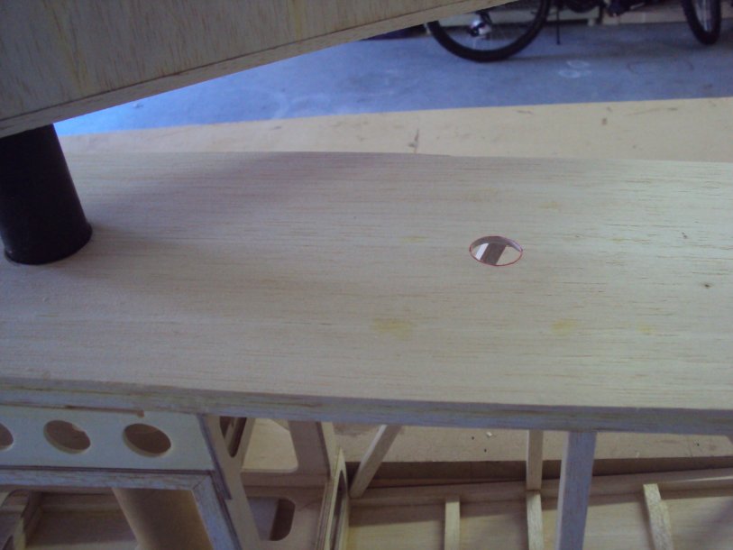

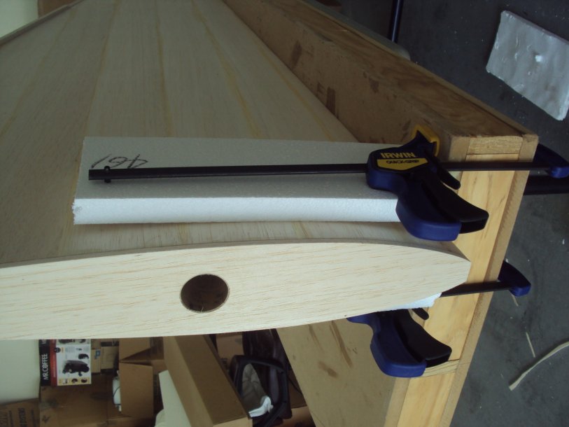

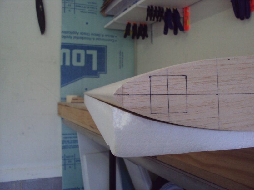

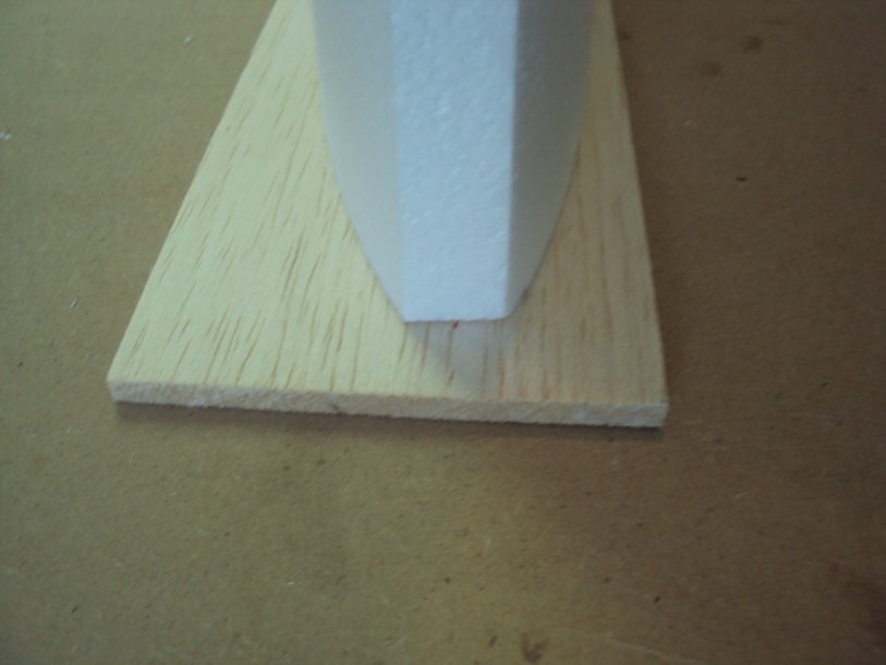

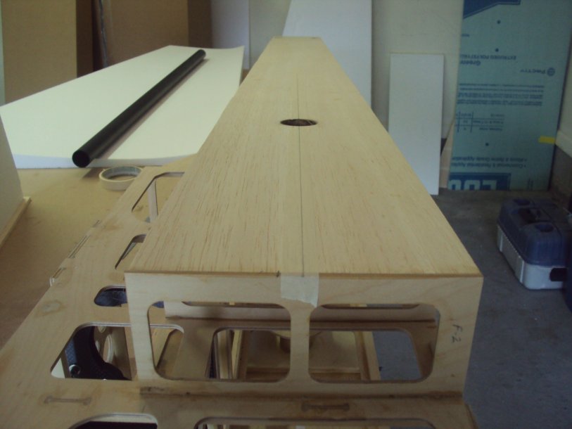

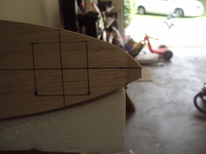

So I have both wings done now, I drew two lines, one on the fuse and one on the main wing root, this was just to give me a reference point so I could line up the wing. I decided to install the wing hard points after gluing the root cap on so that I could find perfect centering between the vertical fuse trusses. After gluing and trimming the root cap I glued on the LE and TE. Later on I will be drilling two 1/8 holes thru the 3/8th wing root hard point and pin in it to the foam with gorilla glue and a 1/8th inch dowel.
Now I’m ready to set the incidence, to me this is the most nerve racking part of the whole build.

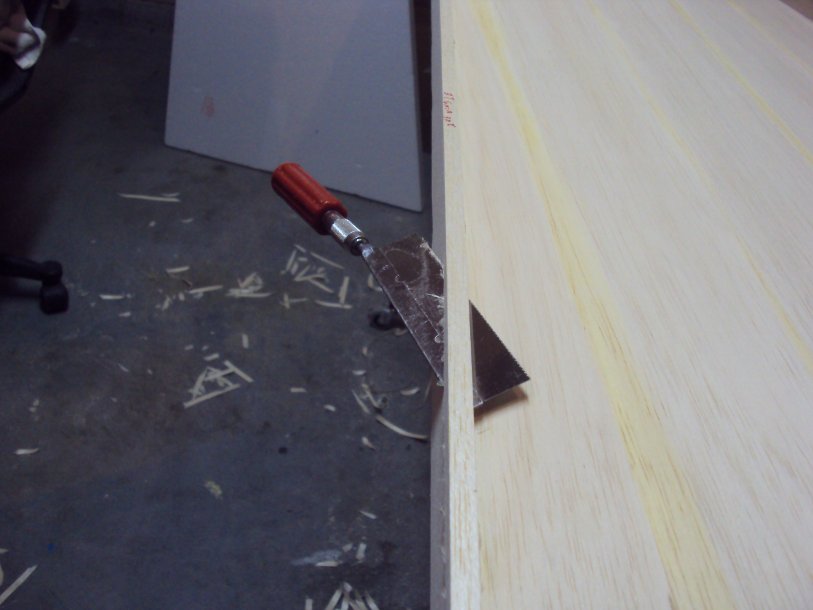

Terryscustom

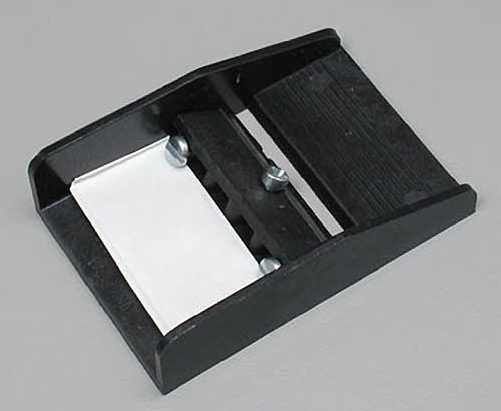

next time you are shaping your leading or trailing edges and need to cut down the material fast try one of the master airscrew razor planes, they work awesome and save you a ton of hassle.
:yesss: What I do is put masking tap on top of the sheeting to make sure it is clearly visible if you start to get close, and also somewhat prevents from digging in. Plane it down close and finish shaping with a 12" block with 80 grit paper on it sanding flush down to the masking tape (sandpaper with scratch the masking tape but not remove it). Remove tape, couple passes with a more fine grit paper and done.
Nice looking build @ROLLERMAN :way_to_go:
ROLLERMAN
Thats excatly what I do, I didn't take pictures of that set up. I do have a razor planer, but is not as wide as the one Kevin posted, I'll be getting one.
