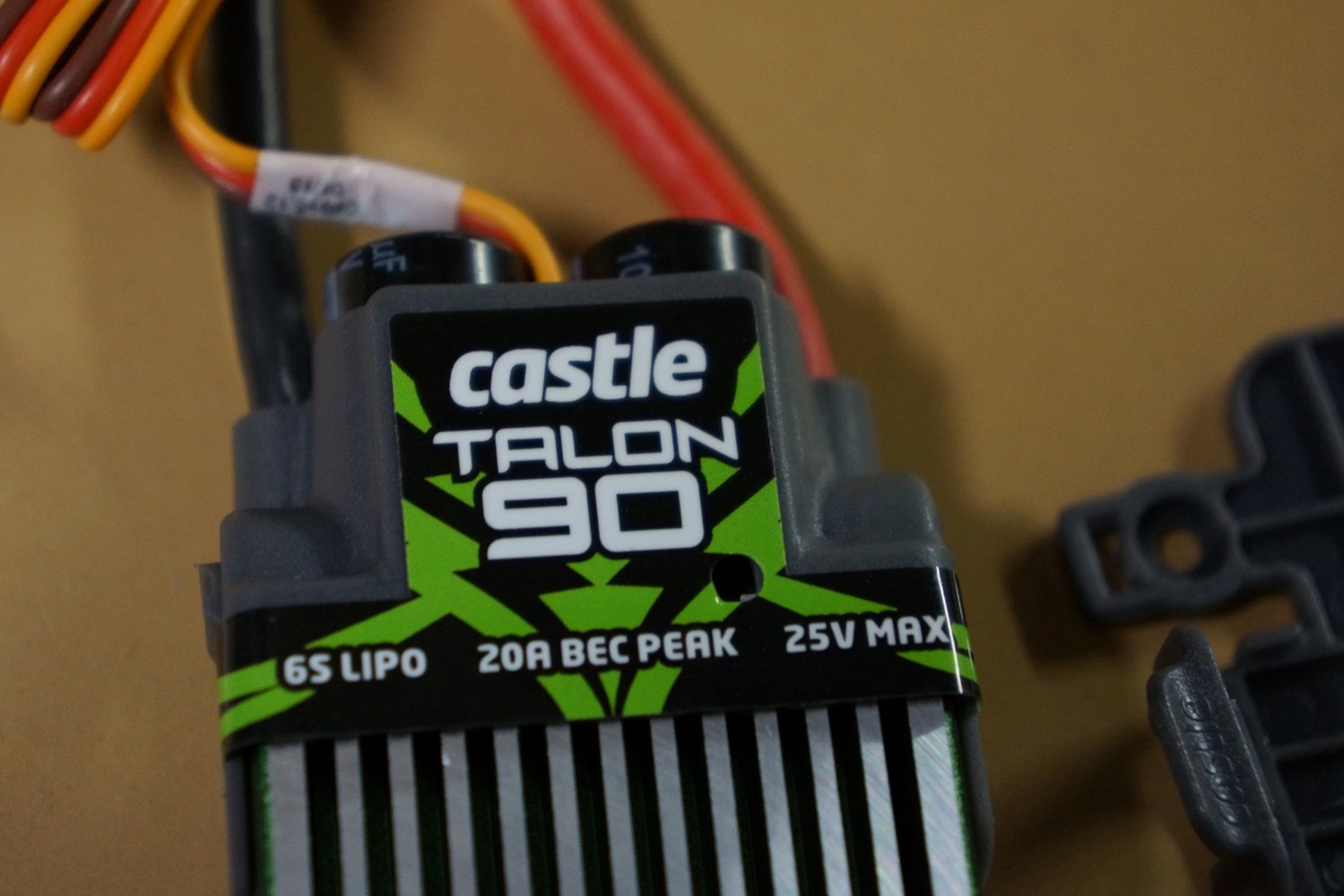

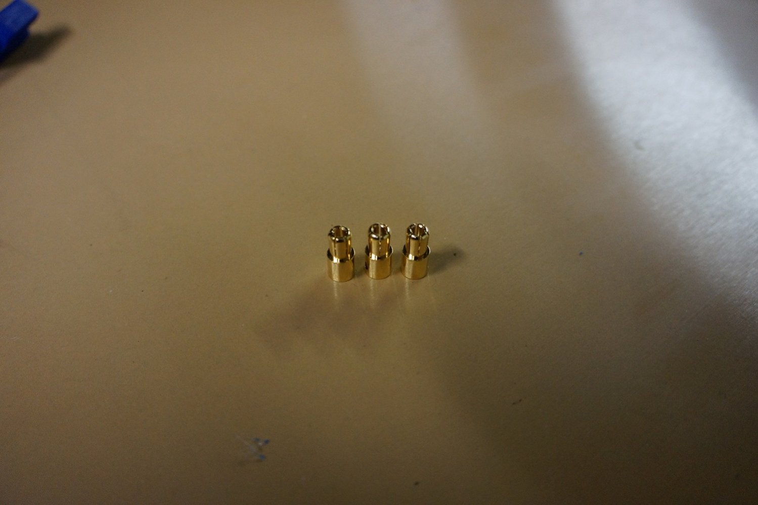

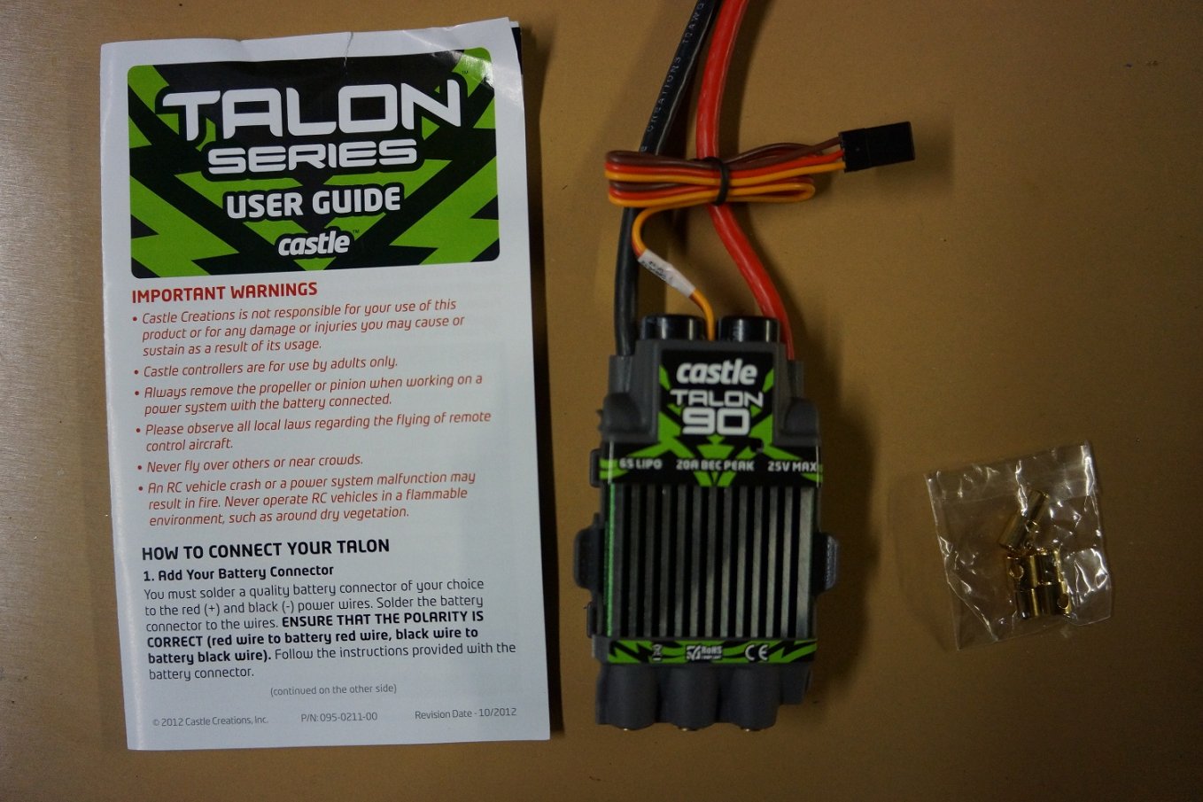

The ESC comes in a very nice, sleek box. Included is the ESC, ESC mount, instruction manual, and male connectors for your choice of motor (for me it will be the Scorpion 4020-1350kv).

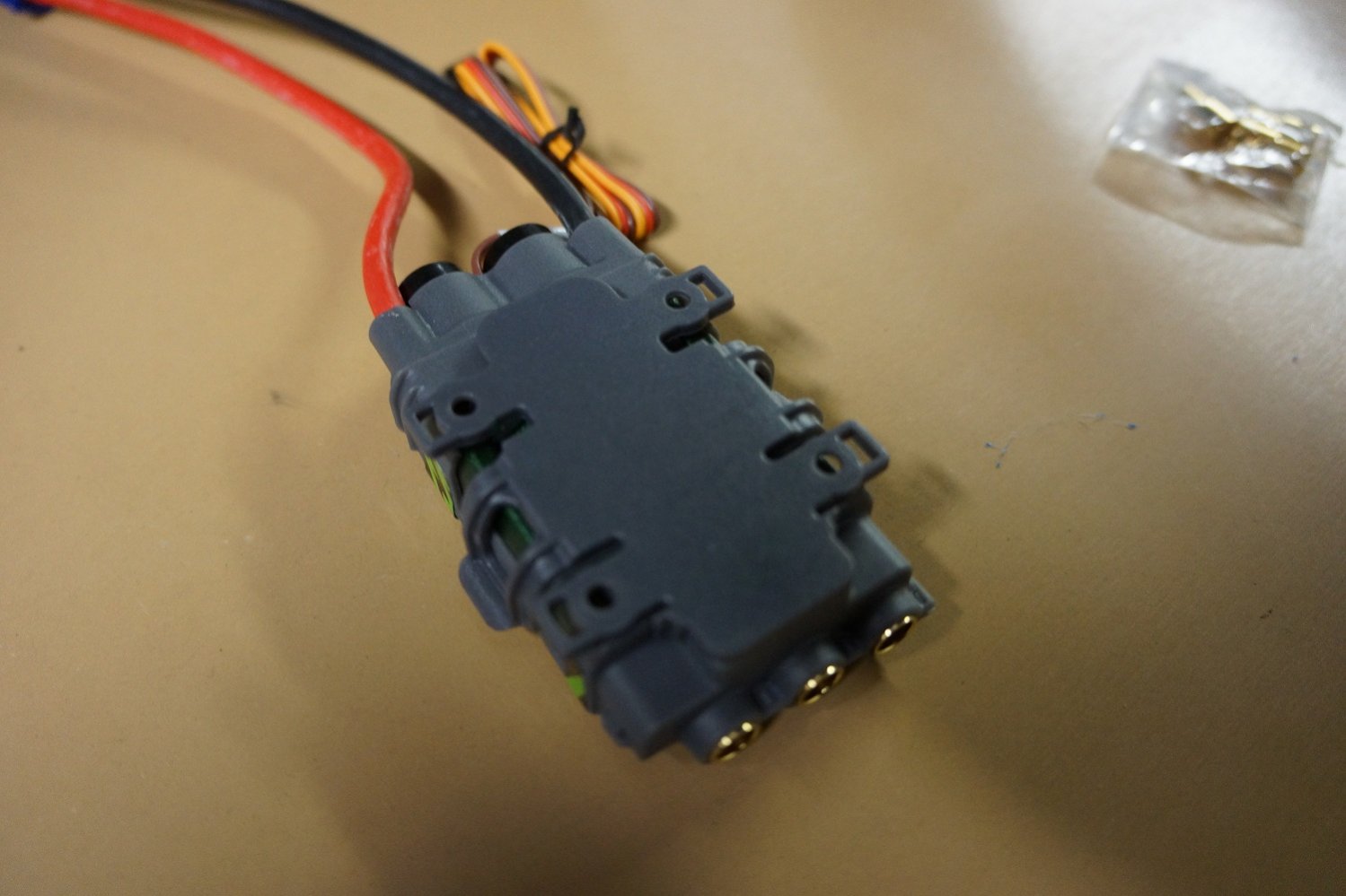

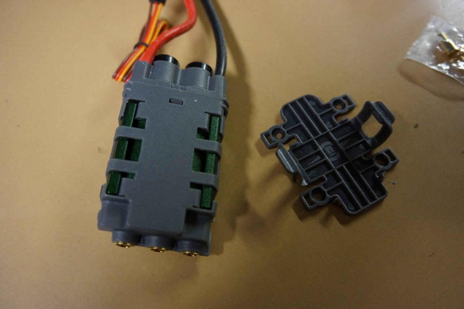

The ESC comes in a plastic shell to protect the cooling fins and other components from getting damaged in the event of a crash, the other nice feature of this ESC is the fact that it comes with a mountable bracket that you can mount on the side of your helicopter or inside your airplane and then simply snap the ESC in place. Very useful if you ever need to remove your ESC for maintainance.
The programmabilty that comes with the Talon is also very useful. Using the Castle Link adapter you can program your ESC (BEC 6v to 8v, startup, RPM governor mode, brake, and lots more). The software that Castle uses is very user friendly and the ESC can be easily programed to many different settings. There is also a data log function which lets you view amperage outputs, as well as the RPM of the motor through various points during the flight (I plan to use this later when testing the Goblin 500).

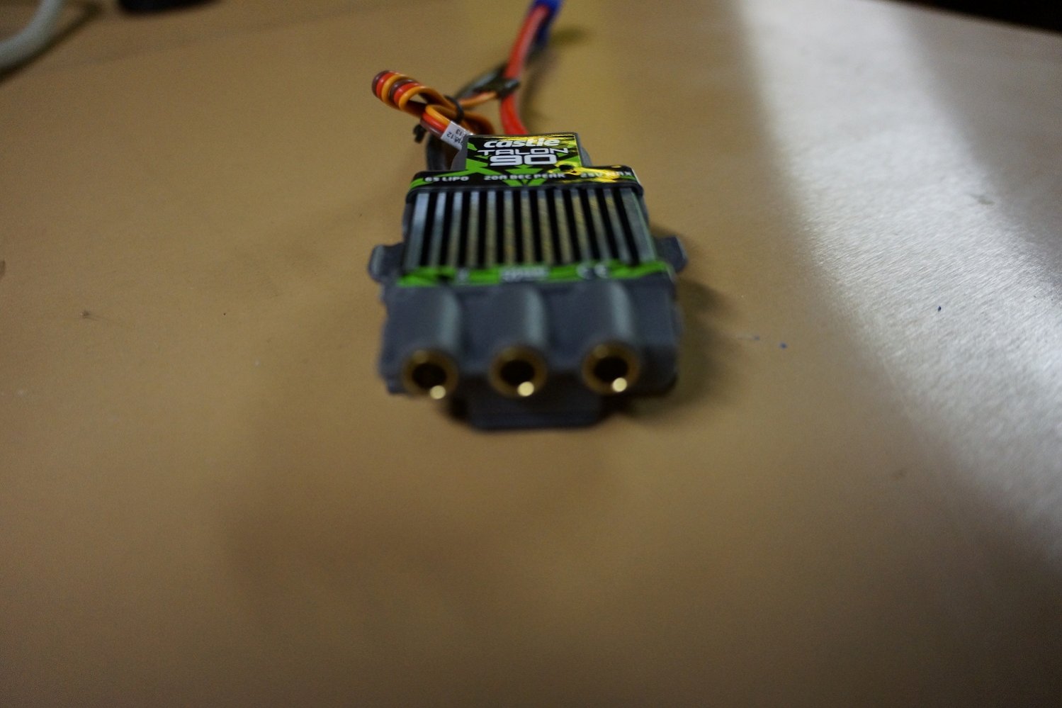

Another really cool feature I have not seen in many ESCs before is the integrated female connectors IN the ESC. You simply plug the motor wires directly into the ESC itself, which limits the amount of wires on any aircraft.
Overall for the price, quality, and function of this ESC makes it a great option for high powered 3D airplane or helicopter setups. The huge 9amp BEC with 20amp max is a nice addition to the already popular Castle ESC.

The only feature that I dislike about this product is the fact that you have to "mail in" for the Castle Link system which is basically a female servo connector to a mini usb port. Castle could've easily integrated a mini usb into the ESC itself for fast and easy programming. Other than that this looks like a fantastic ESC and at a reasonable price.

Thanks for the review so far. I am personally interested to find out if having the female bullets built into the ESC is a good or a bad thing. I always heat shrink my bullets together for added security but you clearly cannot do that with the Talon. Are you going to be using it in a plane or a heli Anthony? I personally would like to see it in a plane. Good luck with your flights.
The bullet connectors that come with the Esc are a little different than the average ones. They fit super tight, if a wire comes out of the esc, you might have some bigger issues :)
