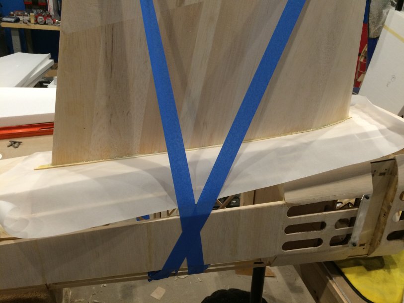

this is what i did.... i measured the distance from the wing tube to the 4 holes on the side of one wing where the respective wing studs and dowels will go. two in front of the wing tube and 2 aft to the wing tube. these points were then cored out in the root of the wing to accommodate a round dowel, approximately 1 inch in diameter and 1.5" long. then, they were buried 1/4'" in from the inner most edge of the wing root, and then a 1/4" thick plywood block was cut to fit this area. these were all glued in with Elmers Poly U glue. then sanded down.

yep, i did that on the right wing, so there was minimal amount of cured glue.  on the left wing, the 1st one i did, my wife was calling me so i had to leave wing unattended.  She is having a party tomorrow.  SO she is a bit anxious.  in any event, this is what the left wing looks like after i sanded it down.  i did not take a picture, but i did fill in the small gaps between the root cap and the wing with balsa-lite filler.
here is once i placed the right wing on the fuselage, and covered it with waxed paper. then i applied the glue between the cap and the root of the wing.
