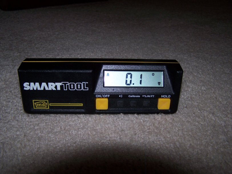

Actually I just did this and it wasn't so bad... I have 2 Robart incidence meters so I used one on the wing and one to help ID the second (unmarked) rod for the horizontal stab....the Robart incidence meter is marked to 1/2 degrees...so I just shot for in between 0 and +1/2...can't comment on my actual accuracy but it looks good :way_to_go:
You ready that correctly...and I got a bit of a laugh out of that myself...I think you eyeball it to be a little off Zero and call it a day!
For info..... If you use a digital meter and place it on top of the incidence bar...you can actually set incidence in 1/10th decree increments. Originally, I set my wings for 1/10th degree positive...before moving them back to 0 degrees.
Wayne
