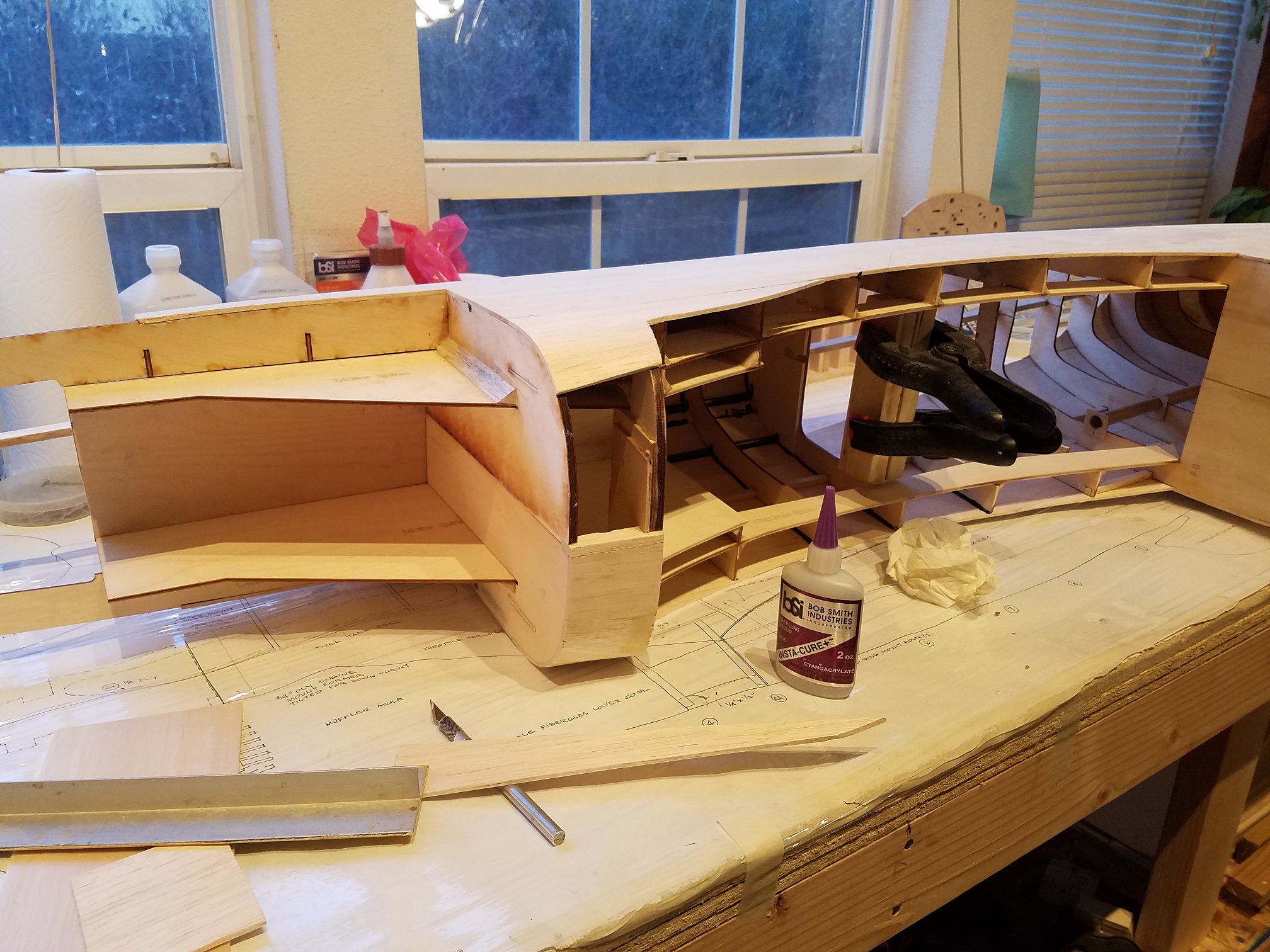

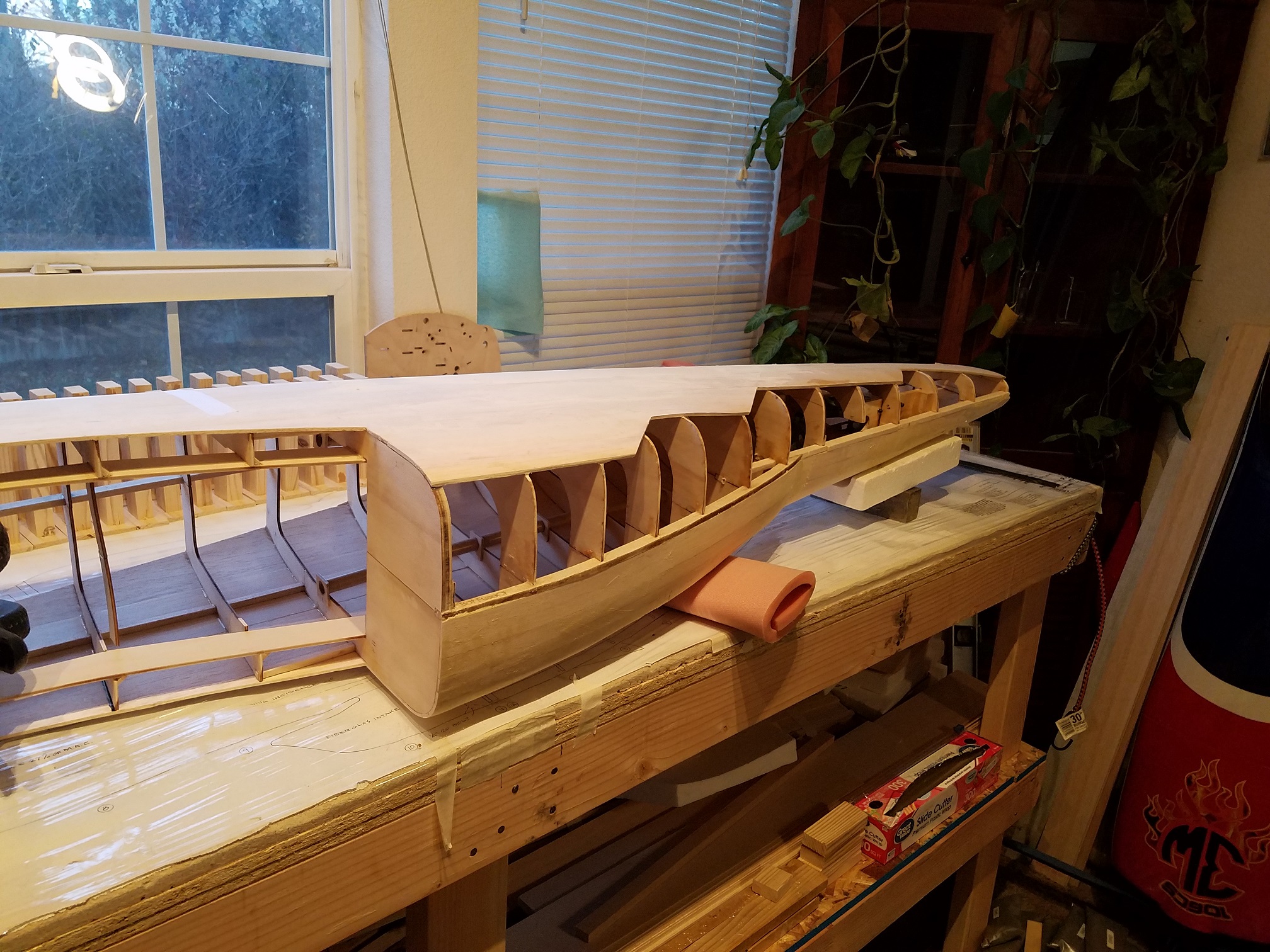

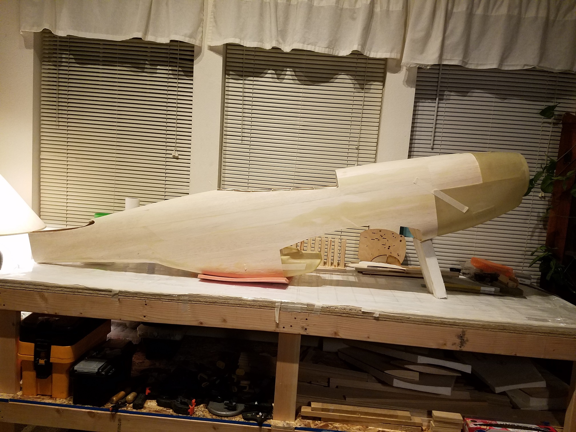

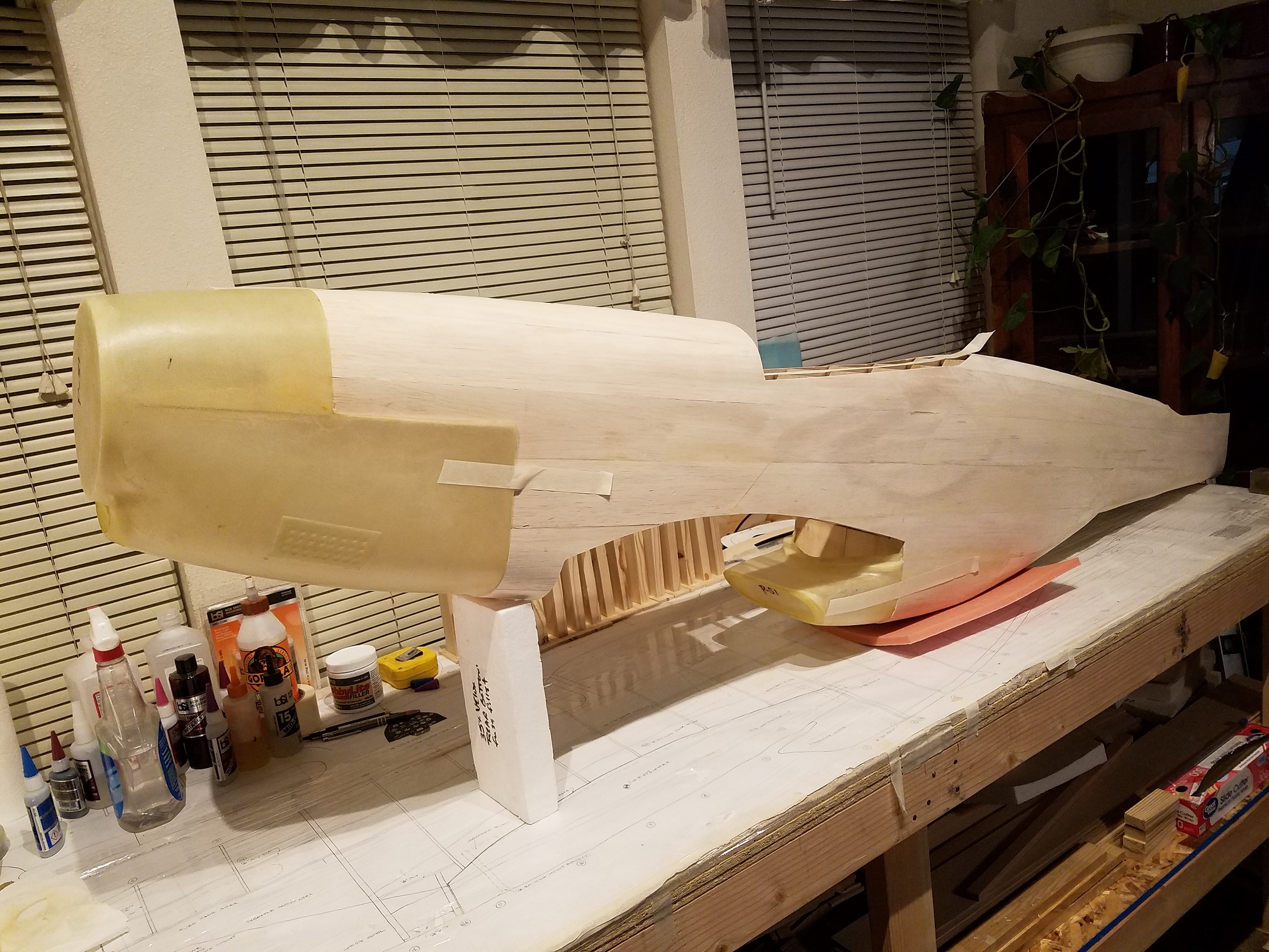

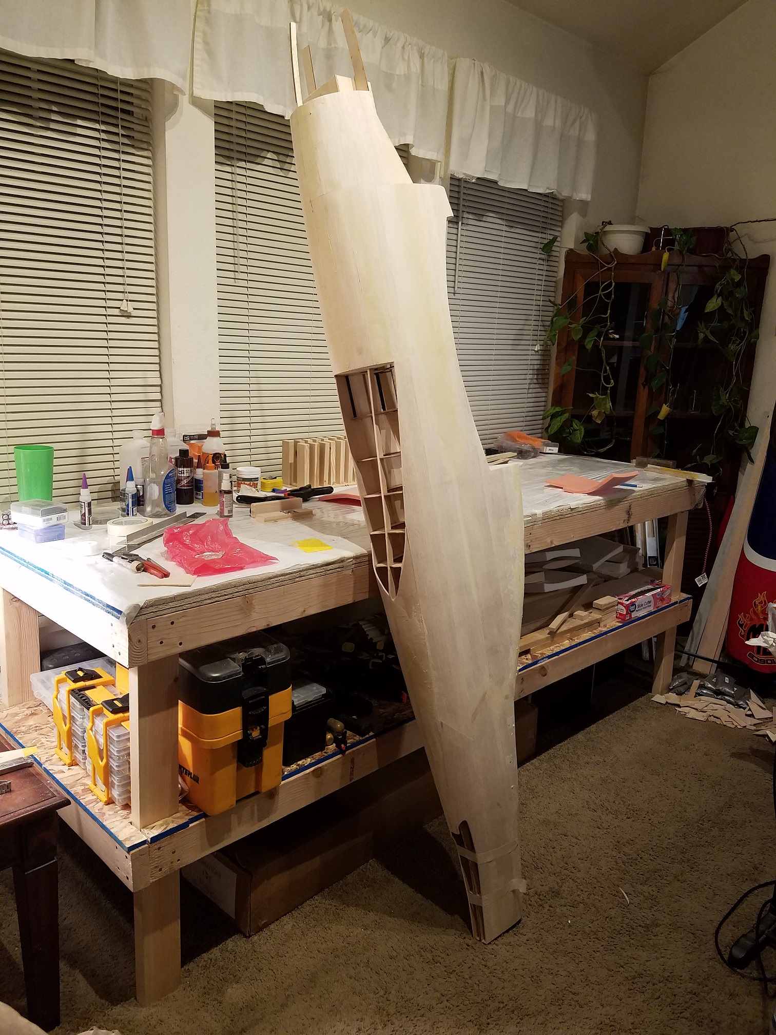

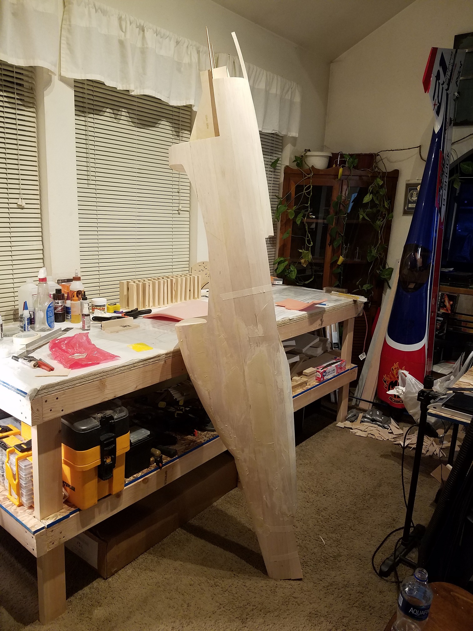

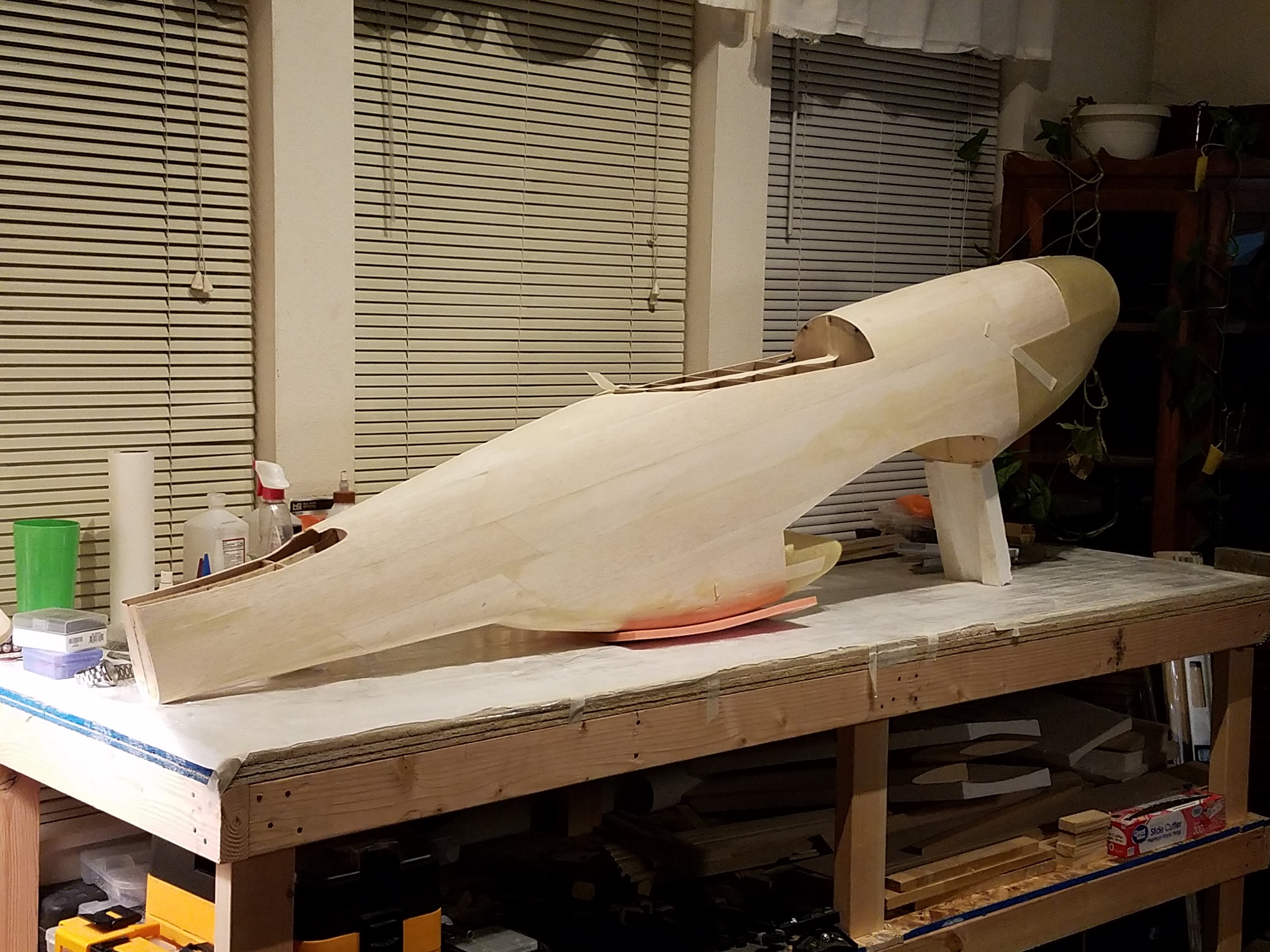

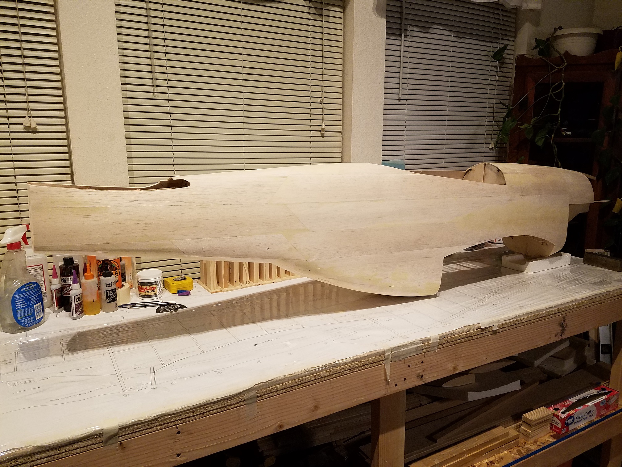

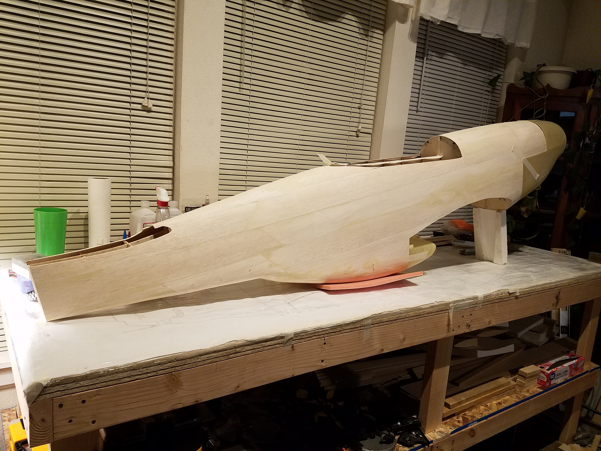

    I'll be putting the big DS Mustang off to the side for a while to work on the Velox. But I did take the opportunity last night to finish up the sheeting on the fuse. (I just could not take a break or stop until at least that much was done.) That was thankfully "after" I glued my fingers together. Oiy!! Tonight after getting things put away, I wanted to see what the big ole Kolm home was going to look at. What a new perspective. I guess I didn't really realize the full impact of the size. Dang this things is going to be fun. A few sneek peaks of the future Mustang.
    20181231_170518.jpg 20181231_170520.jpg 20181231_234748.jpg 20181231_234835.jpg 20181231_235302.jpg 20190101_182456.jpg 20190101_193853.jpg 20190101_194102.jpg 20190101_194124.jpg 20190101_194150.jpg

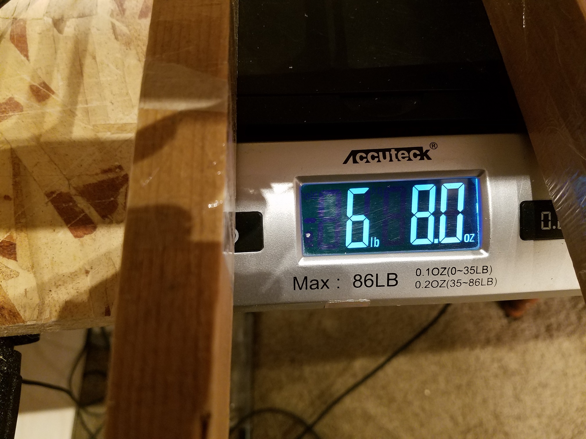

    I was shooting for 8 pounds on the fuse with all the major construction done. I would say I pretty much blew that number out of the water. I do realize there will be a slight change once I have the firewall installed, the wing saddles glued in....(they are 1/64" lite ply) and the canopy frame support glued in. Taking into consideration some sanding and shaping and slight revisions to the engine box, I am still pretty confident I can make that 8 pound goal. The built fuse is pretty darned strong too. So not too worried at this point.
    When I return to the Mustang, I am going to start the tail section. Stabs first, then fin and rudder. One of my friends here has a laser cutter and has done extensive designing of RC airplanes and actually works in the aircraft industry. He is going to help me lay out the stabs, laser cut lite ply stab ribs and help me line out the stab tube and anti-rotation pins so that the big Mustang will have removable stabs.
    Next step after that will be the main wing construction. I will need to order carbon fiber wing and stab tubes and sleeves. Somewhere in between this I will mount the Kolm 150. I will need to start laying out how everything is going to be installed and then the fun begins. Ordering electronics and such. ESC for the starter, servos, etc.
    There is quite a bit done, but oh so much more yet to go. I am really hoping and shooting for a 2019 maiden and possibly...hopefully, The Warbird event later this year. Guess we will see how it goes.
    Stayed tuned fellas. More yet to come.

    Really starting to look like a Mustang. It does look big when stand it up like that. And the sheeting looks really good nice work. Looks like there were a couple really difficult parts to sheet but most of the fuselage is done.

    Looking at the pictures again that air scoop on the mustang is a lot larger than I had envisioned it, with no wing and the rest of the stuff the air scoop is a big part on the plane. Is your going to be open and all nicely shaped as an air scoop.

    I am indeed going to open it up. I'm also going to design waste vents in the back of the scoop/keel. Basically my plan is to be able to draw the air from the engine through the fuselage via a air shuttle and have it dump out the back of the plane like the full-scale. It's going to take a lot of the engineering, but I think I can do it. The waste dumps will also be radio-controlled.
