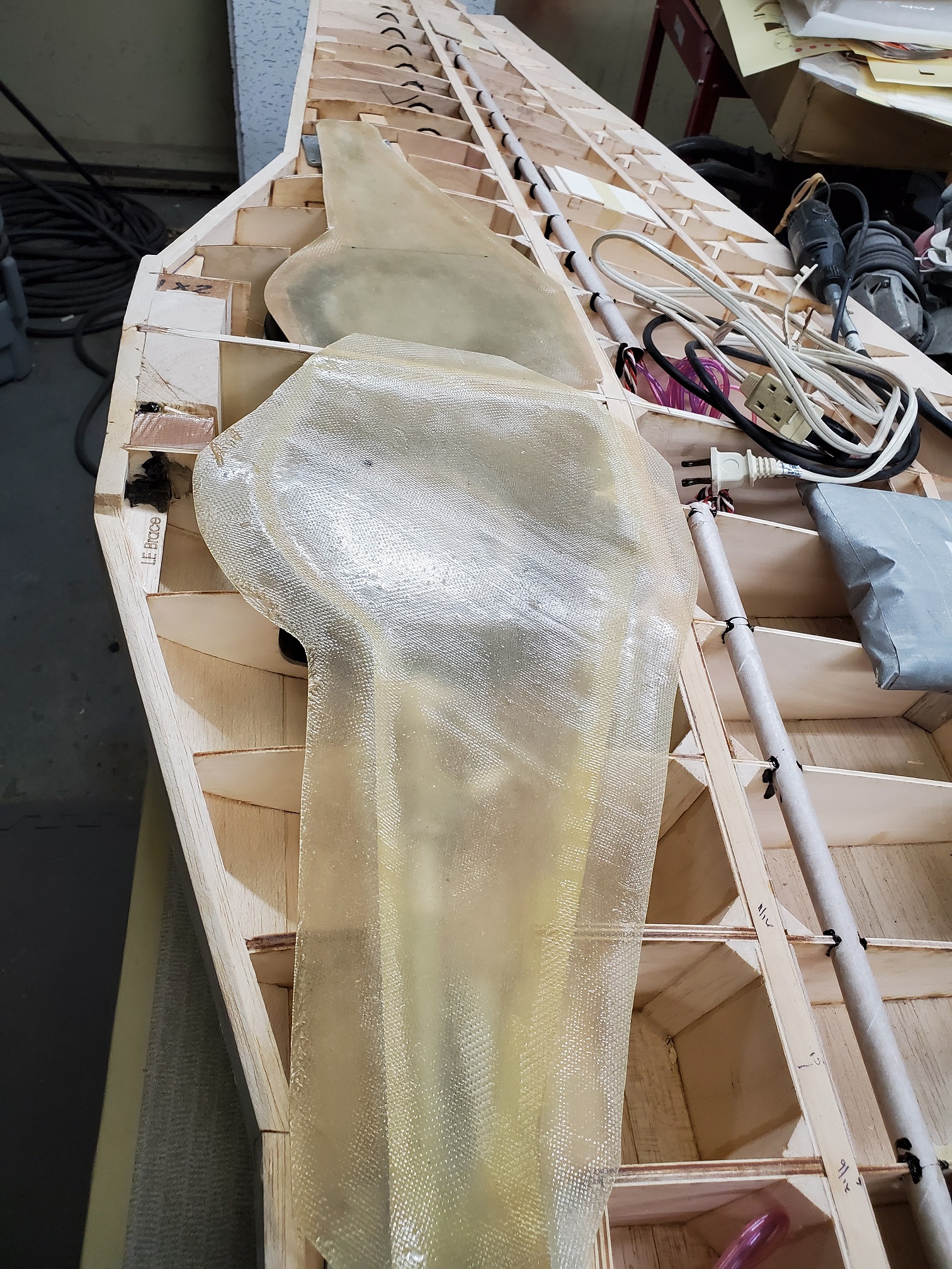

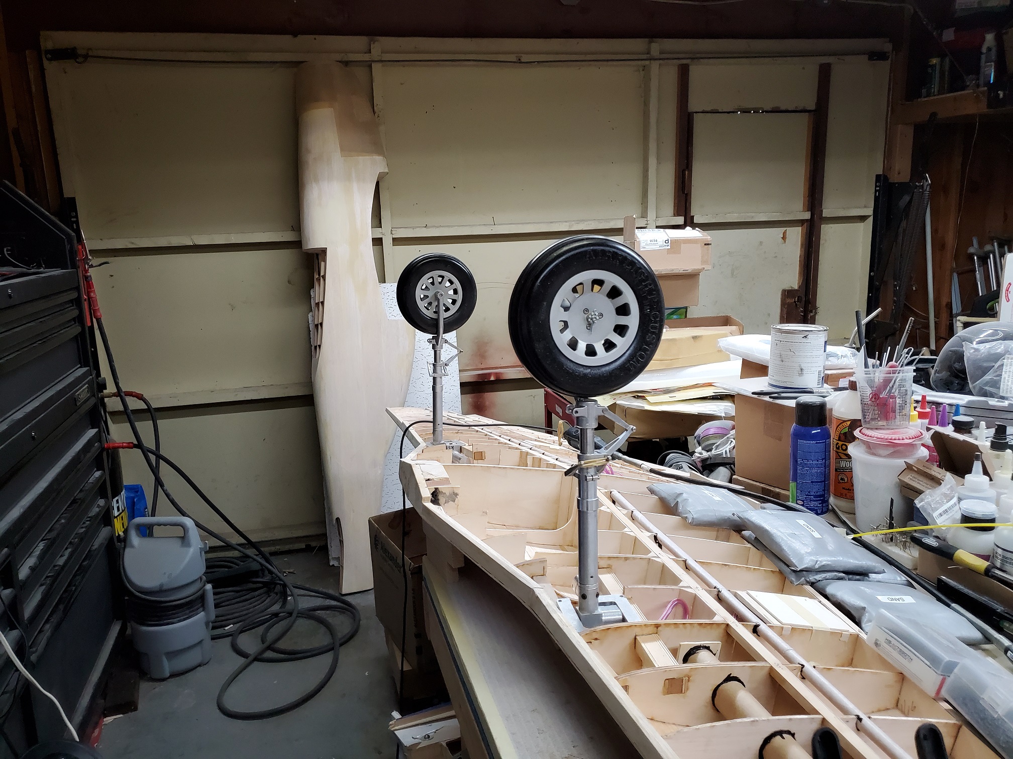

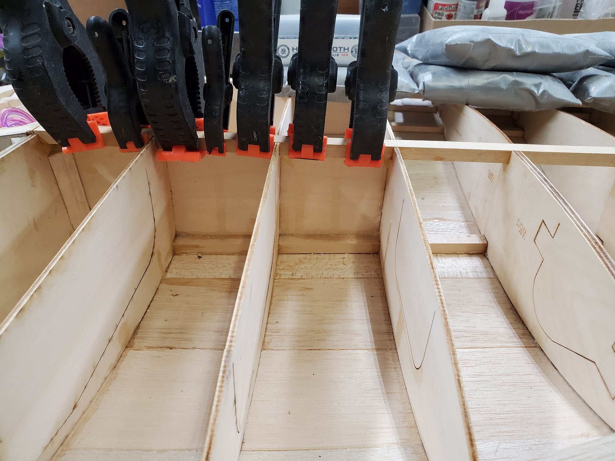

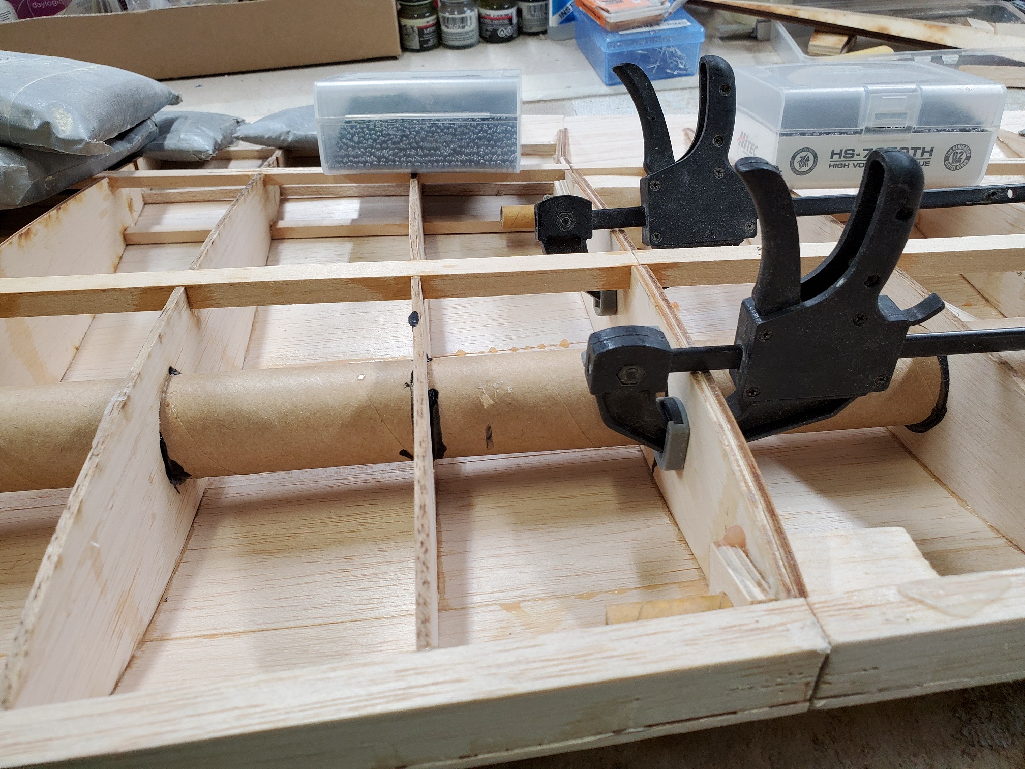

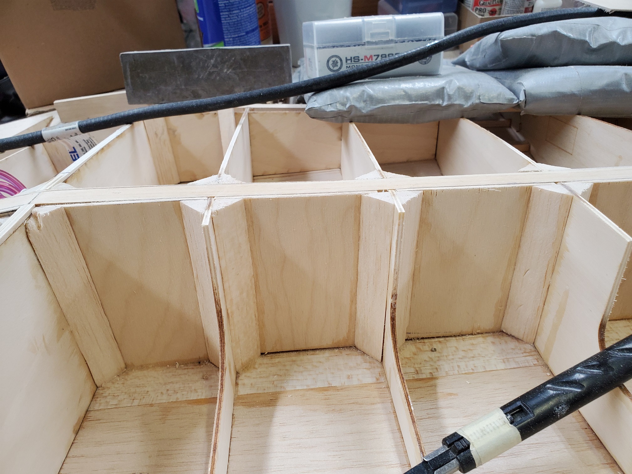

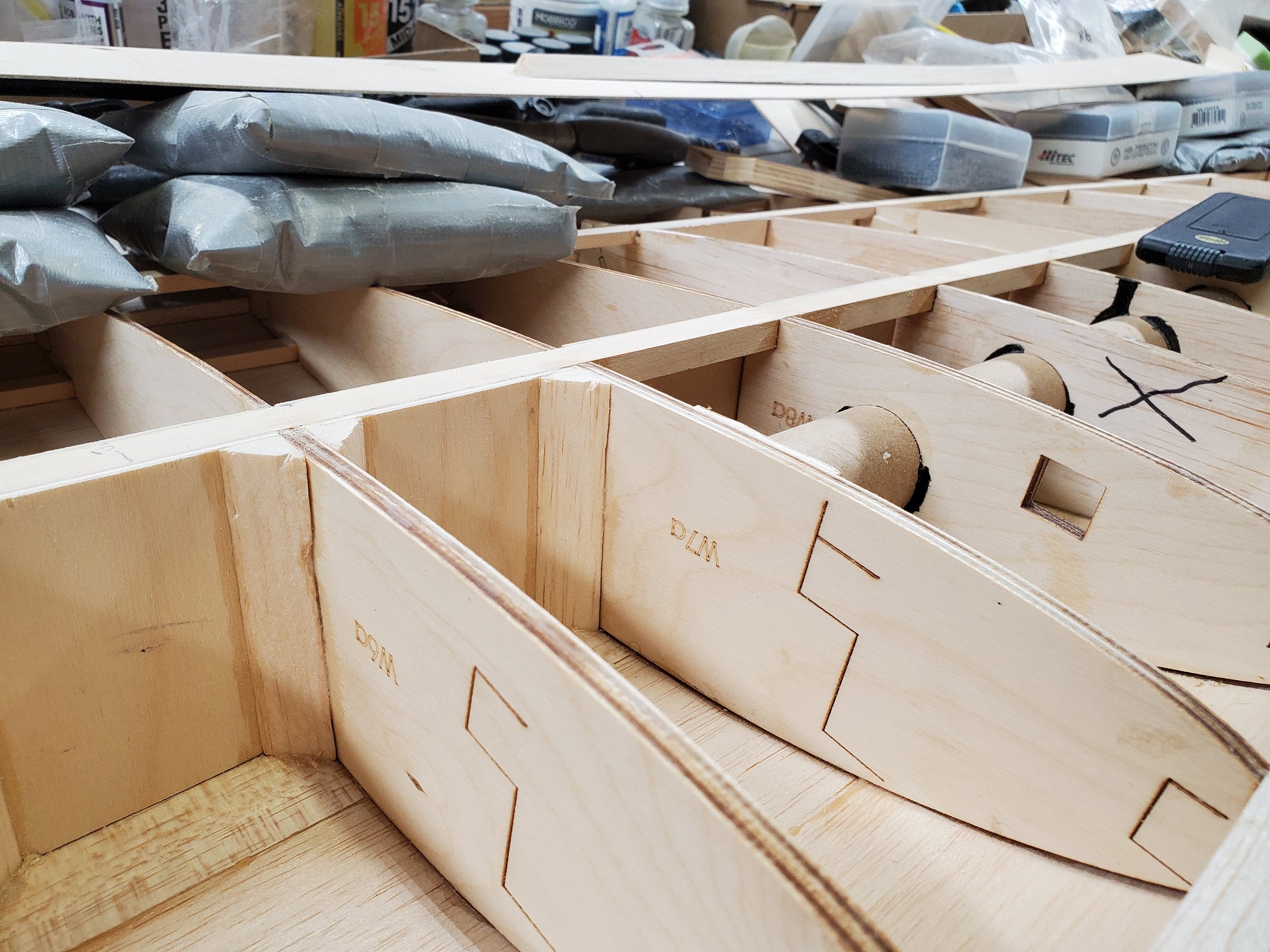

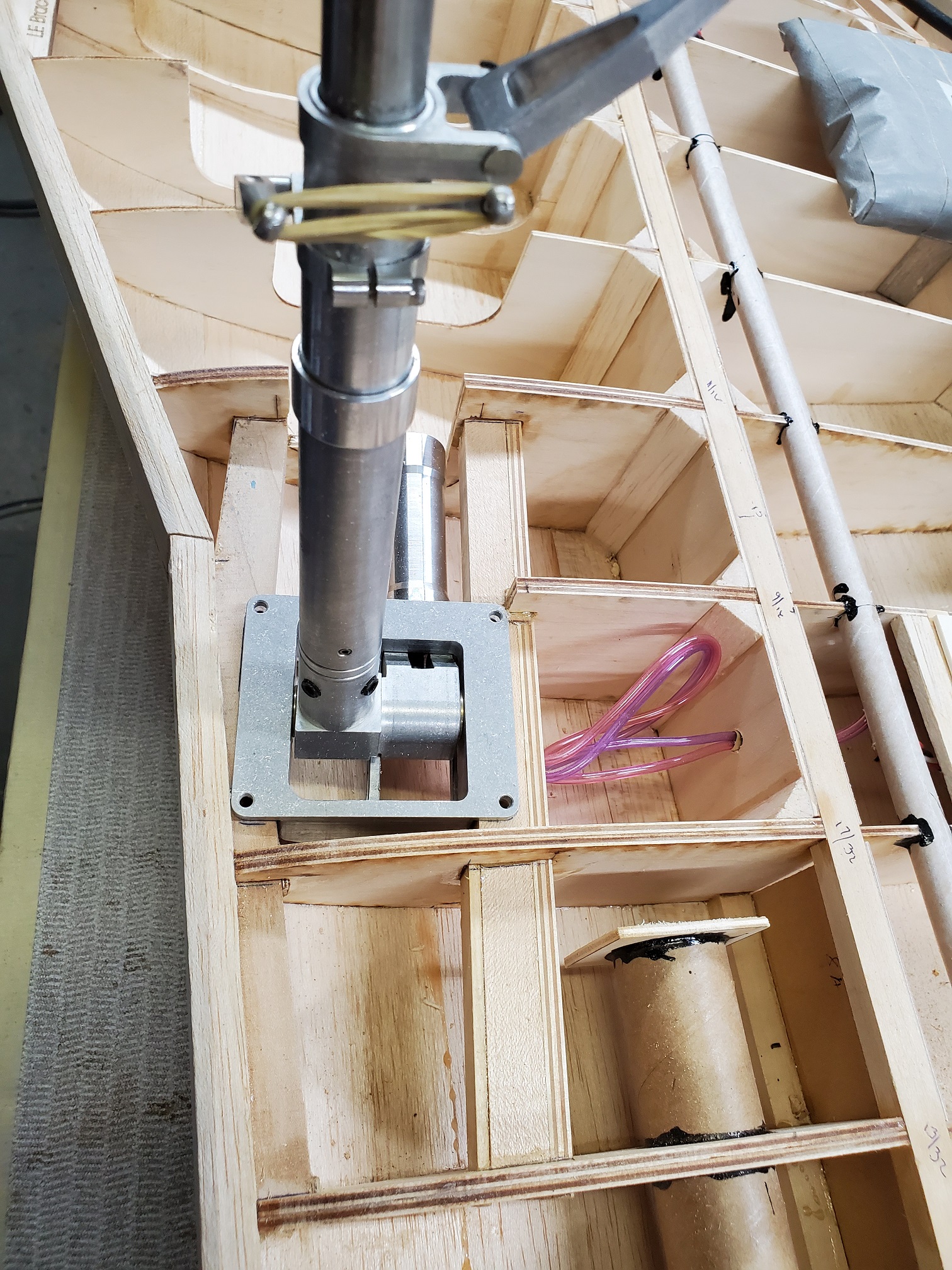

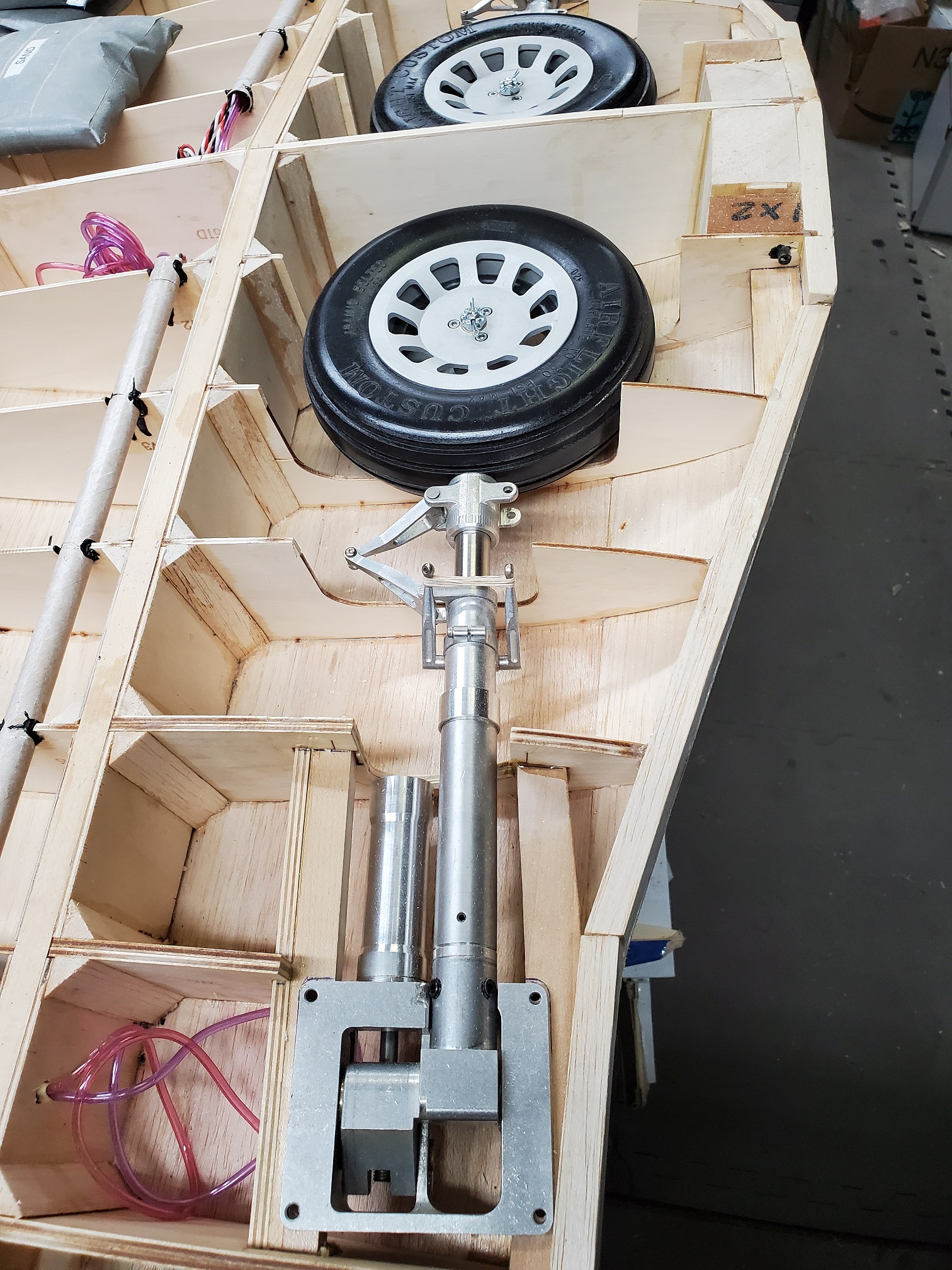

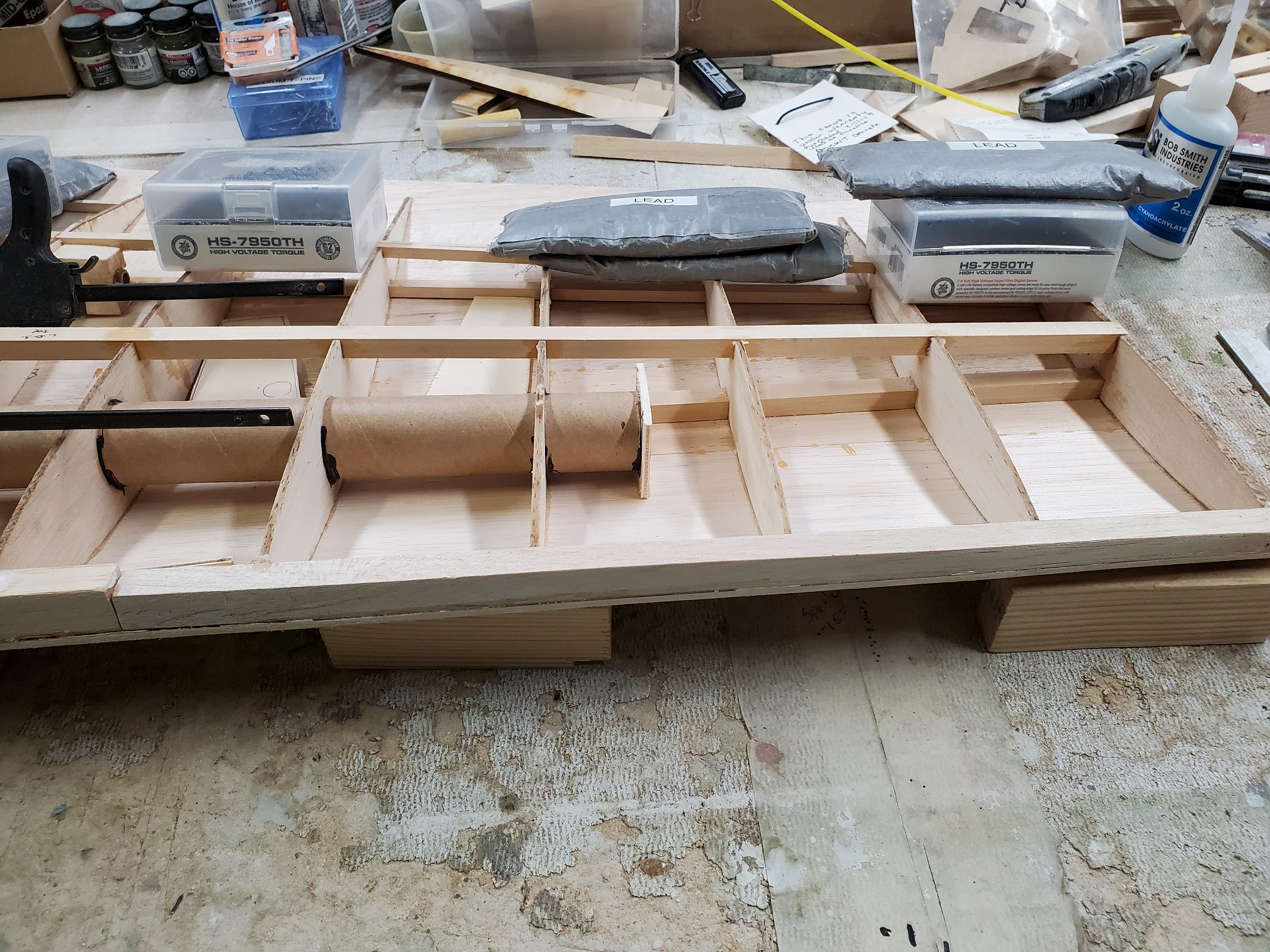

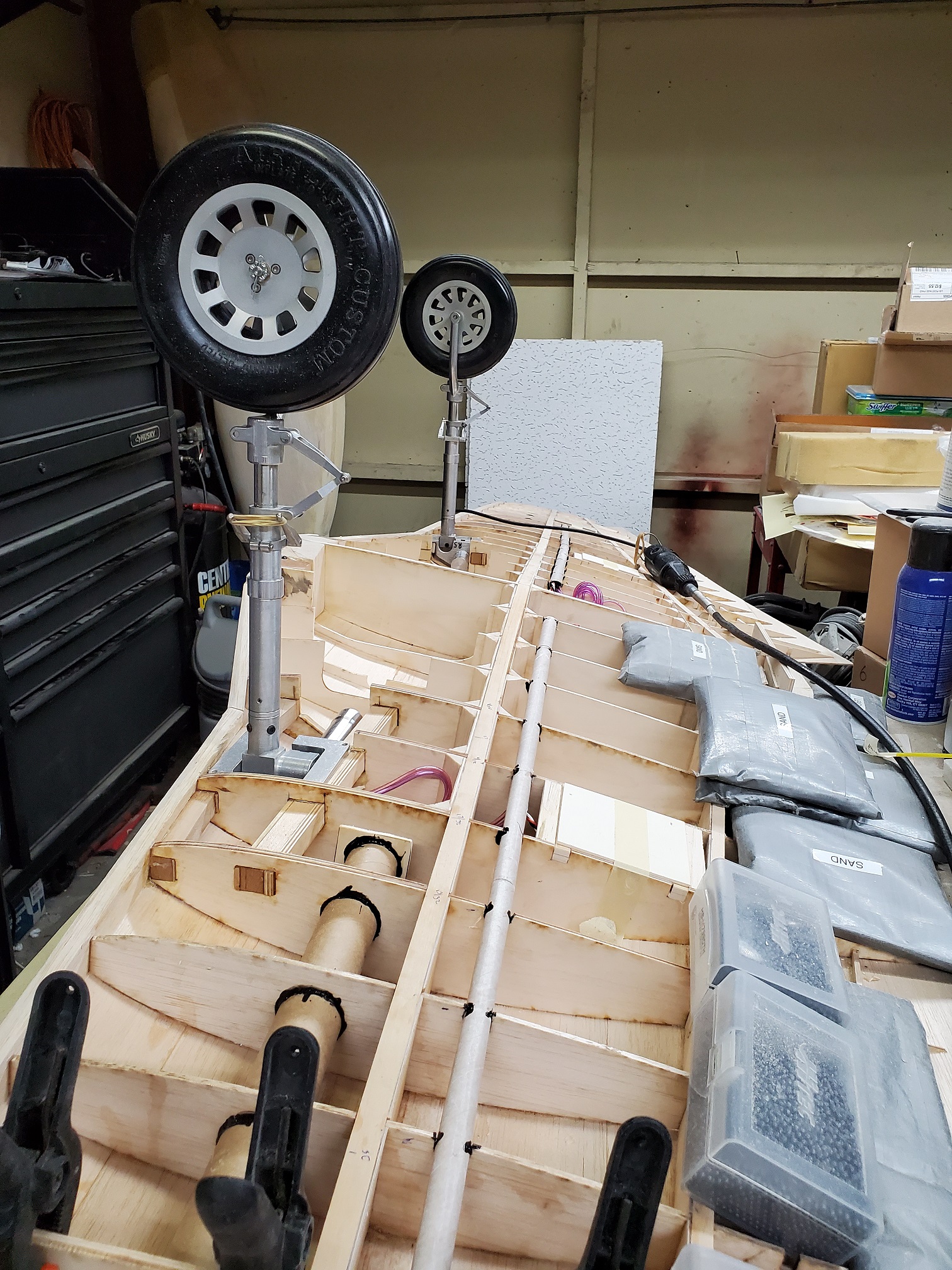

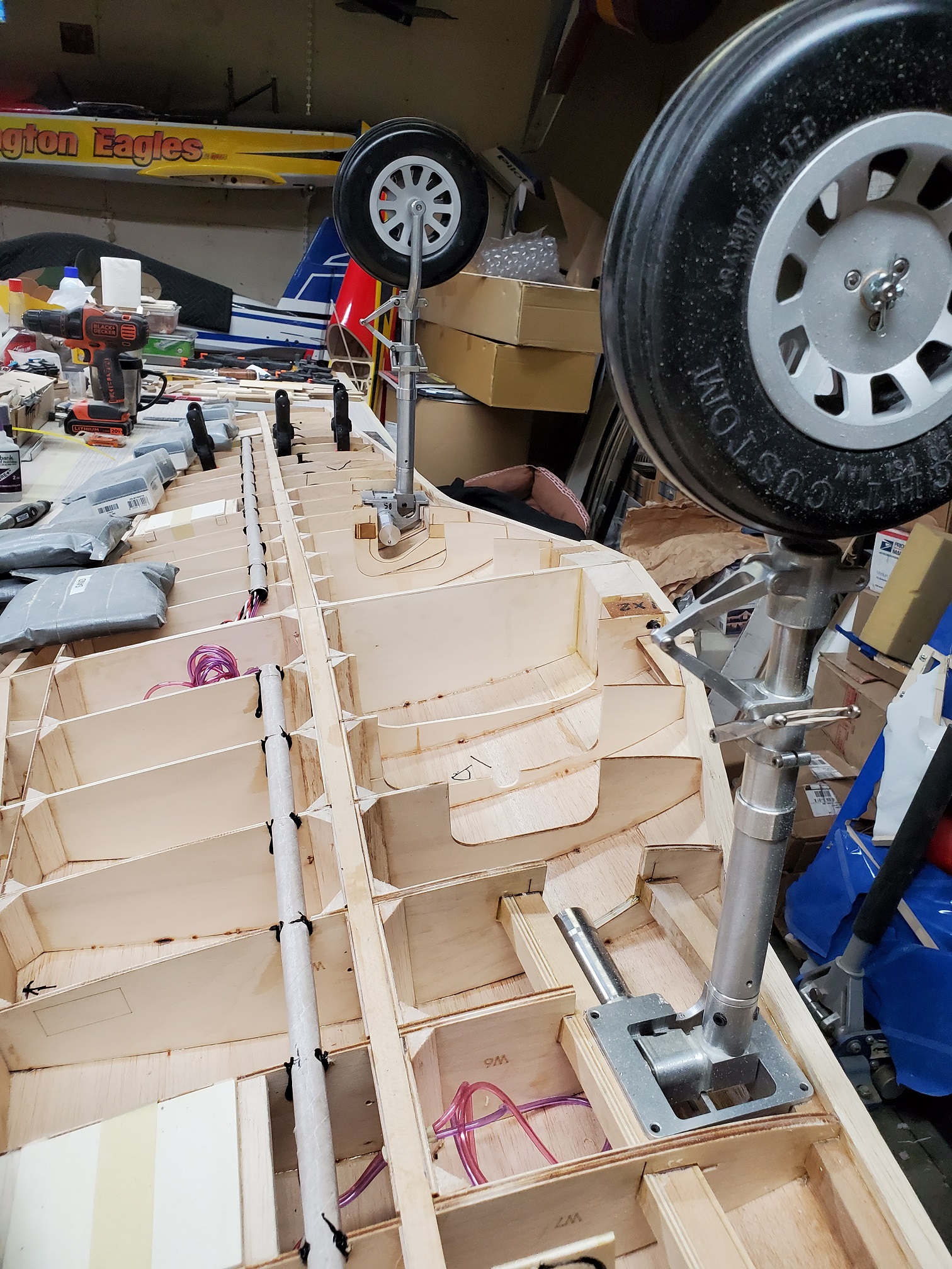

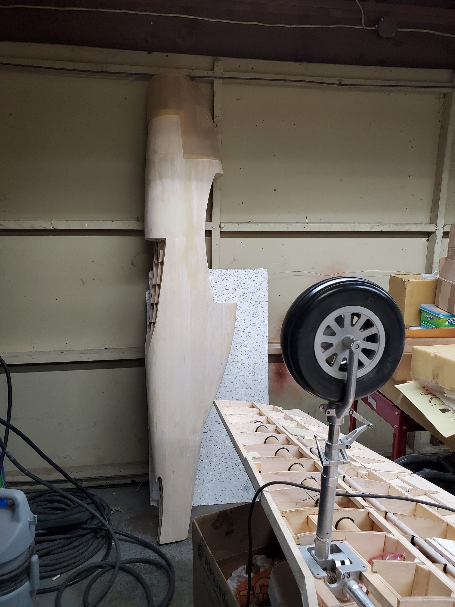

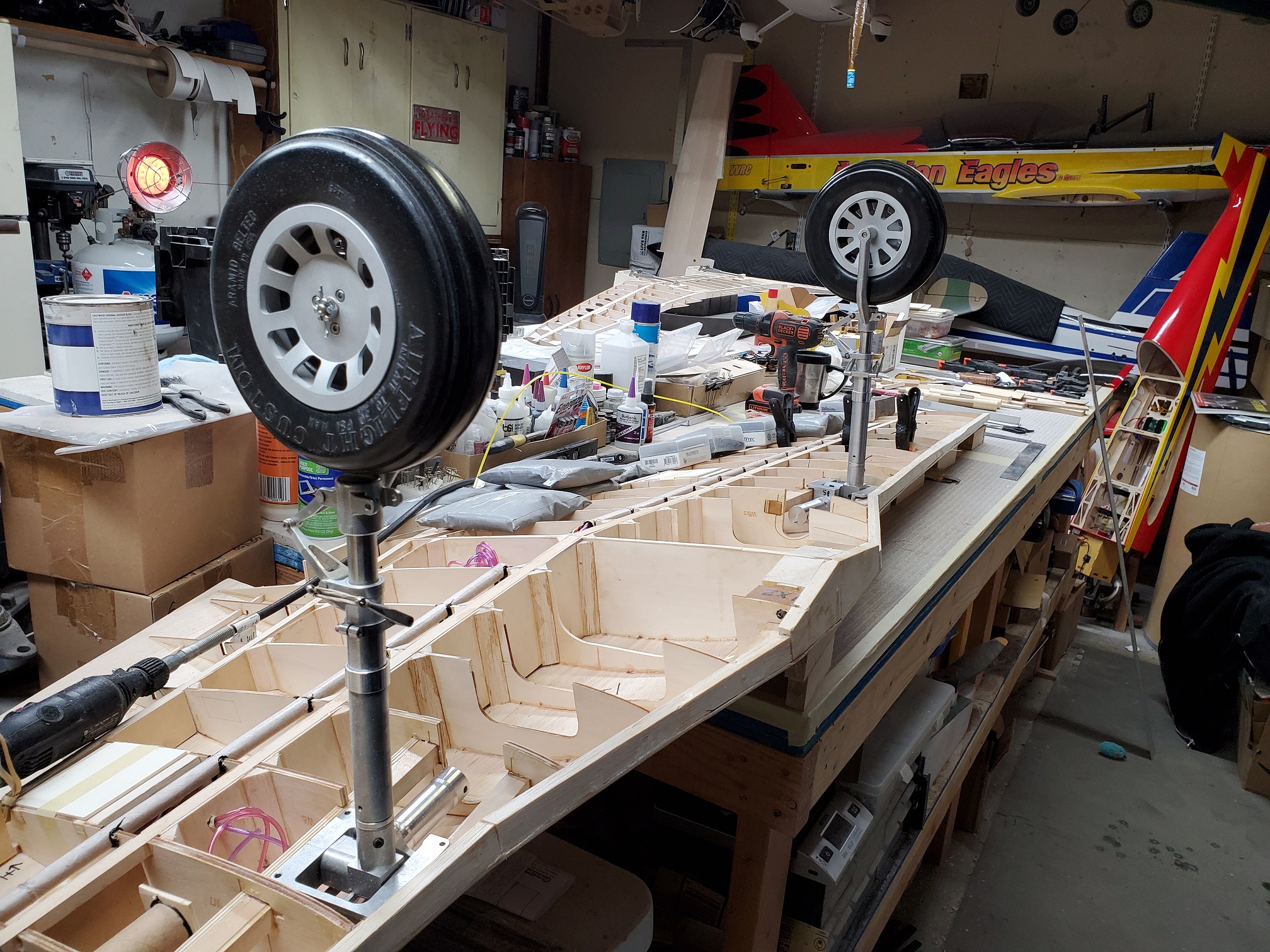

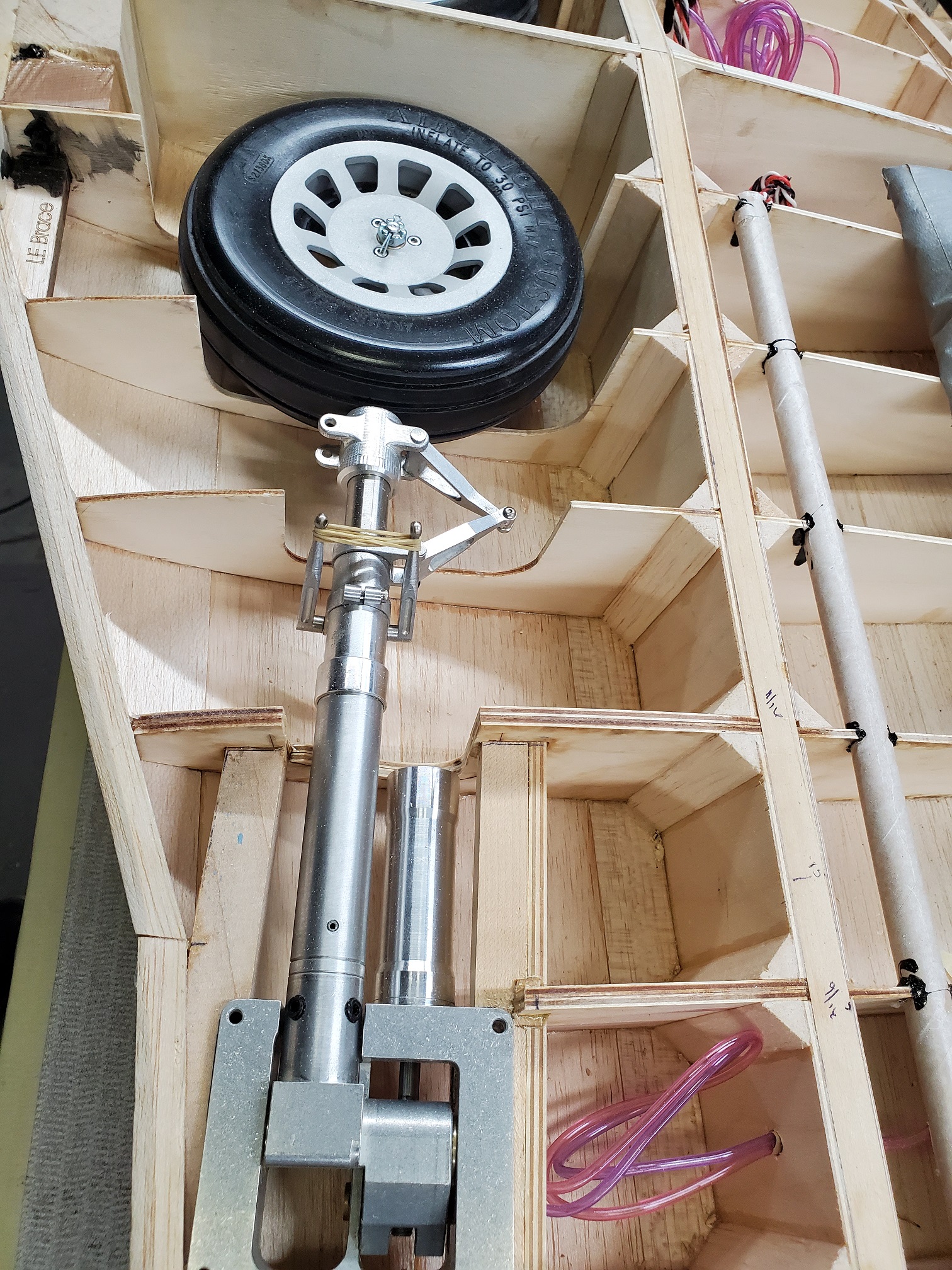

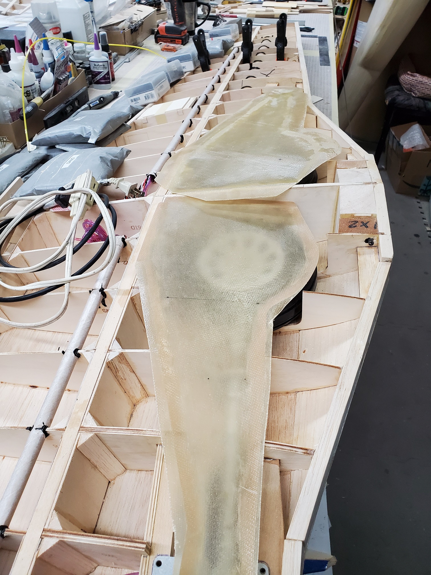

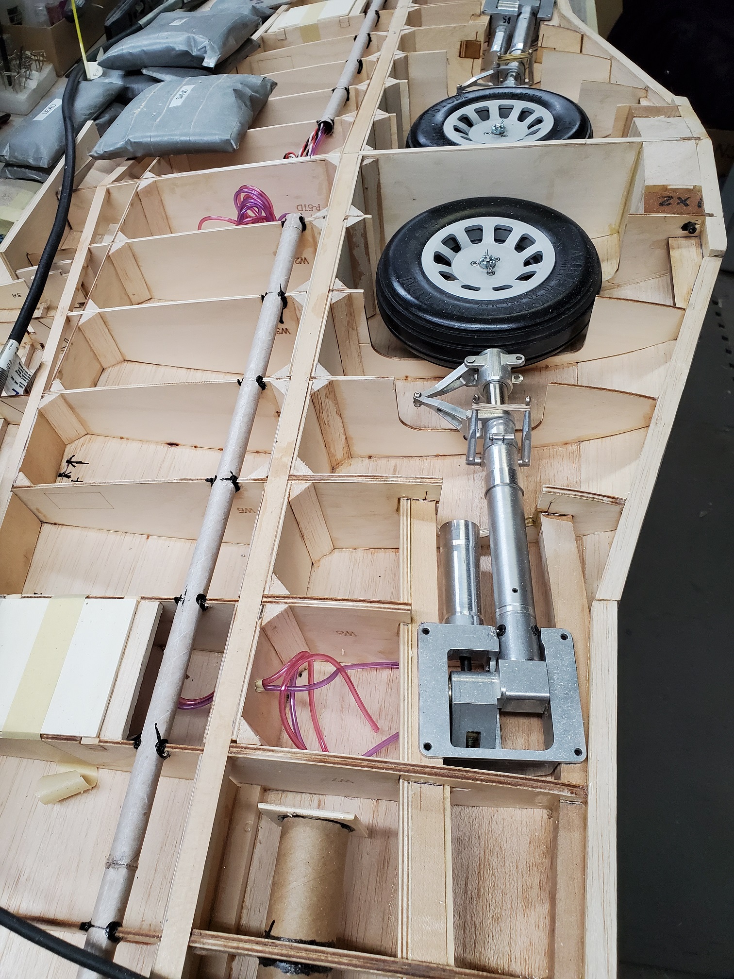

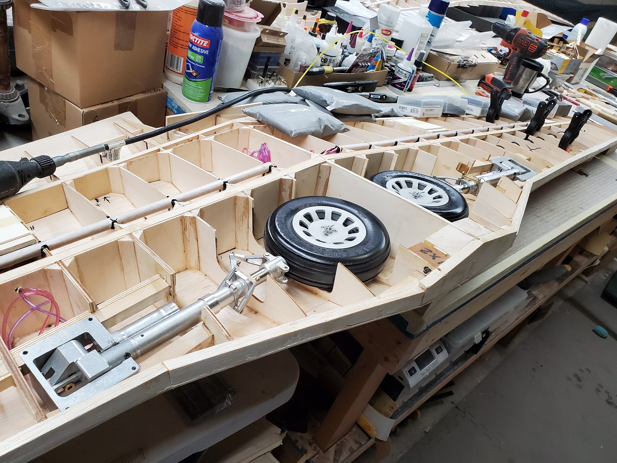

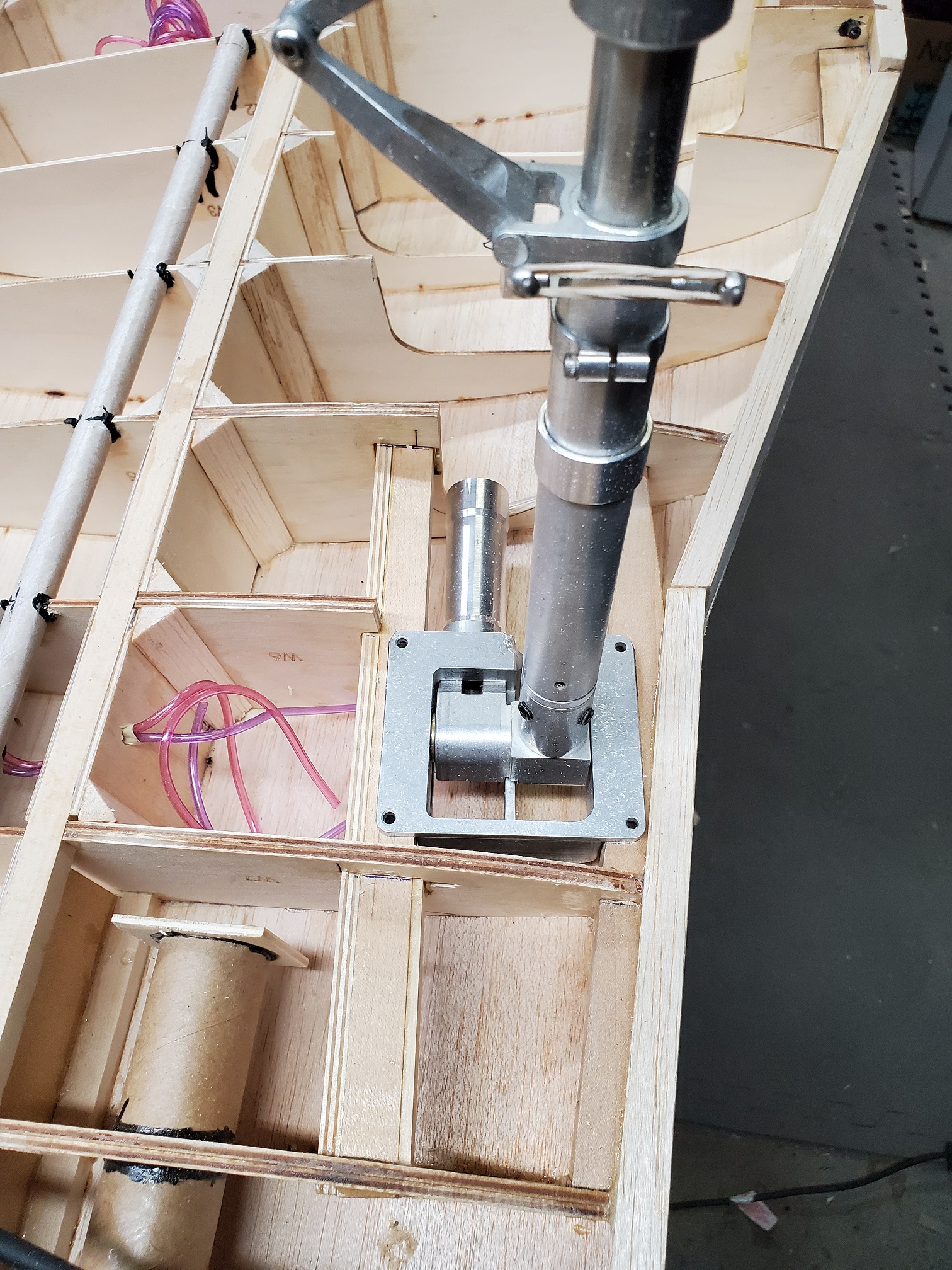

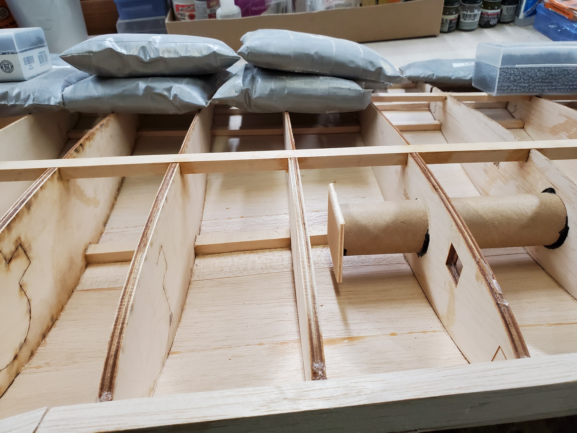

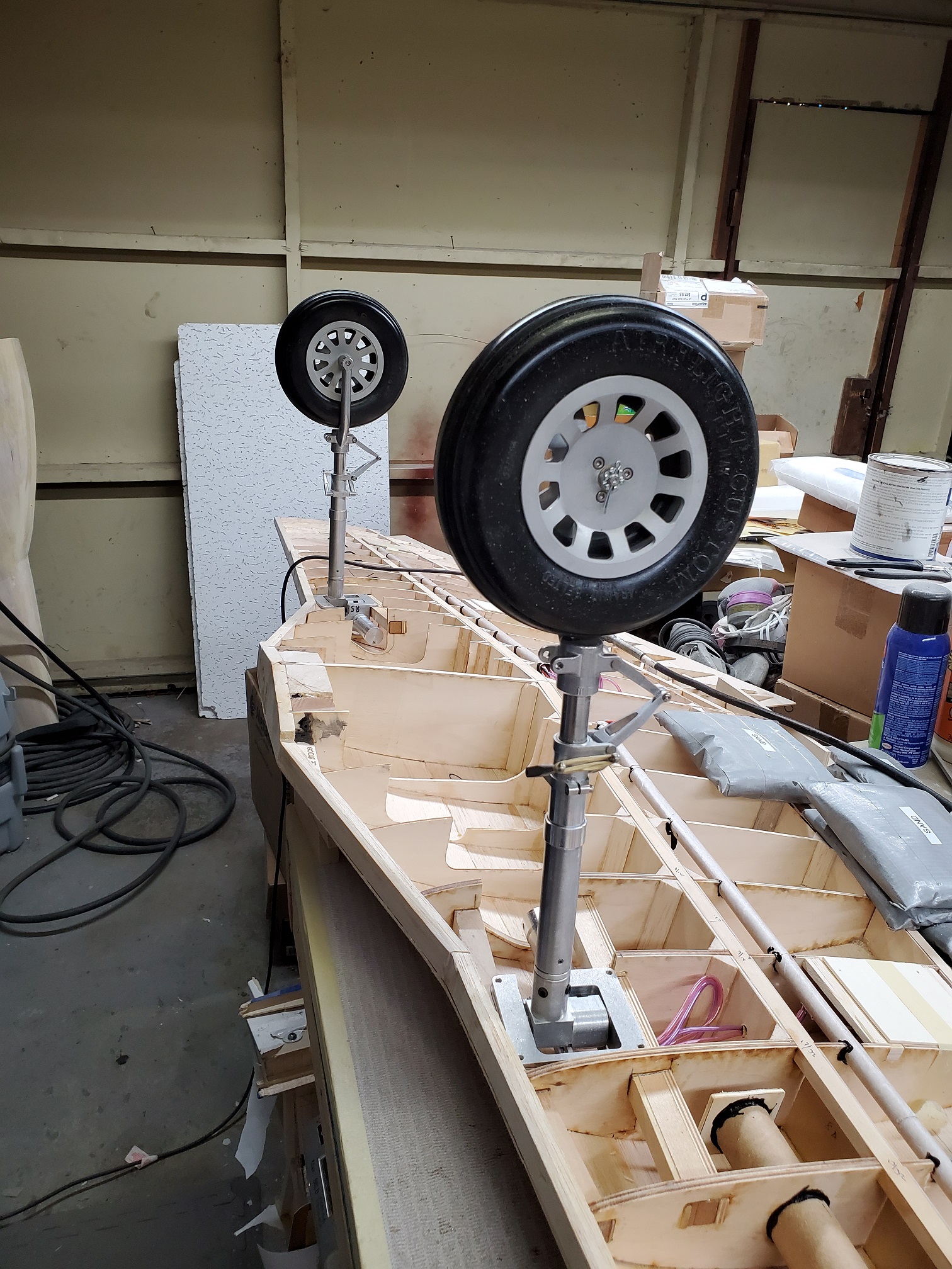

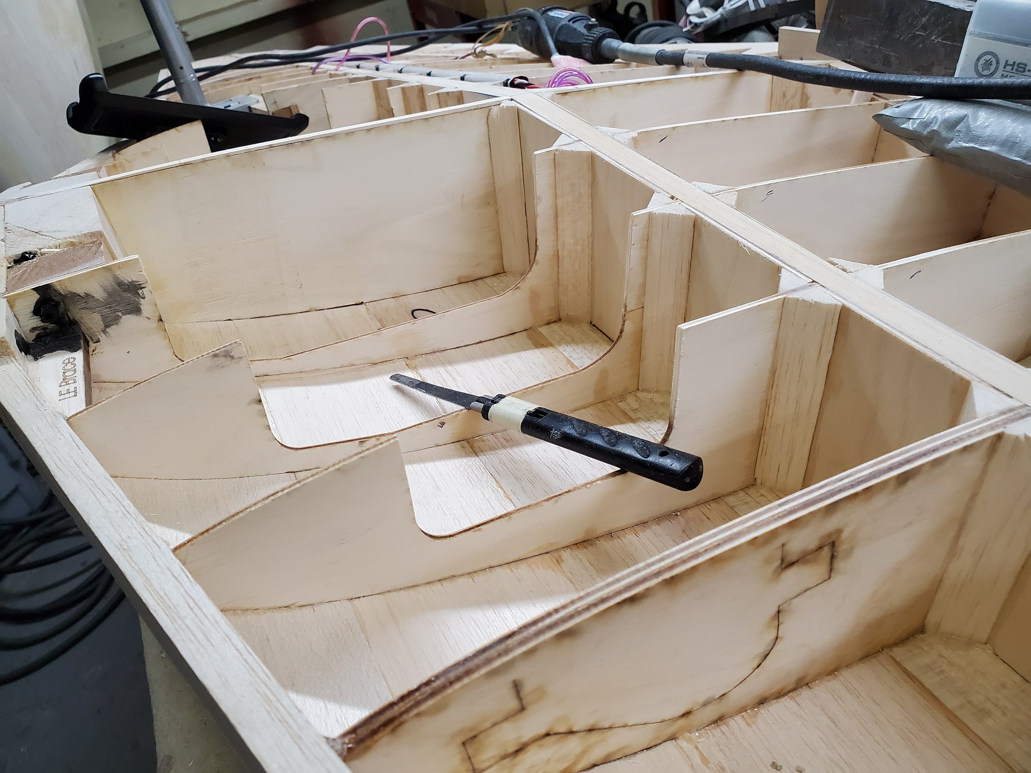

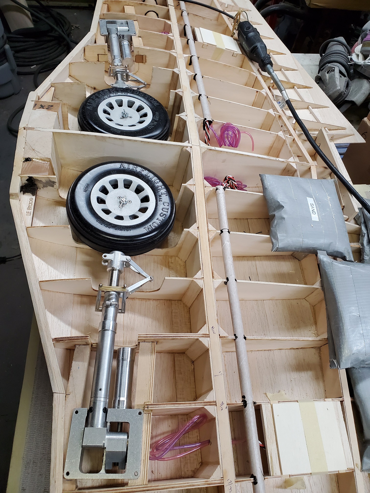

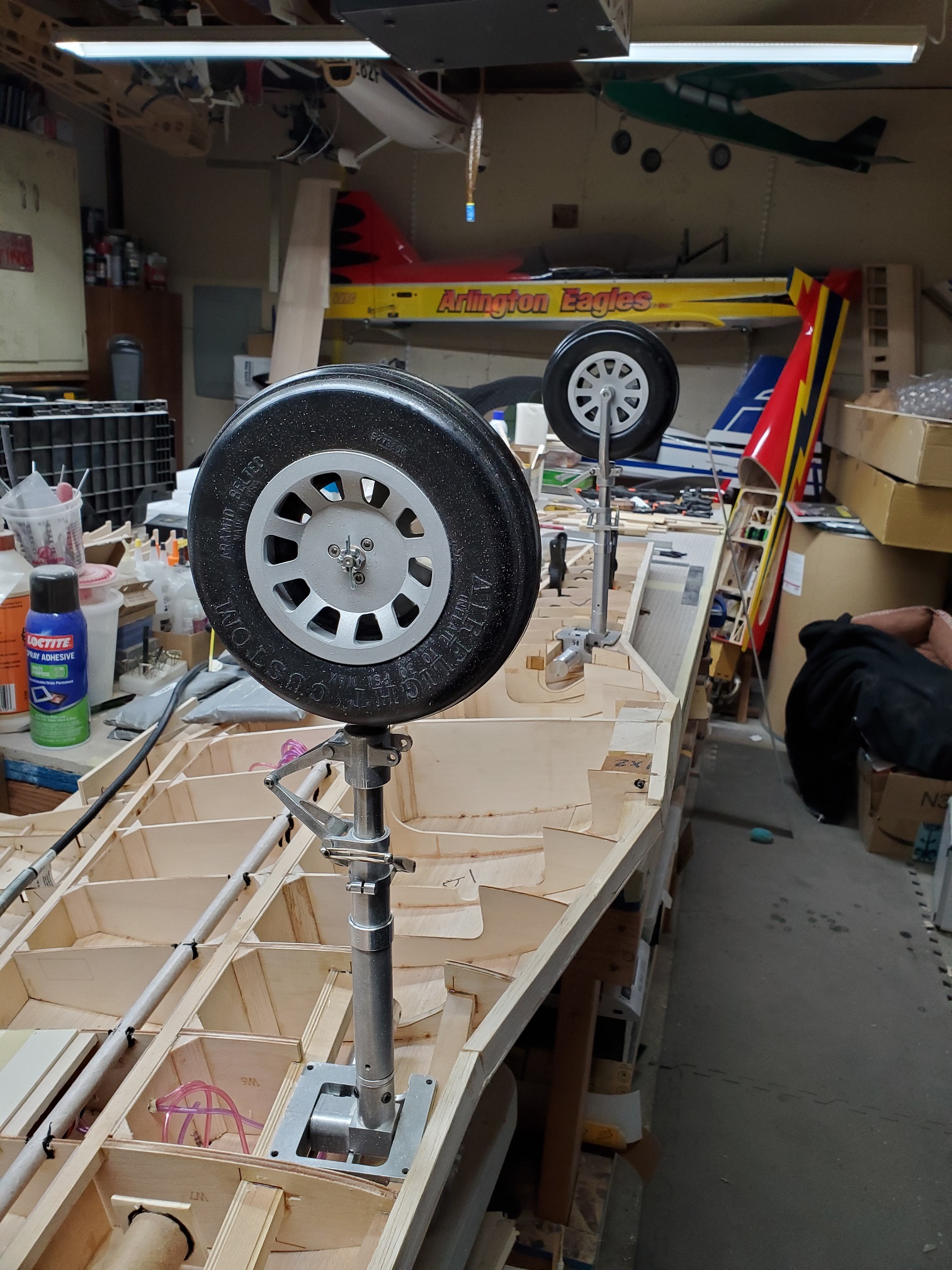

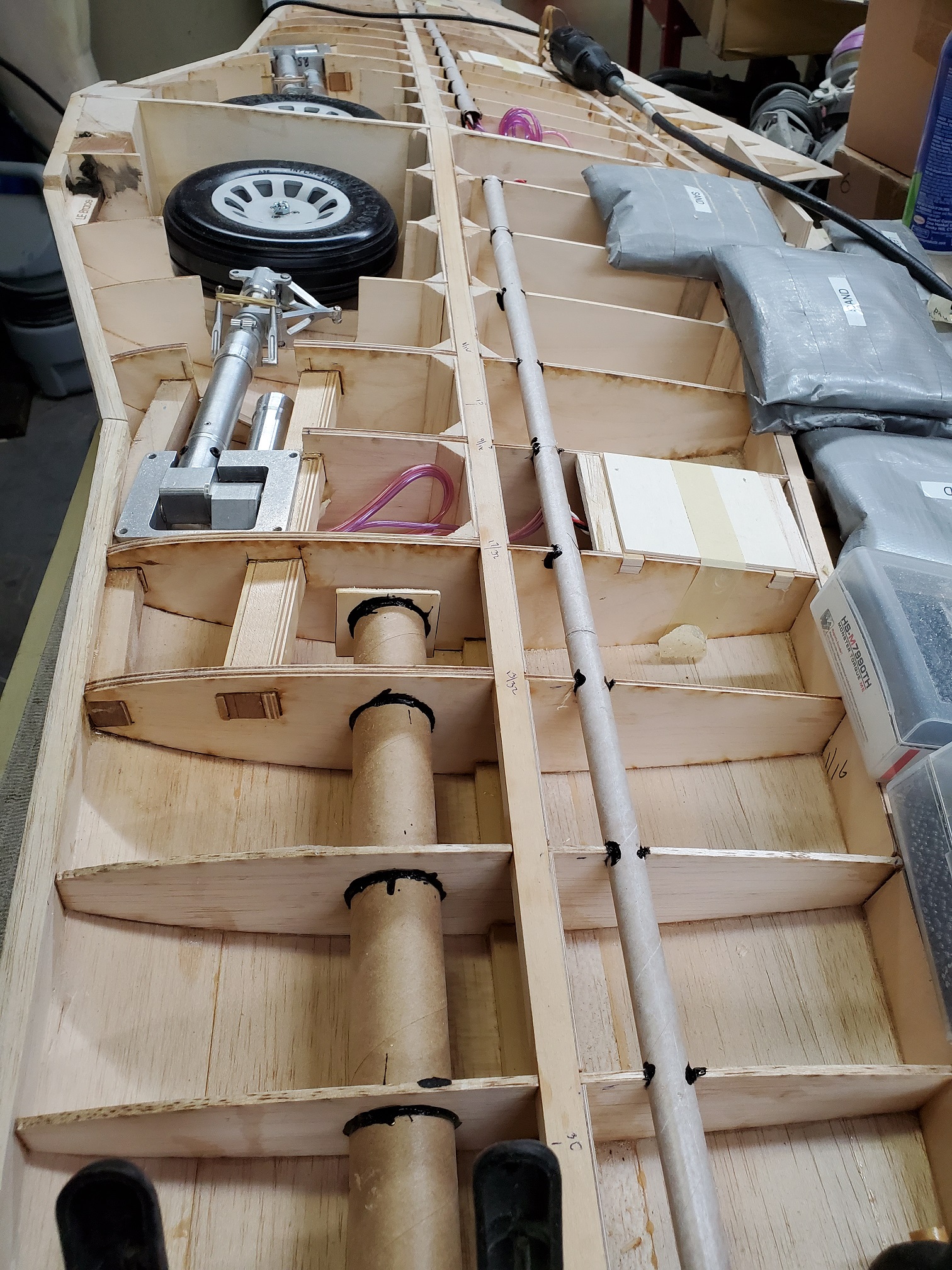

    And the work continues. Three long days at the building table has produced great results. I've made a lot of progress. It doesn't seem like it, but actually... considering the amount of work that goes into these monsters, what is knocked off the list to complete is now accumulating. Air line and servo lead tube installed in the right wing half now. Along with air lines for the gear and the servo leads for the ailerons and flaps. shear webs in place along with tri-stock re-enforcement in the corners of the load bearing areas. Servo doors are also completed. Today was spent entirely on getting the ribs cut and sized for the gear rails to be installed. Once that was done, the rails were epoxied in place and the right main gear fitted and placed in proper location. Holes for the gear bolts drilled. I will probably go back and do a little re-enforcing to insure the integrity of the gear rails. Last thing I want is the load bearing ribs and structure to not be able to withstand the weight or the forces upon landing. There is still plenty to do to this wing before it is ready for sheeting. I have still not decided on functional trim tabs. If I do, it will require much more work and serious calculations. Hitec, (My preferred brand of servos) makes some really small and compact servos. If I do incorporate the functional trim tabs, I will probably place the "MICRO" servos in the ailerons, elevators and rudder. With a small "scale" type linkage, I will make the connection to the trim tabs much like the full scale Mustang. Just a matter of if it is worth the amount of work that needs to go into this facet of the build. Functional trim tabs would be smashingly cool...and my MZ32 is definitely not shy on channels to support that function, but the question is.... will all that extra building and setup really be worth it? Guess we'll wait to see where this goes. LOL.
    For now however... a few photos of the progress over the last couple or so days. Not sure if I will have time to get to the Behemoth Stang tomorrow...but if I do, I will do my best to get more photos. The fuse seriously needs her wings....!!!:yesss:
