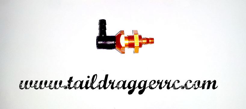

I really like this one because it's 90°. I also cut off the bottom nipple and use this for a vent no as well. The PSP fittings are a little large in diameter for my liking. $4.00 at http://www.taildraggerrc.com/alloy-90-degree-fuel-fitting/

Thanks! Those look awesome!
Although I have never had one of these leak on the new tank I am building for my 91" Extra I have ordered some Viton O-Rings from McMaster Carr 9263K166 If you look under the top hex area you will see a smooth section well these fit there nicely to seal.

Even better! I'll pick some of those up on my next order. Thank you again.
